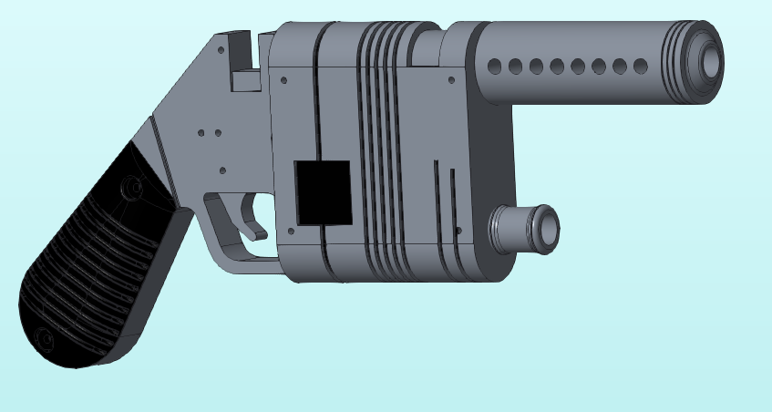

After a bit of time in CREO, this was the result (still haven't modeled the hammer yet):

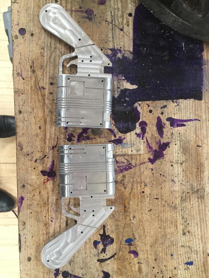

I decided to make the entire body of the blaster (not including the grips, barrel and the smaller "barrel") out of two mirrored pieces. The main reason for this was it would allow me to make the body in just one single-sided CNC job. The screws make it easy to join them together. Into the CNC goes a 1/2" x 6" x 18" aluminum flat:
The run time was a little over 4 hours, but that was with pretty conservative feeds/speeds. The brunt of the time was due to the slots and tight corners that had to be milled out with a 1/16" endmill with slow feeds/speeds. In the future, I'd probably optimize the toolpath a bit and use a grooving tool for the slots that ended up giving me a similar result (the four slots arranged in a square in the picture below) much quicker, so I could cut that milling time by an hour or so. After cutting the two halves out of the stock and cleaning it up on a deburring wheel:

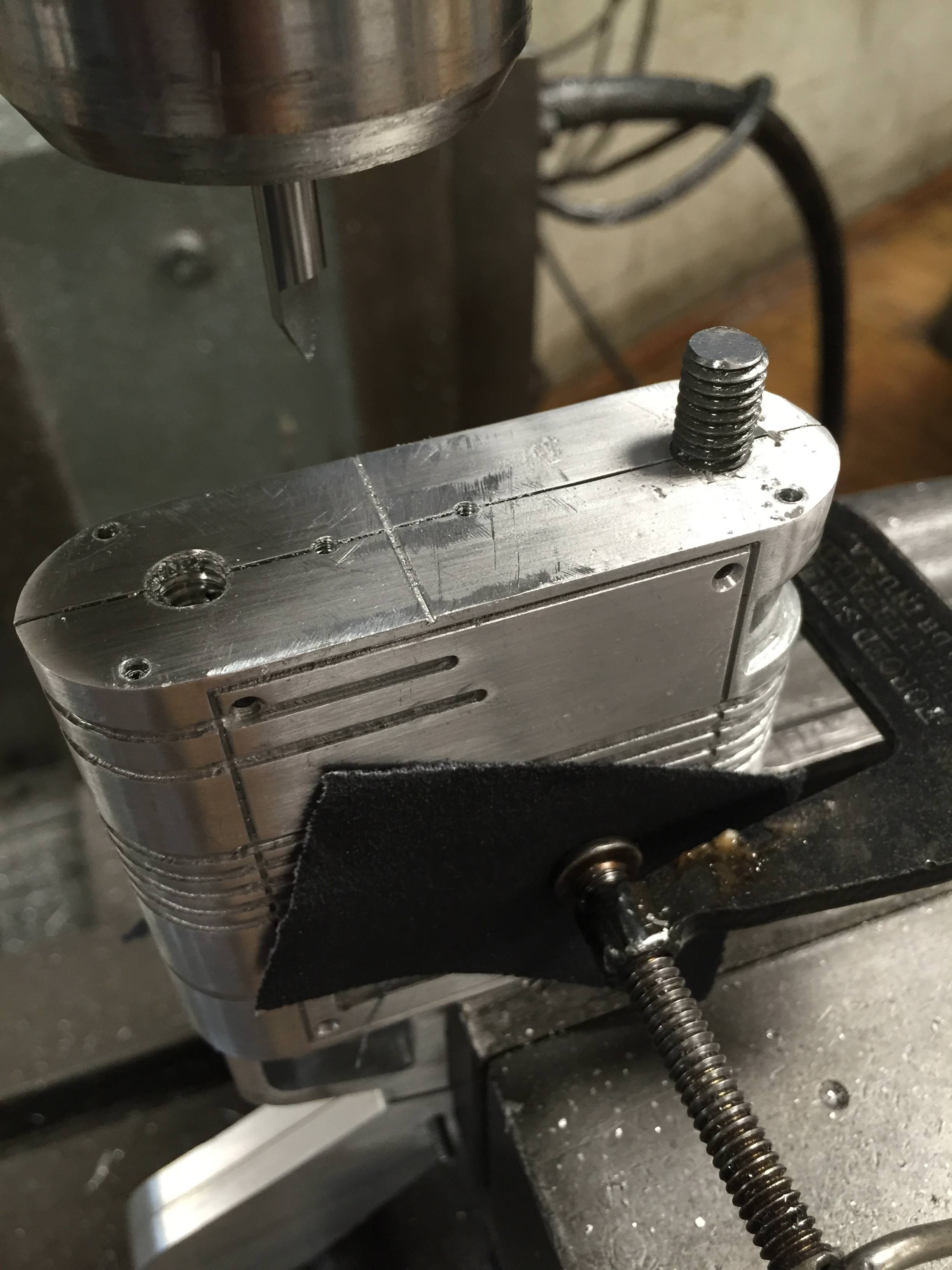

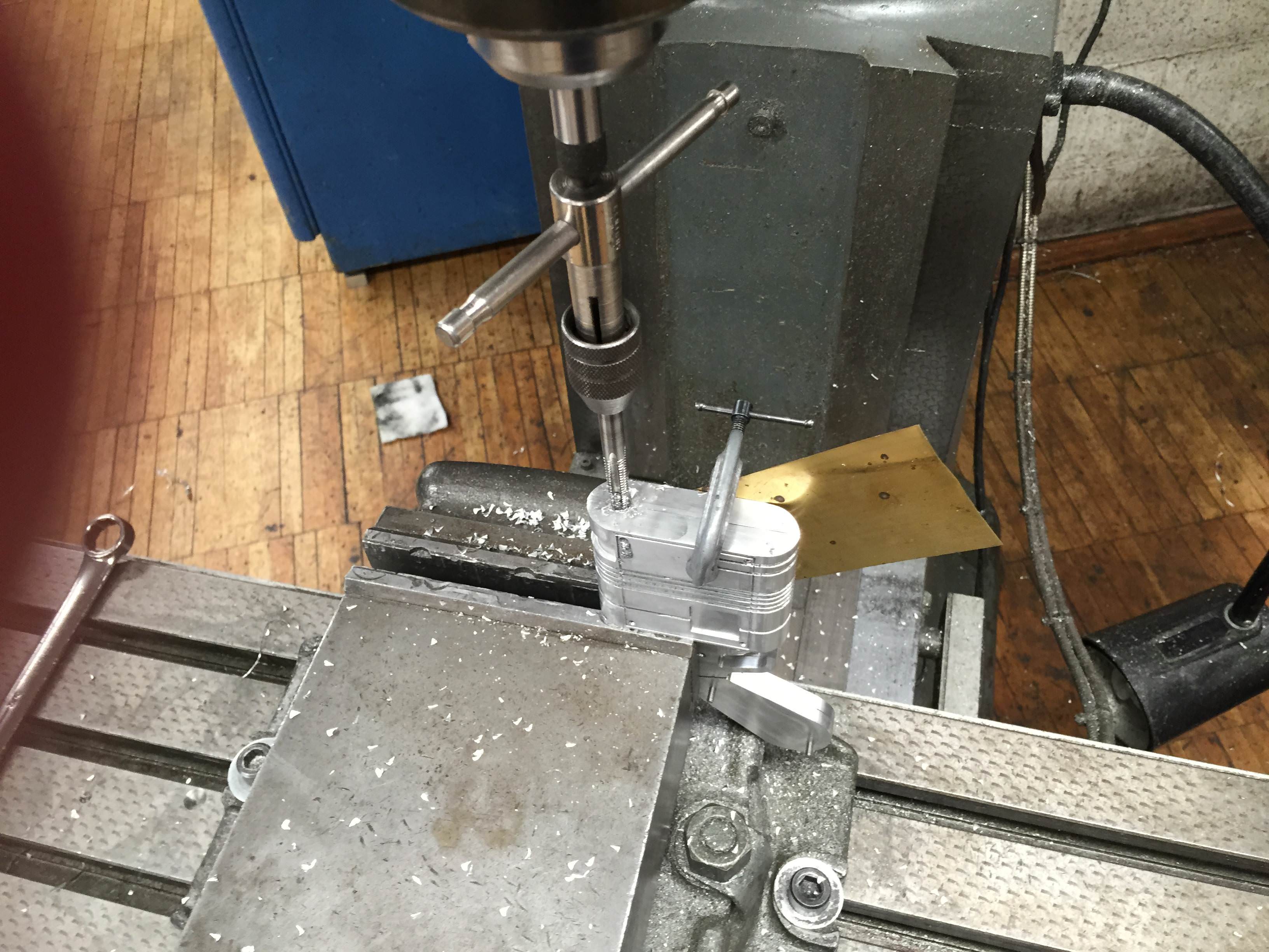

Drilling and tapping the body for the threaded rod to attach the barrel:

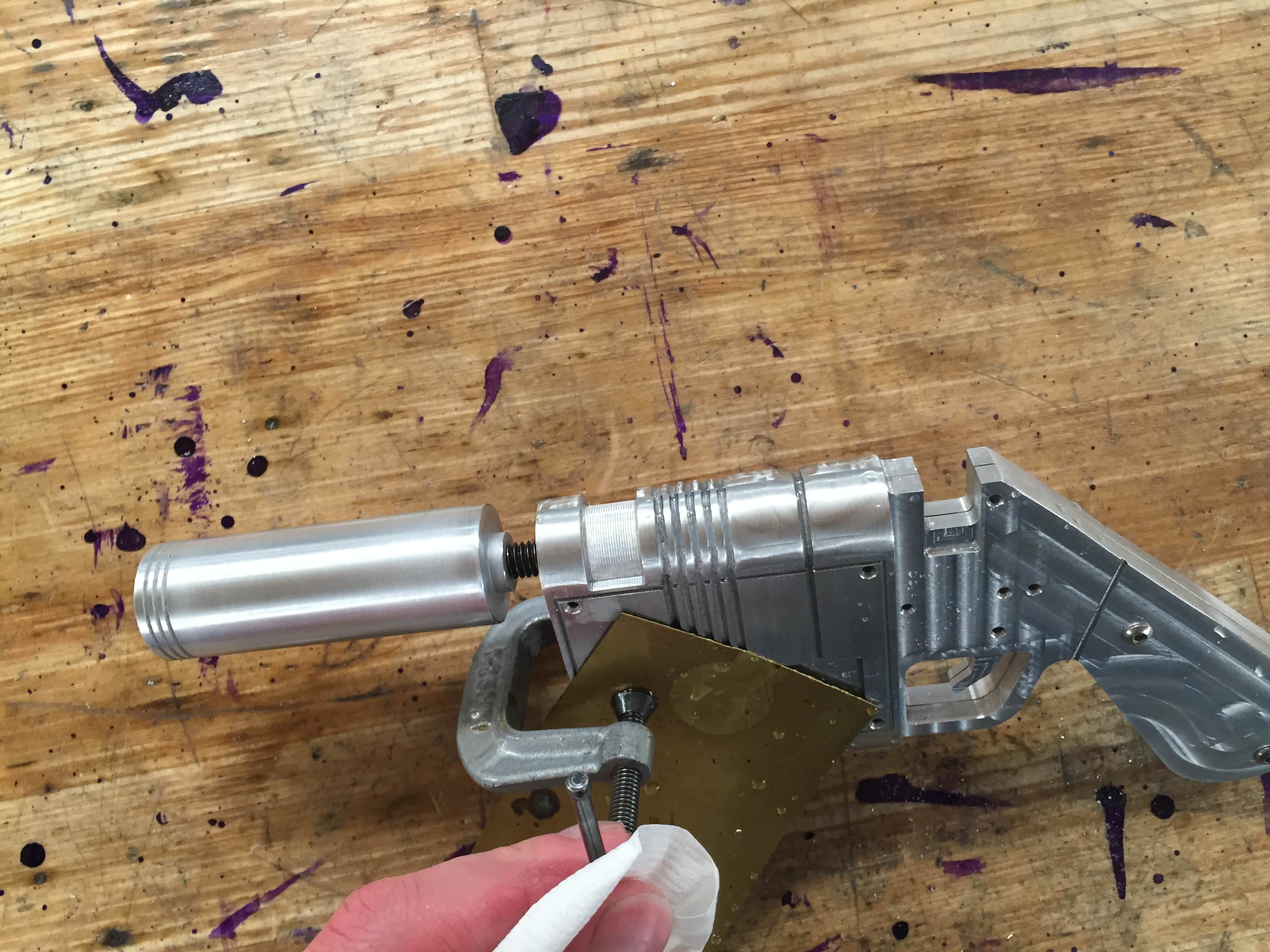

And a quick look at how it attaches:

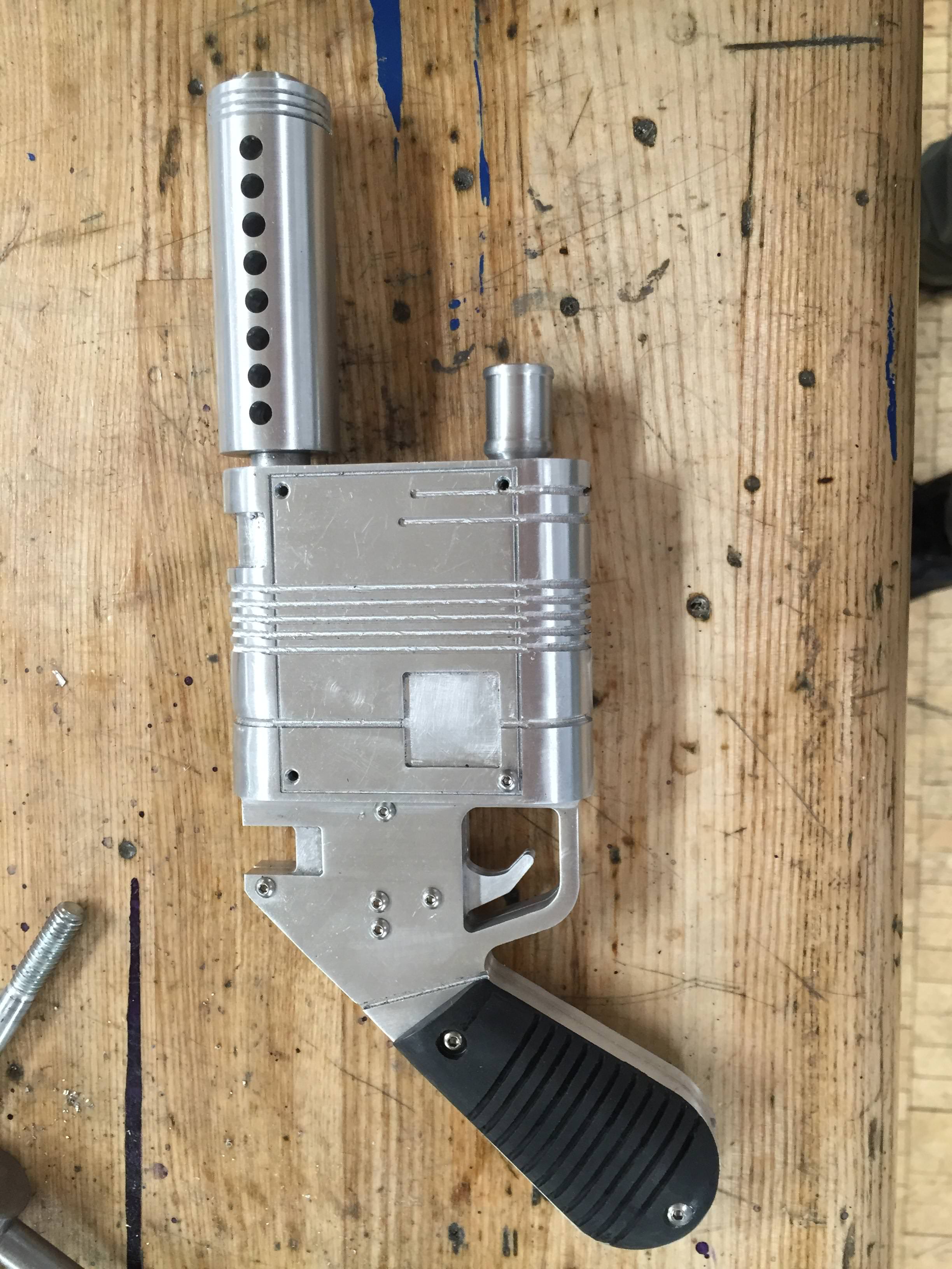

The holes on the barrel were drilled after aligning the body to make sure they are correctly oriented:
Finished barrel without paint:
The holes at the front of the body were drilled and tapped and a groove was cut across it to resemble the real thing. The line between the two pieces should become much less noticeable when the two pieces are bolted together and bonded.

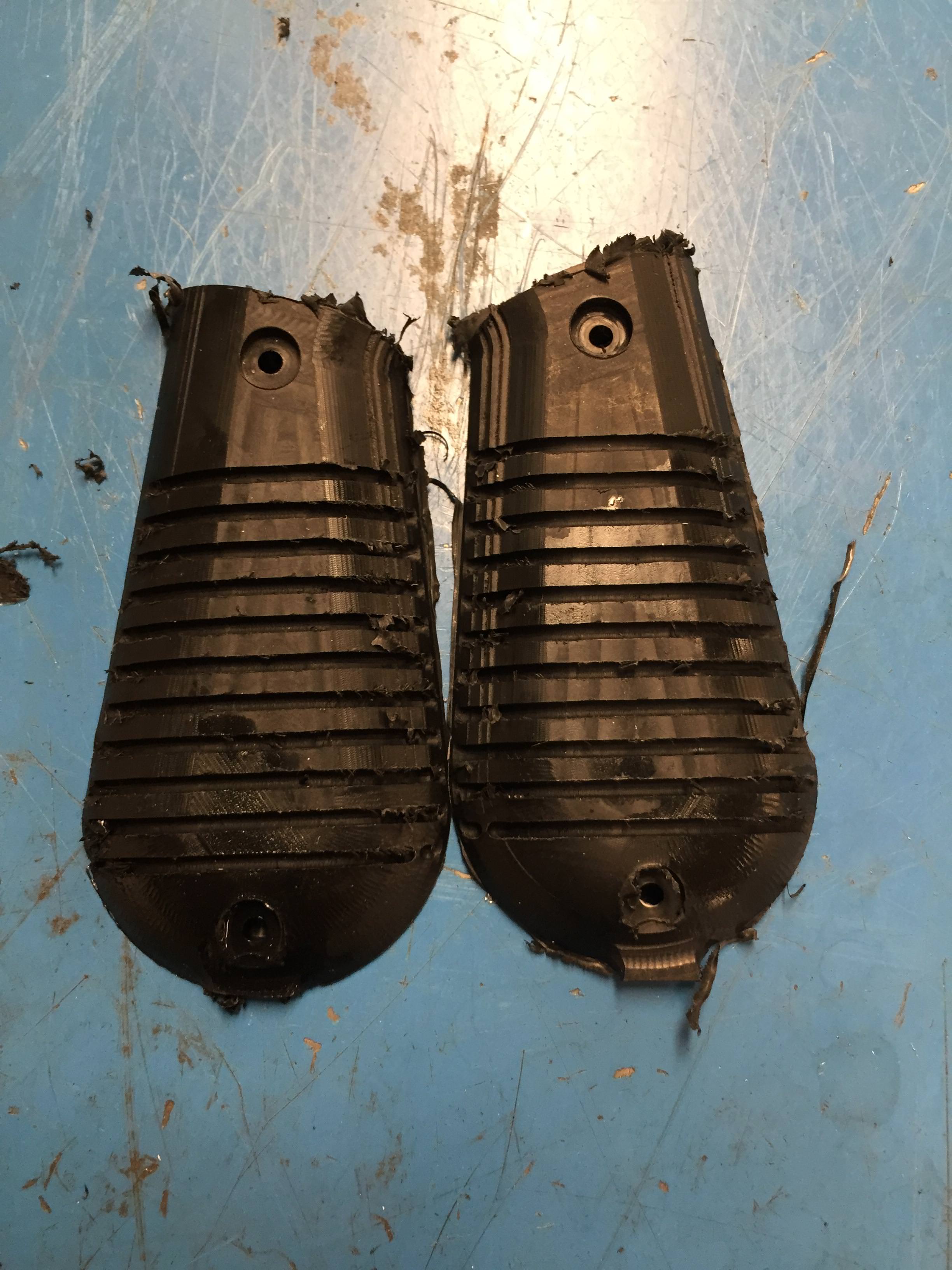

The grips were CNC'd out of ABS plastic. They didn't come out great since it shifted a bit during the CNC job and I was running it extremely fast:
However after a bit of cleaning up and sanding they came out fine. Currently it's really dull but should become a lot glossier after a coat of acrylic lacquer:

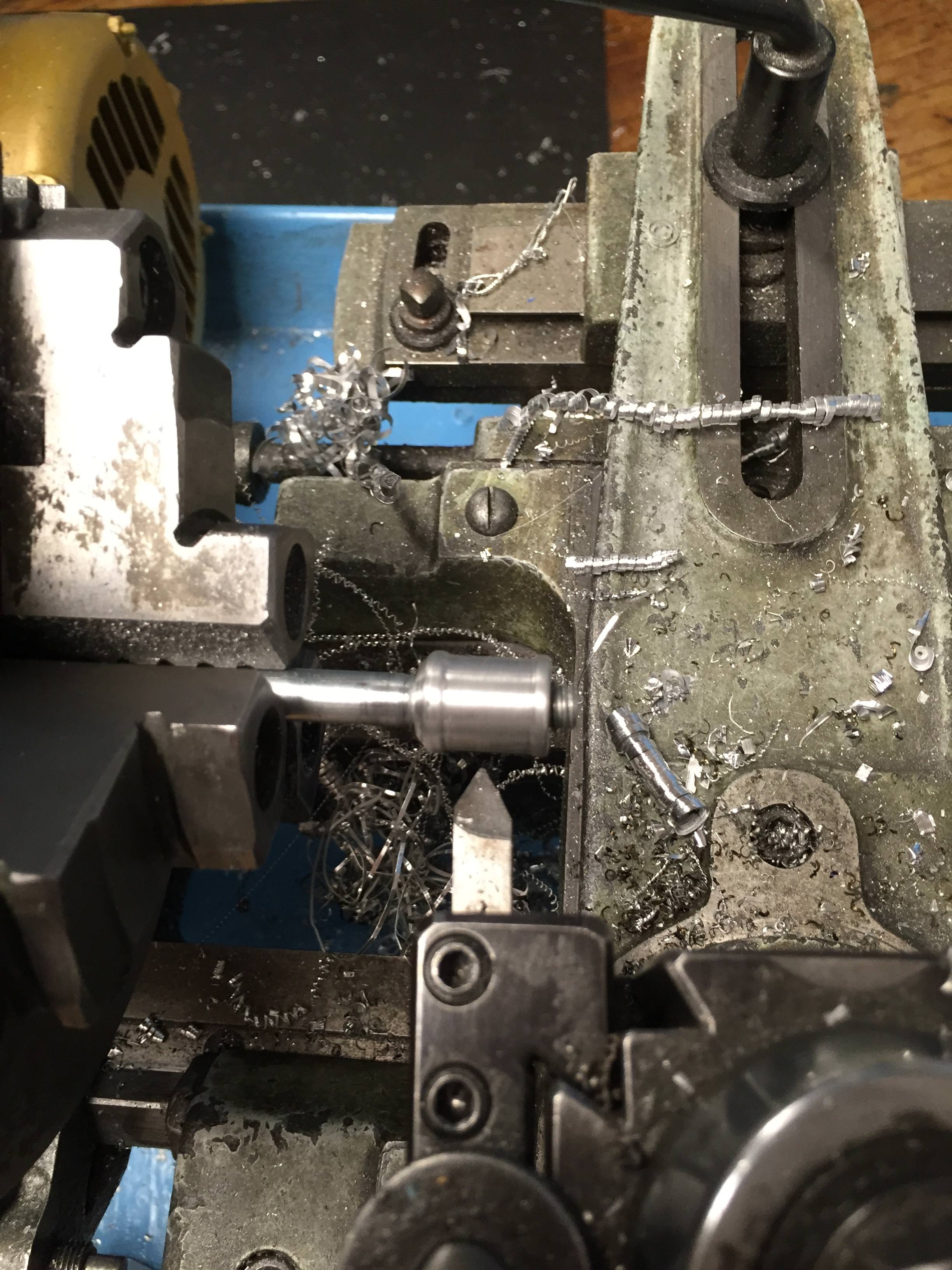

The small bottom "barrel" was also made on a manual lathe. This was kind of a pain in the ass to hold properly:

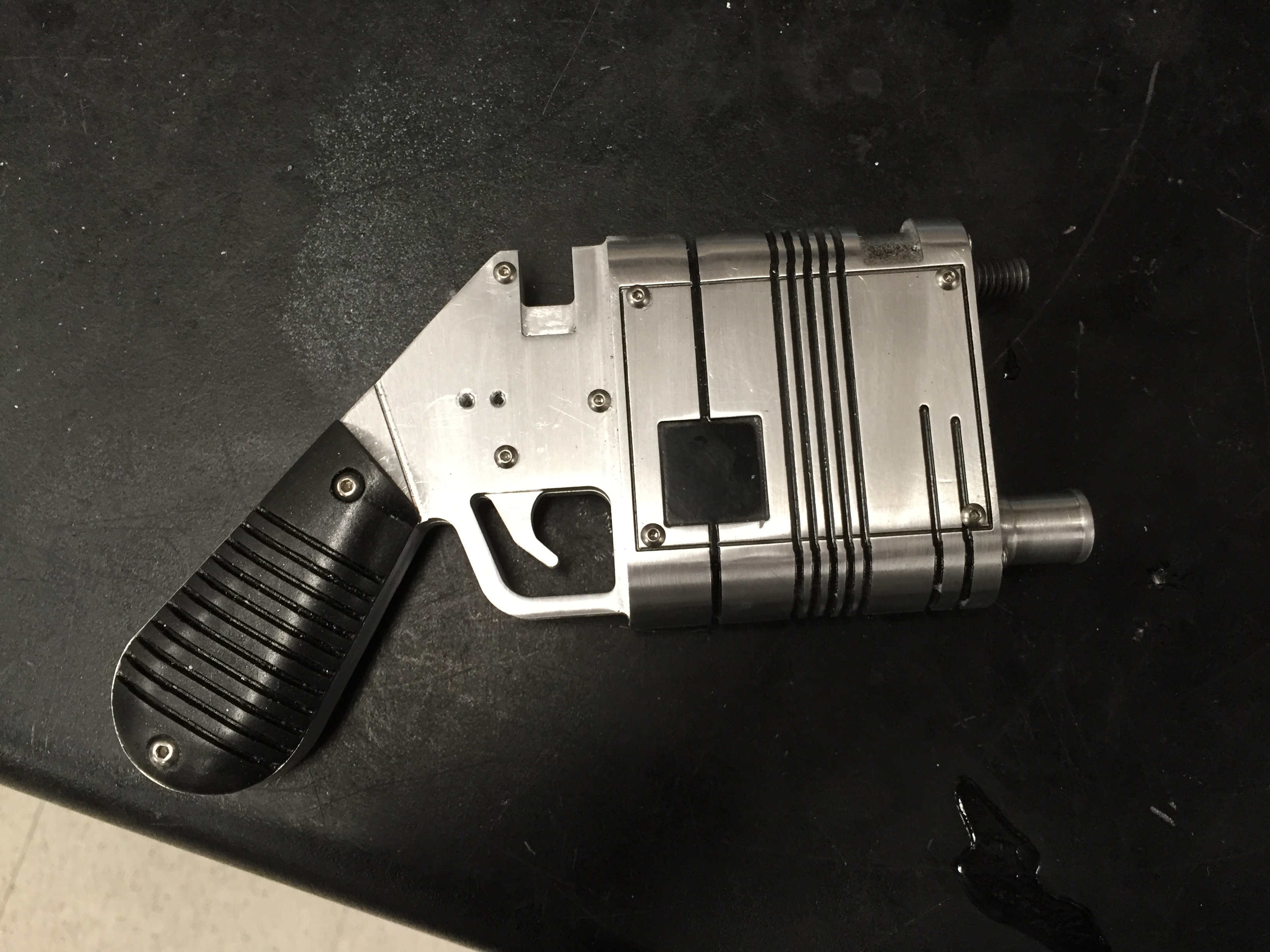

And finally here is the current state of the blaster. Several more things to do such as making the hammer, painting, roughing up, etc.
