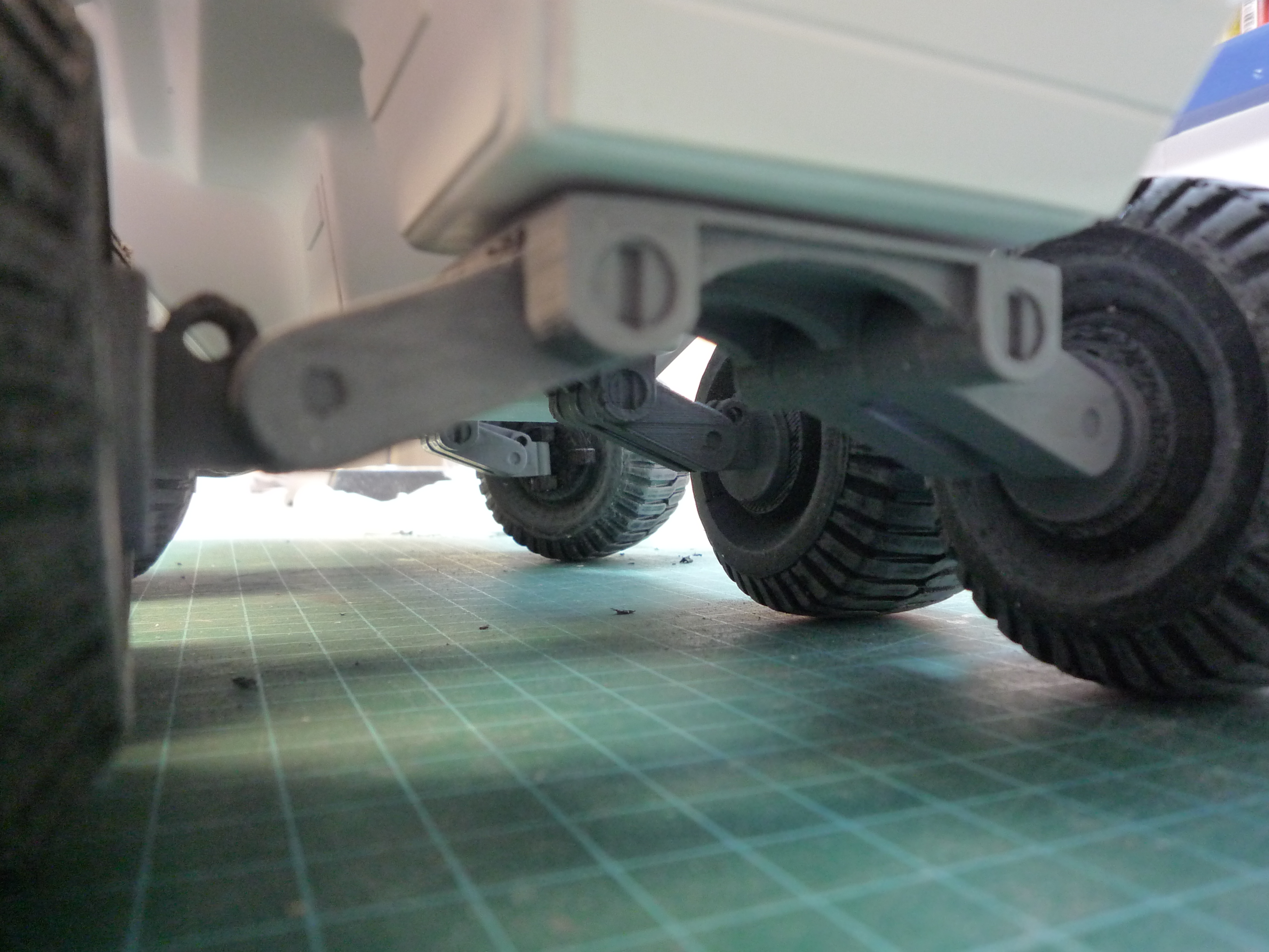

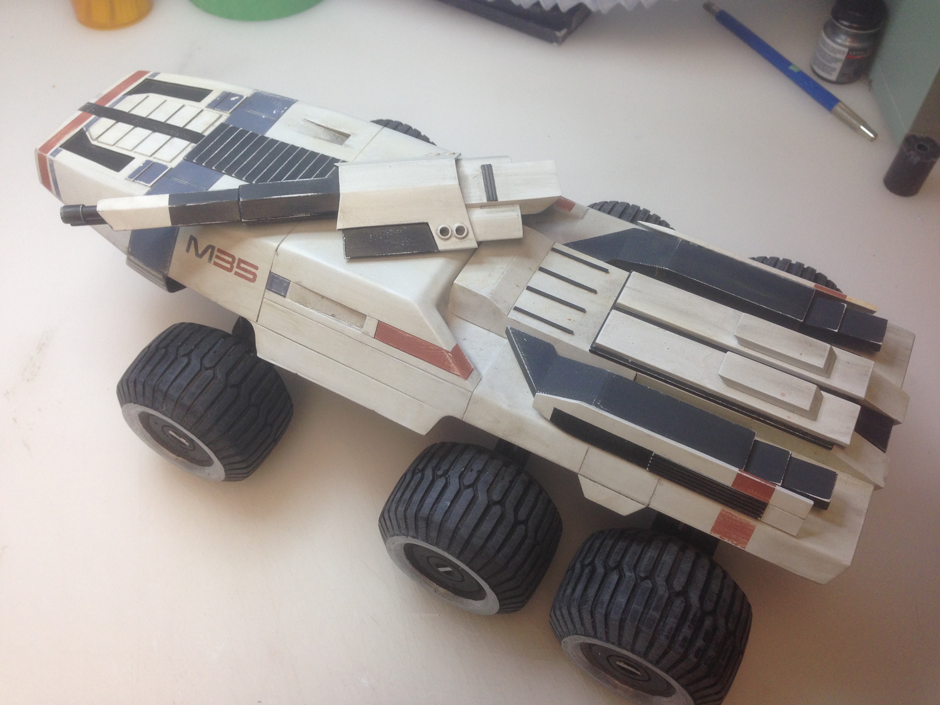

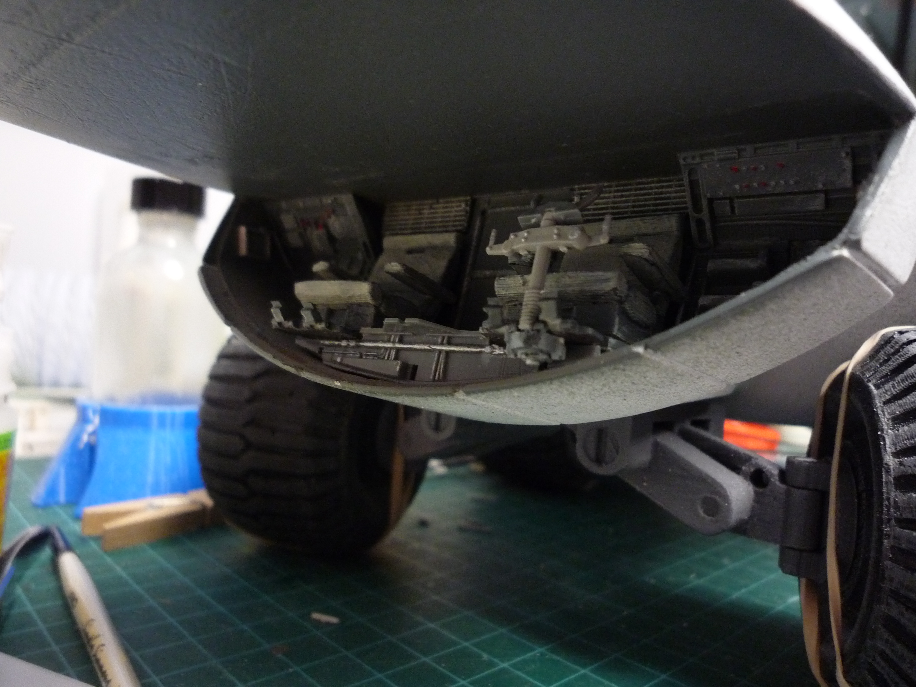

So I've gotten back to this project. Built up the details on the top of the hull, as well as re-designing the suspension and 3D printed them. Not a lot of reference for the suspension that I could find and the paper-craft version seemed kind of wimpy. I also built the cockpit interior today.
That looks great! Personally i prefer the Hammerhead but the mako will always have a soft spot for me :) are you going to add any electronics to it? lights or perhaps even RC functionality?
Absolutely lovely! Make all the jokes you want but the first game is the best partly in due of this gravity-defying, bad beast!
