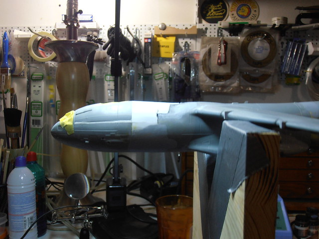

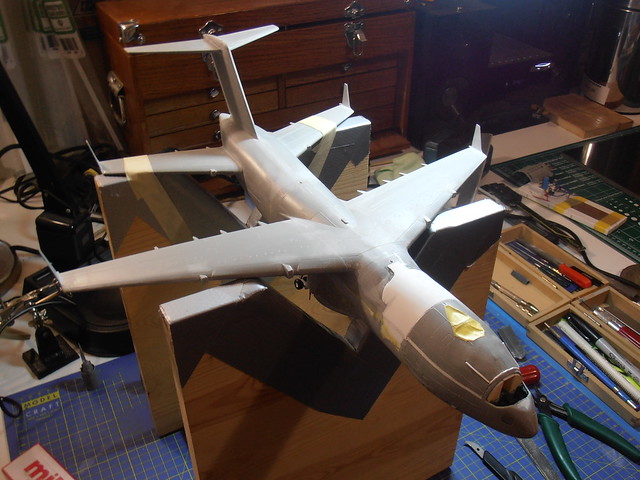

One of the last modifications was the addition of the hump. I've cut the section away at the panel line and kept the arch for the cockpit glass, also to keep things where they're supposed to be.
First attempt at getting the height, I glued 2mm styrene strip but it was too much and made it look strange.
The angle was all wrong, so I removed the 2mm and put in 1.4 mm strip. Cut a couple of reliefs into the top and heated them until I got it where I wanted. Looks much nicer. Ugly, but nicer.

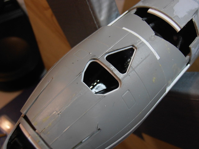

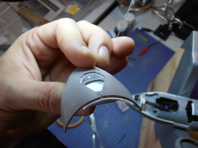

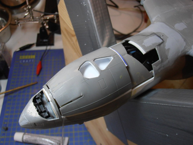

Next on the hump, was the skylight for Coulson's office. This little thing took me all day, literally 8-fun-filled-exiplative-laden hours to complete. I had only one shot to get it right and kept checking and rechecking against the screen caps I had because failure at this point would be very bad (no spare fuselage to cut up). I went very slow when cutting and did all the final shaping by hand with very small files. That square hole by the wing is an access point so I can drill into the LED and attach the Fiber Optics for the office.
all cut out... I can relax.
Since it's going to get 'frosted glass' it needs a backing...
One of the 3 fiber optic strands in the office.

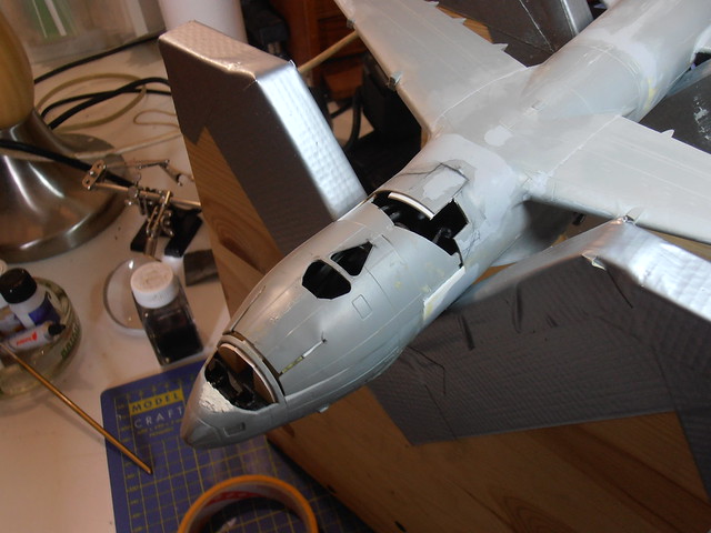

Now that the office is done and in place, top section attached, time to close it up. 1mm styrene that closed up the gap from the stretch and went onto the fuselage to blend the shape (and cover the led access hole) without using tons of milliput. Had to thin it out in areas to fit like I wanted.

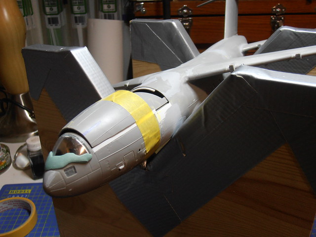

The area of the hump just aft of the office is too flat. Millitput to the rescue!!
Still needs a bit of work, but it's looking good.

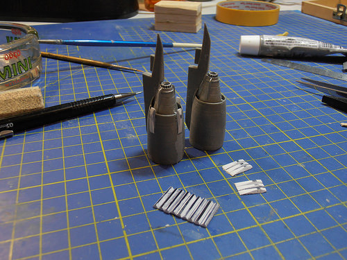

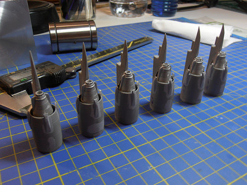

I was sick the last few days and will be unable to get it all properly done before the show. I'm not going to rush anything just to make it to a show. It's going to be done right and take as much time as it needs... that being said, I think I'm about done with the engines... Still needs sanding and some scribing and whatnot, but overall, I think they're close... Upon closer inspection of the screen aircraft, the engines seem to be shorter after the end of the cowl. They're probably set deeper, but at this point I wasn't about to crack them open. The next one will take this into account.
I used 1.5mm x 2.5mm styrene strip to make the greeblies on the engine pod exterior. (Anyone have a name for them, let me know) I made a jig using some scrap wood, vice on a ball joint, and my dremel to get the angle consistent on both sides of the strip. Then I cut them into 13mm lengths, stuck them together with tape, and used a jewelers hand vice and a file to sand them into shape.
All six "done"... bringing each engine's total additional styrene bits to 21... for a grand total of 126 pieces. No matter though because once primer starts to go on numbers and hours melt away.

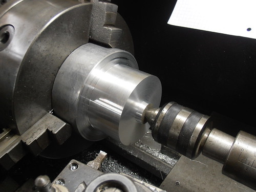

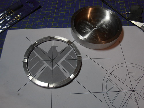

While waiting for some primer and filler to dry, I started working on the touch-sensitive switch for the base... I used some leftover Billet T4 Aluminum I had laying around for years doing nothing. I could have used MDF and made my life way simpler, but where's the fun in that? Plus, with all the work I've put into the Bus, along with the Granite base, MDF seems cheap and out of place.. not to mention I don't have any. So T4 Billet it is!! Here it is on the lathe with a live center. Yea, a lot of material went to waste, but better this than sit around another decade taking up space.
Essentially the touch sensitive on switch will be housed in the aluminum cup along with the LED's. Here it is on the milling machine getting the notches. It's a good thing I made it so deep, I ended up breaking a drill and had to mill down quite a bit, but still managed to make it all work.
And here's the "teaser" of the billet aluminum cup with the top piece notched and cut off. Tomorrow I'll drill out the holes for the screws and tap the base. I'll also be picking up some plate T4 Aluminum to cut the pieces for the logo itself.
laid out on the 4mm aluminum...
das SHIELD logo...
Took several hours of hand filing and sanding to get the pieces right. Now I just have to bevel the logo bits and get the brushed finish all the same direction.

I finished the top portion of the logo on switch. Beveled all 8 pieces by hand and bonded them to the acrylic. Before bonding, behind each piece, both on the acrylic and aluminum, I roughed up the area with my dremel. I used some scraps to test it all out before I did anything with the pieces themselves and only after it all worked with the mock-up circuit I have, did I proceed with the final piece.
After finishing the beveling.
Bonded to the acrylic. Test fit into the bottom cup. The acrylic was also cut and sanded by hand until it fit just right then sanded on the backside. The logo looks like it's floating...
With the ring set on it...
and the top-down official shot...
