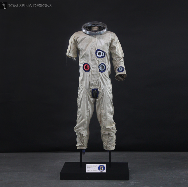

This is a display by Tom Spina Desigins that is similar to my idea:
www.tomspinadesigns.com
Custom Mannequin for an original Gus Grissom NASA Spacesuit - Tom Spina Designs
Custom Display for an original NASA Spacesuit worn by astronaut Gus Grissom during Project Gemini training.
