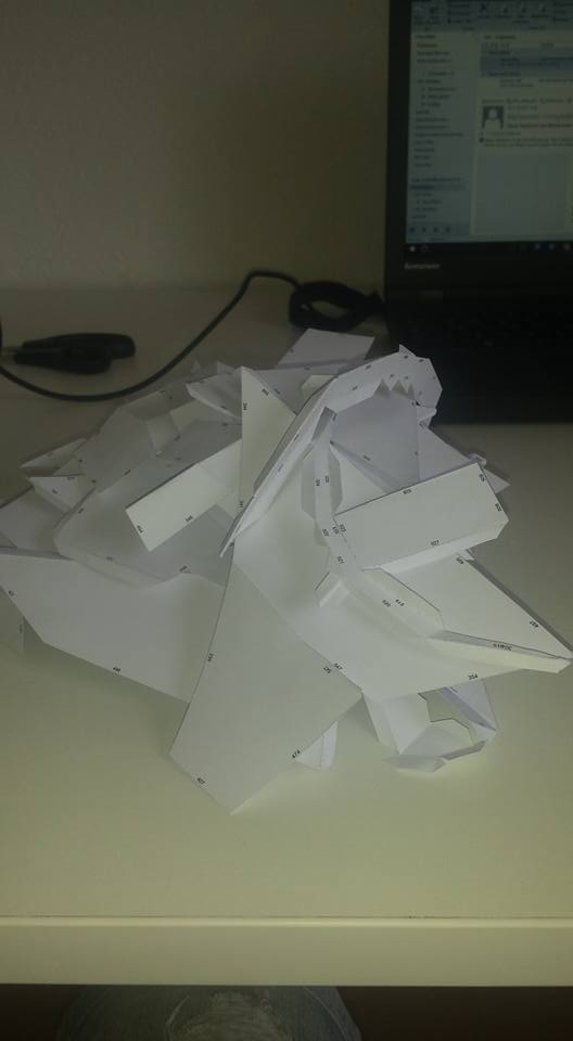

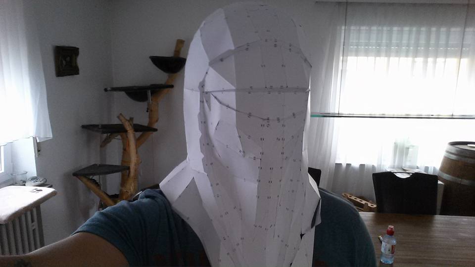

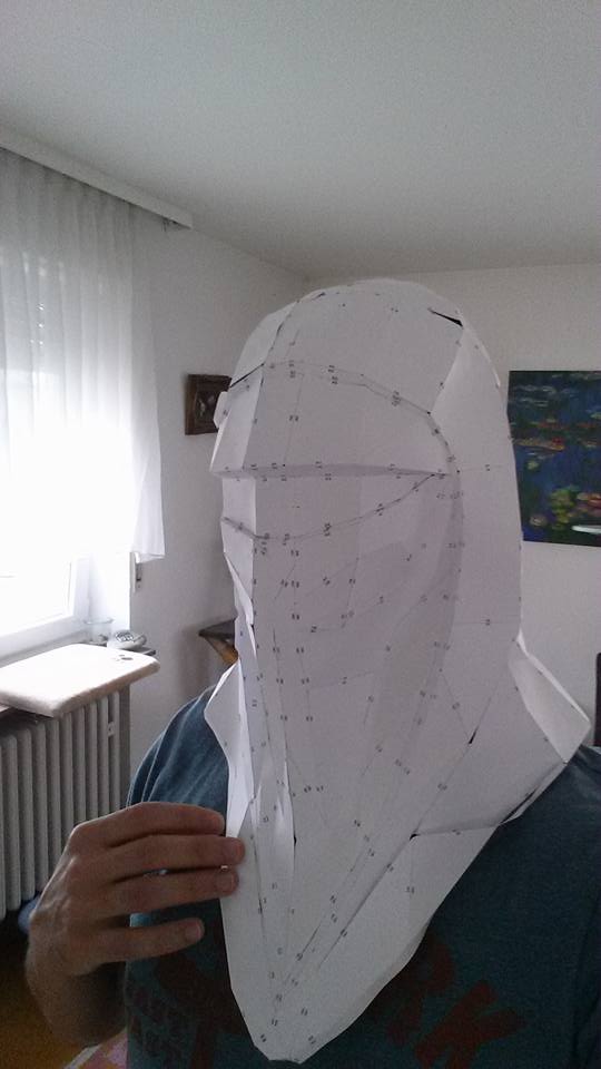

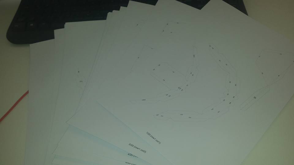

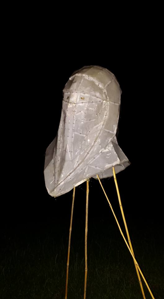

The cutting was done within a few hours.
The glueing was done within just one night. I sat there for about 8 hours, nonstop. My wife came downstairs in the middle of the night, wondering what I was doing
View attachment 749520View attachment 749521View attachment 749522
As seen previously, I used braces right aftere the pepakura part, which made life much easier and gave much more symetrical result for the resin part.

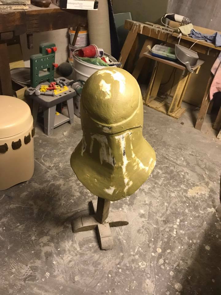

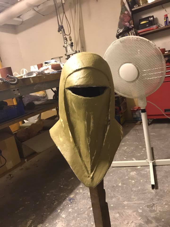

I have no pictures of the bondoing part... after all it is "same same but different".
But for the first time I used Plasti-Paste or Puddy or whatever you wand to call it. It wasn't bad at all but I should have put more effort into the previous stage and only used this to do minor things... not everything with it.
View attachment 749525View attachment 749526View attachment 749527View attachment 749528

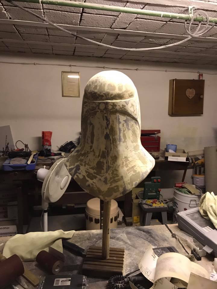

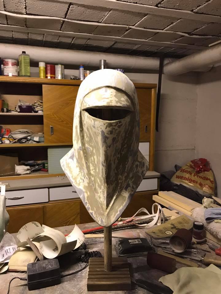

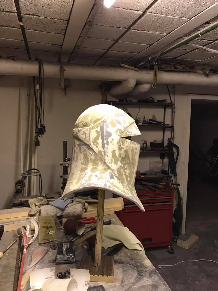

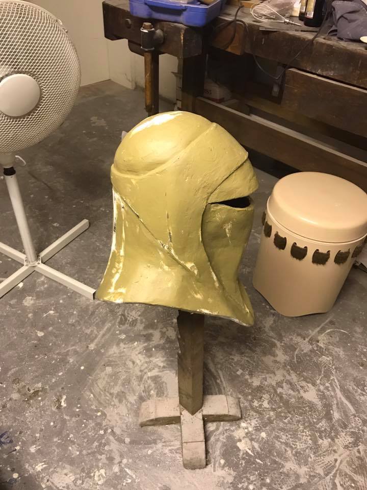

Some more sanding and filling.
View attachment 749532View attachment 749531View attachment 749530View attachment 749533

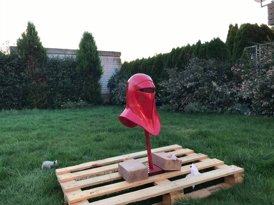

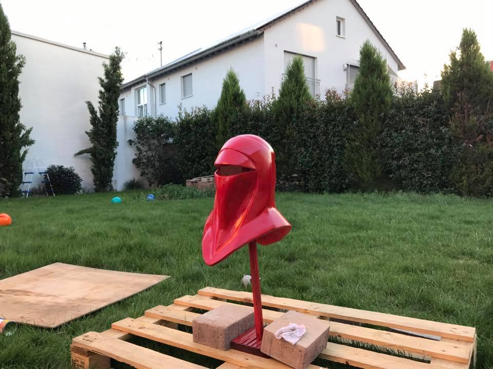

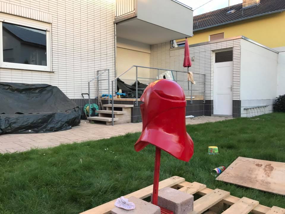

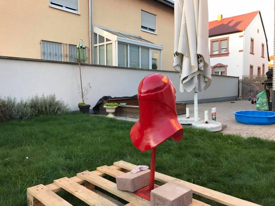

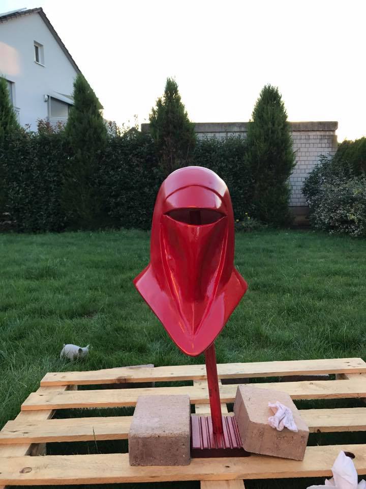

2 layers of red spray paint., sorry did I write layers? I meant CANS. Damn stuff.... This color didn't cover anything. It was horbale. I did prime it in advance, but hat to sand so much of that there was hardly any primer left. Therefor all the dark spots where shining through
View attachment 749537View attachment 749536View attachment 749535View attachment 749534View attachment 749538
