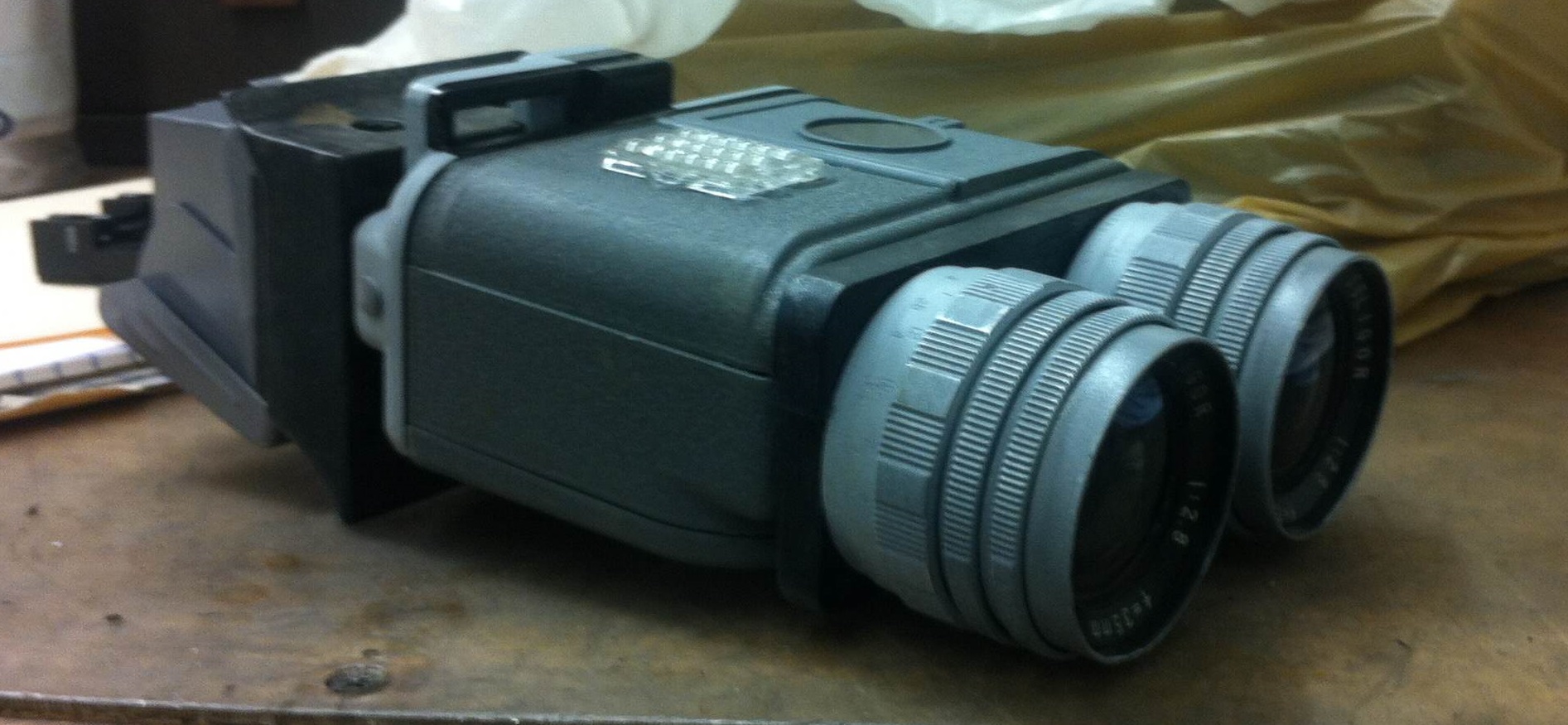

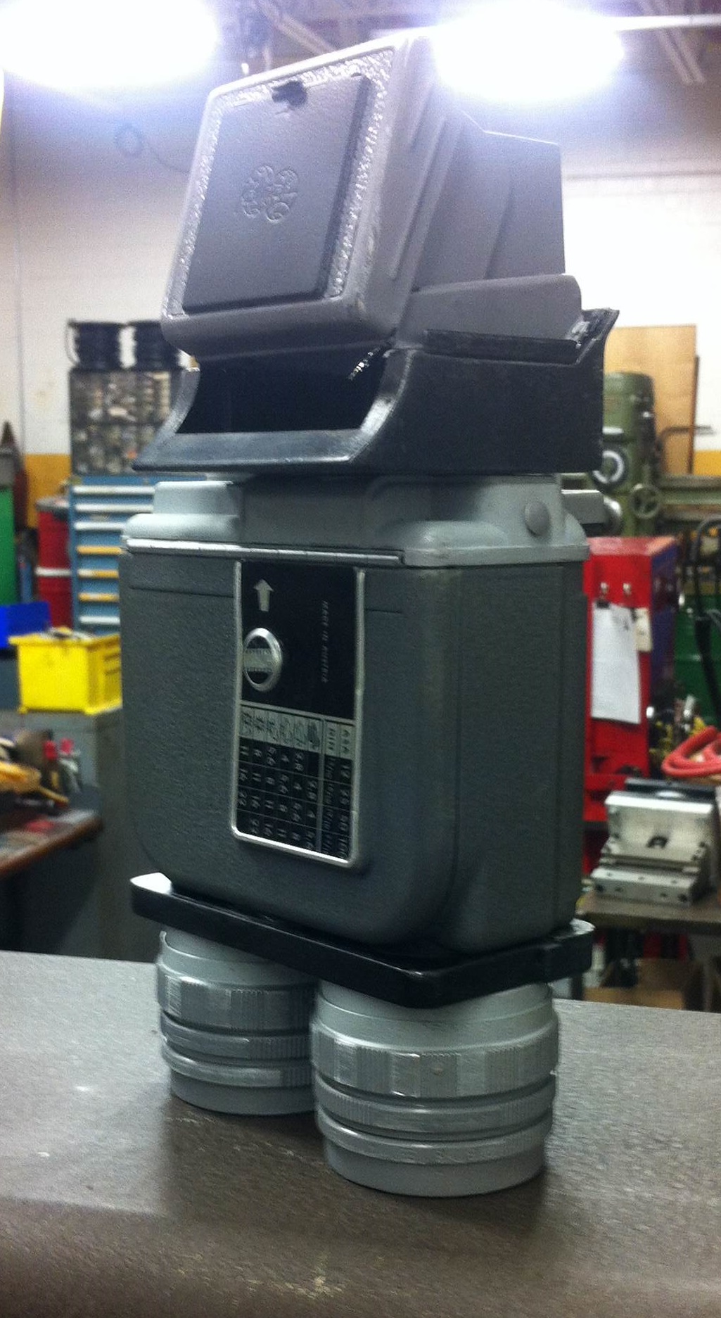

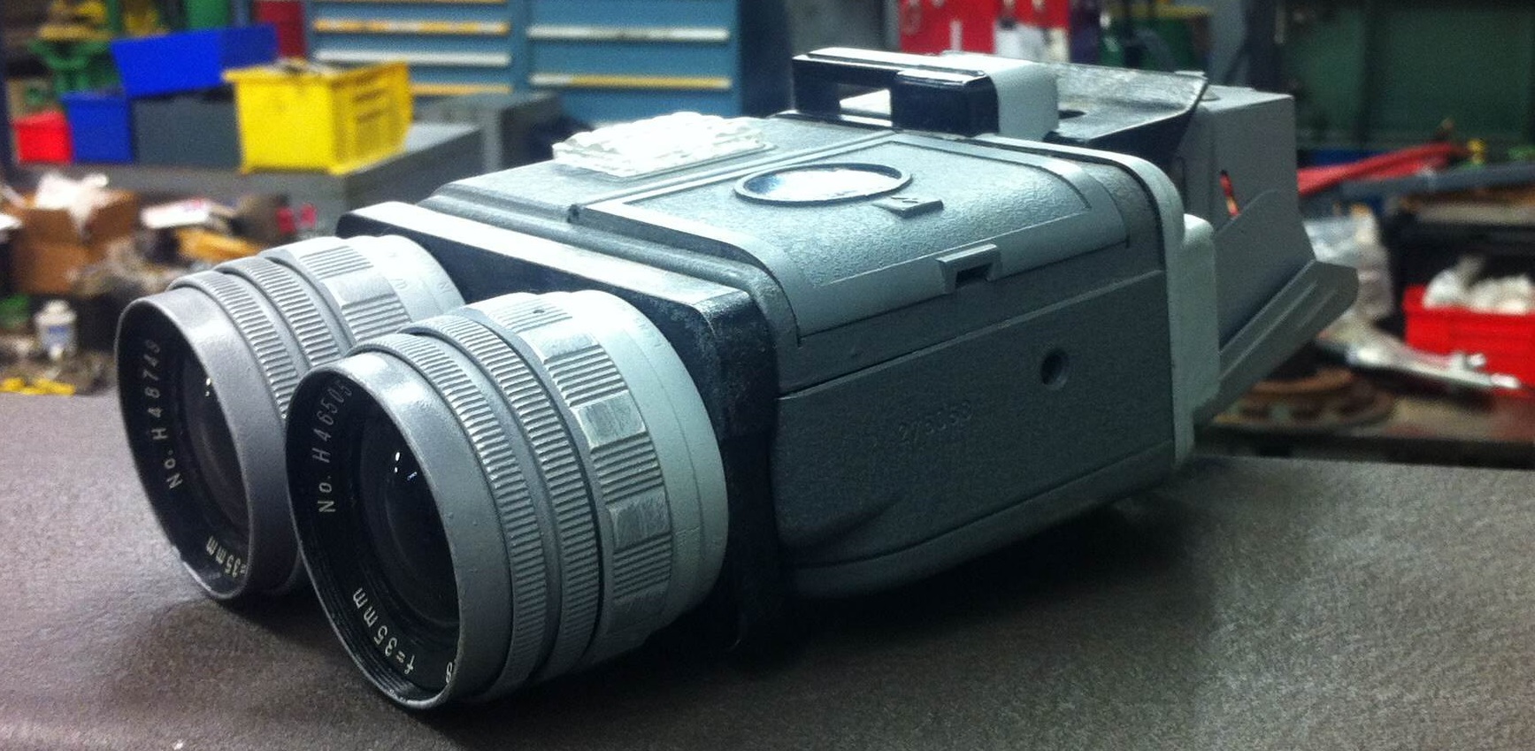

I'm building a set of Luke's ANH Macros. It's obviously not finished yet. But, can anyone spot what makes this build a little different
ya, no knobs, side boxes, triangle, belt clip.
but has an open transition box :( and the lens plate is upside down :lol
and you used soligor lens'
Good eye. :lol I doctored up an Electromatic, a Kalimar reflex, and some Soligor lenses to see if I could get them to look the part
darn nice work sir !!!
those soligor lens are a great close match. what colors did you use on those?
if you ever want to do another one, I have molds for the face plate and all the parts so you wont have to go through all that work :) but then you would not have the satisfaction of what you crafted either :)
great job !!
Thanks.
For the Electromatic, I 3d printed a door that would replace the roll top, I then painted that with some textured paint to try and get the right look. I also printed an ad on part to make the face plate look a little closer. Then I sand blasted the face plate smooth and repainted the whole thing to get the colors to match.
For the Lenses, I just used the rustoleum primer that was in the cupboard at the shop. But, before I painted them, I sand blasted off the black coating, so that after painting them I could weather away the paint and show some aluminum.
I kinda wanted to see how close I could get on a budget build without spending money on the correct parts
