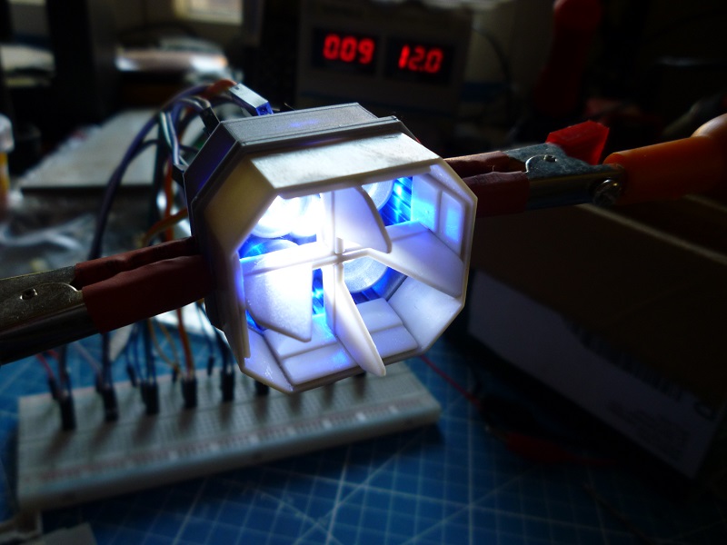

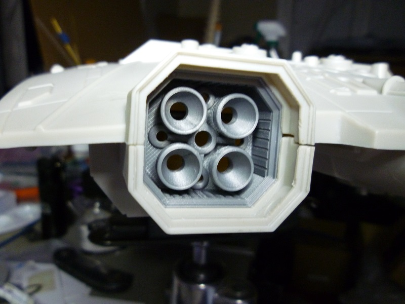

Here are a few pics of my engine work and one of the crew heads. It only has one fiber in this photo. There will be three fibers per head.
  • P1010693.mp4
    947.5 KB
