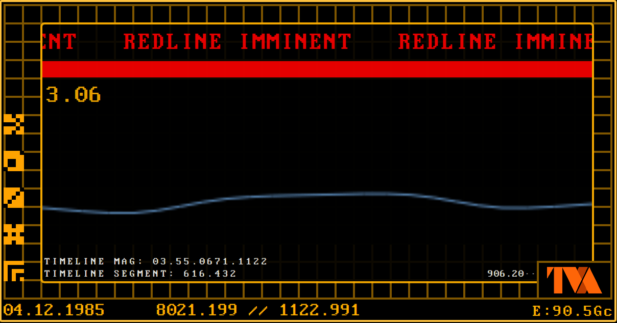

I'm working on the UI software here: jherico/LokiTemPad
So far I've got a number of elements working as seen from this gif capture:
