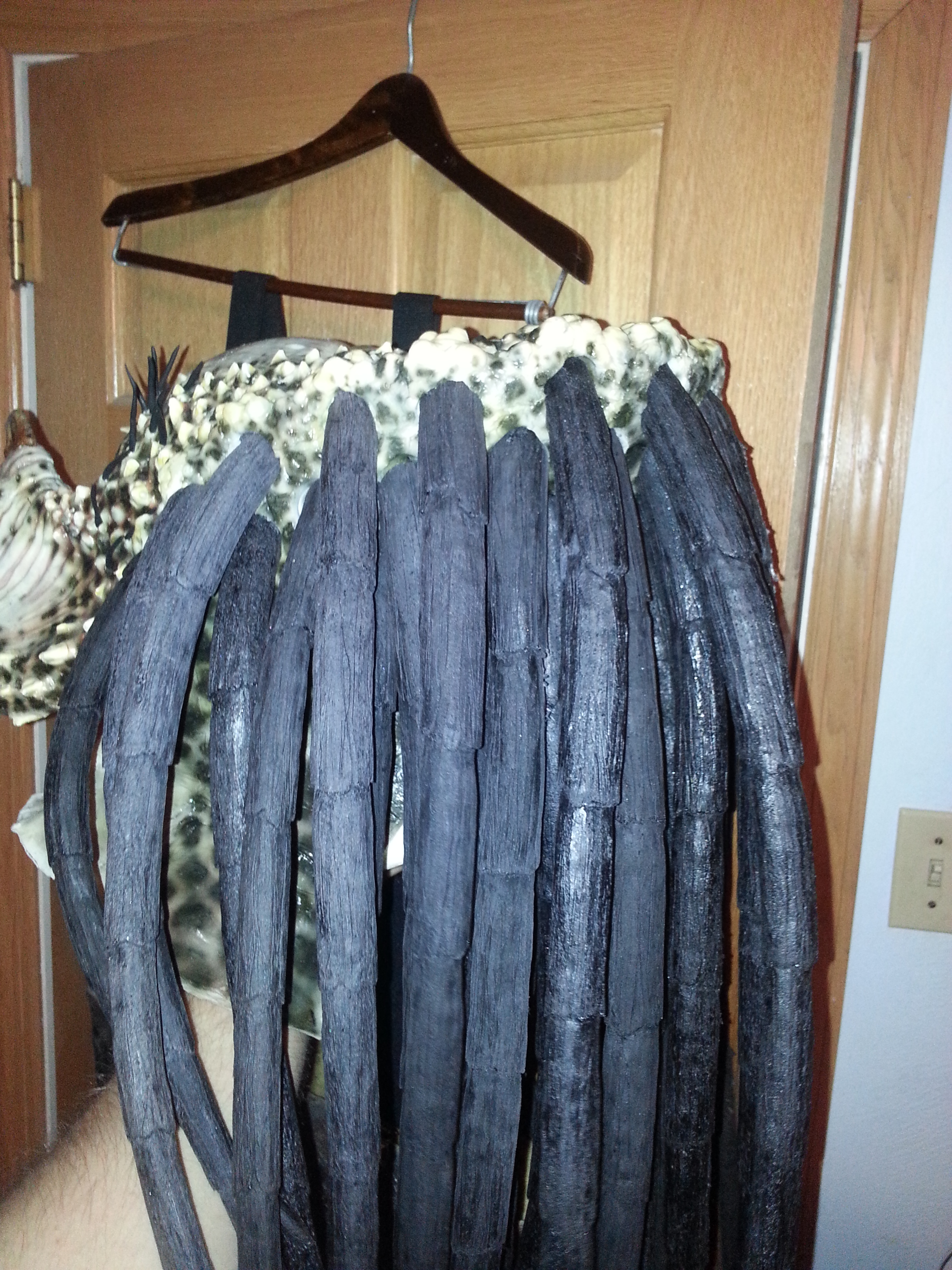

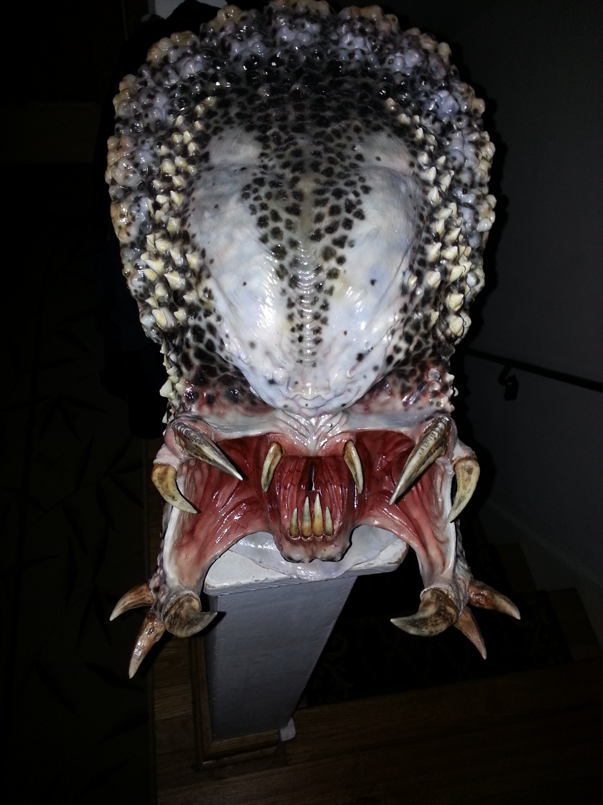

Well here I go again. Got most of a predator costume done and here is what is done.
The mask is from skunk and also painted by him too. Insanely cool paint job. Thanks again mate.
Feet are from seahunter.
The rest of the skin and armor is from Mannowar. (Stop taking my money man!)
The skins were painted by Neokazama. Thanks again chris. Your paintjob on the skins are top notch. Hope to be half as good as you one day bud. :) And props on the name man!
The armor I painted myself. I still want to paint the tips of the dreadlocks so I'll be attaching them once I have that done.
The paint on that mask is incredible! Easily one of the best I've seen.

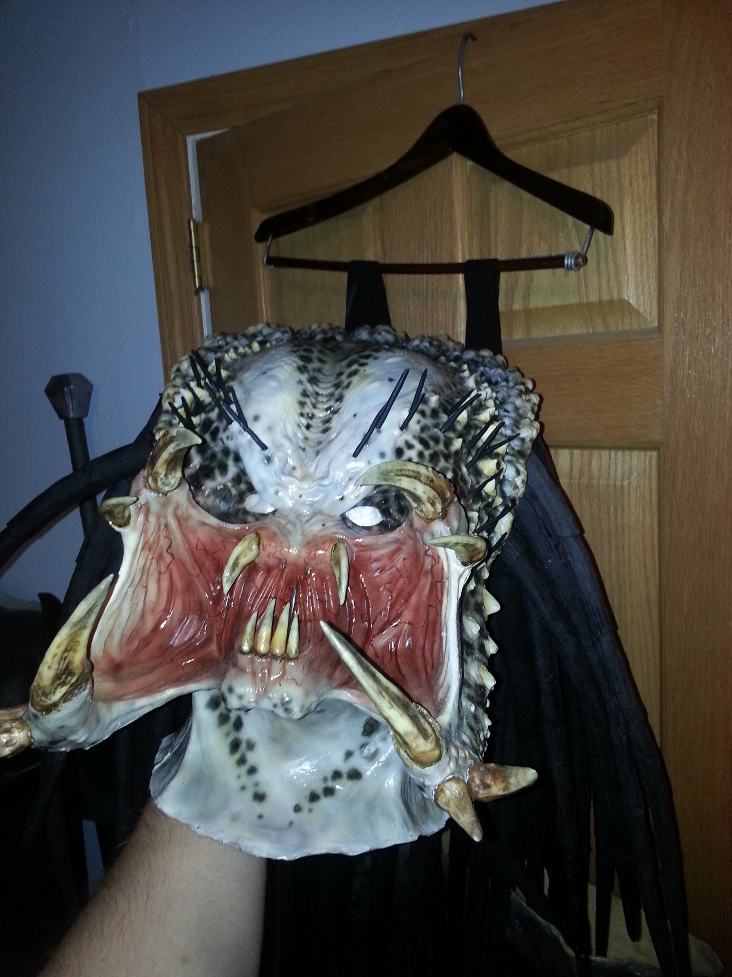

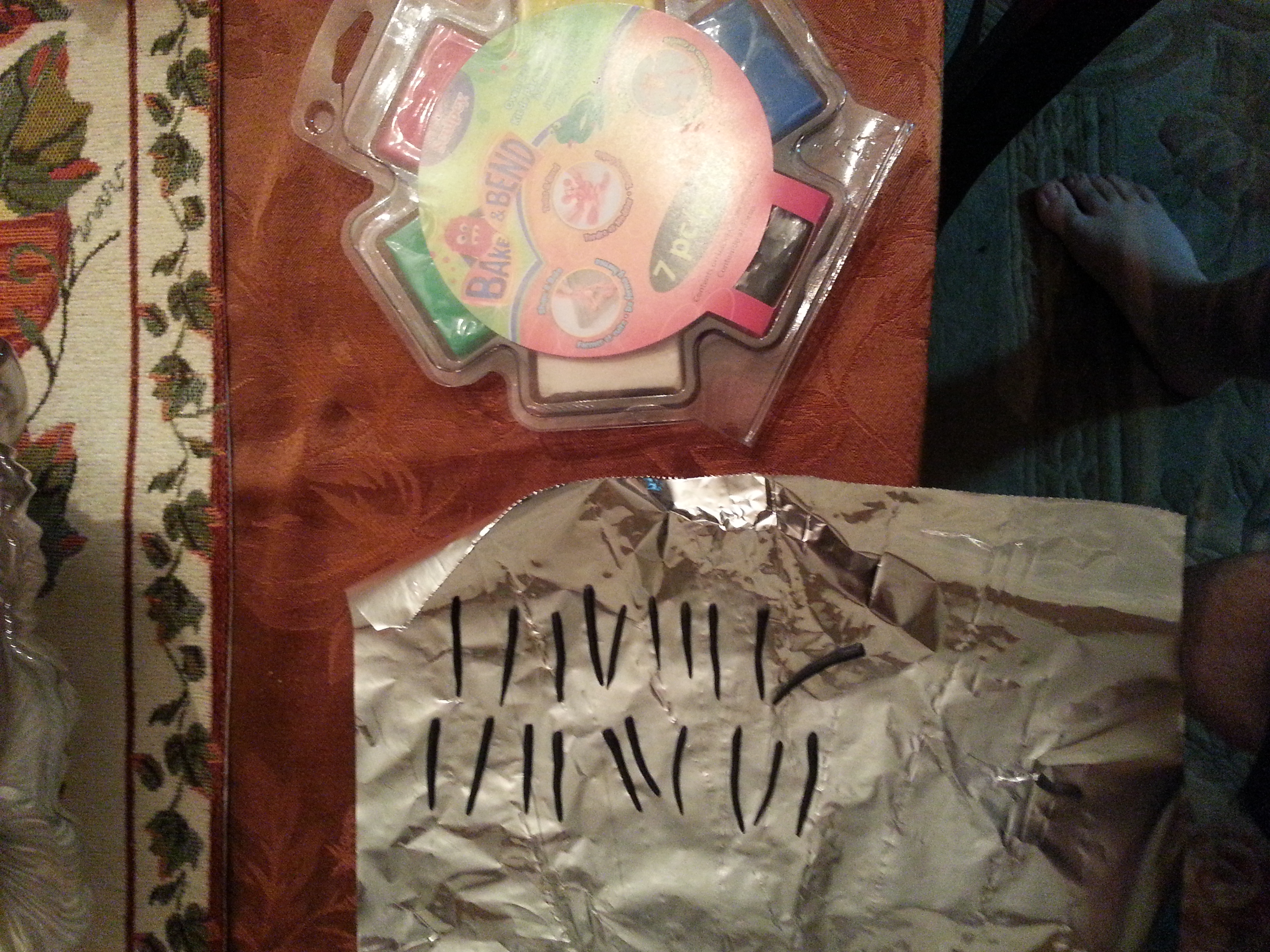

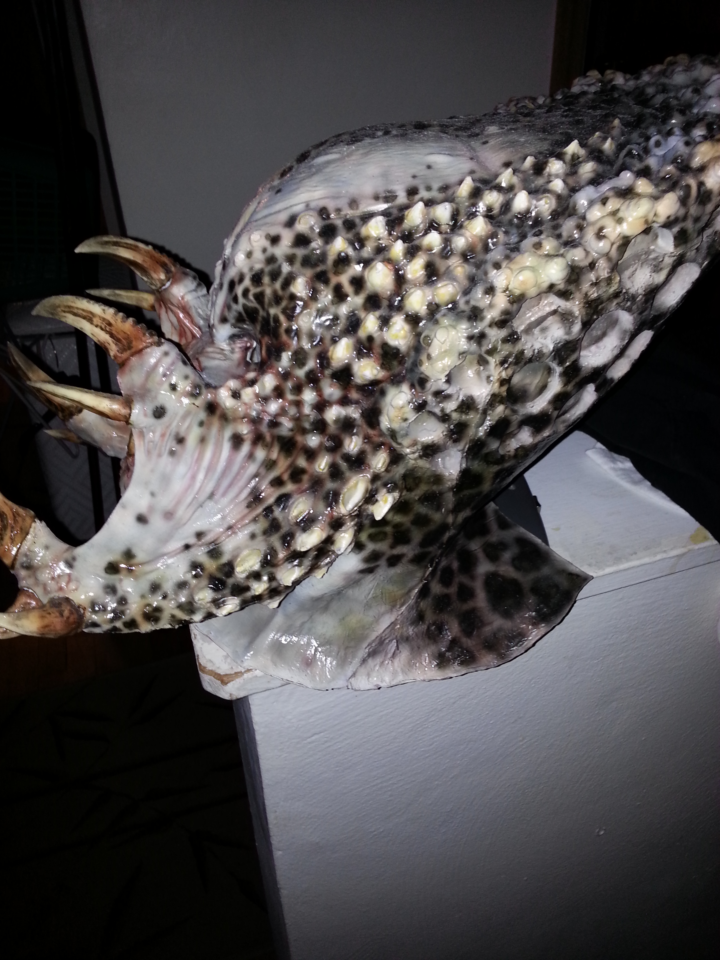

I have an update on the mask. I Made some quills using bake and bend clay. Works very well and is fairly cheap. I started with 20 to see how far that would take me. I quickly noticed it was not going to be anywhere near enough. So I made a second batch of 30. I only have the brows covered. For some odd reason I was having trouble getting some of the quills to stick with super glue. So I just stopped for the night. I still have the lower mandibles and chin to cover. And I got the dreads glued on.
These pictures are honestly pretty bad as I don't have a head piece to display the mask properly. So I'm trying to hold it out with my hand and take pictures. Will update with better shots when I'm wearing it.

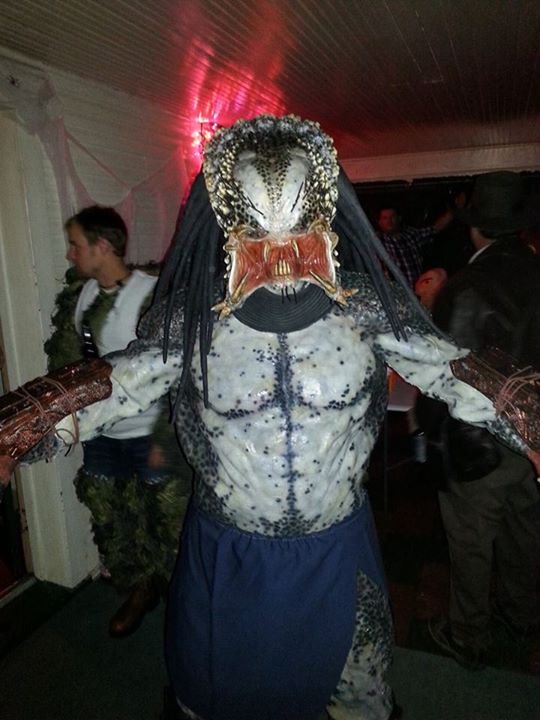

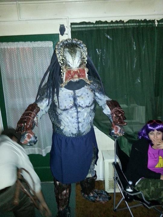

Attached a few pictures from halloween. It's not finished, but a friend of mine on the Lair convinced me you guys would like to see it.

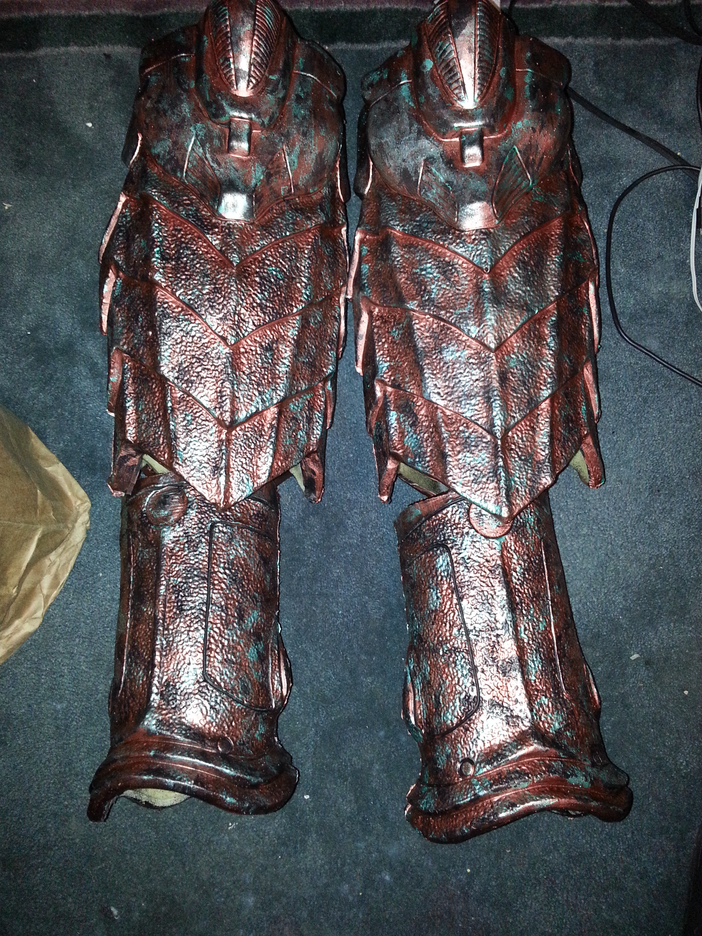

I do want to point out that the I'm only wearing the tops of the gauntlets as they don't fit over the skin. What do you guys normally do if you run into this problem? I was considering adding elastic bands to them so it would be move like the Berserker styled gauntlets that didn't have bottoms.
