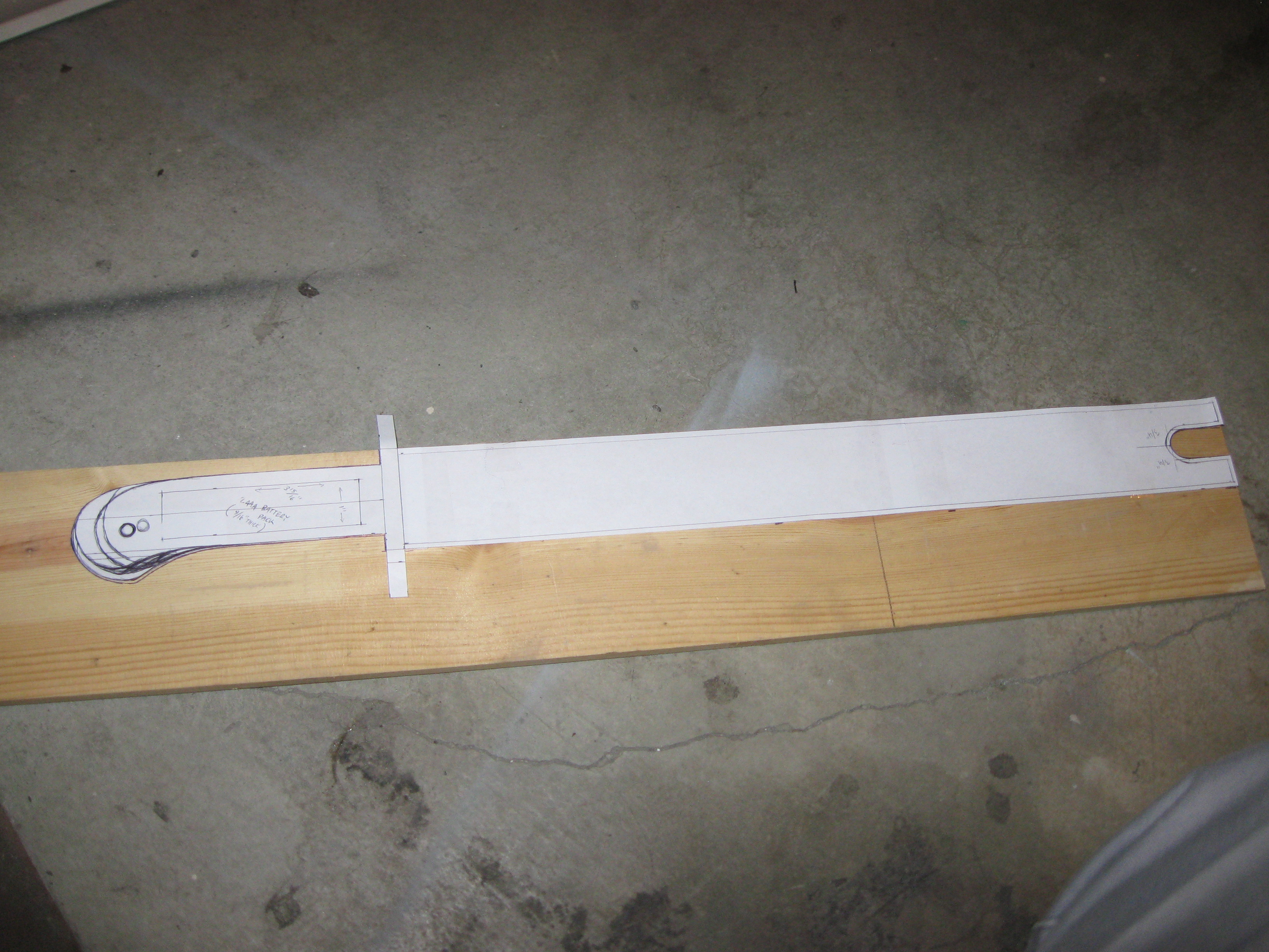

The proportions change for the sword in every frame (yay for cartoons!) so I had a bit of wiggle room on sizing it, but I did grab a shot here he holds it against his chest sort of and I scaled it roughly according to his arm length from wrist to elbow. I ended up lengthening up the blade a bit because once I saw the scale of it in real life it just looked too short. ( I settled on a full length of roughly 25.5" with a 19" blade)
Anyways, made up some blueprints and transferred them to a thin wood sheet I had. The grip will be wrapped with leather to thicken it up. Then I went to town with my jigsaw.
There will be a left and right grip that will sandwich the center and I'm going to round them considerably to keep the thickness to a comfortable amount. Also one side of the grip will be open with a slot in it because I'm mounting a battery pack and inverter into it so that I can mount EL wire into a grove that will run all the way around the edge of the blade! I'm just waiting on the EL wire and battery pack so that I can double check it's dimensions then I'll cut out the slot in the center and one of the side grips. I'm thinking I might stain the grips instead of painting them for more of a real world version of the sword. The leather wrap will velcro together to cover the slot on the one side.

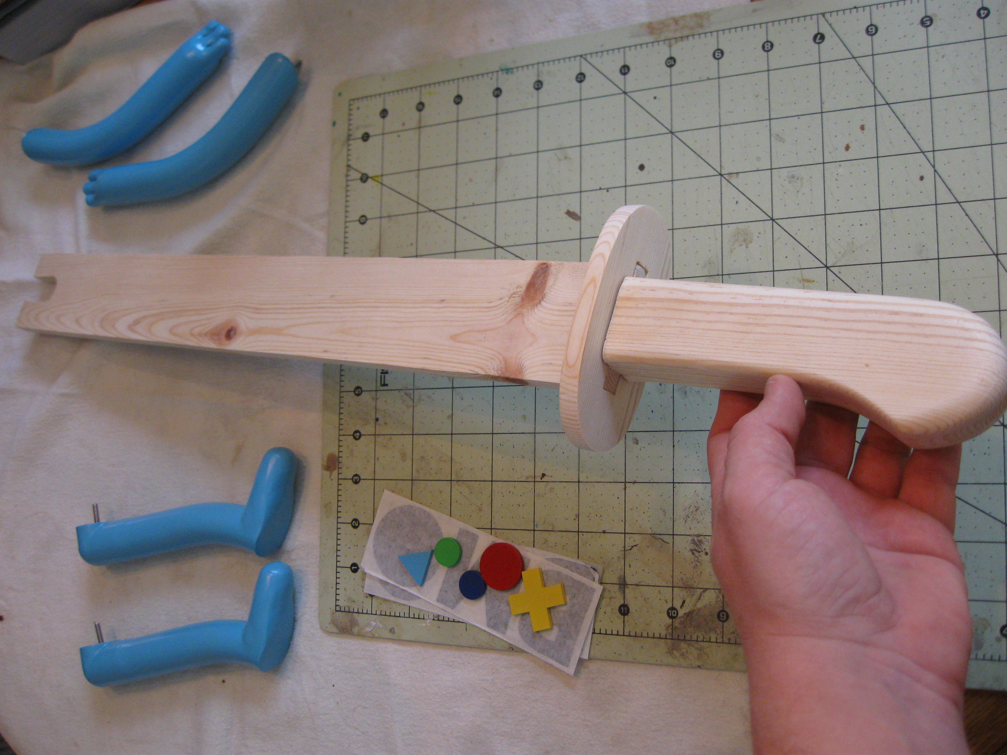

It was not fun making room in the grip for everything but I managed it! I know the grip looks really chunky but, I will be sanding and rounding quite a bit of the material off. It's just what I had on hand. Also I will be recessing the wire into the blade 3/4 of the way and it will be bent into the shape at the tip of the sword.
I had a chance to finalize the way I would run the EL through the handle/blade and I started shaping the handle some and worked on the crossguard (sorry, don't know the official names of the sword parts). I might shave the crossguard down a bit as it looks kind of big.

Yup, Ultraman's right. My yellow EL wire came in today. I got impatient and tried to rush cutting the groove that the wire will sit in....so I did some bondo work as well today. I've decided to just wait till monday on this project when I can run the blade through the table saw and get a nice straight groove cut into it. I think I might just paint the blade and once I find a good source for affordable brass sheeting I'll upgrade it.

Thanks! I was able to make a mount and run the sword through the table saw at work and get a really nice groove in the blade. I've been busy with some other projects but I haven't forgotten about the sword, I promise! Hehe. I still need to put a groove in the recessed part at the tip of the blade, which I'll have to do with a router or a dremel. I'll get some new pics up soon of the sword in it's current state though.
