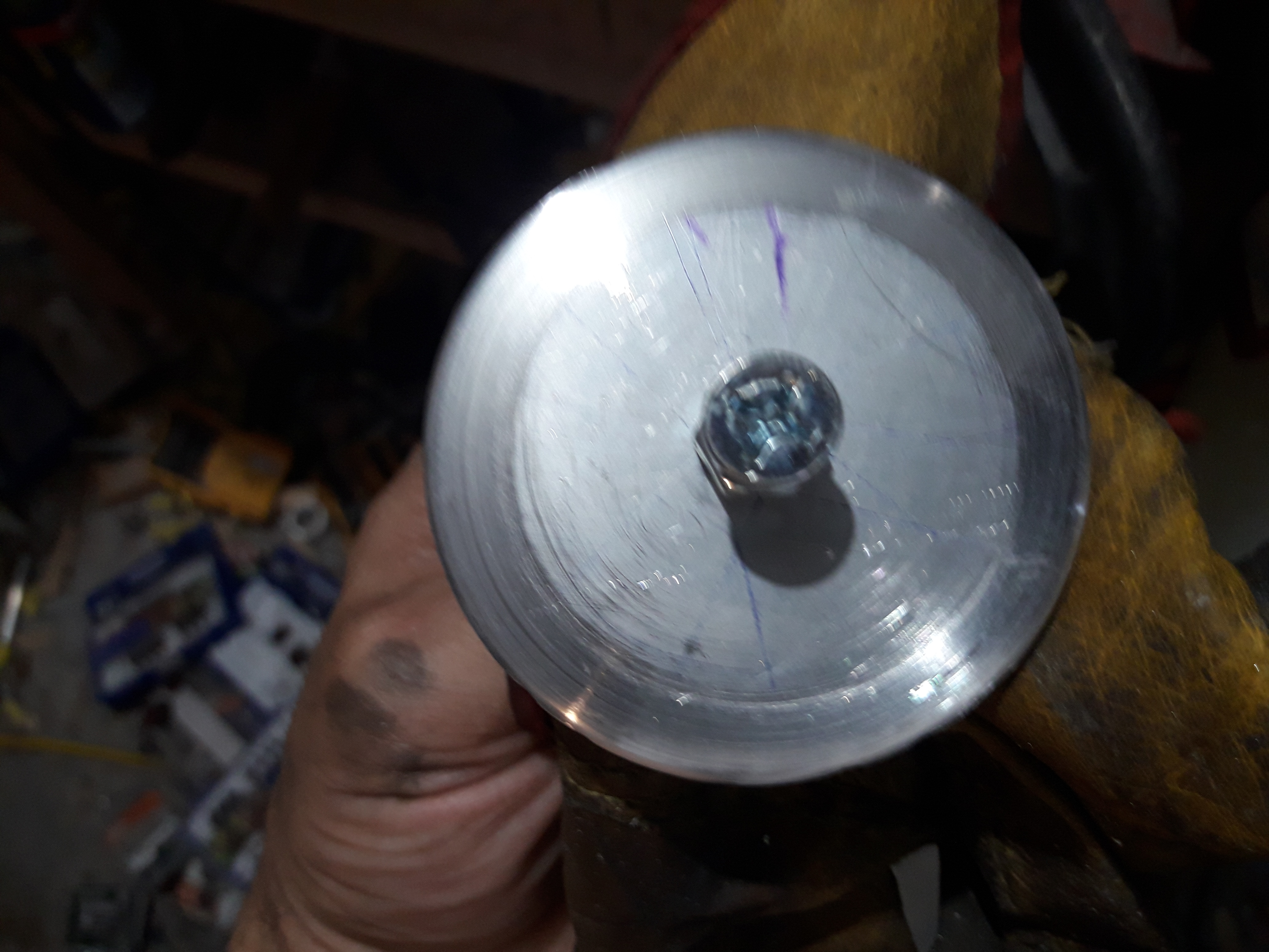

It starts with a 1/4" thickness aluminum and fun with hole saws. Figure out the side thingy patter you like.
The then drilled 1/8" holes into where the side thingys would be. Then attached the plate to a drill press and used a file to round to edges.
Next, a band saw to cut the pattern into the round plate. Since it was roughly filed, I now have great circular guides.

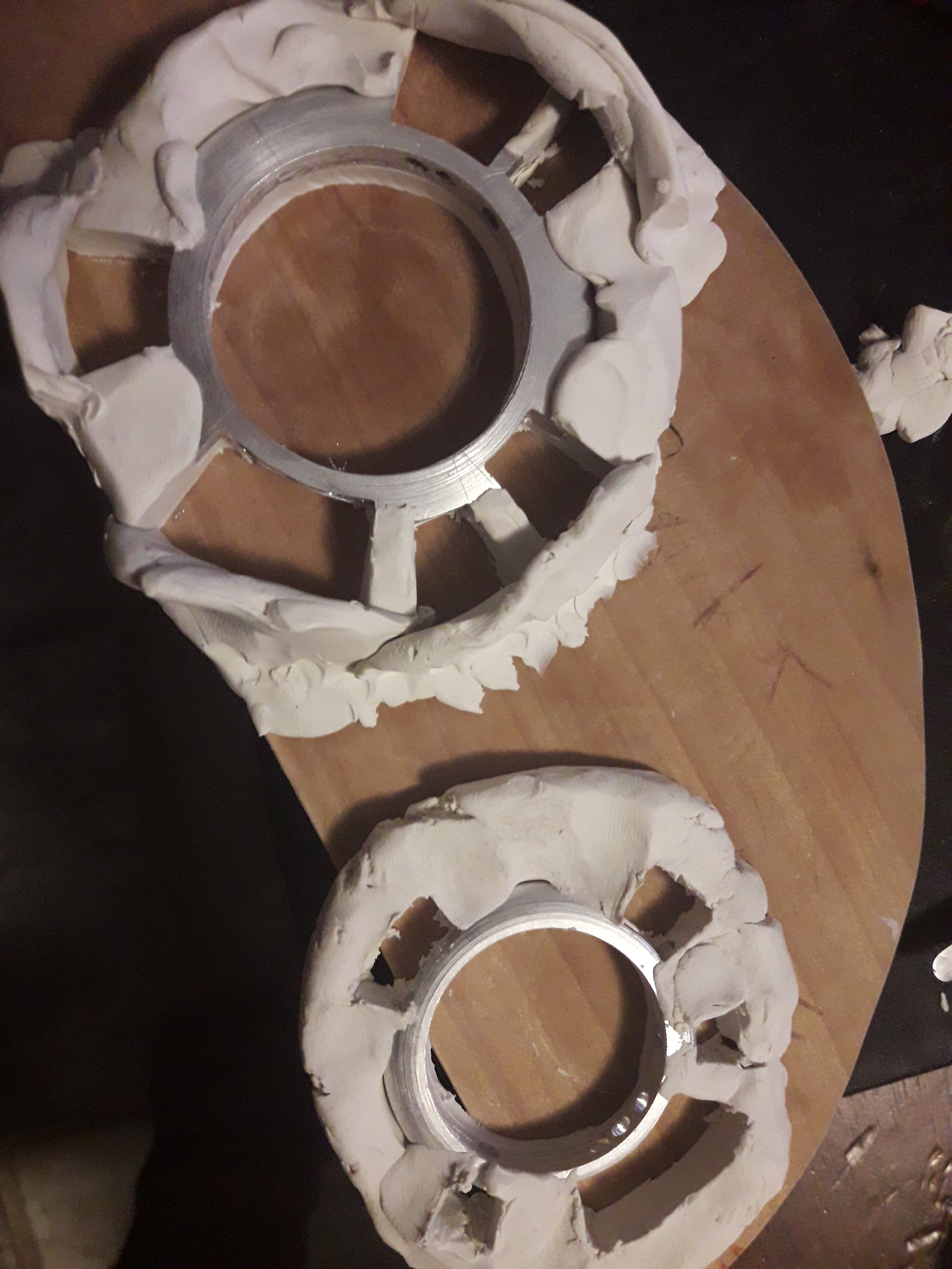

Next, use clay to make a moat to hold resin for the side thingys.
Fill with resin mixed with some glow-in-the-dark powder.
