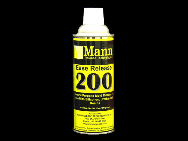

Ok, in my experience, I havent had much stick to plastic like that but in the case of the latex I would recommend that you err on the side of caution. A light dusting of a spray on mold release before you apply the latex should do ya fine. :)

I couldn't find the Mann's product shown above, but managed to get some of this
I did two coats of release, and let fully dry, now the latex is in there, and I gobbed her on thick. We'll see how she comes out after the drying. I'll post more progress pics as I get them. Thanks for the advice folks.

Most release contain agents that will expedite the breakdown of the latex. Simpler and more cost effective solution. Brush a very thin coat of baby powder into the mold befor brushing in the latex. as for faster curing, a heat gun is what I use... Of course your mold is plastic so it would be a bad idea. Thin coats evenly applied between curing will build you a nice durable skin... Powder the topside befor removing it from the plastic... That way your fresh latex won't stick to itself
Wd40 will kill your latex... And honestly vasaline rakes away from the integrity of the sculpt... Seriously.. Baby powder... I run latex everyday... Just try it
Anything oil based will destroy latex in short order. Don't you guys read the warnings on the condoms packets? :( The baby powder is a great idea.
