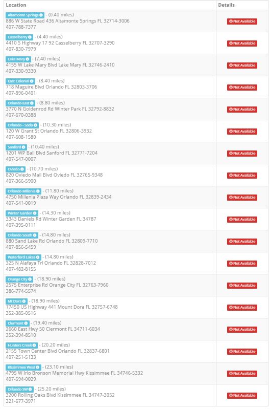

For something that is starting at $80, not quite sure i want to spend double on that (on Amazon).
Just yet.
I found one of these today in Birmingham, AL, at a store called Bargain Hunt. It's apparently a chain where they resale a lot of returned items from Amazon and other places. The box was beaten to death, but the helmet is perfectly fine. I wound up paying just $50 for it.

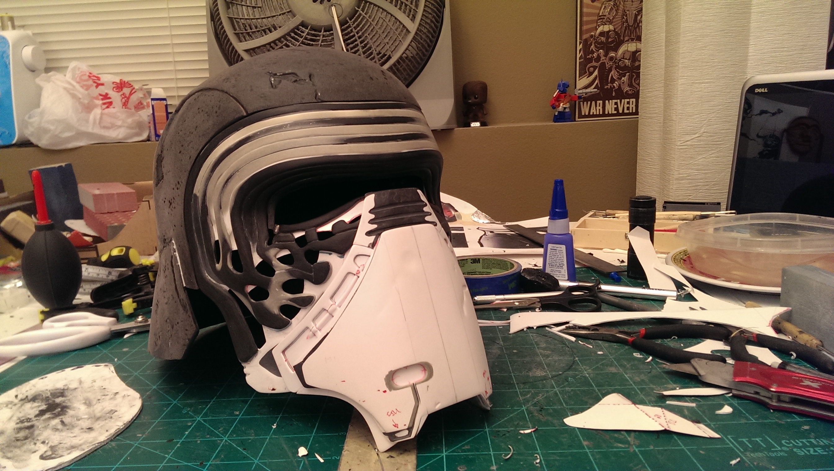

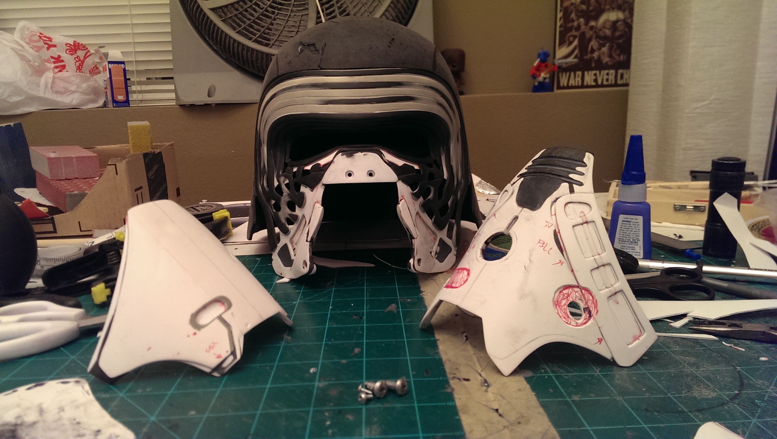

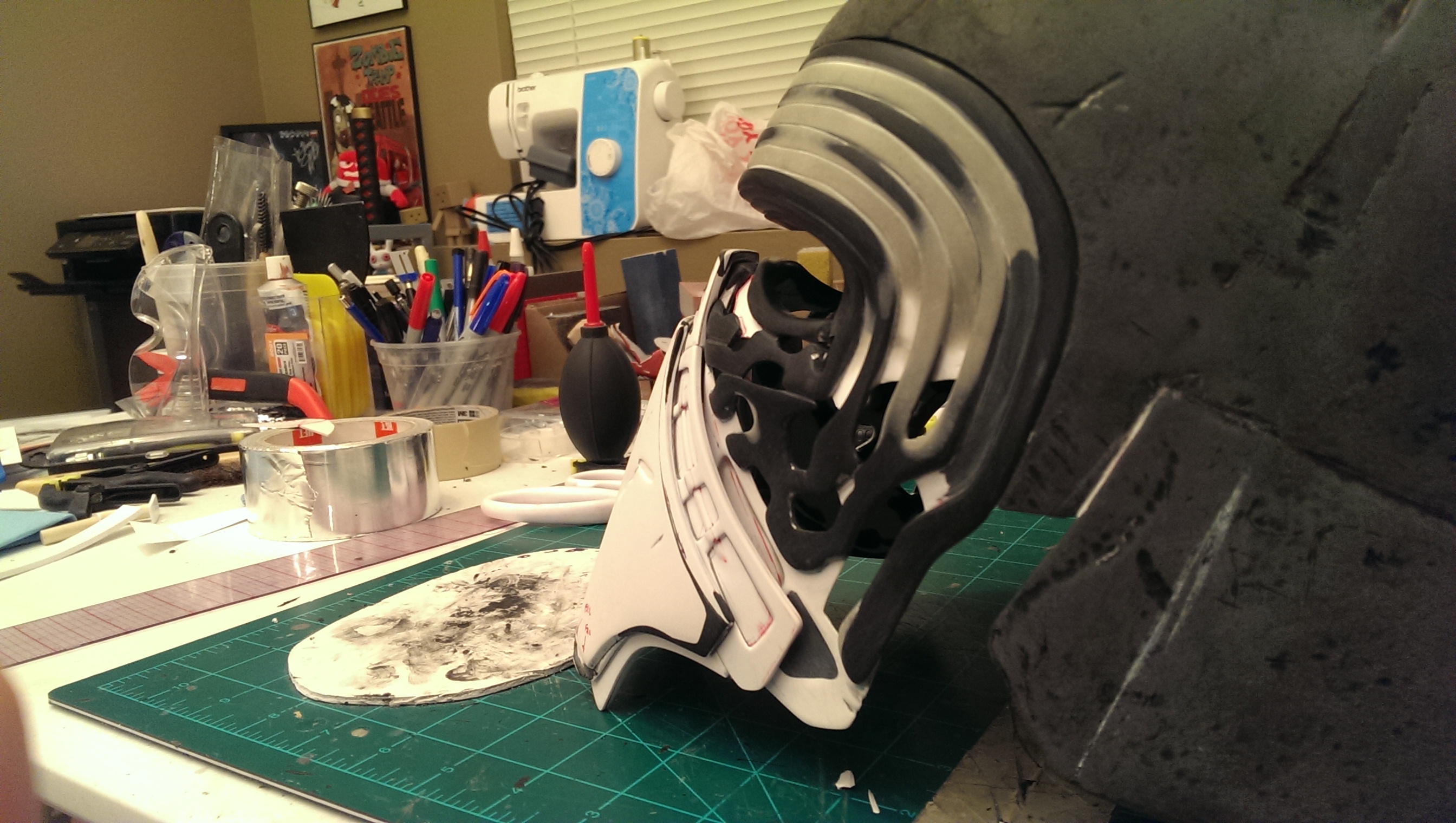

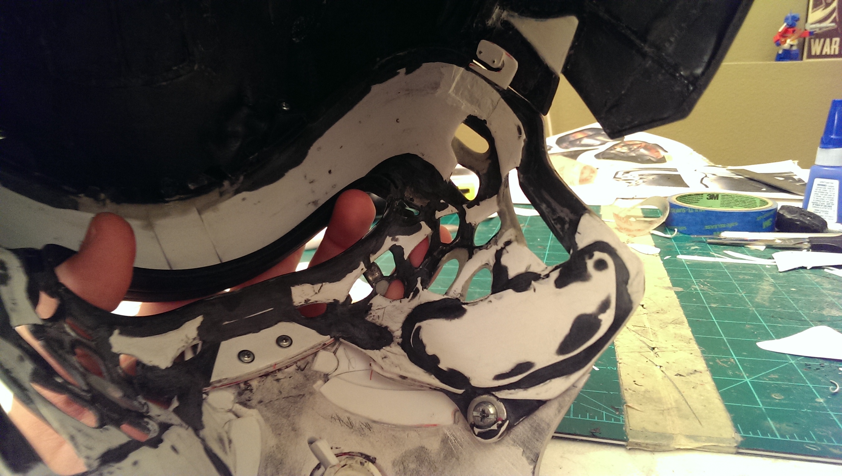

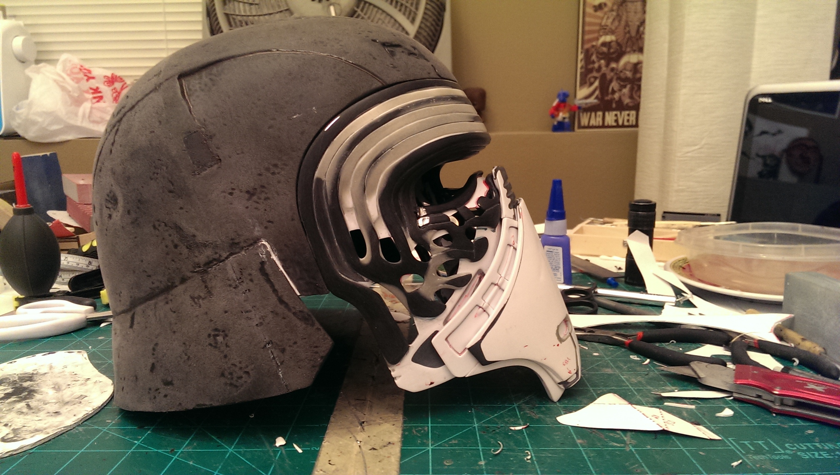

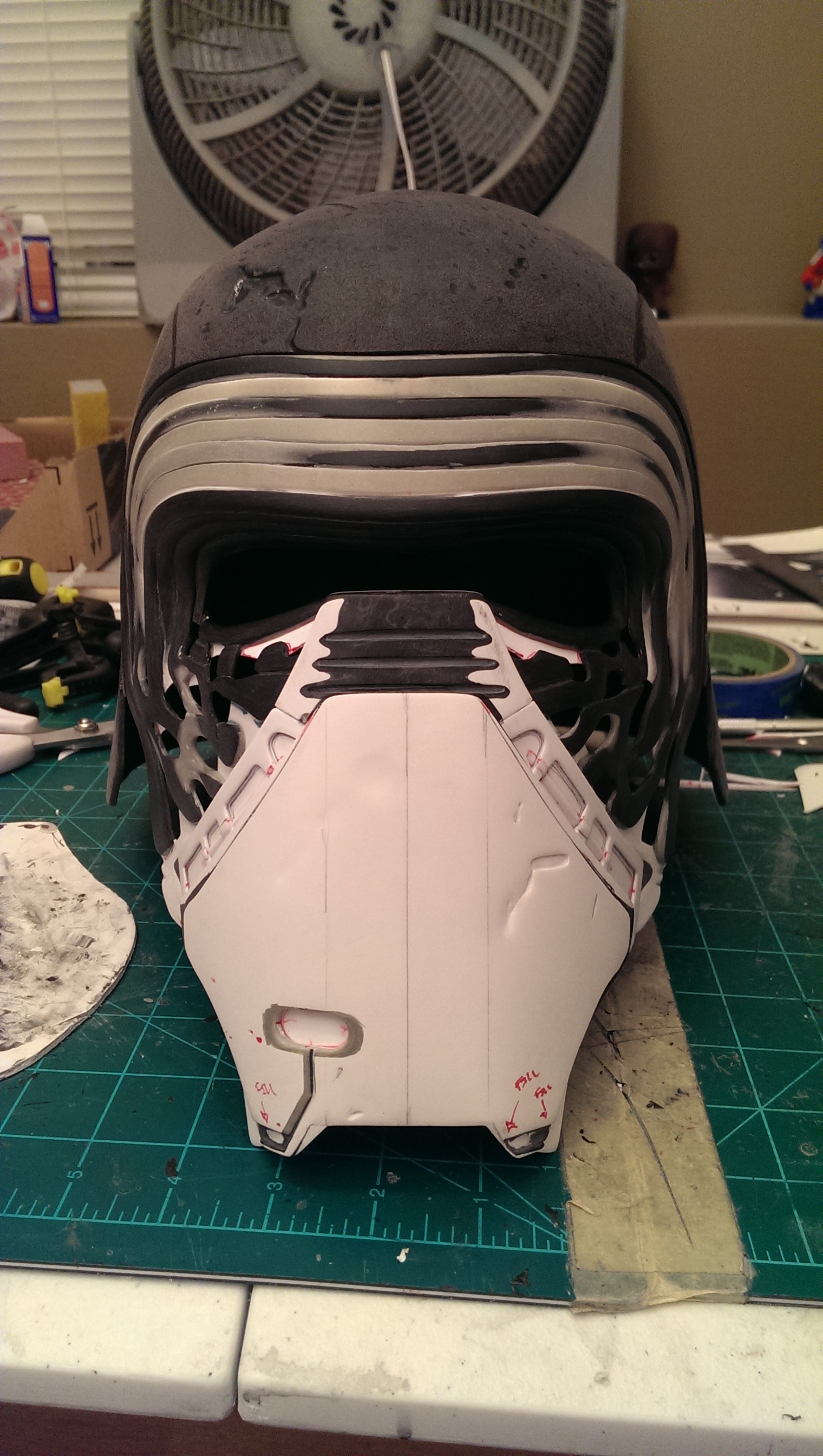

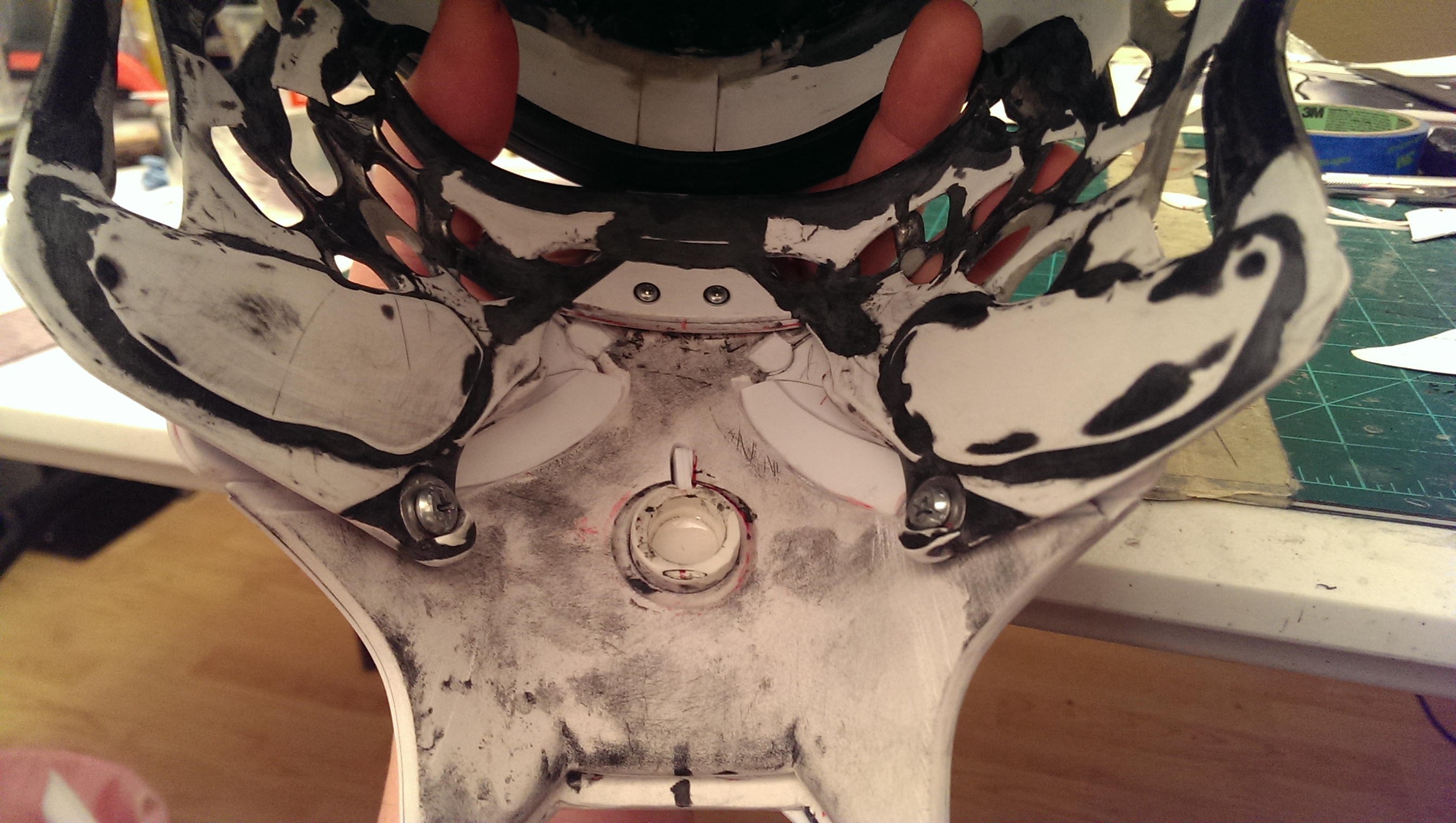

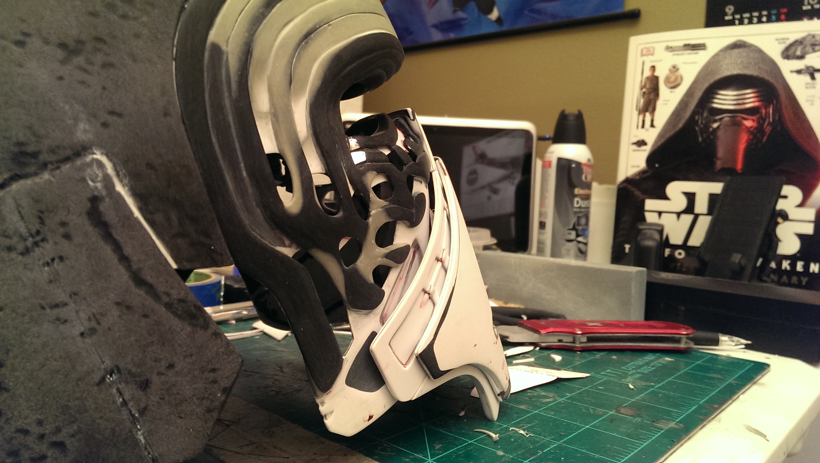

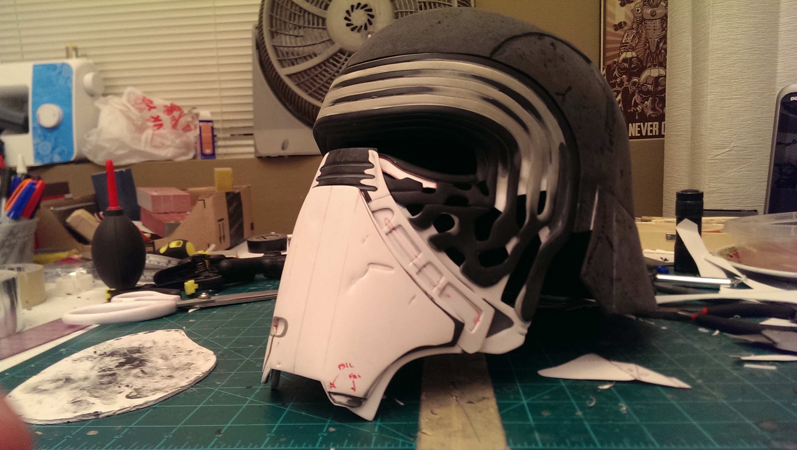

Figured I'd post in here since this thread is what got me wanting to the mod the BS helmet. Using the overall dimensions I decided to just remake most of it. I've got a lot more to do, most of the pieces pictured need fillets and filler before primer can even be considered, but I think it's starting to really take shape and I'm pretty excited to finally be able to wear it. Some of the pieces are pretty pieced together as well because initially I was just going to make it a bit more accurate than the BS helmet but gradually made it more accurate as the build went on.
My helmet will maintain it's ability to be taken apart as well, at least the grille/mouth pieces.
View attachment 579430View attachment 579431View attachment 579432View attachment 579433View attachment 579434View attachment 579435View attachment 579436View attachment 579437View attachment 579438
You just using white ABS to build it up?
Pretty much. White parts are a mix of styrene and sintra. Mixed just because I'm getting rid of leftovers from other builds. All the grey and some of the black areas are Apoxie Sculpt.
Nice to see someone else using exoxy sculpt, if you have any artistic ability you can fix any mistake and make anything alot more detailed and precise.

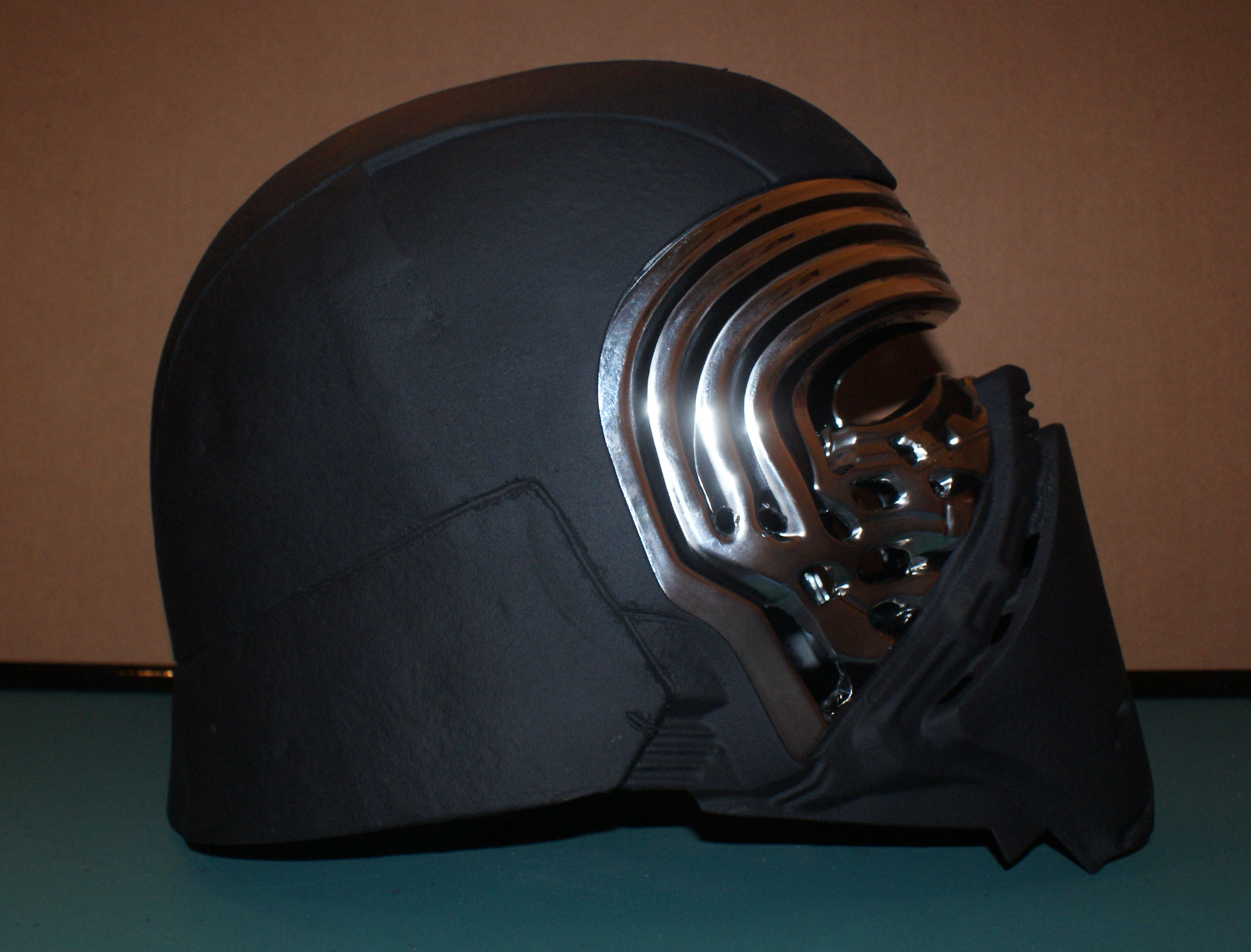

I'll throw mine up here rather than make a whole thread for it. Plastic welding with a Wood Burning Tool and a Soldering Iron, Krylon "Granite" Texture paint and then a matte black. Not super thrilled with the Matte black, I feel it should be a little glossier? What paints have you guys used?

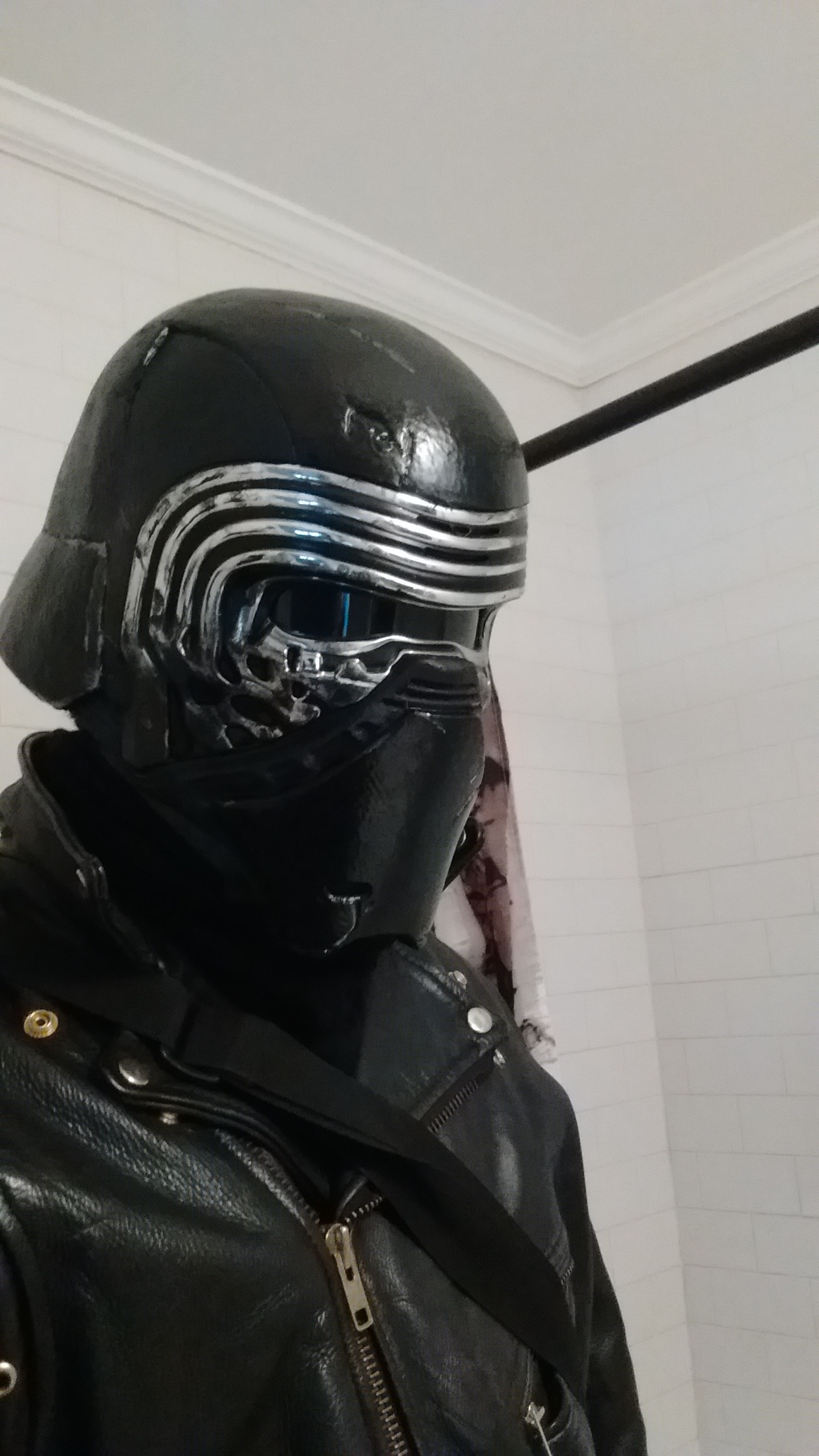

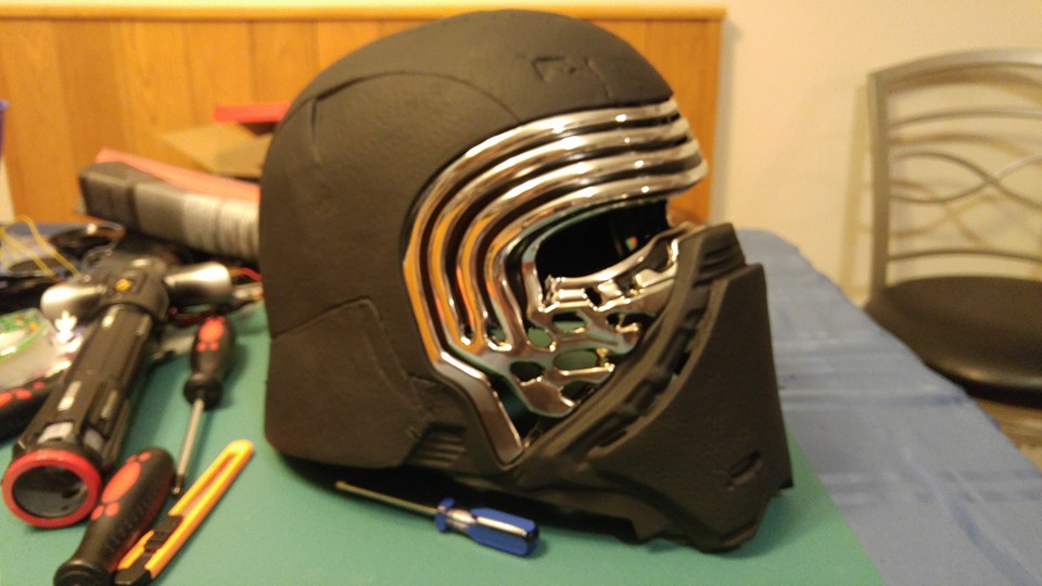

OK finished paint, other than details. Here are some pics I used krylon plastic fusion and krylon maxx cover primer. Wet sanded with 330&800 before painting. Disney snout. Screen over visor, cheek holes drilled out. I like how it looks. I'm very surprised by the results. So far
