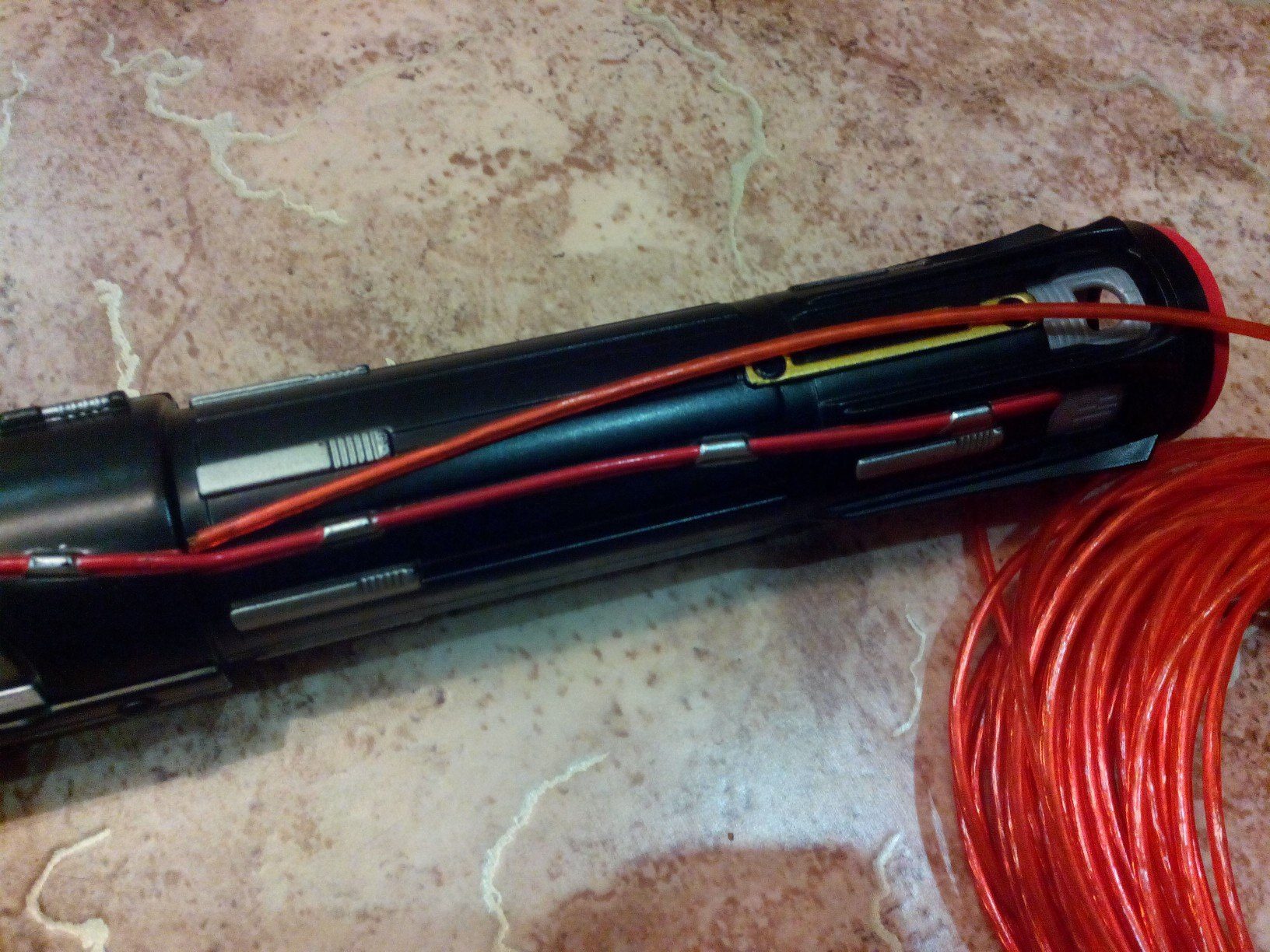

But the wire is a tranparent red.Its also wrong on the Force FX saber.
Good work man!:):thumbsup
Thanks!
I know the wire isn't 100% accurate unfortunately. I had tried searching for a more accurate one but didn't have much luck in the gauge I needed to fit the Lego hands I used to secure it.
The one I have for now will do. Because of the Lego hands it's easily removable so if I find a better one in the future I can swap it out!

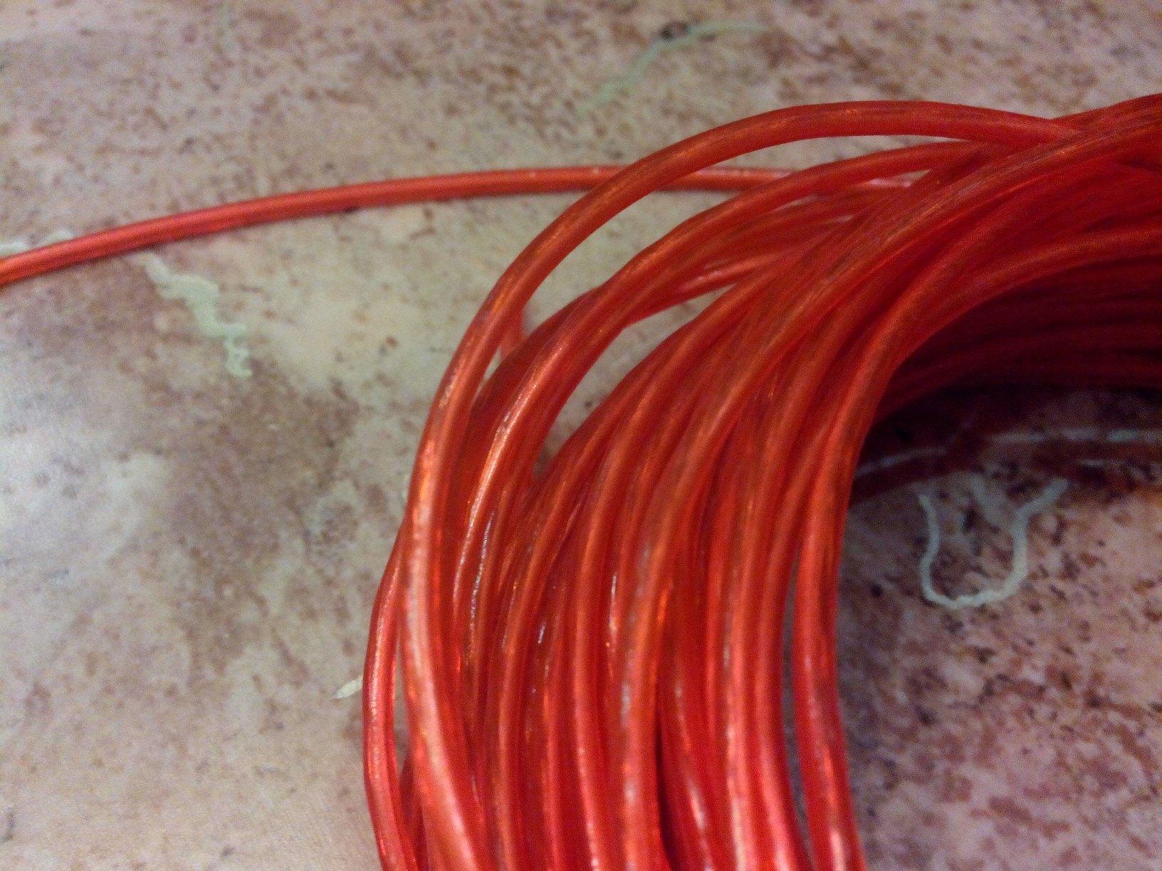

Hello guys. If you want transparent red authentic wire, just send me PM and 5$ on paypal. Then I send 1m of it to you by Post.
Some people already done that here and on Knights of Ren FB group.
12957638_1128336627189260_1436197392341826300_o.jpg12916838_1128336633855926_5003653432060586075_o.jpg
Sounds interesting lukyanov. What thickness / gauge is the wire? I need a particular size for mine, I think it was 12 gauge.
