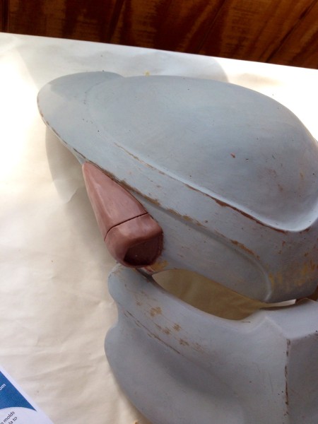

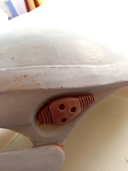

I was planning on prepping my Termokk 3.0 bio for paint today and unfortunately discovered that someone who won't be named (NOT me) threw away my tri-laser shroud and left temple air hose detail piece while spring cleaning.  As I have leftover clay and mold making materials, I went ahead and tried my hand at sculpting them.  The left temple piece is under rubber now, and I started to base out the laser shroud.  One step forward, two steps back...

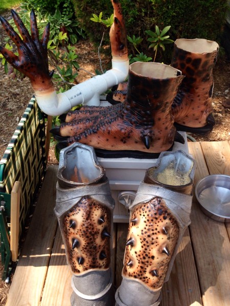

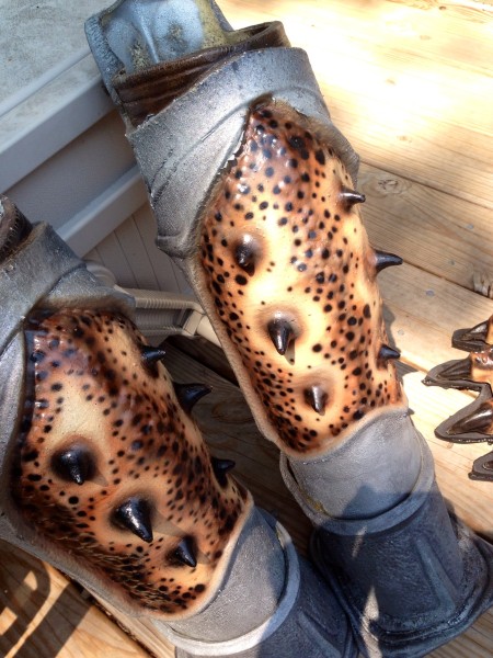

Finished painting the remaining flesh pieces today.  The main focus today was re-painting the fleshy bits on the shins to match my color scheme.  I also threw the hands, feet, and shins under the perma wet.

I've also successfully sculpted and molded my tri-laser shroud, just haven't snapped the picture yet as I haven't cleaned it up.  Thanks for looking!

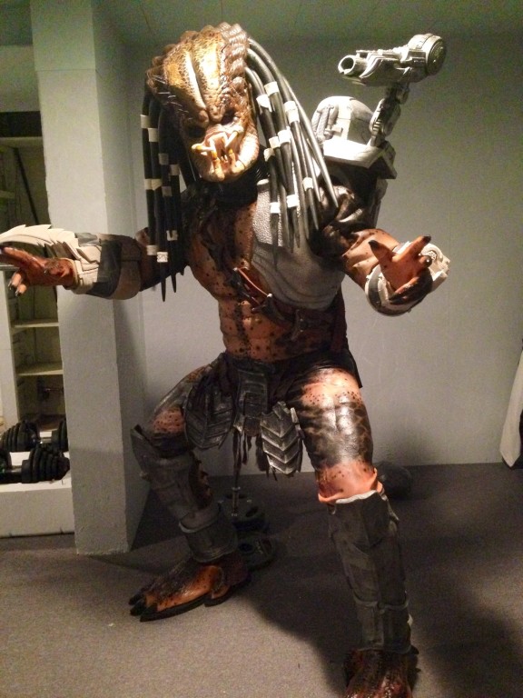

Thanks!  As I am as impatient as a child, I put some more time in today and gave my skins and armor a test fit to see what needs tweaking.  I recently picked up the avp chest/backpack/cannon shoulder armor set from member Eagleskull and have opted to continue my kitbashing with this build.  Obviously the gauntlets aren't painted and are held together with duct tape, the electronics are nowhere near completion, and the bio is still sitting untouched.  The strap system I set up to hold on the backpack turned out to be too short and wouldn't wrap around my chest so that's why the cannon is almost falling off my body.   But hot damn am I happy with this build so far.  Here are a few pictures of me geeking out.  Thanks for looking!

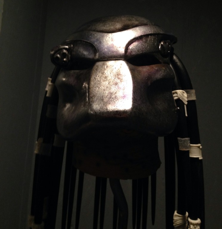

Finished painting the bio and installing magnets in the bio/mask.  I shot paint through the spray gun and tried to use similar techniques found in Jamie Grove's Real Metal Effects video over on the Stan Winston School website.  I really liked the initial texturing that I was getting with the bio as I was painting, unfortunately as the paint dried it smoothed itself out.  Regardless, I'm still pleased with the outcome.  All that is left is re-wiring the LEDs and installing the visor.
Pre-weather:
Post Weather:
