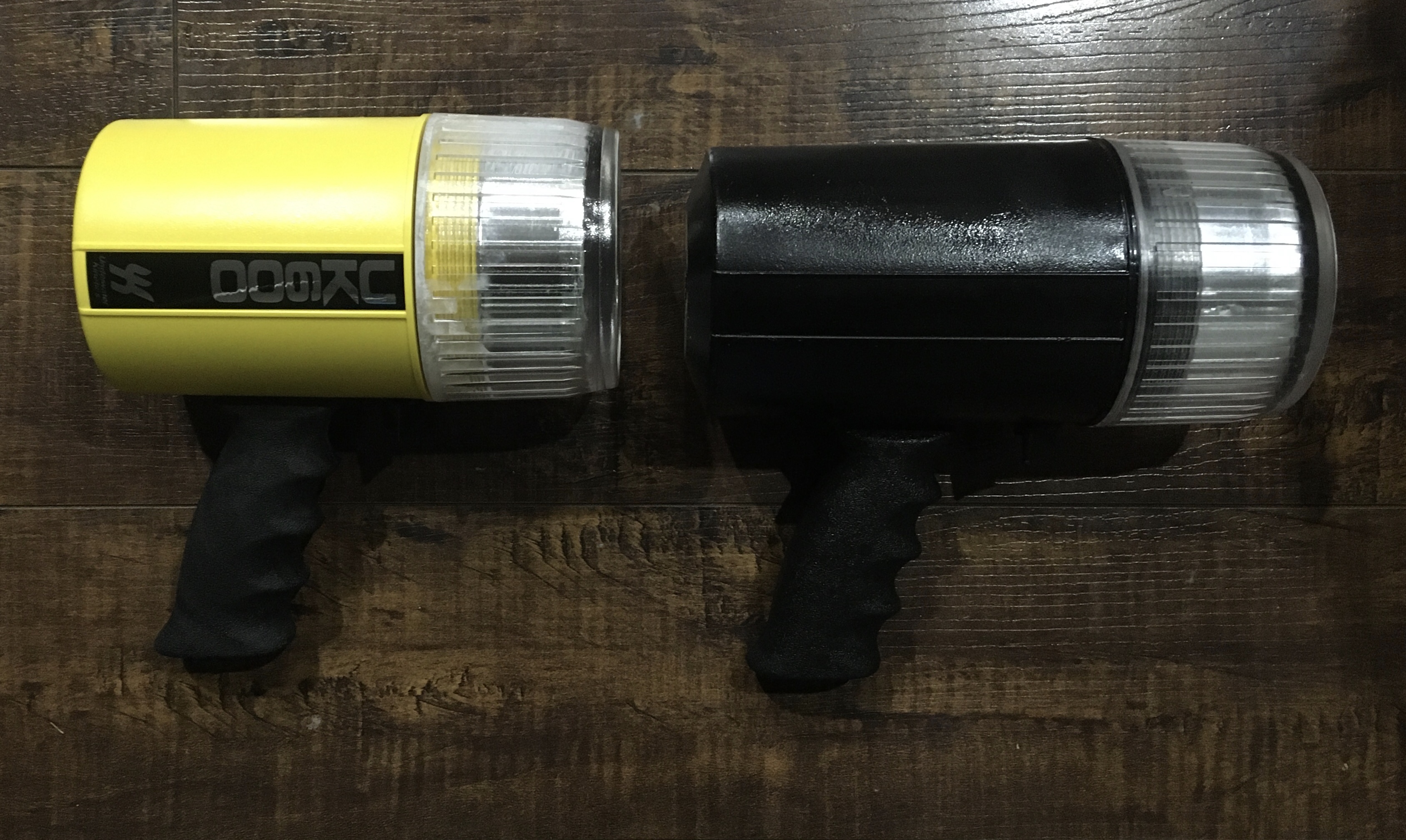

I was looking at my UK 800R and if I removed the label sticker, painted it black, and attached a clear plastic cap to the front I think that might actually be it. I think it's an acrylic or polycarbonate cup of some kind. Any ideas?
That’s basically what I did with my UK1200. I actually just peeled off the labels and painted it black today, though I don’t like the look of satin so I’m going to repaint it flat black instead. Just a warning though, don’t use adhesive remover on the clear bezel. Mine had part of and old sticker on it and even the smallest amount of remover frosted what it came in contact with. I’m going to try a 4 inch acrylic beanie baby display case for mine. I’ll have to cut out the bottom some probably with a hole saw so it leaves a small ledge that the forward reflector can have something to be secured to. I’m finding different cheap spotlights at the thrift store to use for the reflector once it gets here. I have an idea for the center focusing tube also. I’m going to order a few different size light focusing lenses and attach it to another section of 2 inch clear pipe. It should work until I come up with a better solution. If it works out I’m planning on doing the same to my UK600 and leaving it unpainted as the Congo version. I’m wondering what they used to get the cool white in the movies as both my lights have the warm orange halogen bulbs.
