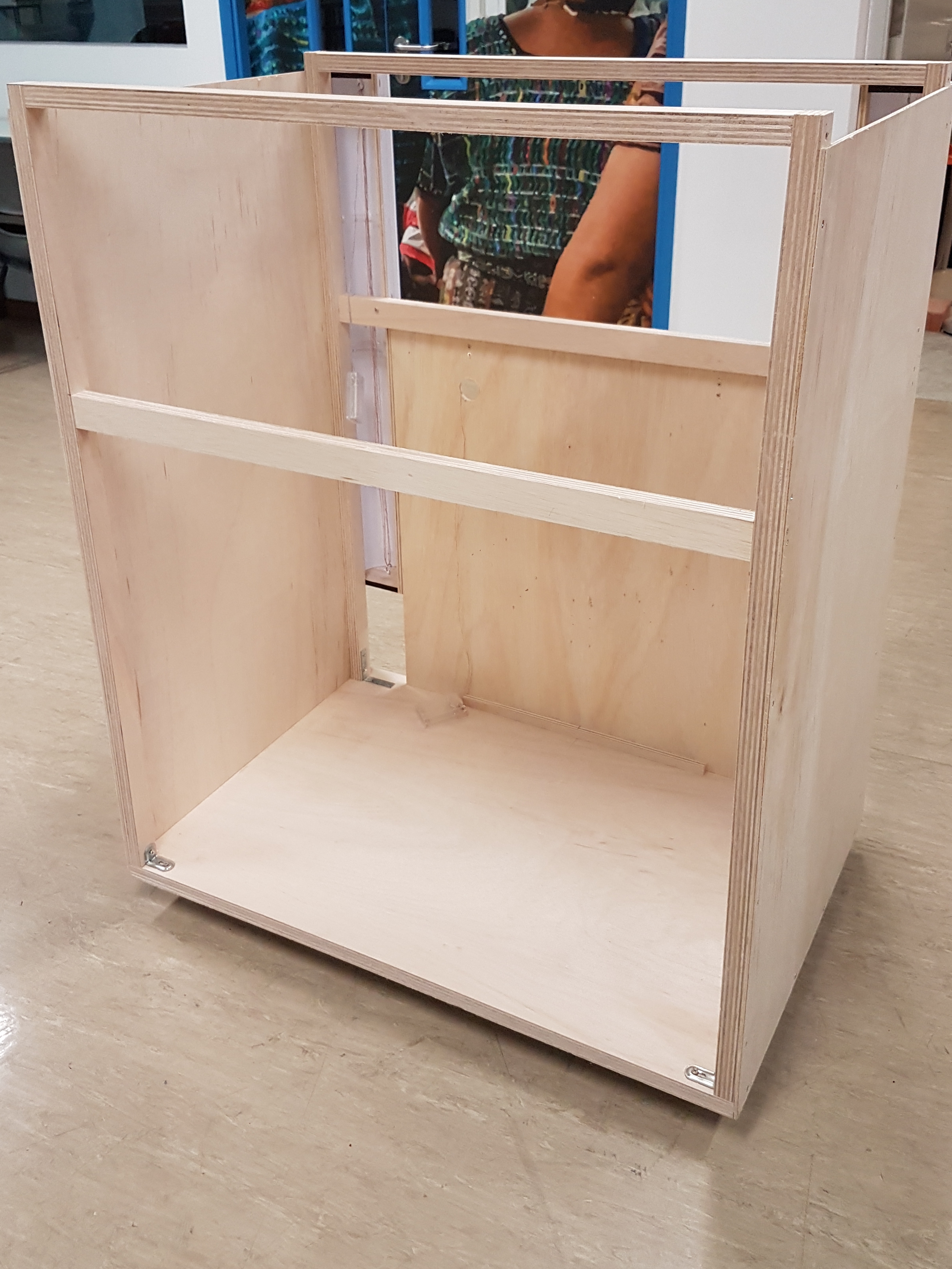

Here's some photos of the carcass & parts before assemble.

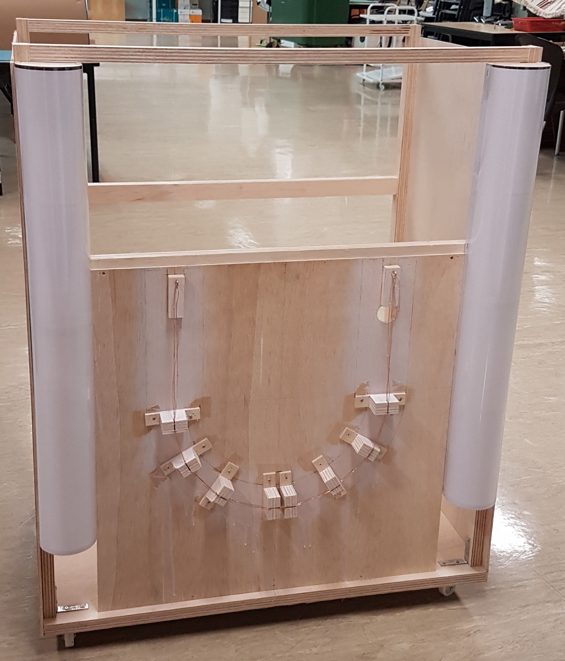

The lighting parts made of plywood frame support with acrylic. Covered with white paper sandwiched between 2 layers of clear PVC plastic. The battery operated LEDs run along the center.

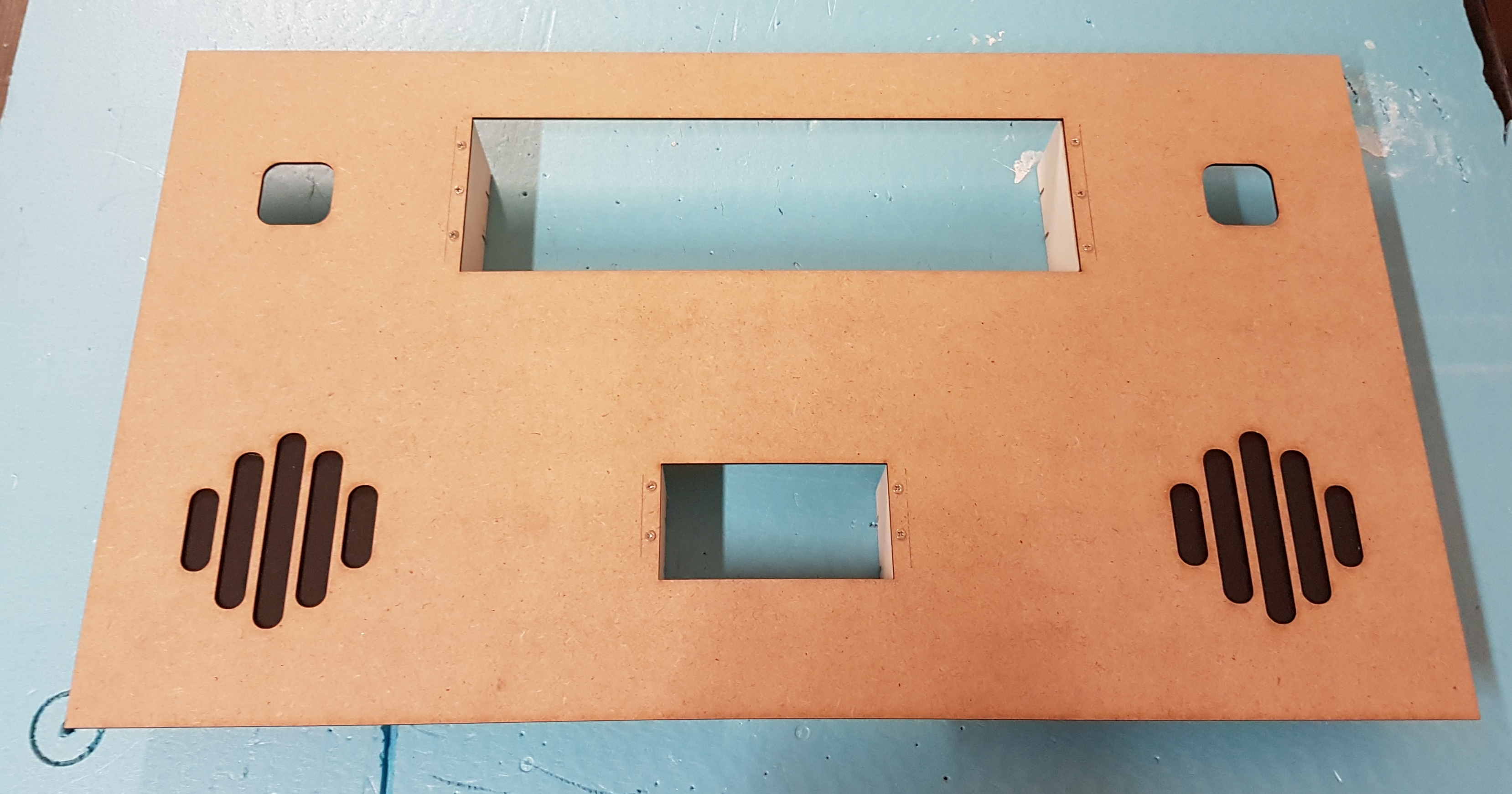

Some parts assembled & one of those parts (MDF) thats being laser cut. The brackets supporting the battery operated LEDs ( 5meters ) & also will be supporting the acrylic U shaped parts. Just use a black paper to cover the "speaker" hole.
Another section using MDF & acrylic being laser cut & put together... wording printed on clear media!!! The numbers on the red buttons engraved using laser.

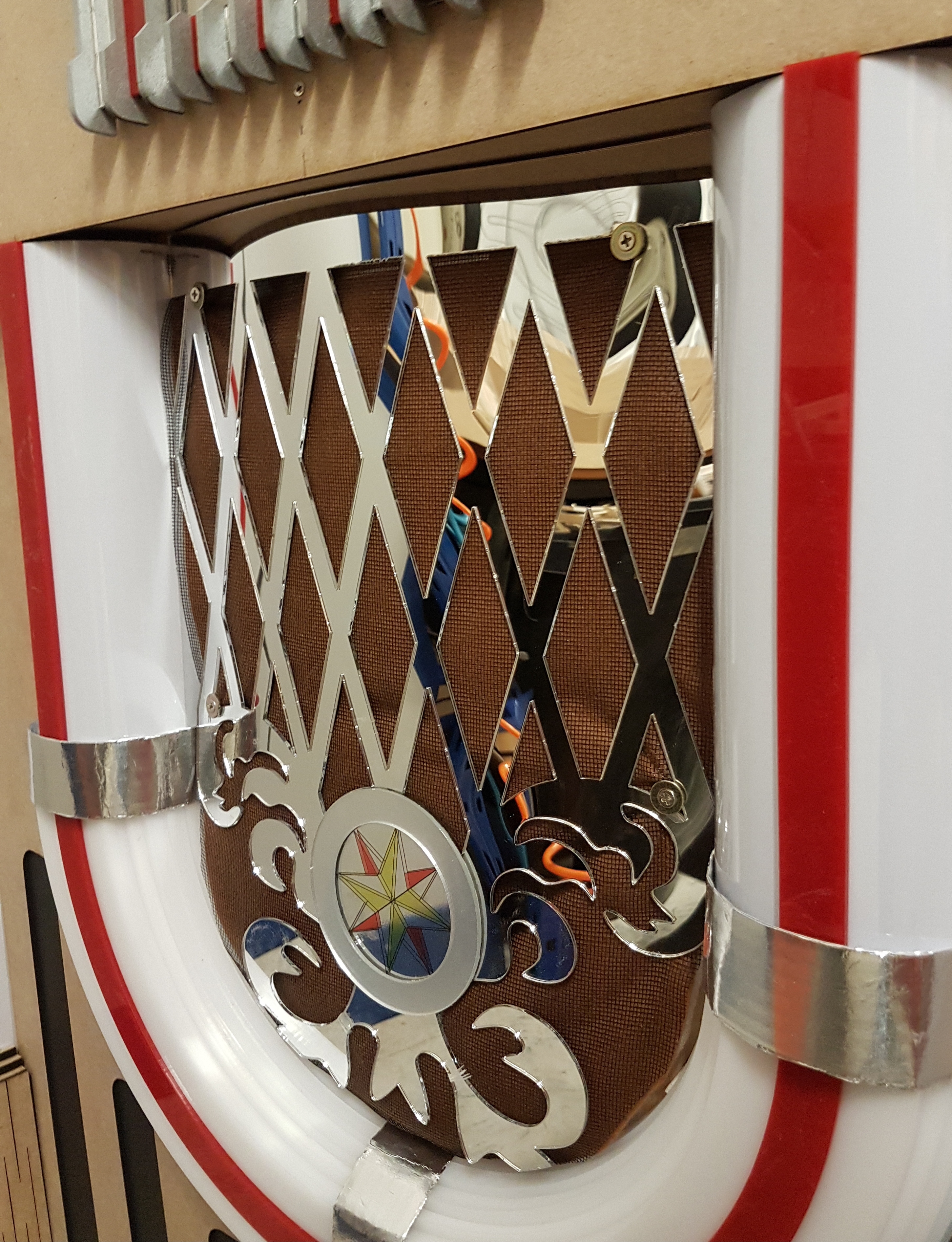

Speaker cover made from reflective/mirror acrylic (laser cut) & back with felt cloth & netting. Bottom light cover MDF laser cut, bend & glued together. The area where U shape light cover meet the straight part, covered with cardboard using aluminium tape.

The top & side (silver & red) uses cardboard with aluminium tape & red plastic sheet so it can be bend into shape to cover joints/gaps in between the lighted parts.
The top part uses cardboard sheet stapled down the the plywood frame, easy to bend to get the semi circle shape. Strips at the side & bottom using reflective/mirror acrylic. Sides & back painted with acrylic paint fudge brown. MDF parts left unpainted as it has its own light brown colour which matches with the whole thing.

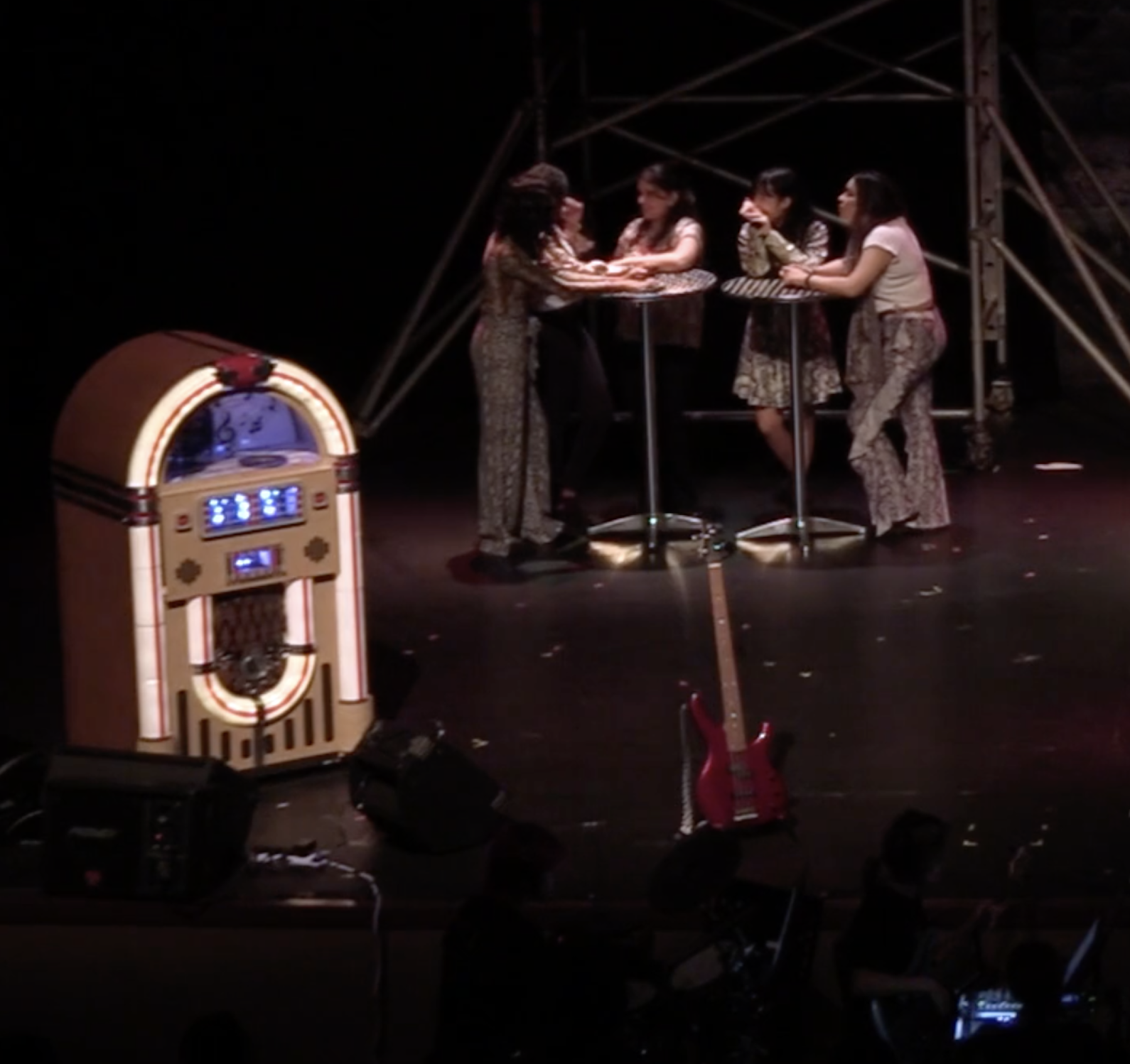

During the musical... Bar scene!!!
Word is.. it gets all the WOWs when it was pushed onto the stage for the scene!!!
