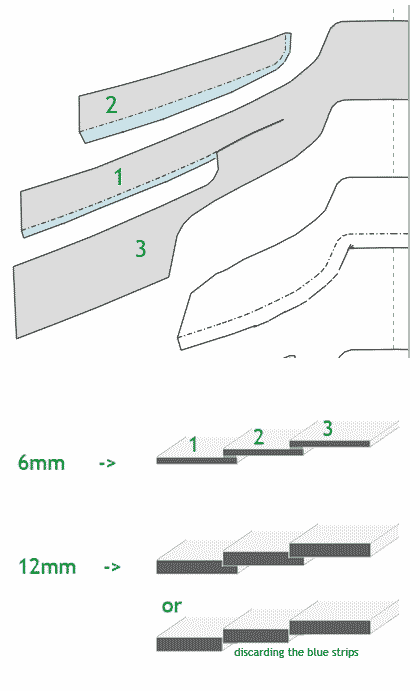

0.5 inches makes something like 12mm... well I never had any feedback about any issue concerning a failed build with both my pdo files and some 12mm thick foam. The thing you must know is that of course the more thick is your material, the more narrow will be the 'habitable space' inside of your suit.
Even for the abs I'm sure you can also use some 12mm foam. You may applie these process if needed :
You can thin the foam on the gluing area,
or plainly cut up your pieces of foam without caring about the dot-lined overlap you'll see on the pep files. Illustration :

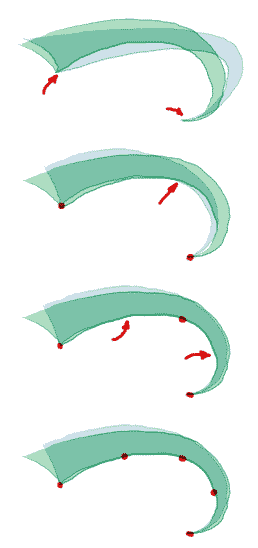

Some advice... well yes, at the horn gluing stage we have three loooong pieces to snap together. To be sure to obtain a well curved horn, you may want to face them up first and glue them point by point, this way :

That's it, the dotted lines along the borders of the paper templates are here to delimitate
- the real outter side of the suit (in grey)
from
- the strip that will recieve glue and will be overlapped (in blue) by another piece of foam.
If you're using your 12mm foam, by thinning the blue area you can act like if you were working with some 6mm foam, or you can also completely remove this blue edge depending of the method you plan to assemble your foam pieces.

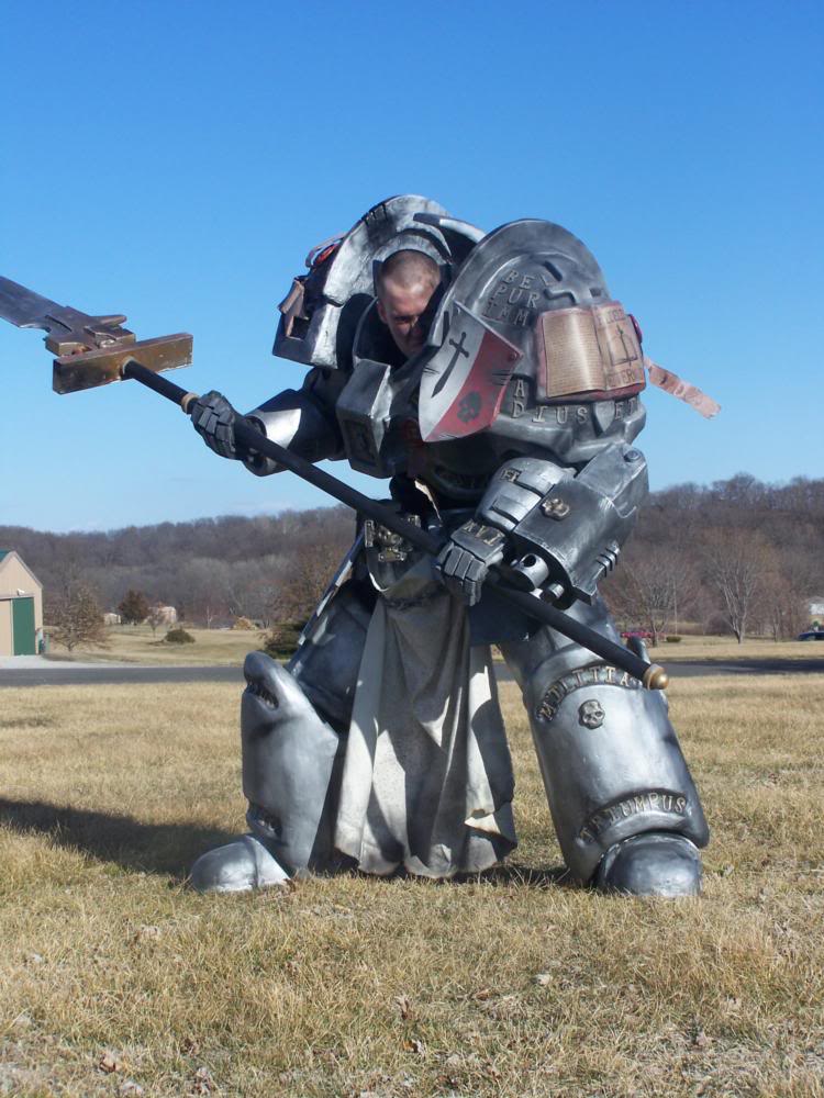

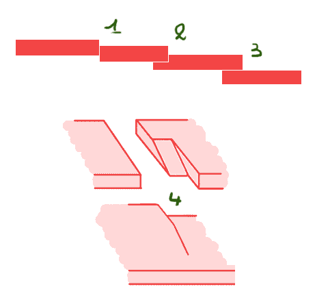

I've been asked if I had used some 2, 3 or 5 mm when building Sharkhead's helmet, in fact it was some 7mm foam. The illusion was due to the fact that I used several ways to snap the pieces of foam together, depending of the rendering I expected at the surface. Low, medium, heigh, and progressive step :

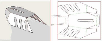

On this part, every dotted line is here to show where to make a V cut on the inner side of the foam to obtain a seamless mountain, as shown on the 3D view. If we except that it's faster, and that it prevents from getting your 'small valley between the two edges' you don't even need to fill anymore with any product to make it perfect, well yes the result is roughly the same.:behave
One simple thing also is you don't have to mix the dotted lines that represent a mountain or a valley, with the dotted lines that delimit a gluing area. But it might not be much harder on the picture above that on the one below :
In case of doubt, always refer to the 3D view of Pepakura viewer... :)
