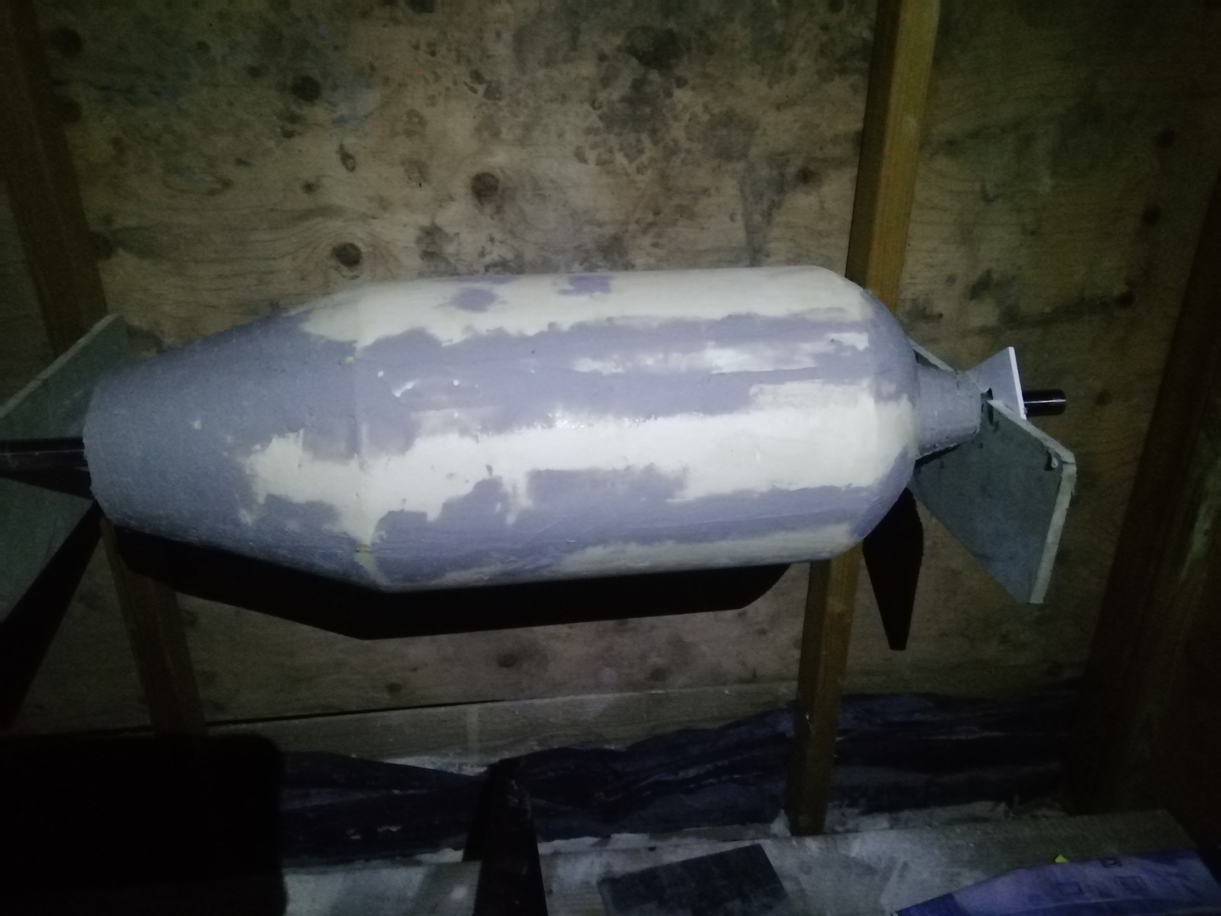

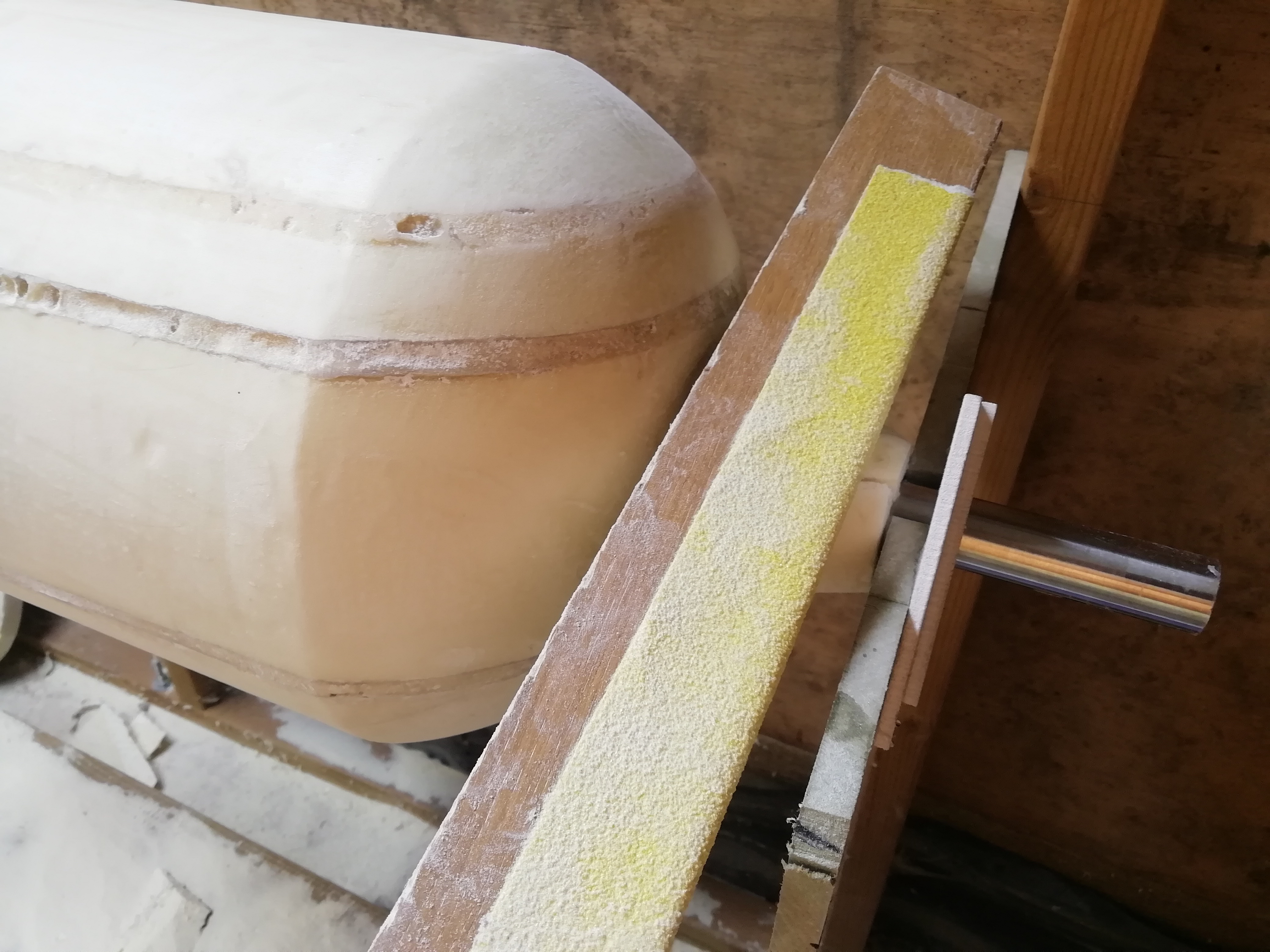

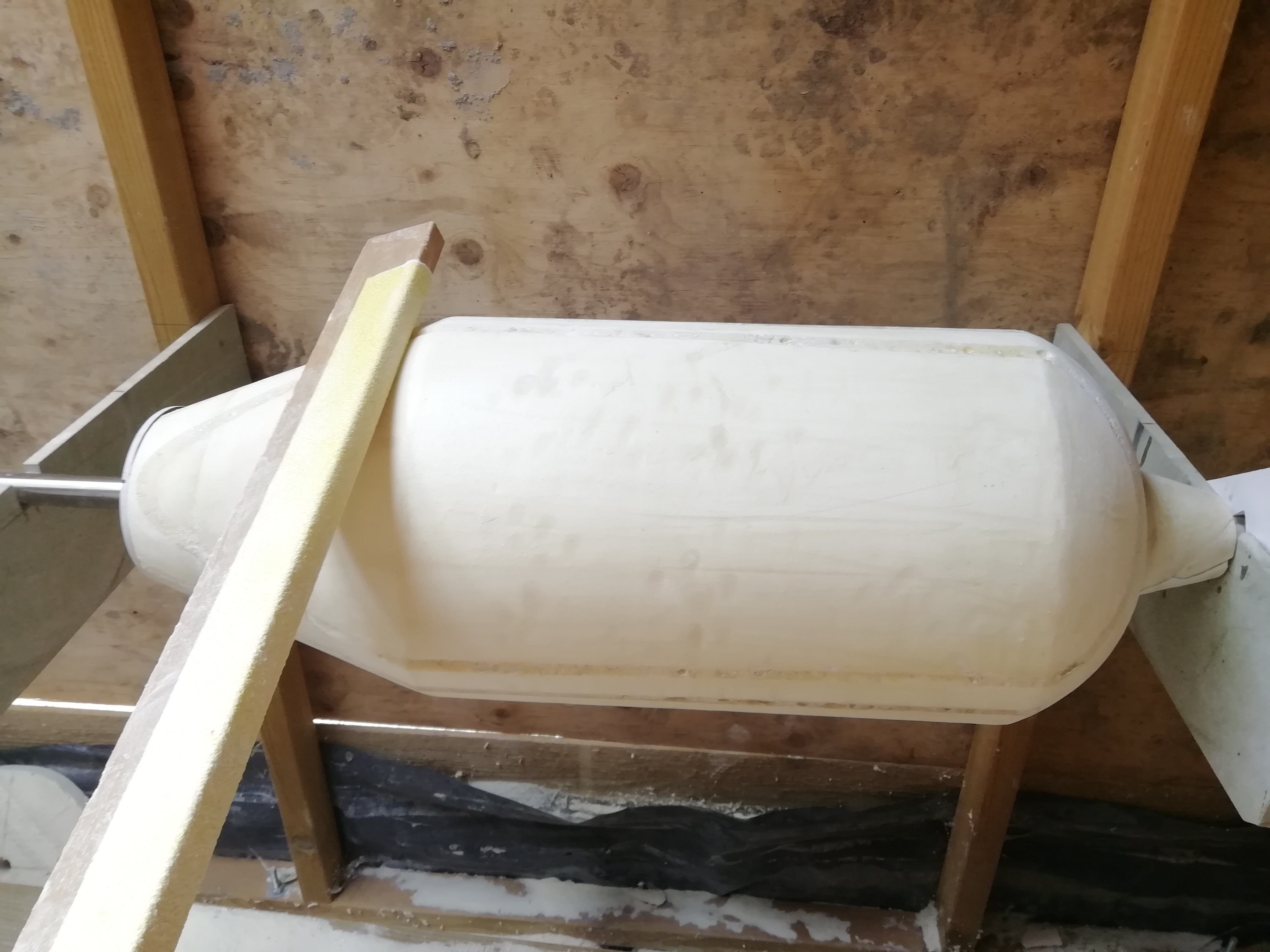

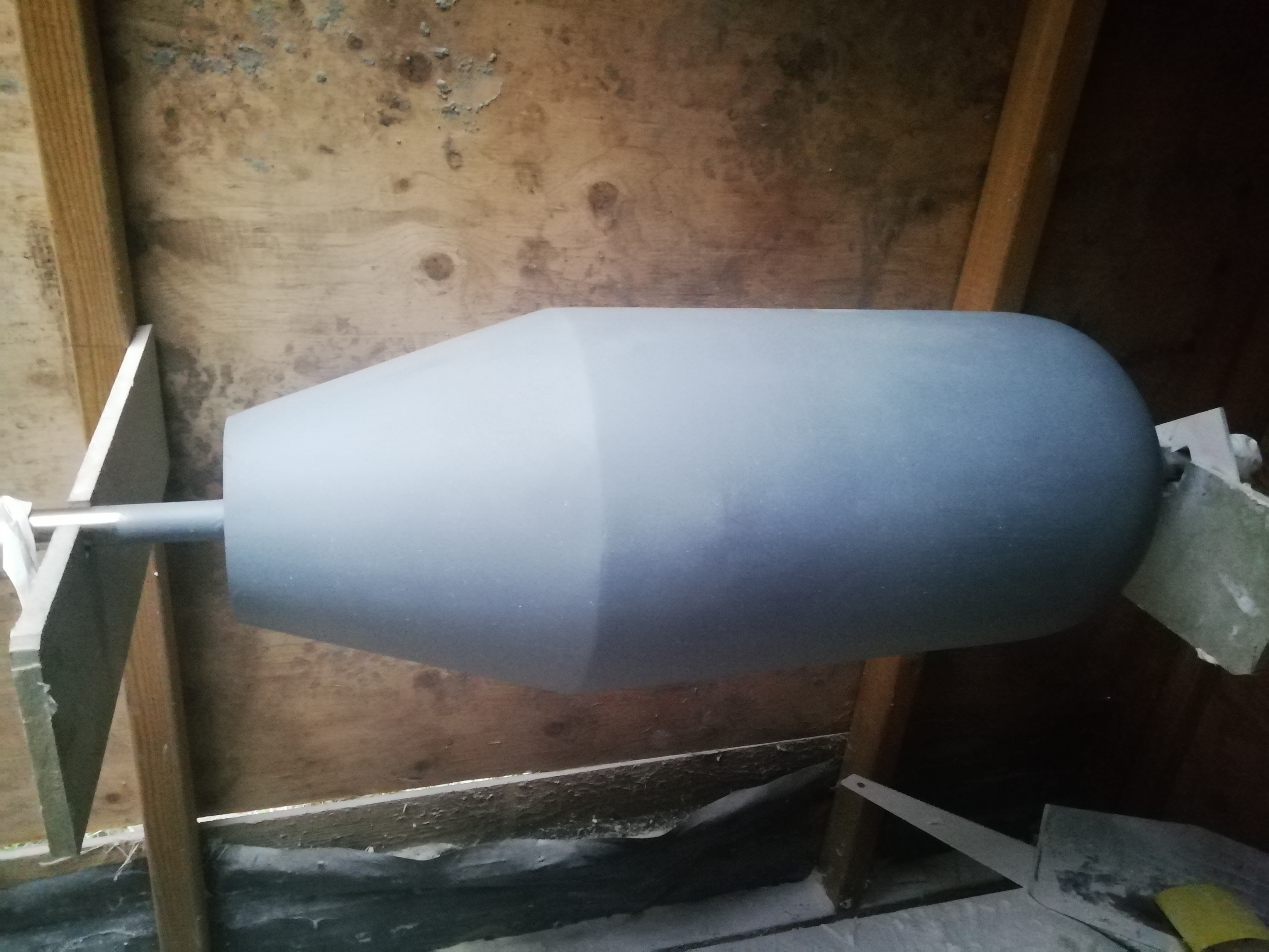

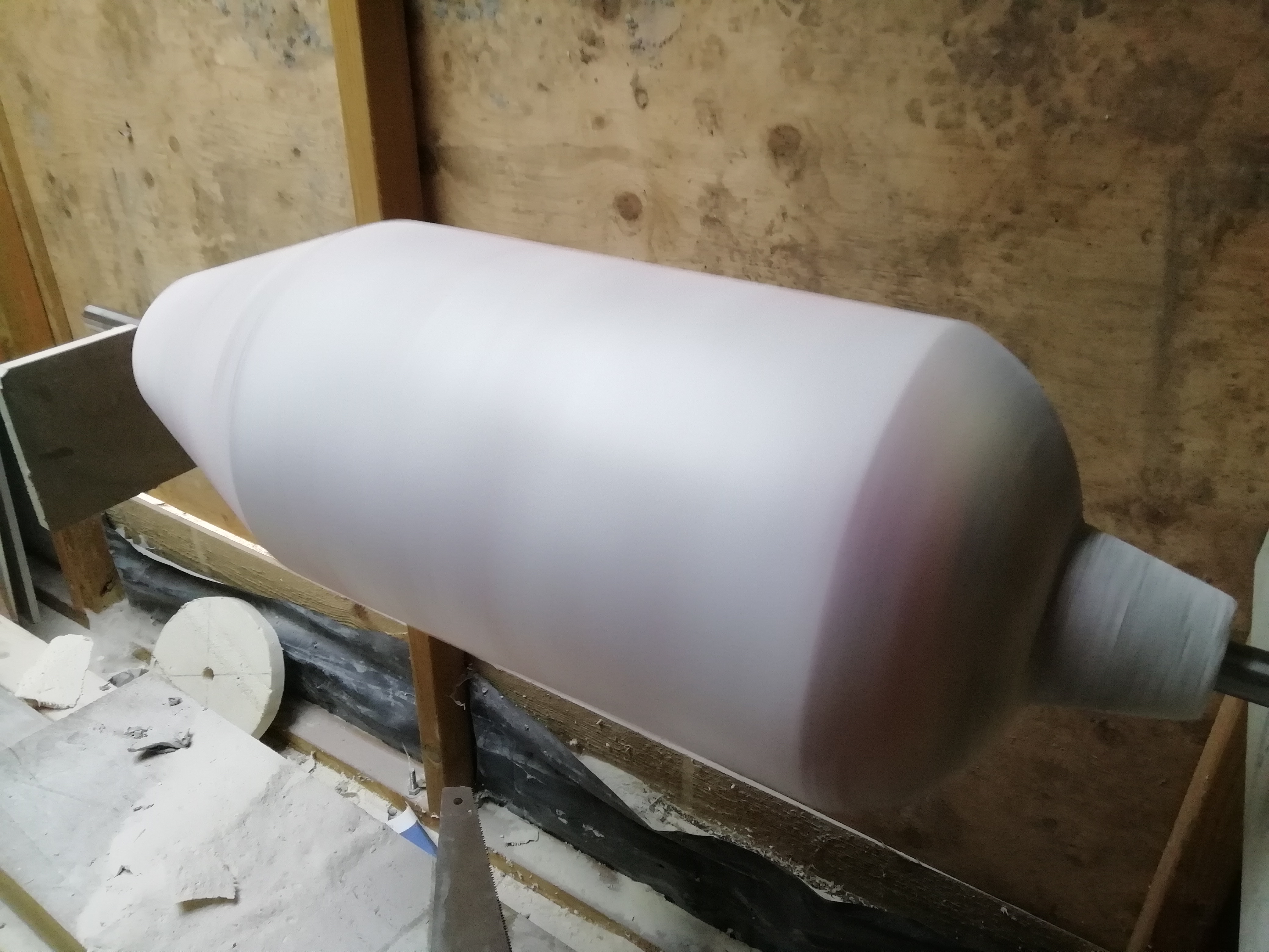

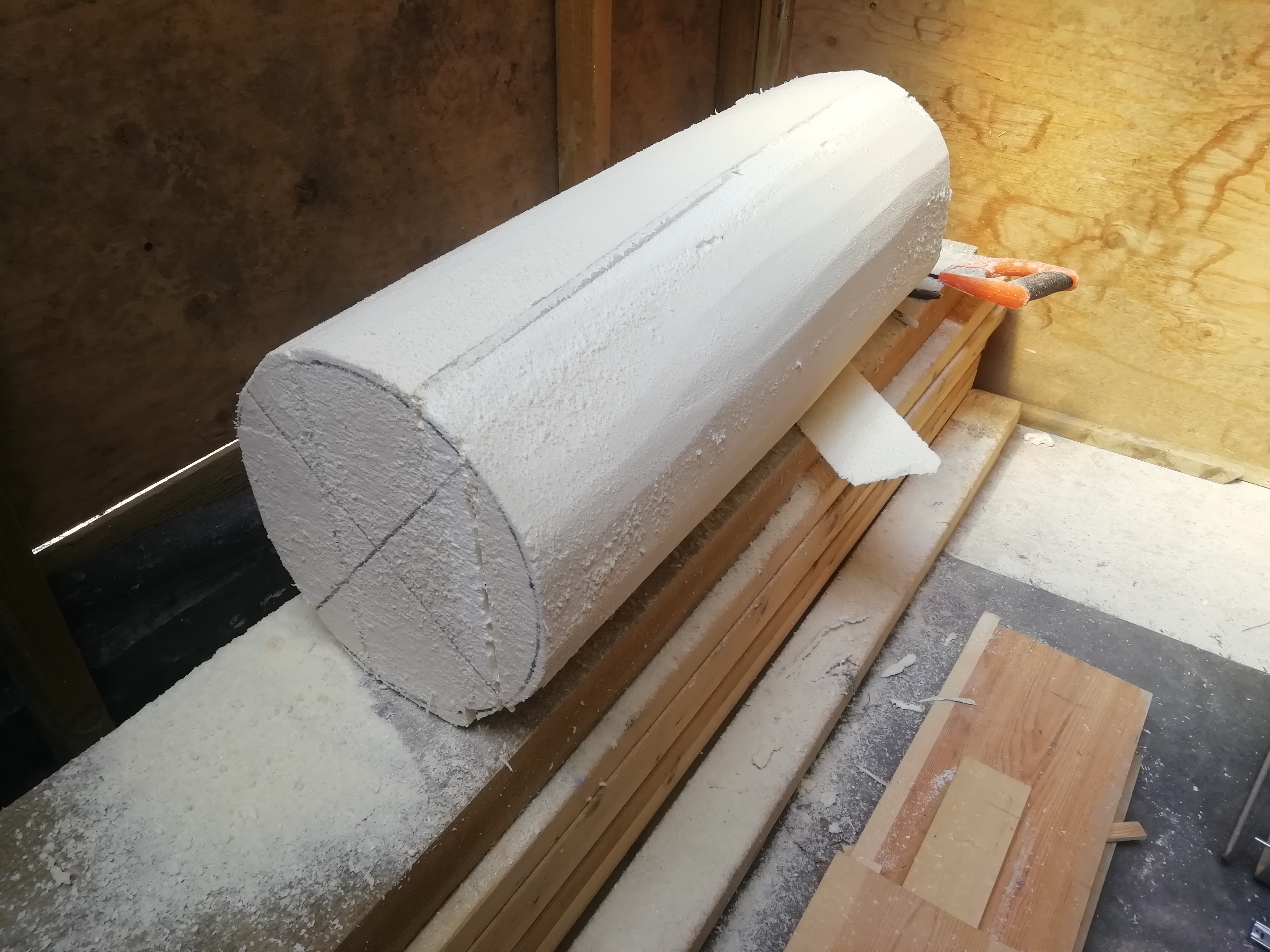

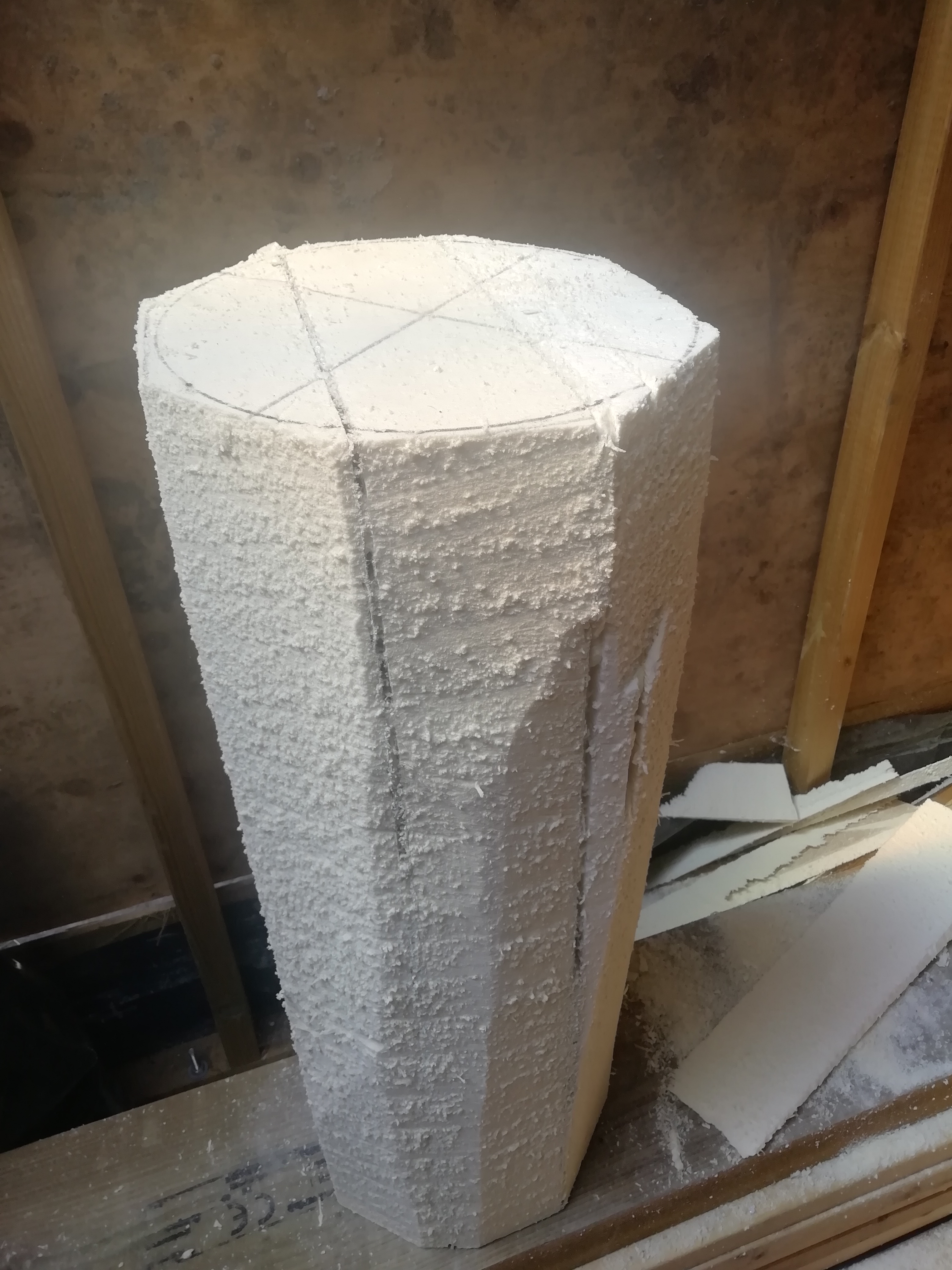

Making progress and nearly ready to start casting moulds on some of the main body.

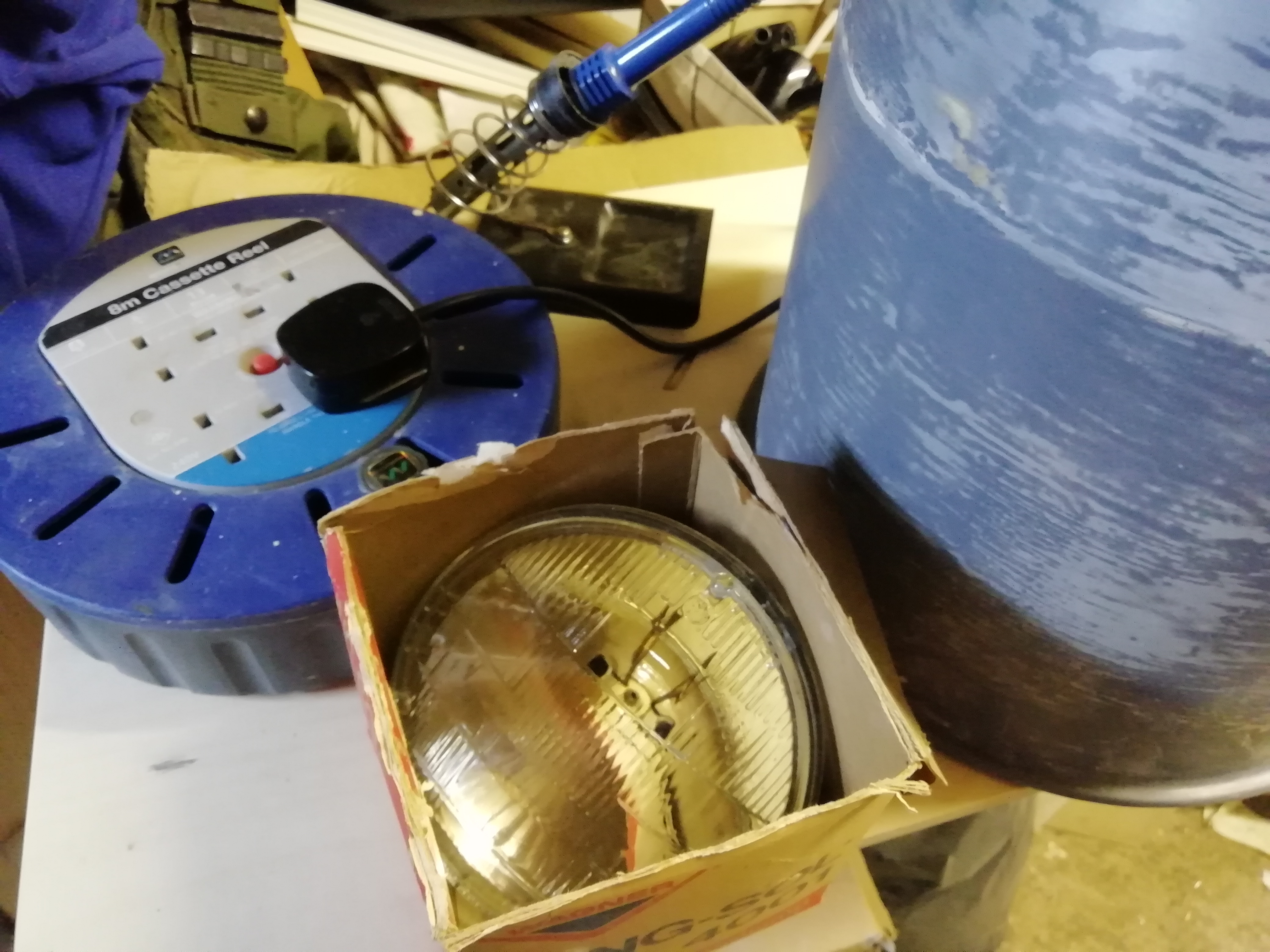

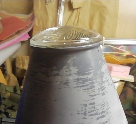

IMG_20200418_120450.jpg 12v exact lamp installed, these were the same as used on the tow sleds too.

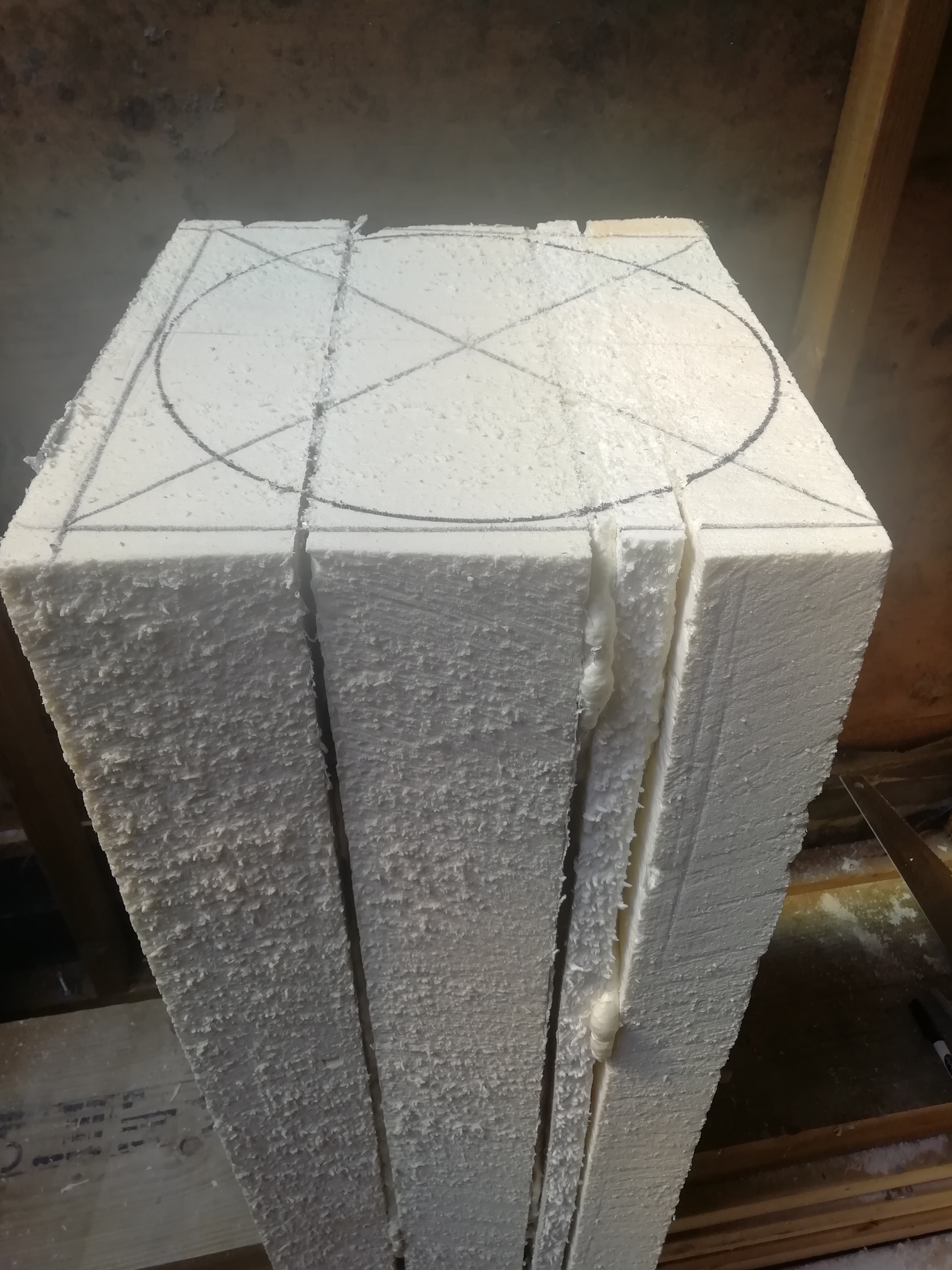

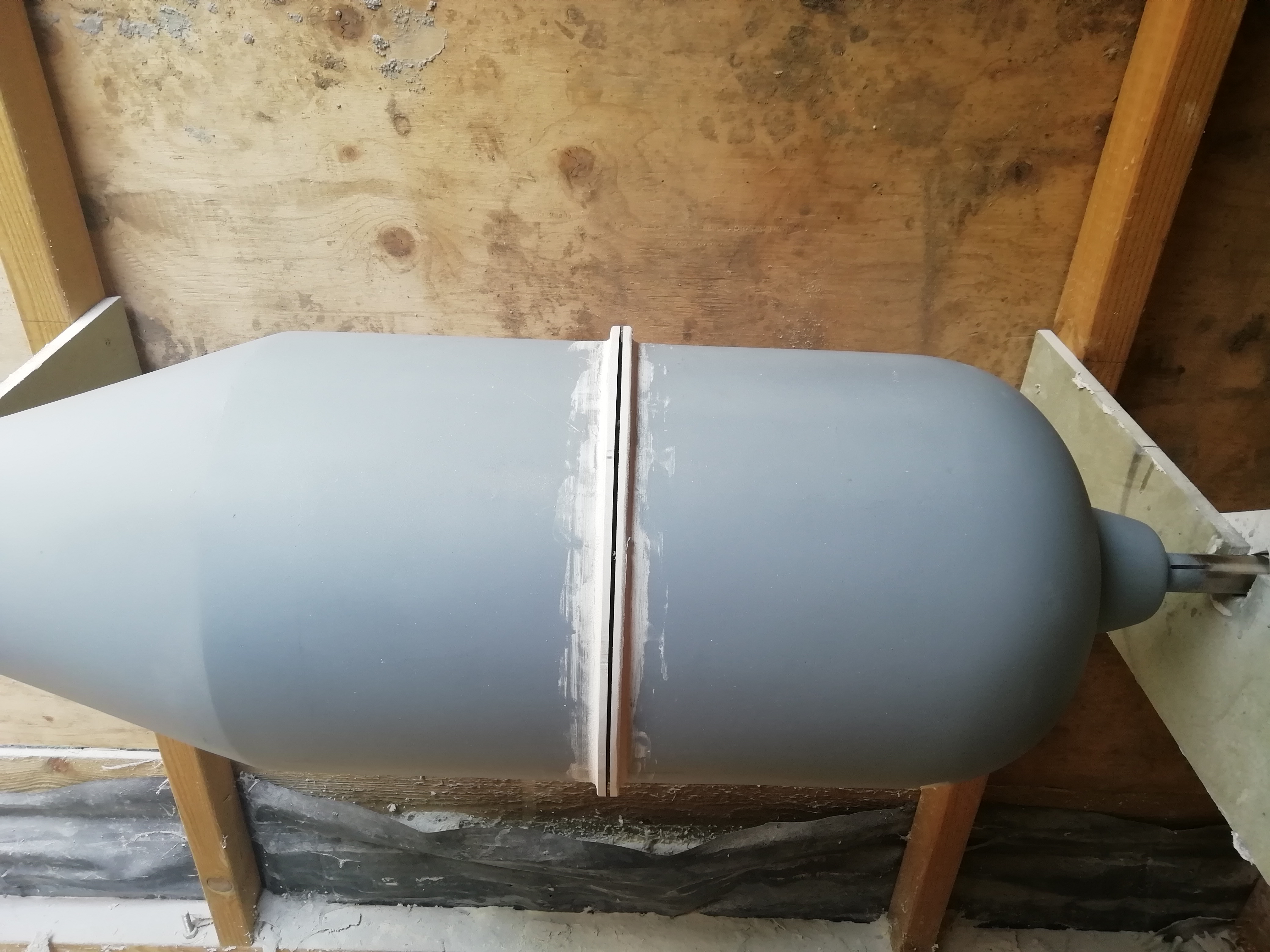

IMG_20200328_173219.jpg Blocked back up for ease of moulding

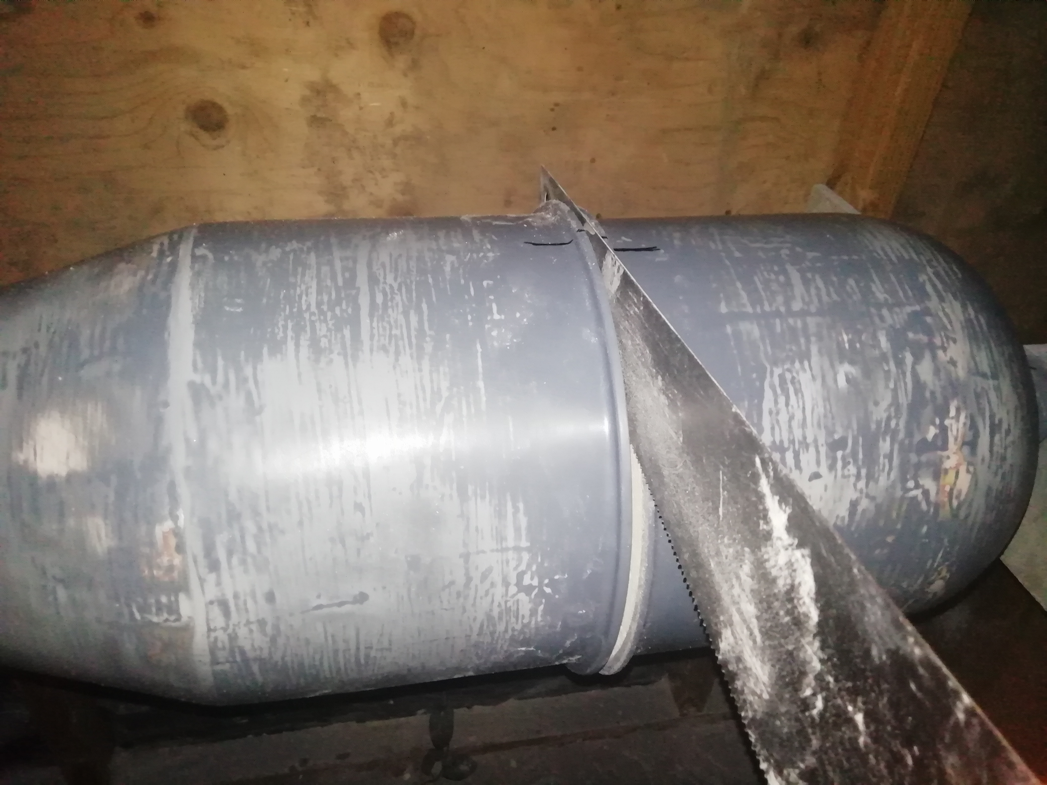

IMG_20200329_134732.jpg IMG_20200418_114918.jpg I laboured over a load more movie stills and decided that the rear was more curved.
IMG_20200418_122316.jpg Forming moulds

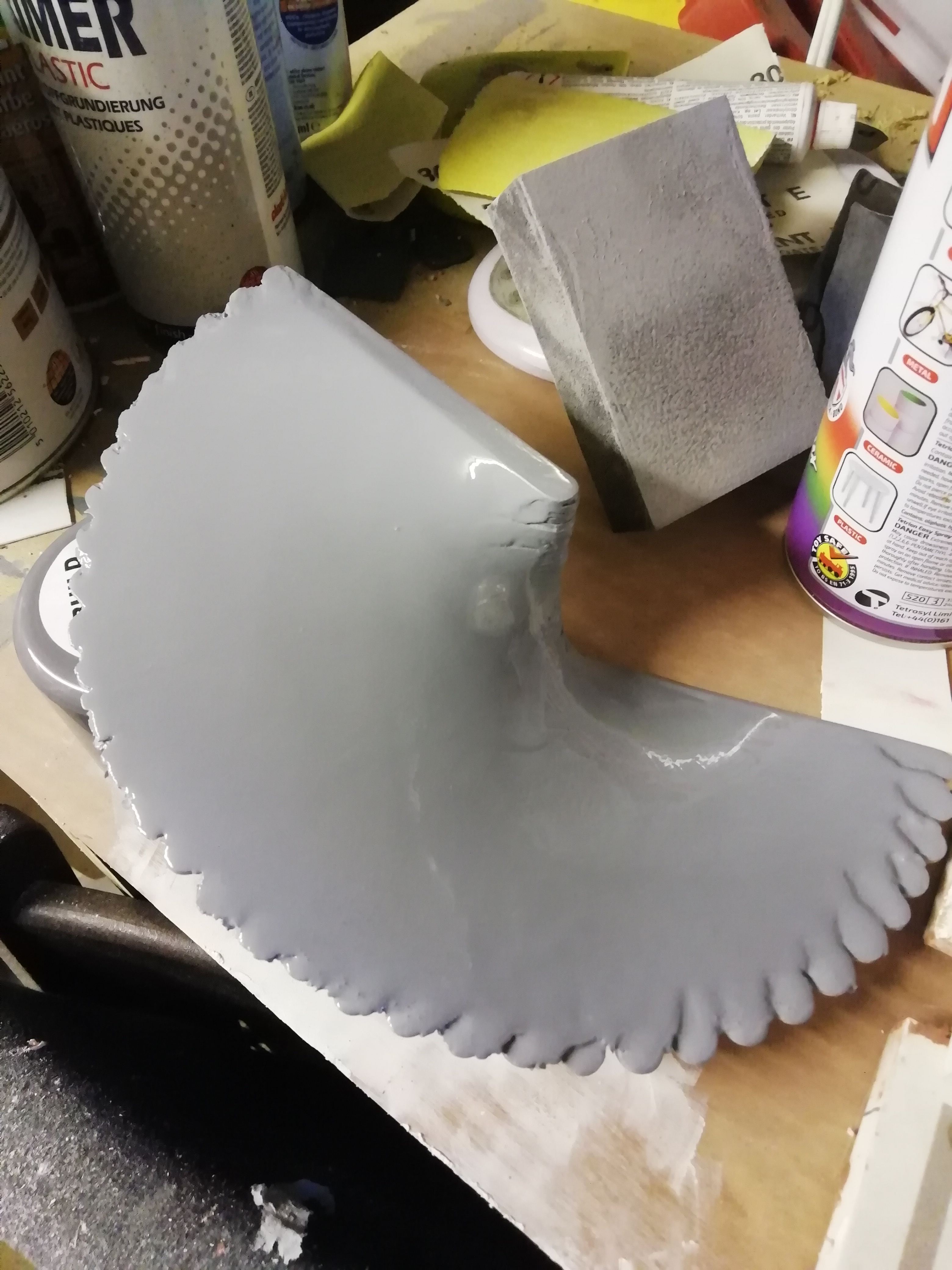

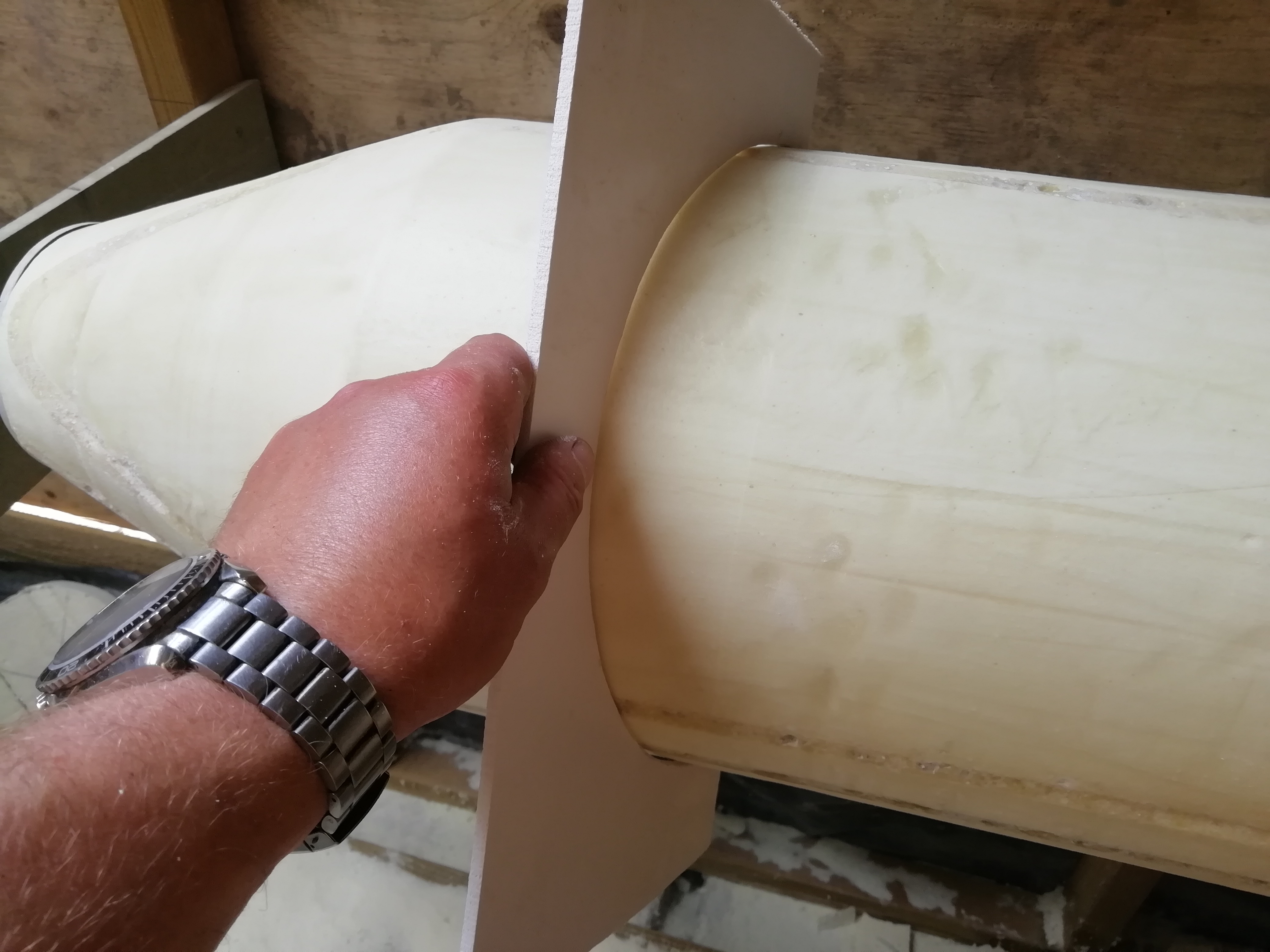

I've also started on forming the rear prop.

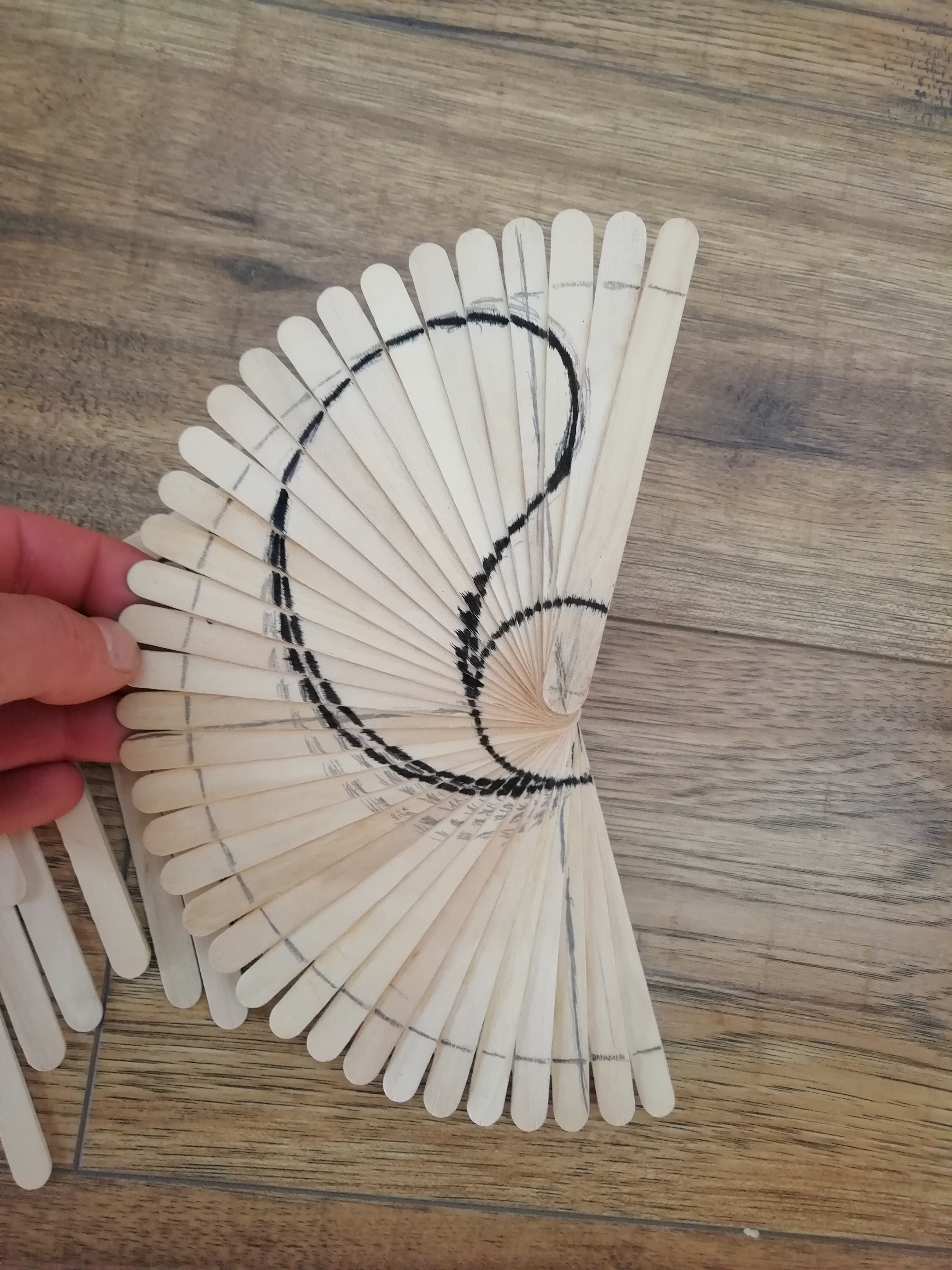

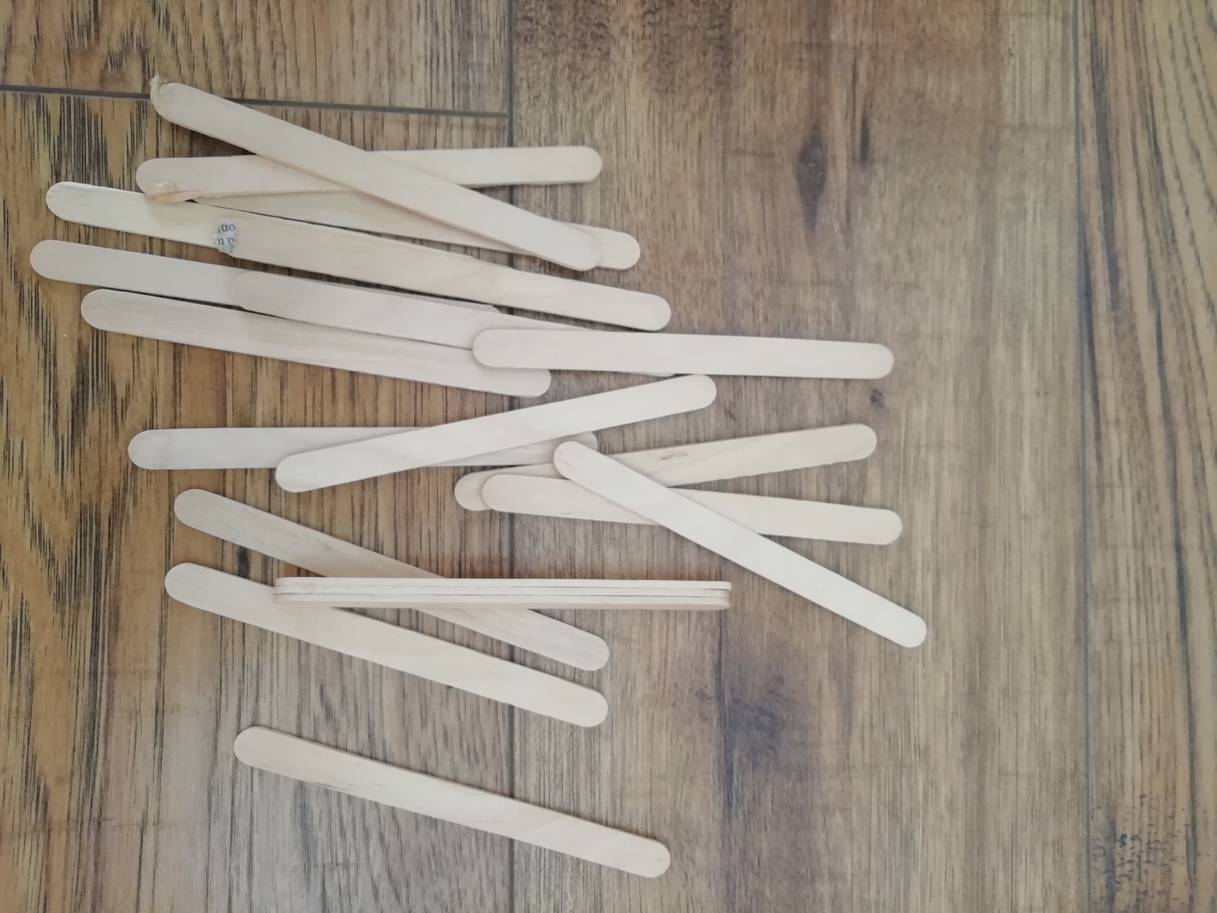

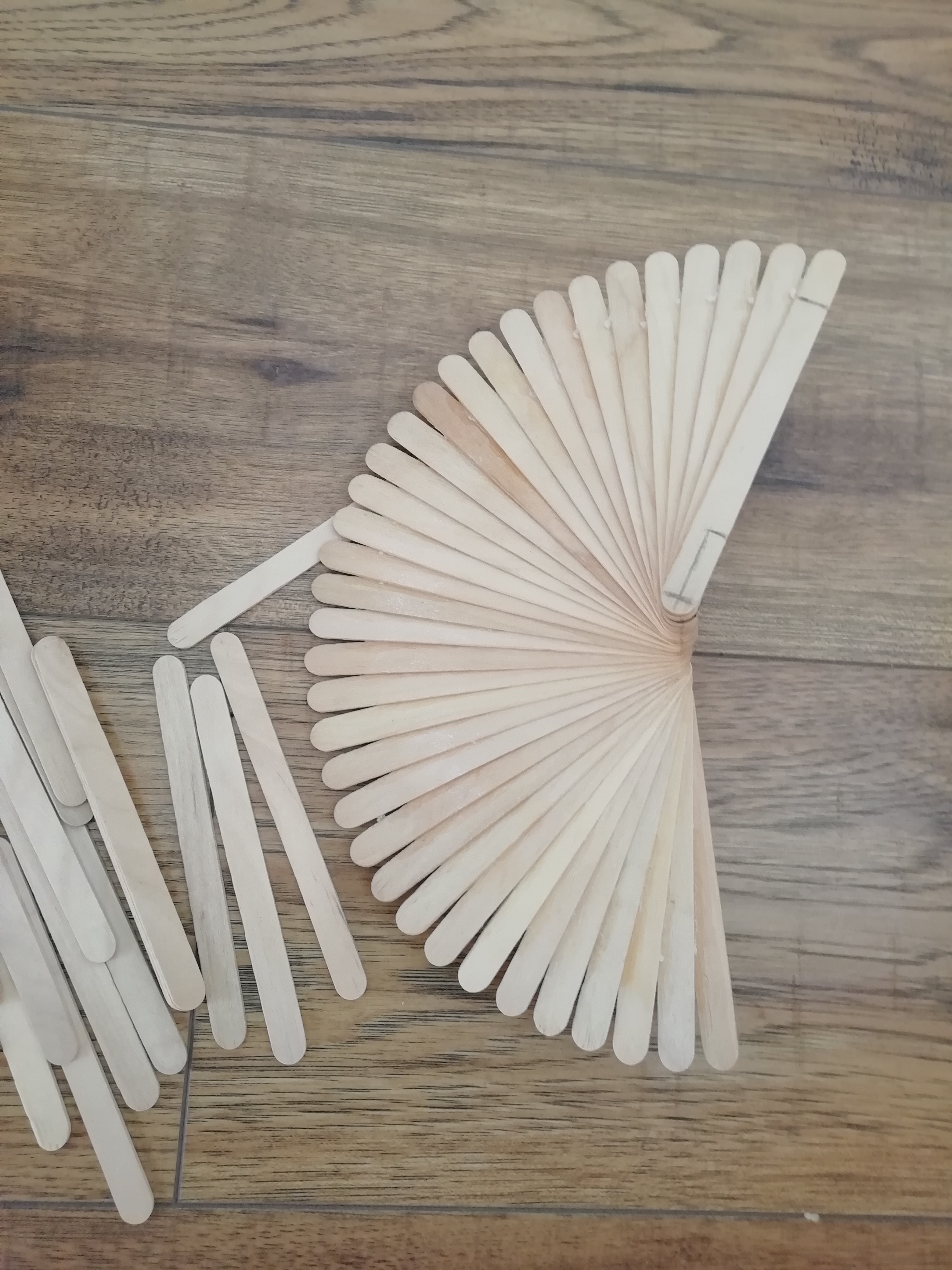

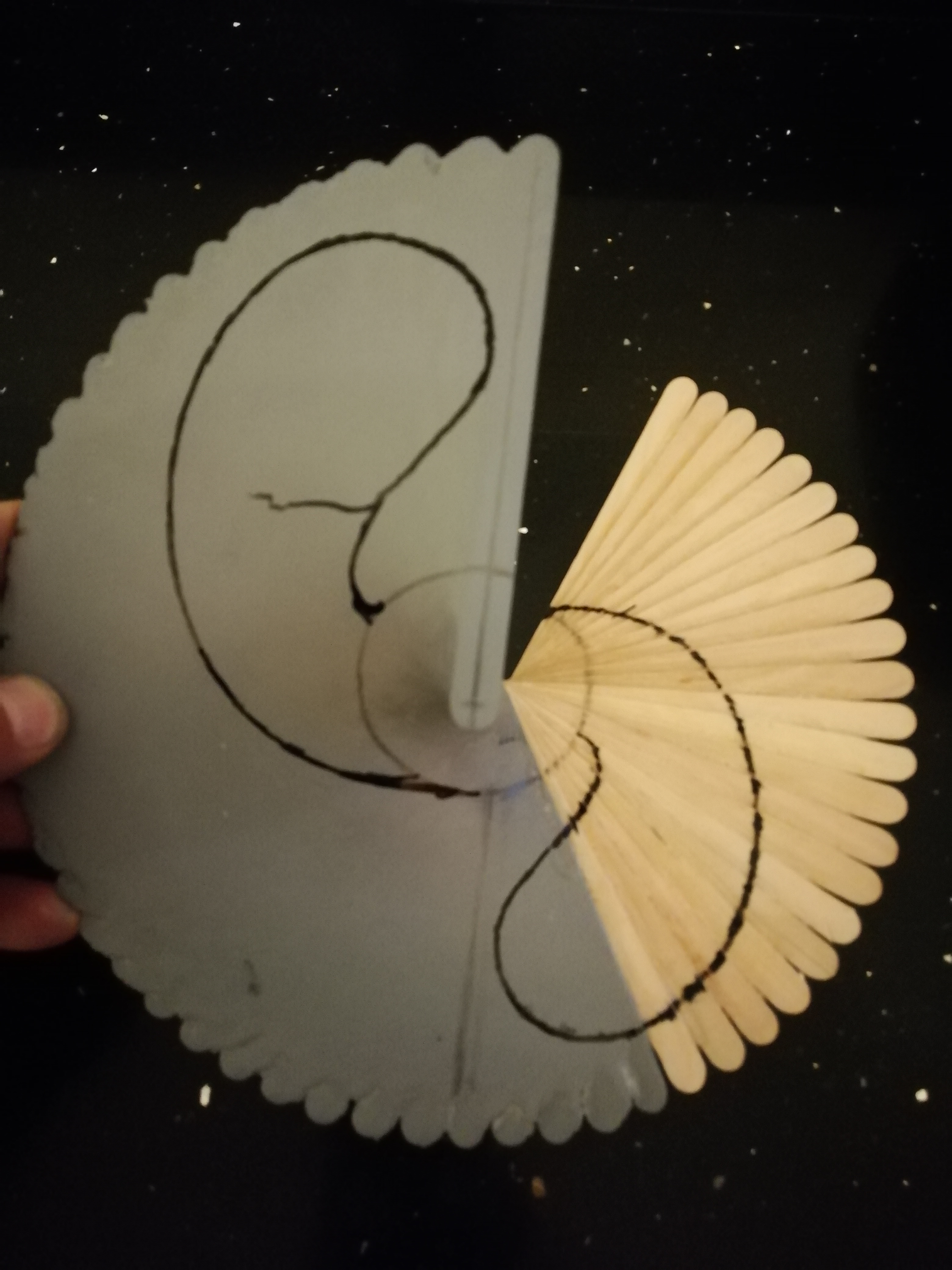

Making things with the kids while they're currently off school with popsicle (or lolly sticks, in the UK) some models, it suddenly dawned on me that these were a fantastic tool for possibly making the spiral curves for the blades. After making a few fans and spacing the sticks at different intervals i came up with roughly the correct blade pitch. what do you think?
IMG_20200502_170143.jpg IMG_20200502_170205.jpg IMG_20200502_170222.jpg IMG_20200502_170242.jpg IMG_20200503_155754.jpg IMG_20200503_155822.jpg IMG_20200503_171824.jpg IMG_20200503_235430.jpg 007-TB_Jetpack-Pic (3).jpg
wow,i know it's been warm here but you eat some lolly's there mate.;)nice work.

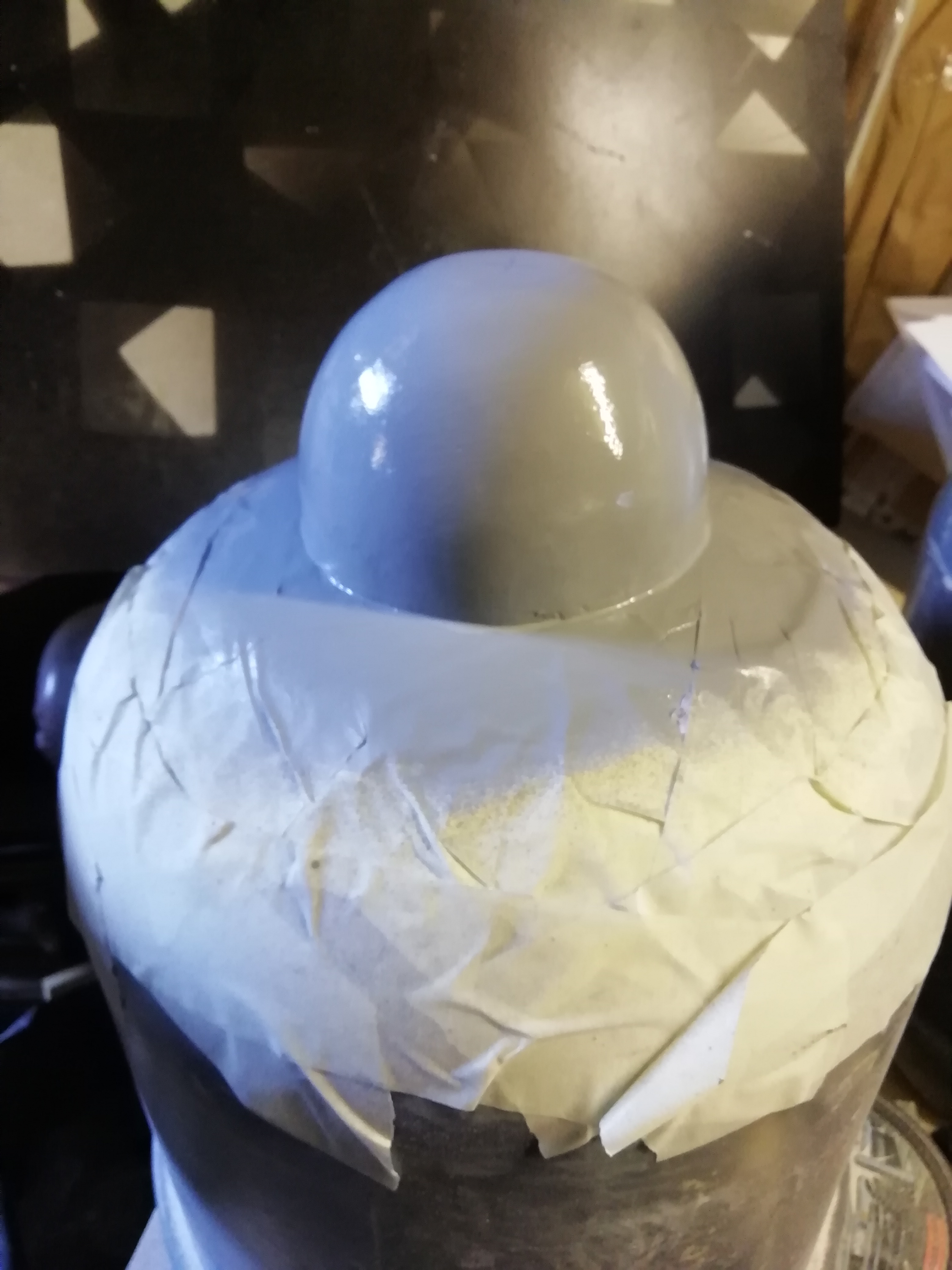

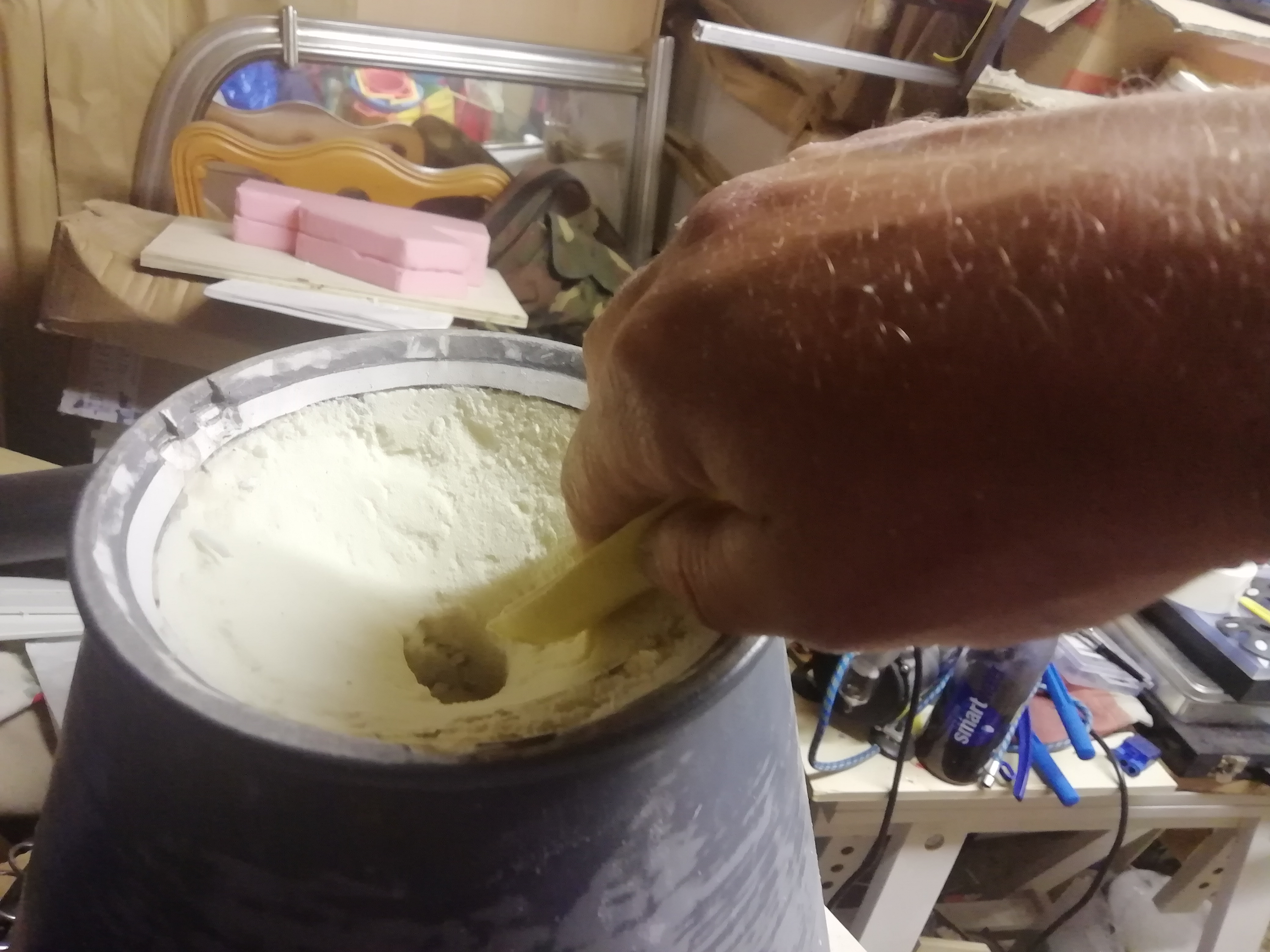

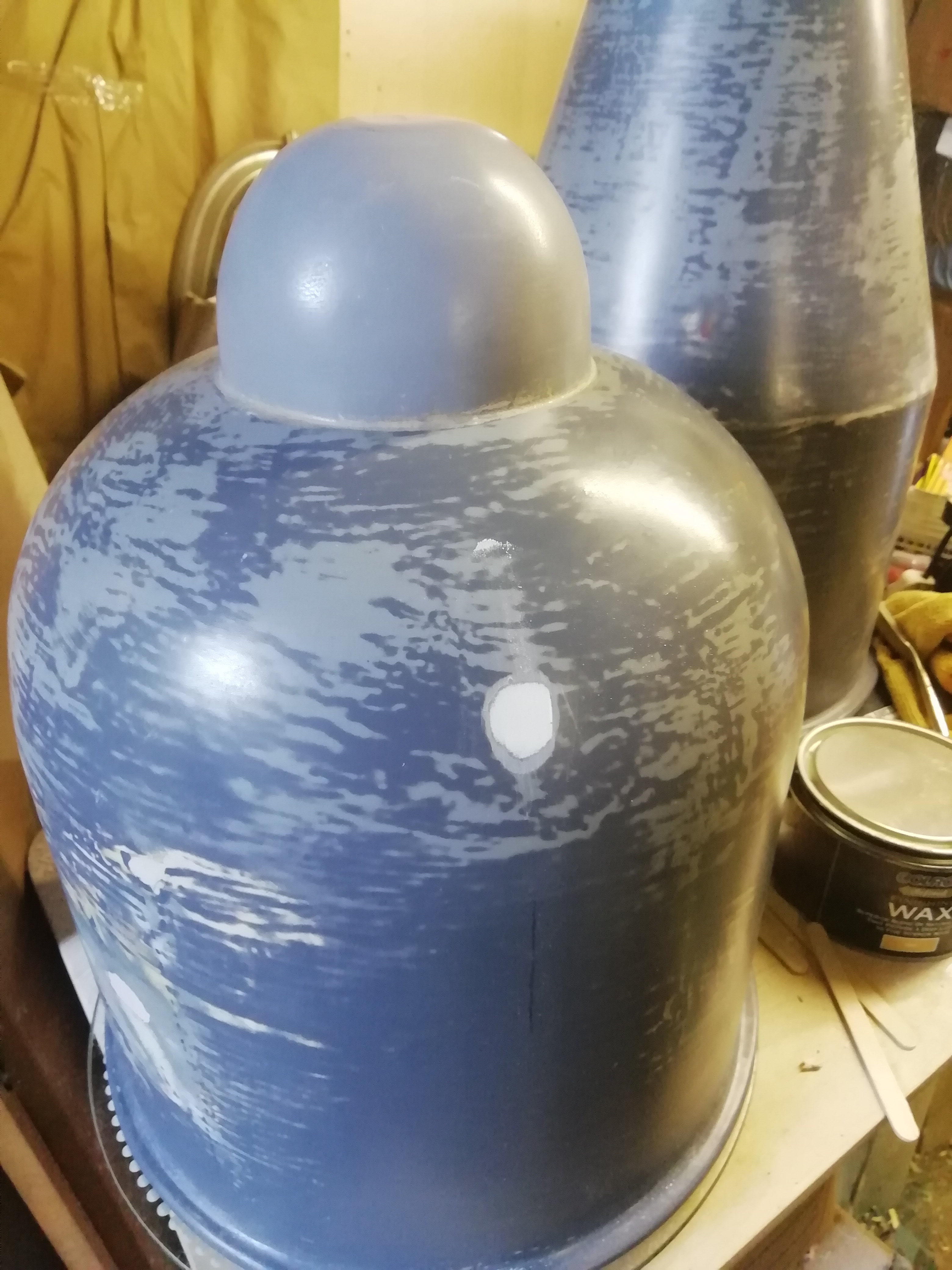

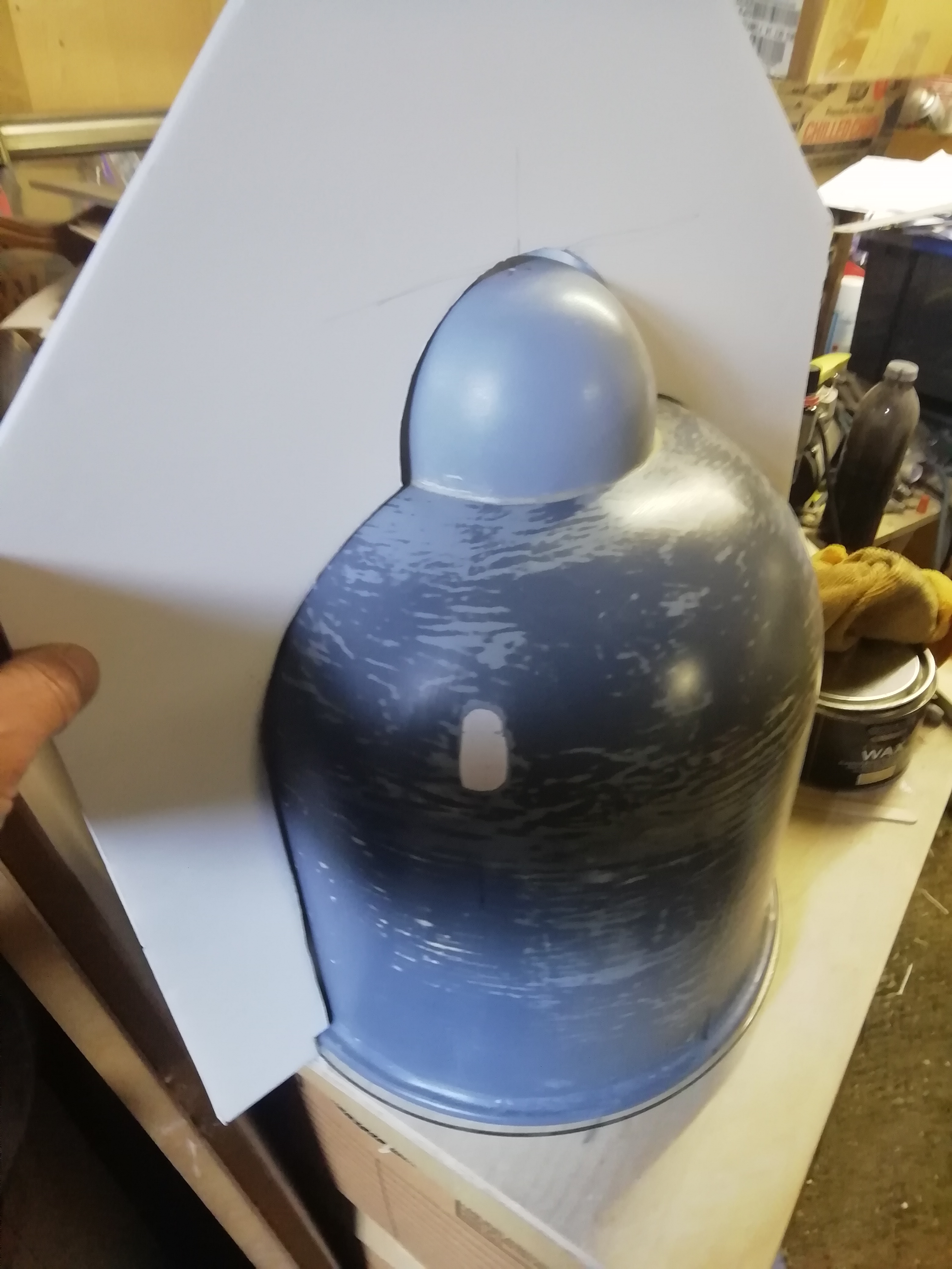

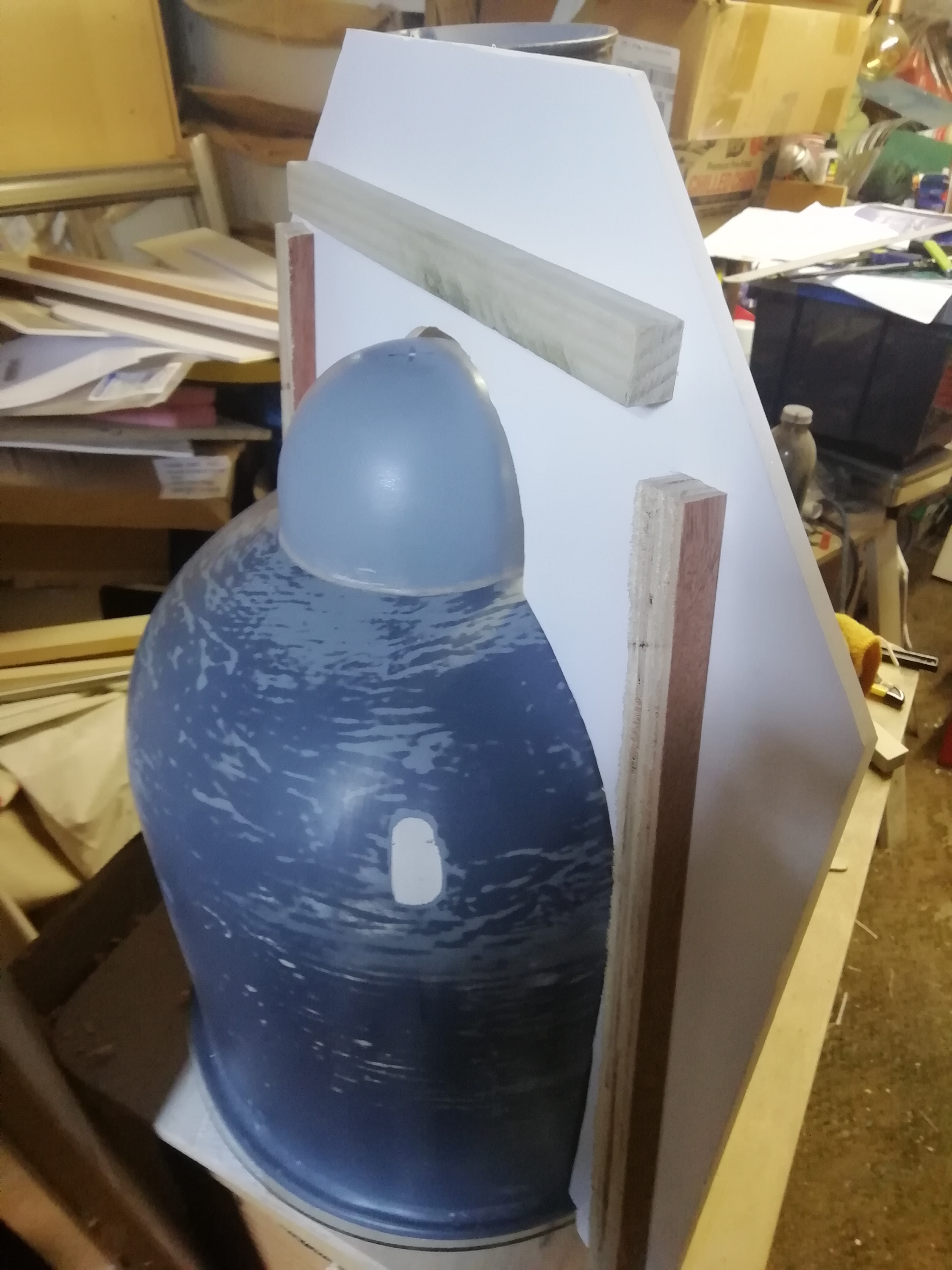

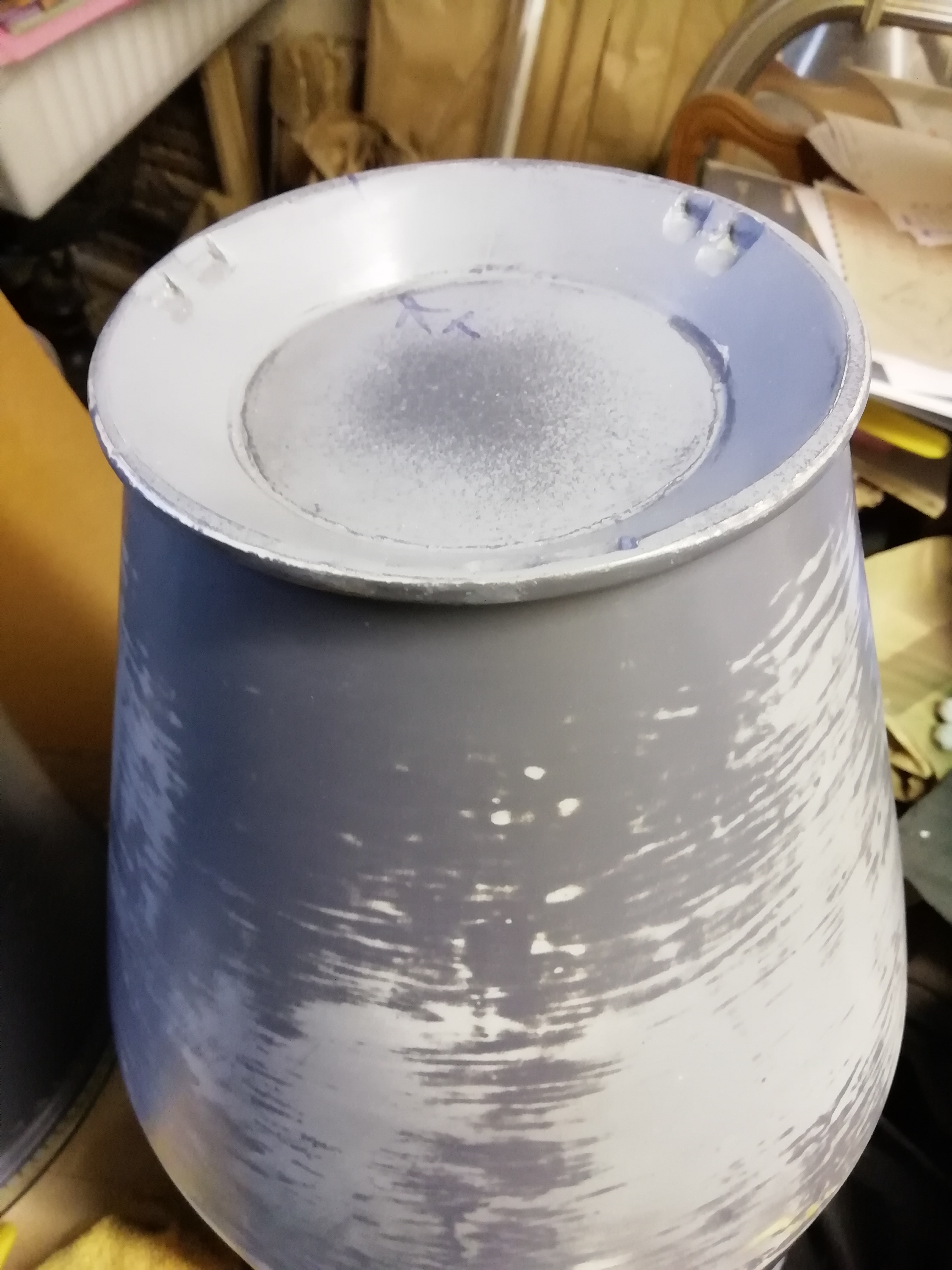

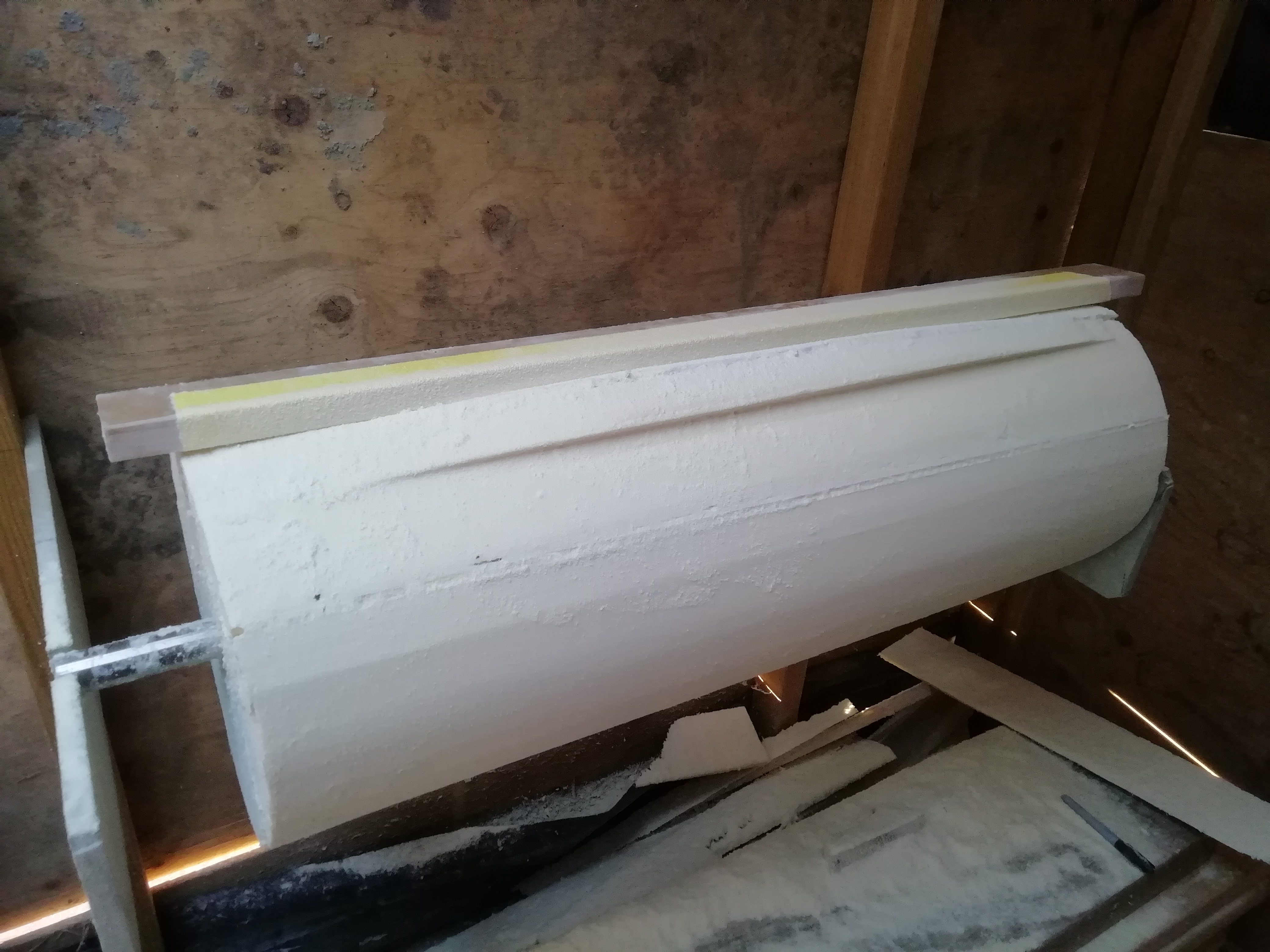

Prepping the plug for moulding... Front half first
3 Part fibre glass mould
Formed pretty well, a bit more time on the mould release on the plug next time, as it stuck a little but happy with the quality of the mould
First pull out of the mould pretty good too, nice flat white. A bit of clean up and starting to take shape
