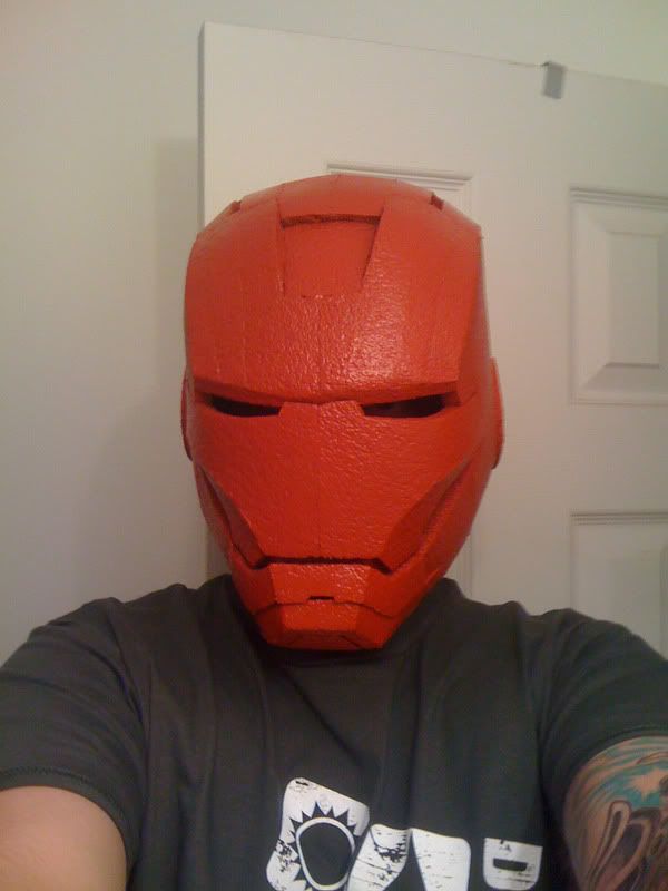

Hey guys. So I plan on posting progress pics tonight. I have both legs done. So I just need to do the abs in foamies and boot coverings and then a few other misc things. I have decided to post a preview of the helmet. Sorry the color is off in iphone pic. Really nice in person. I will do the gold faceplate tonight.

Sweet! I'm amazed at how well you were able to get the foam into that shape!

Thanks Adrian. I will be posting an update tonight with most of the costume on. Of course it is still blue lOL.. but good news.. the red paint matches compression gear almost exactly so that is good.
