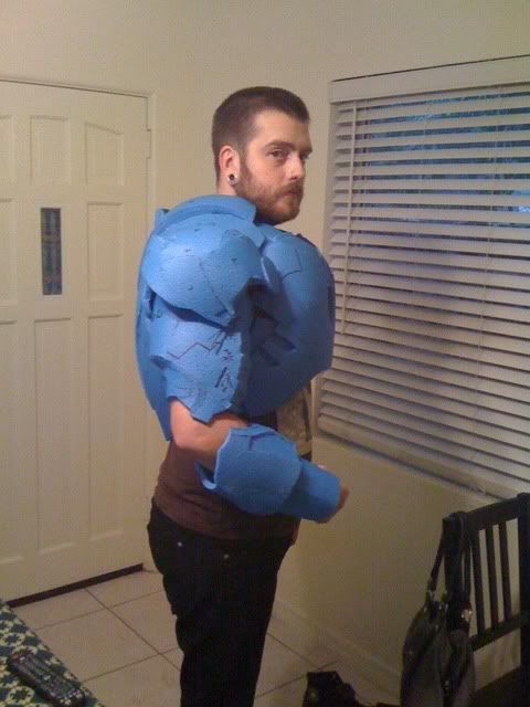

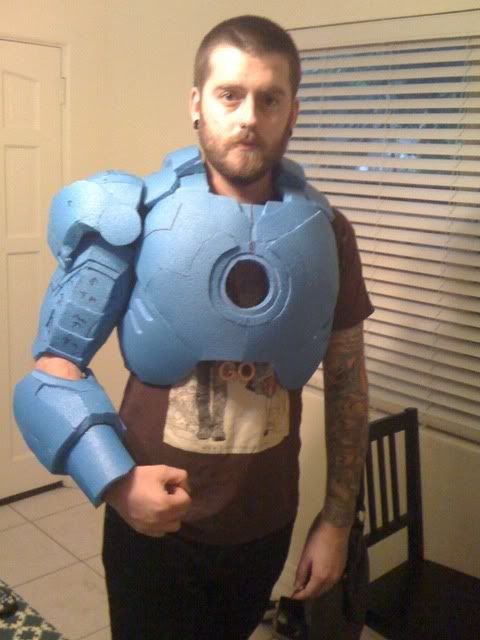

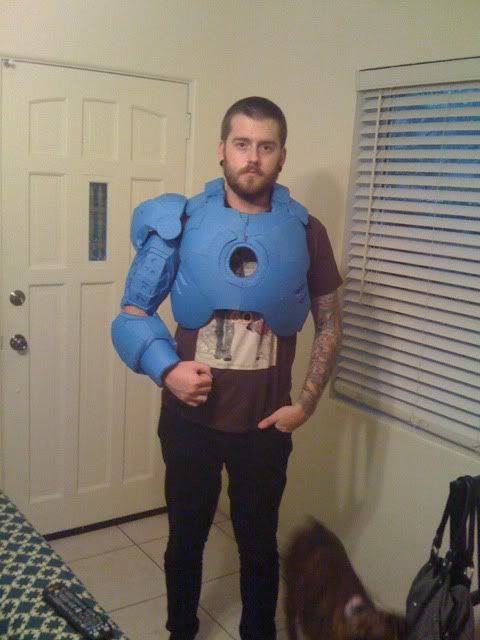

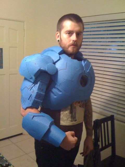

Hey guys. Small update. I finished a shoulder! WOOT. Ha Ha... please note i didn't bother popping on the elbow or helmet ha. Let me know.
Re: Foam Mat Iron Man Mark IV Build New Pics 09/22!
Do you NEED me to keep telling you how awesome this is??:lol Well it is! Is that the "modified" shoulder Robo was talking about? It looks nice, more rounded.

No this isn't the modified shoulder. I already built the shoulder but he made a brace piece for me to keep its shape. It is the exact shoulder pep file ROBO made just modified to be pep friendly. So it is in essence accurateish
That is in essence the easiest build of the entire suit. When building with foam you don't need to do edge pieces because the foam has its own thickness. So basically the trick is to stick with the main shapes and create varrying layers and offset each layer when they meet ot create indents etc.
