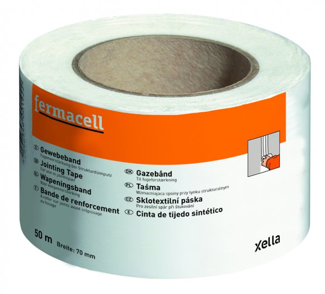

BTW in that video of yours Stealth, i noticed the guy got "Resin" and he mixed it with something else but i donno what i couldnt hear it properly?
And i noticed that the "Fibreglass" he used are strips of some kind like paper-ish, its difficult for me in dutch to find fibreglass because i think they use different names for it so is this fibreglass >
http://www.google.com/images?client...q=plamuur&gbv=2&aq=f&aqi=g4&aql=&oq=&gs_rfai=

Hama, fiber glass can be three types.
You need to use fiberglass or glass tissue and not fiber wool or glass wool (here in italy is called wool of glass).
THe first one is softer and can be laid withour problems anywhere, in undercuts too.
The second one is tougher but will cause you problems while putting it almost everywhere you have an angle to cover.
Fiberglass is usually known as FIBER GLASS or GLASS RESIN. HEre in italy is called: GLASS RESIN and the fiberglass is the thing I was talking about.
Hope this helps ;)
Also, urethane is for slush casting, that means, making the resin rotate inside a mold. It's quicker, cleaner and a little more expensive. The final risult is a pretty light cast, but it's also fragile.
Fiberglass casts are stronger, but it takes longer to make one, it's messy and it STINKS awefully! Also, you'd need gelcoat to brush as the first coat and then reinforce with fiberglass. This casts are usually heavier.

So this is the one i need > http://link.marktplaats.nl/335568478
We call this Glasweefsel ( literally means Glass Tissue )
is that the one i need?
THAT'S WAY TOO BIG! That's like a...i don't know the english name, but it's not what you need. Look for something thinner...WAY thinner...
Try at any home-depot or home supplier. They should have it.
I think it's called: HARDWARE supplier, something that sells stuff like screws, tools, nails and stuff like that ;)
Get Polyester resin if you wanna use the fiberglass.
