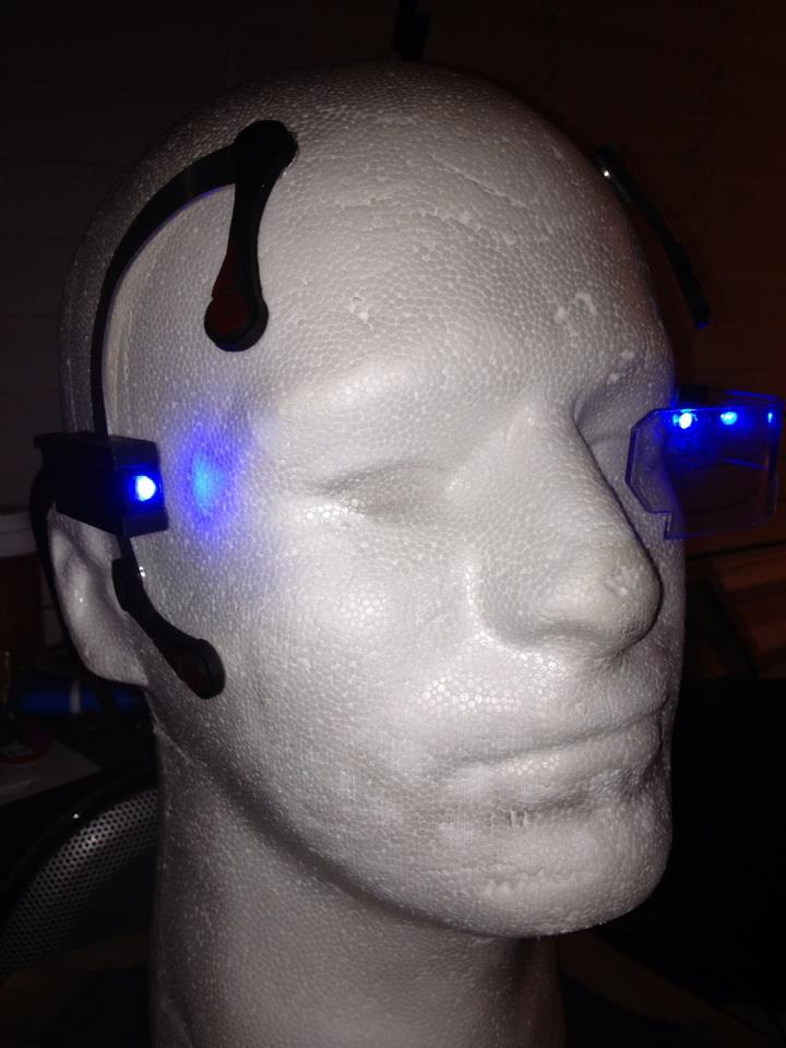

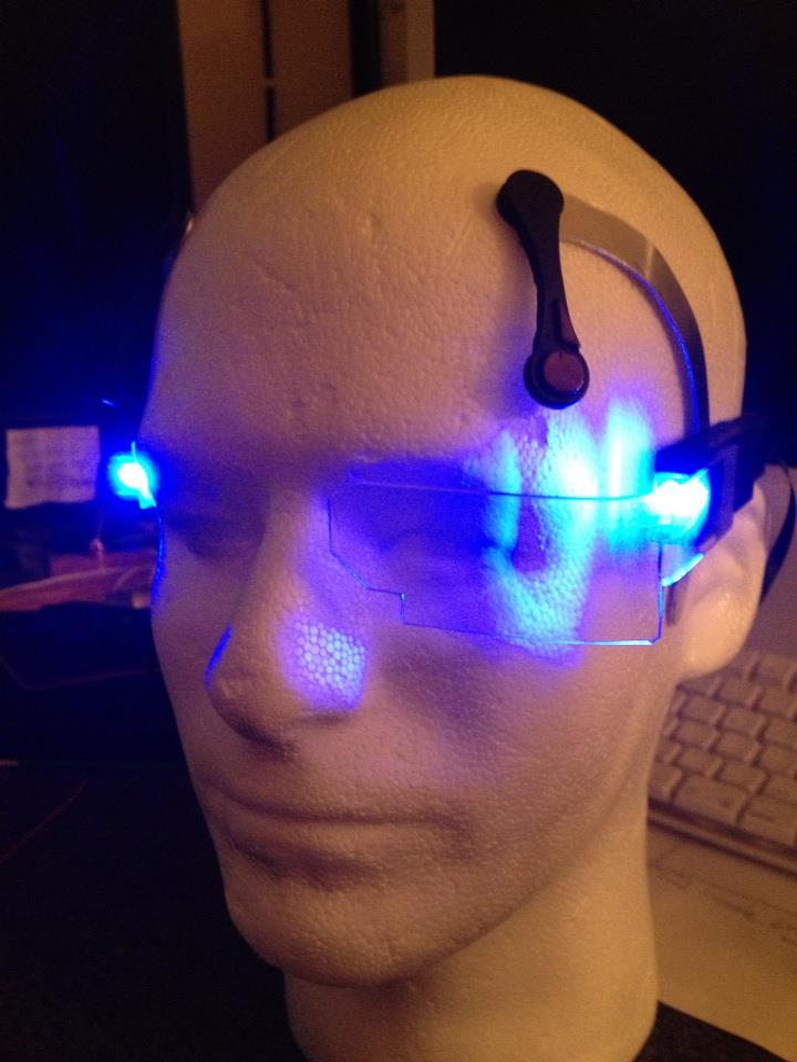

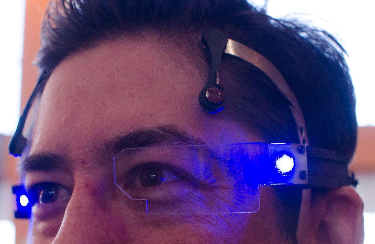

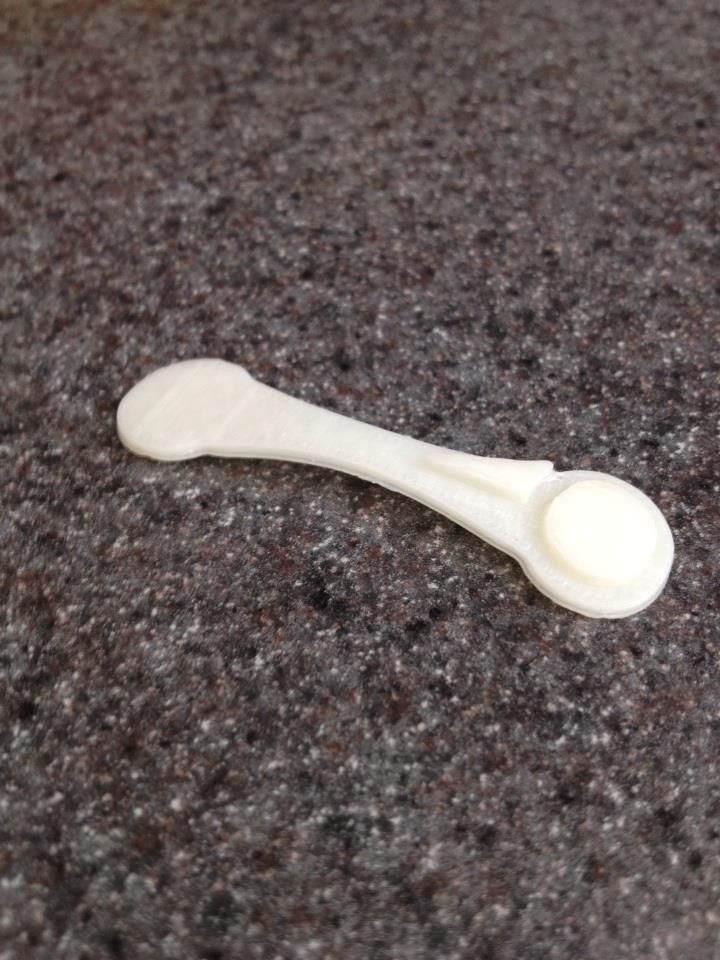

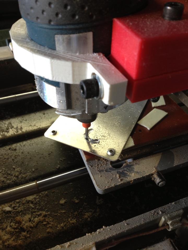

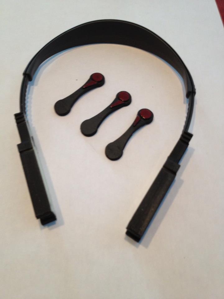

I used Google Sketchup to draw the parts that I printed on a 3D printer. I also used CamBam to draw and cut out the aluminum parts on a small CNC router. For the clear lens I used a piece of plex that I cut/shaped with a Dremel then used a heat gun to bend it into shape. For the back strap I used an old pair of cheap headphones and removed the ear pieces/telescoping sections so that only the top strap remained. For the LED's I used some high intensity 12V LED's from superbrightleds.com and wired them to a small 12V A23 battery and holder that sits on the very back of the headset. Now that the movie is out and I have seen the back of the headset I will be making some changes to the back strap to make it more accurate.

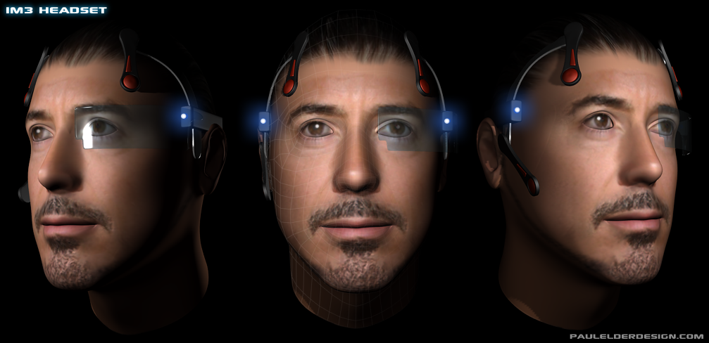

Nice work wamser_e. Here's mine I still need to tweak the details of the led housing, couldn't find a better reference. All modelled in 3DS max, I may have spent a bit too much time on the tony texture but is was a generic game mesh I did a while back so wasn't too labour intensive :lol
Open for improvements though :cool
