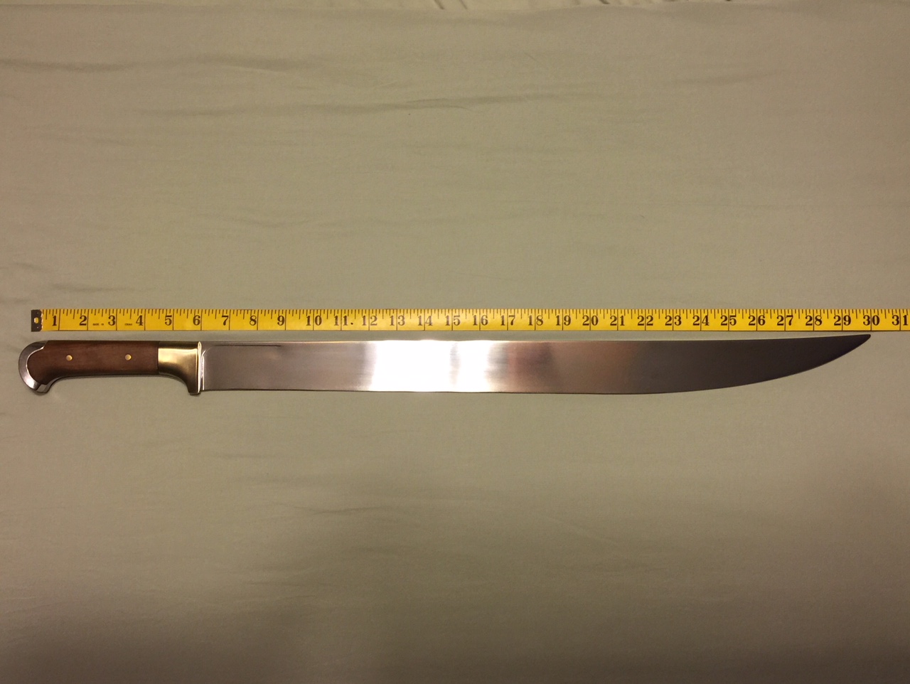

I worked with a 3D modeler on Etsy to make a 3D printed version of the Indiana Jones Temple of Doom bridge machete. I needed a lightweight prop I could carry for cosplay. This is my first time finishing a 3D printed prop and I am a newbie with an airbrush. I am hoping this group can answer a few questions. I have assembled the prop and primed and sanded it smooth with filler primer.

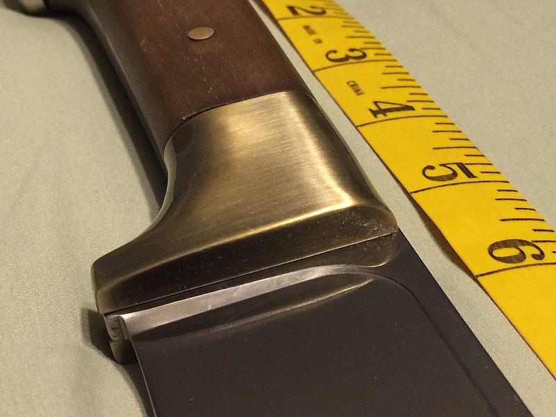

On the handle is a brass section. I am trying to replicate the polished brass look in the attached photos. I tried using Alclad gloss black base and the Alclad polished brass paint but it came out very dark and dull. Are there other paints or methods that could be used to achieve something close to this? Would rub and buff work? It is a cosplay prop and will be handled thus the finish would need a gloss clear coat.

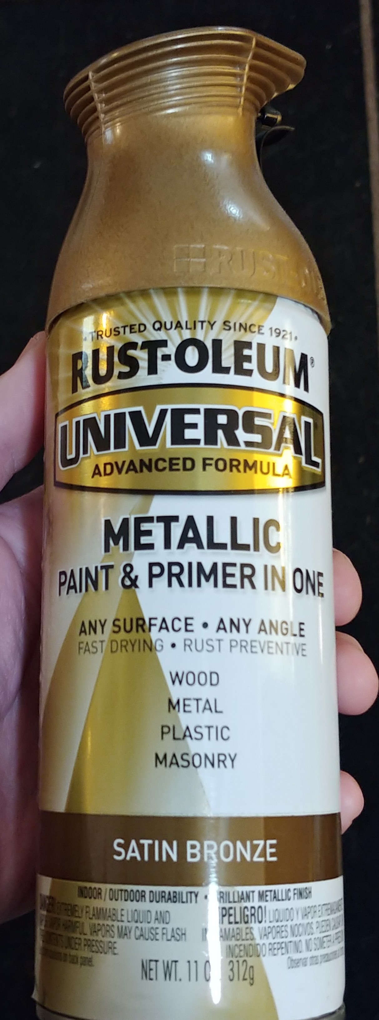

As far as the brass, I've had good luck with this paint.
Dann thanks for your reply. The Satin Bronze looks good. Did you apply it directly to the primer paint? Did you also use any kind of clear coat on top?
There may have been a little primer there, along with some Bondo, but it was smooth as a baby's bottom.
Nope, no clear coat. A little polishing with a dry cloth after it was cured.
Thanks, it's fine. Pretty durable, I'd say. You've just gotta let that paint cure, ya know?
And the burnishing/polishing/rubbing with the old t shirt helps quite a bit. I do that with pretty much everything I paint.
