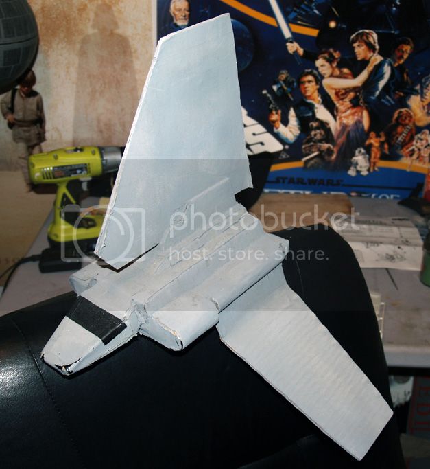

If anyone saw my star destroyer thread, you also saw that in 7th grade, I had my a shuttle based on just a few pictures I had back then. I never really finished it, and only just quickly sprayed it gray with primer. Heres how it turned out. Not too bad considering how long ago I made it.

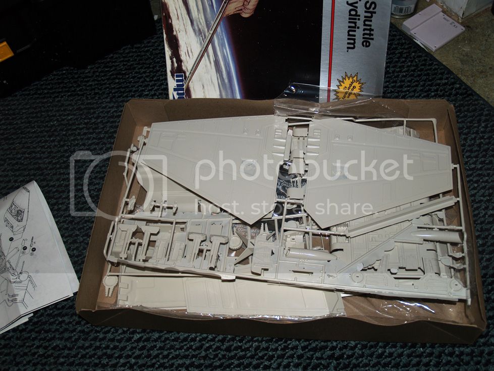

But I wanted something better, and heres what I got. The box says 1983, so wondering if its from then. Not sure.

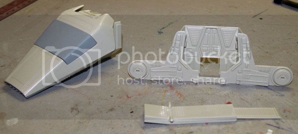

So far I took the window, that was a dark clear, sanded it down a bit and have sprayed primer on it. Now I need gloss black.
I ran into this problem where there was a gap here in the nose part.
So I took some styrene and fixed it up a little.
Once painted, it should look much better.

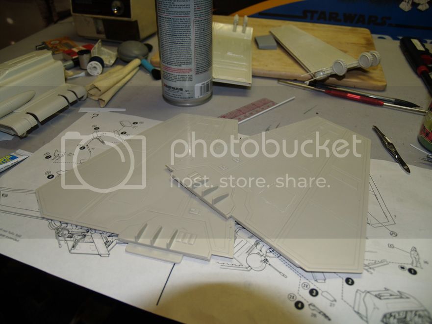

Heres what I have so far.

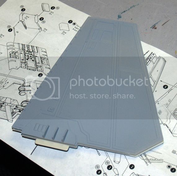

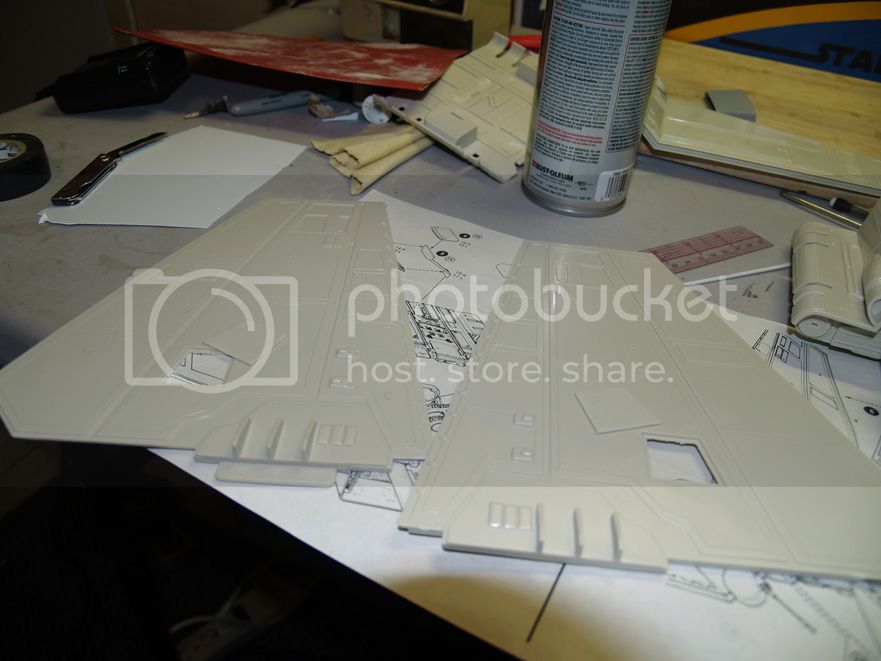

So what I have now.

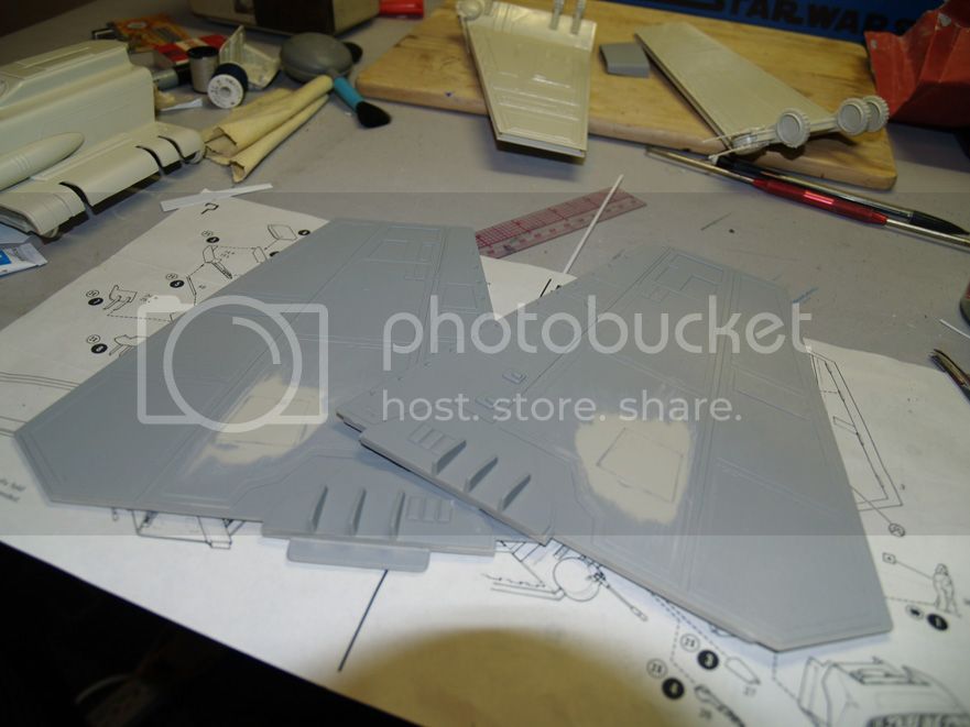

The main fin had these weird holes in them, so had to fix it.
And now its not too bad. If the light hits it just right, you can still see the square a little bit, but not to bad.
