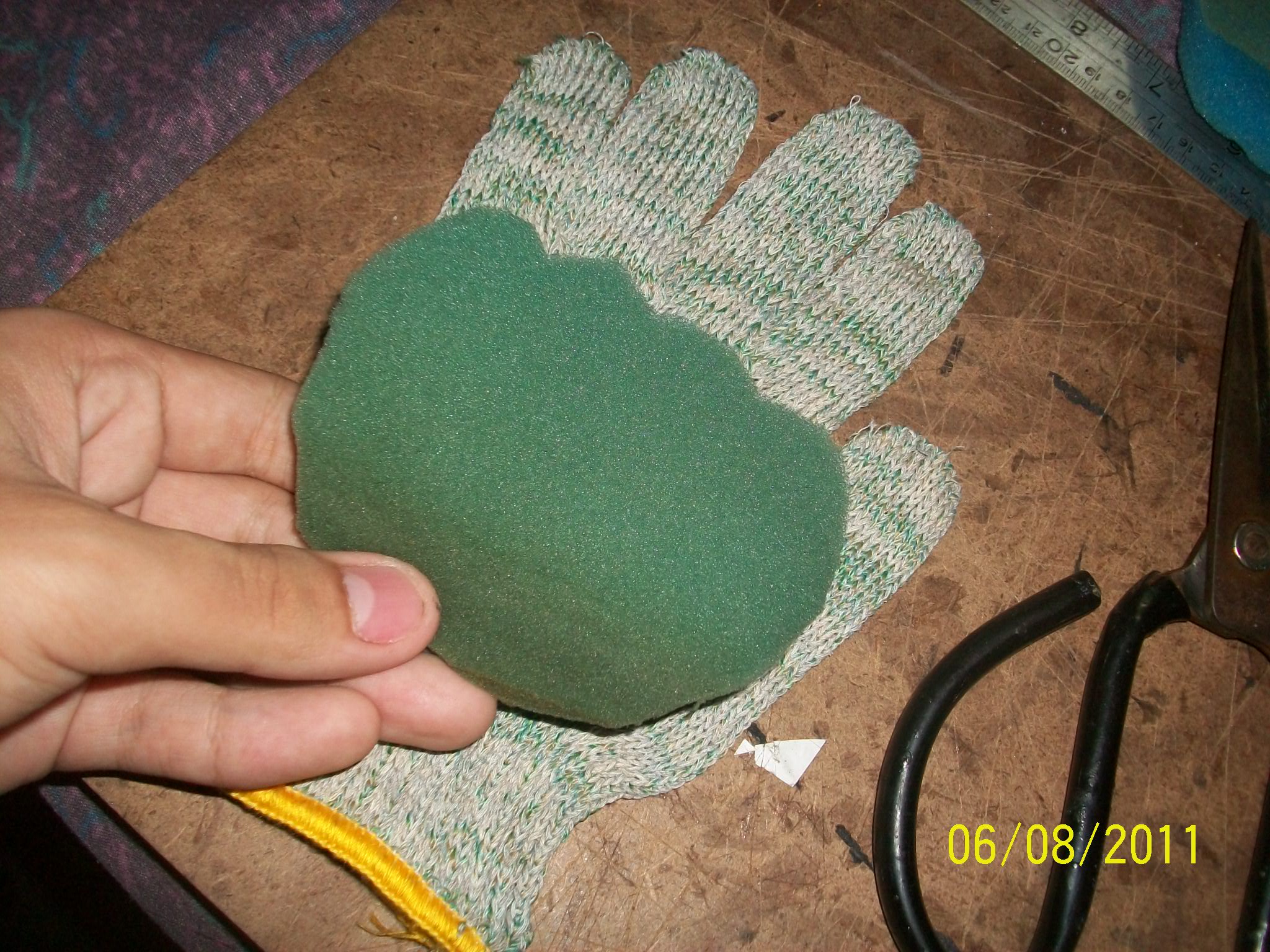

Measure the back of your palm horizontally and vertically so you'll get a square shape..And then trace the shape of your fist and cut it on the foam..

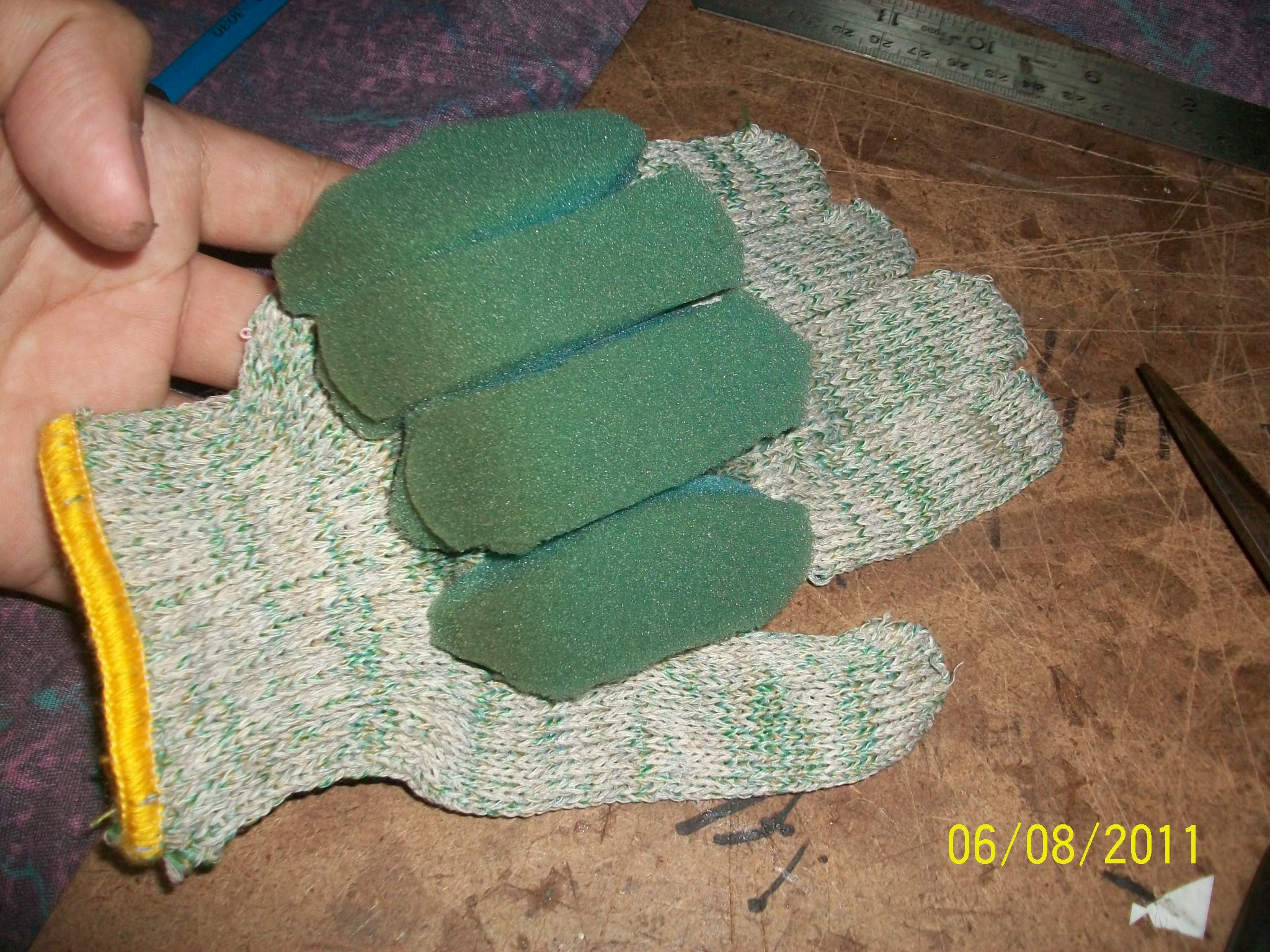

Cut it like how the bones inside your hands are shaped and glue it in place using Contact Cement...

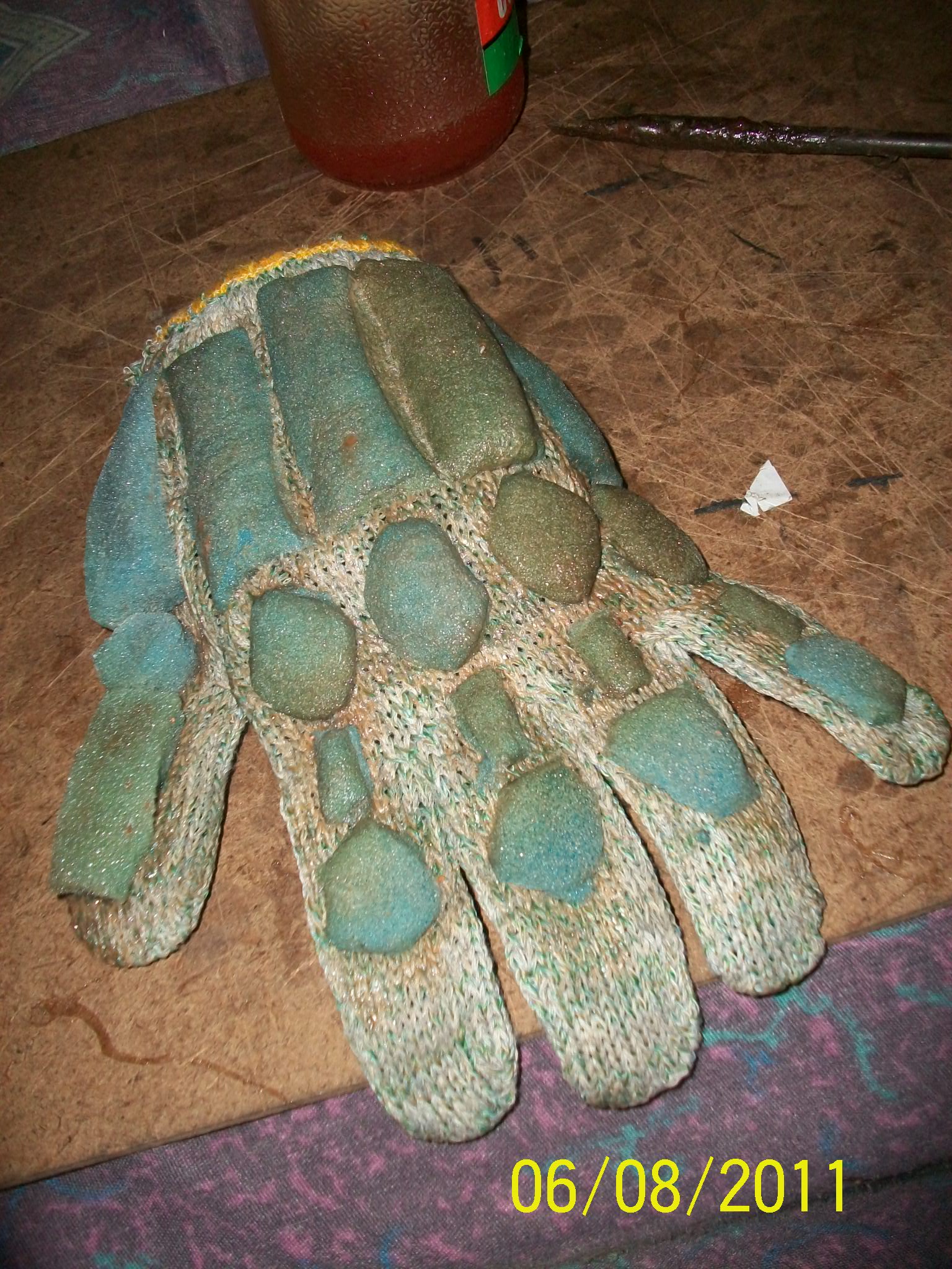

Just continue cutting shapes..The fingers, joints, etc... Me I just cut a round shape on foam for the finger joints and stick it on the gloves..

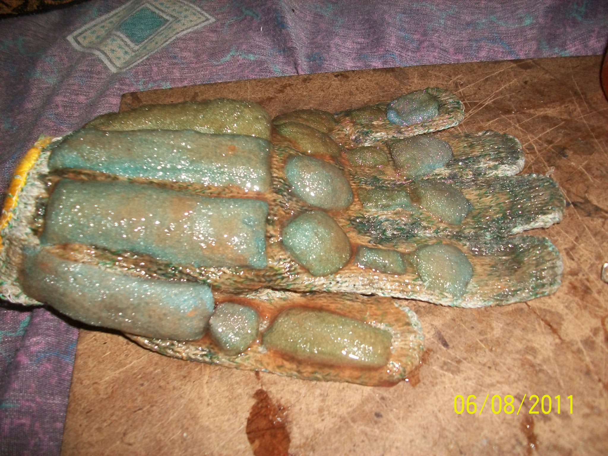

Coat the foam with contact cement and let it dry for an hour.. Once its dry you can mold the foam to your desired shape.. This step will make the foam rounded and has no sides.. I mean when you cut a foam, definitely it would shape like a box so in this step you can make the sides of the foam rounded like in the picture....
Step 5...
Once you're done and happy with the details.. Coat the foam again with contact cement or Latex..Since latex is not available here in the Philippines I just used contact cement.. Put 2 to 3 coats of contact cement.. In this place the foam will rubberized and has a less tendency to rip apart.. Be sure that all parts of the gloves are sealed and coated with Contact Cement!

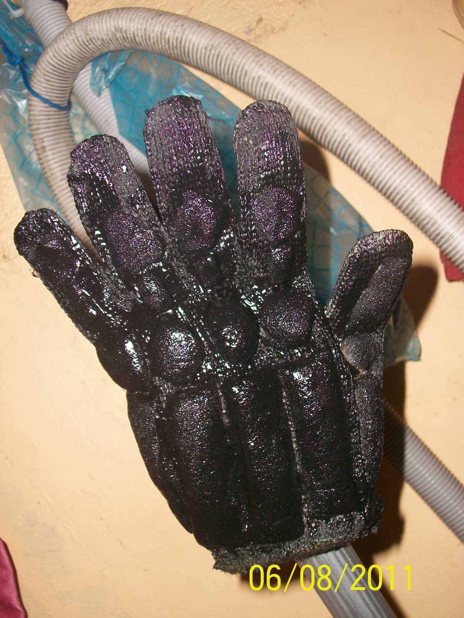

When the contact cement is dry and you are comfortable with the foam and you think that it wont rip off you can now proceed painting.. I primed it with black spray paint..

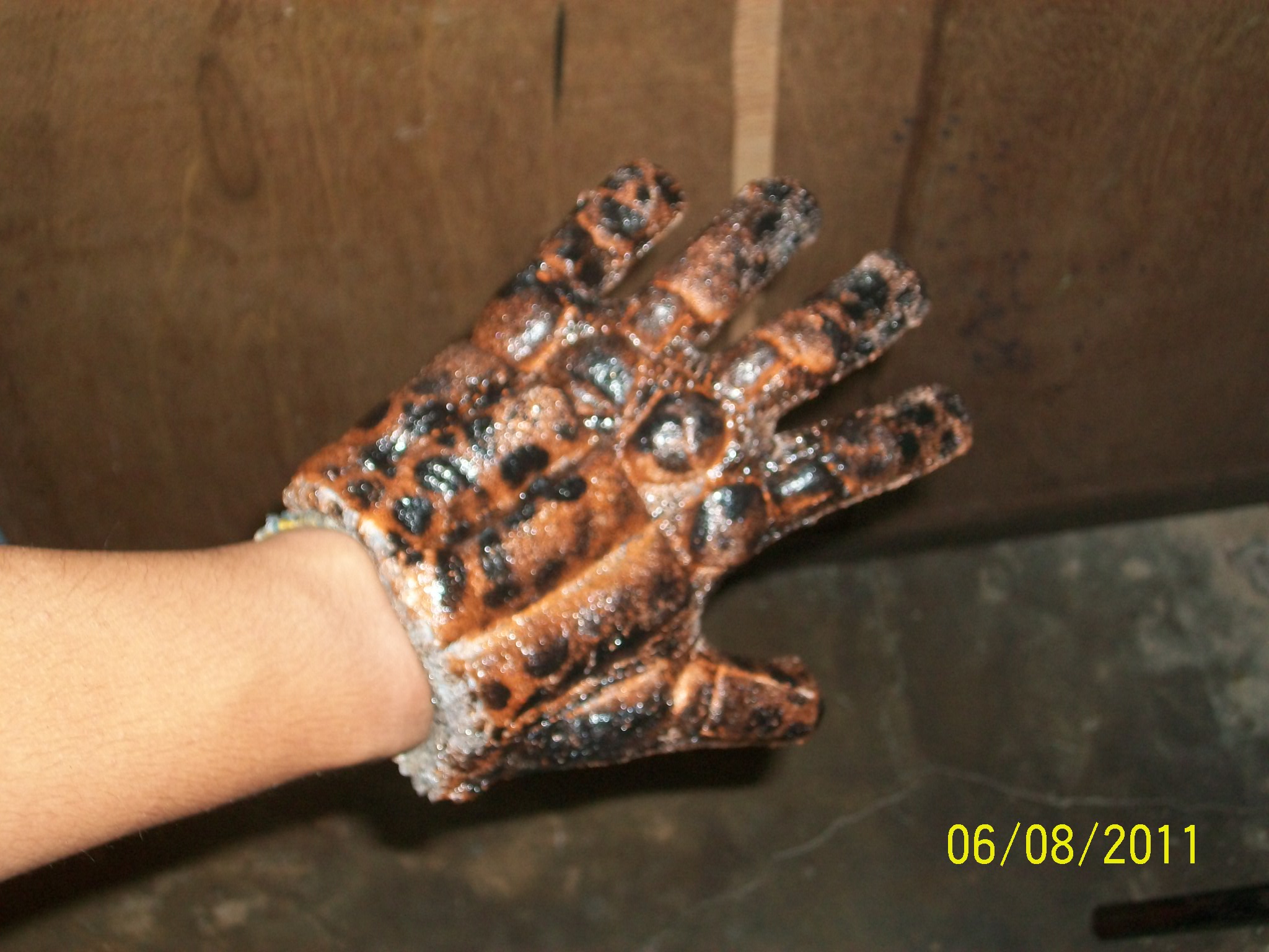

Once the primer is dry you can now paint it with the color you want..I suggest that you coat the base color two times or the gloves will just absorb all the paint that you put into it.. You can now put more color details on it. You can put Predator spots, weathering, etc... Im sorry about my paintjob LOL.. I'm not that good in blending colors yet..
