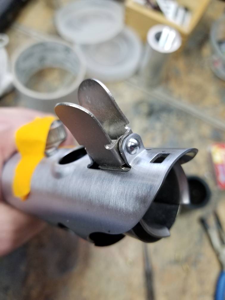

I'm trying to replace my graflex blade holder, but I don't know how to remove this pin in order to remove the bunny ears. Help!
Use a small punch and place it on the small end of the rivet/pin (the end you have showing in your photo) and gently tap the rivet/pin loose. Then you can pull it out and remove the bunny ears.
I'm not sure why, but that pin is wedged in really tight. It doesn't seem to move it all. I'm afraid to hit it much harder.
Yep, that's it. Line up a small punch/nail setter smaller than the pin hole and tap away. It will take a little bit of pressure but you can whack the pin out.
I've run into one or two pins that have taken a surprising amount of force to get out. (I think the worst was one the pin bent while still in the collar in the ears.) I taped a mousepad around my flash to protect it from the hammer.
Shoot it WD-40, And let it sit for a few hours, then give it another shot. You are also working against decades of corrosion inside that joint, most likely.
Another piece of advice: apply painters tape around the area to avoid any unintended scrapes and nicks as you attempt to remove the pin.

If it is made by the company you think it is, then that "rivet" is actually screwed in.

That's good to know just in case it is screwed in. I don't want to damage it trying to get it out.

Yeah, might be worth cutting a small notch into the bottom of it, so you can try a small flathead driver rather than trying to grip the top with pliers or something.

If it's a TGS, it's a threaded screw.
I think with the drifting of the back of the screw we may just have a problem now..
To unscrew those tight pesky bunny ear replica rivets (screw version)
I use hot glue on the end of a pencil, let it totally cool down and give it a snap counter clockwise
