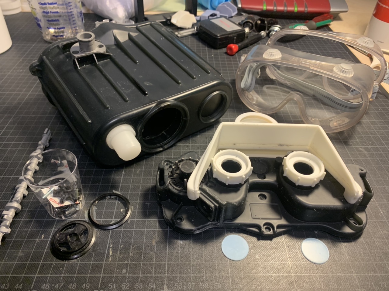

Here‘s a kit I put together for a customer...features one of my old viewer hoods, since that part is not rebuild yet
sloooowly proceeding to cast the main bodies and the other greeblies. Will have to redo the mold(s) once more eventually...had a bad batch of resin, that cured foamy and the cast parts STUCK to the silicone, causing some damage to smaller areas of the molds
decided to have the front lense ring 3D printed, since this part is so intricate to mold/ cast
ah well...this run is not under good stars. :/
