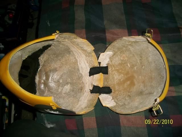

I found this posted on a different board, its a person using elastic.
http://i187.photobucket.com/albums/x105/heroslayer5/100_1163.jpg?t=1285210822
I like the idea of elastic because a hinge seems either flimsy, uncomfortable, or might cause damage if dropped or twisted. I also like the idea of magnets, but it would have to be done right.
Ill play around with some ideas and definitely post what I come up with but I would love some input before I dive in blind.
Elastic might seem an inferior option at first, but a metal hinge requires cutting away part of the helmet's exterior for it to open. All of the Toei helmets use elastic, AFAIK, even the heroes. But if you're going stunt-style (with the external latch closures) then a metal hinge wouldn't be too far out of line with the aesthetics.

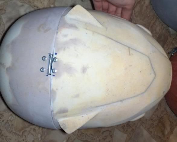

I was just playing around on the site and I happen to see your post. I dont know if it helps or not but on the green ranger pepakura build I just finished I used two small gate hinges. With a little work they work, they cant even be seen from the top of the helmet.
Hope this helps! If you need better photos of it let me know!
Do the hinges hurt the top of your head when you where them valon?
Not at all! Since I took and used two of them together, it folds with the helmet. I had to also bent the ear of the hinge so it had more of a curve with the helmet.
Great idea with the double hinge! I think Im still gonna stick with some elastic for simplicity. I just finished cleaning up the seam so hopefully by the weekend Ill be ready to cut it in half and work on the inside.
