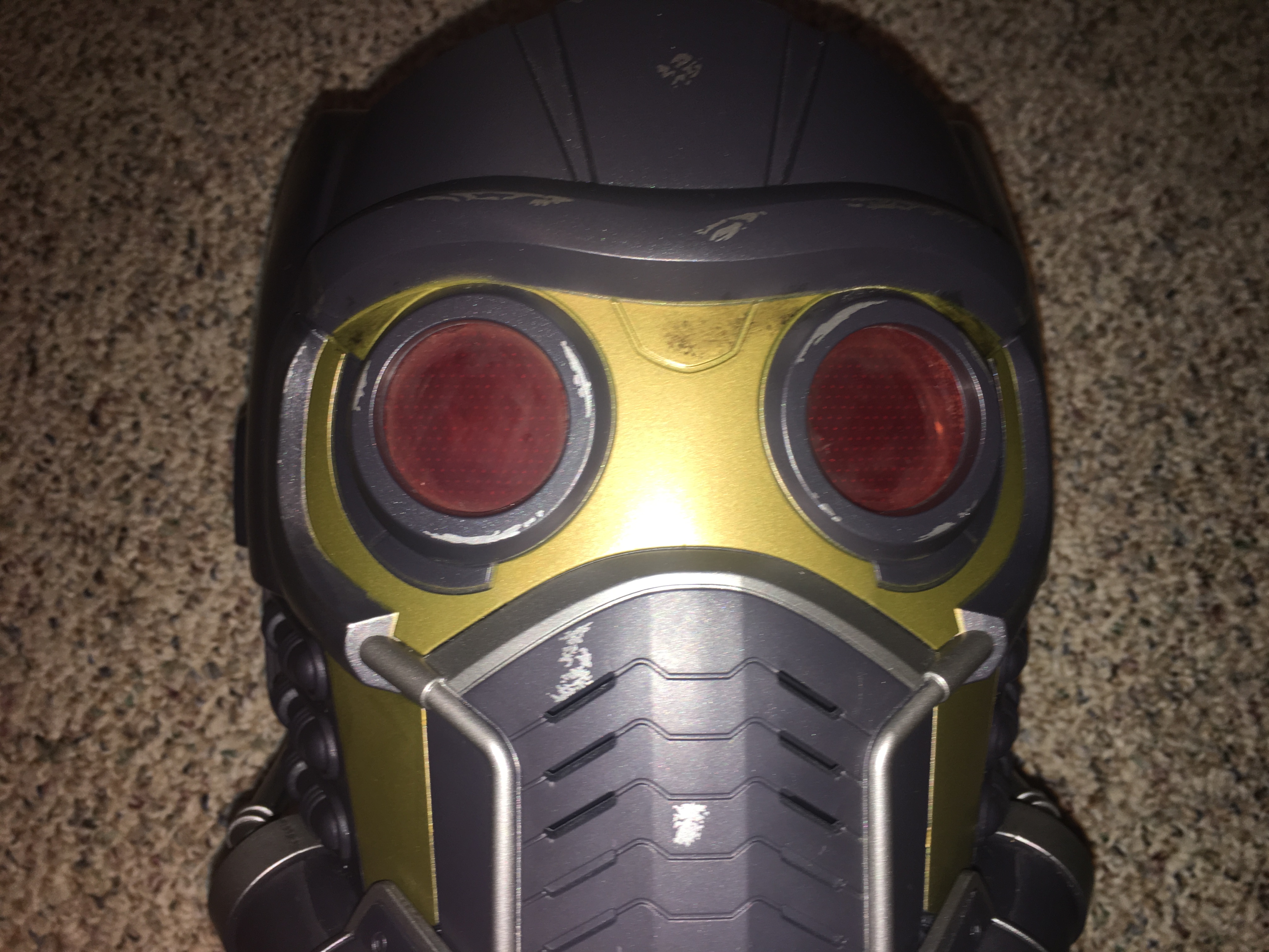

I have a Star-Lord Helmet with the foggy lenses like everyone else. I tried all the normal things everyone else tried to no avail. Then I went through my Stormtrooper kit and pulled out the NOVUS #2 fine scratch remover.
I tried it on one of the lenses and there was a huge improvement with just a little bit used. I might try a few more rounds, but for now I call that a success!
Before...View attachment 752618 After...View attachment 752619

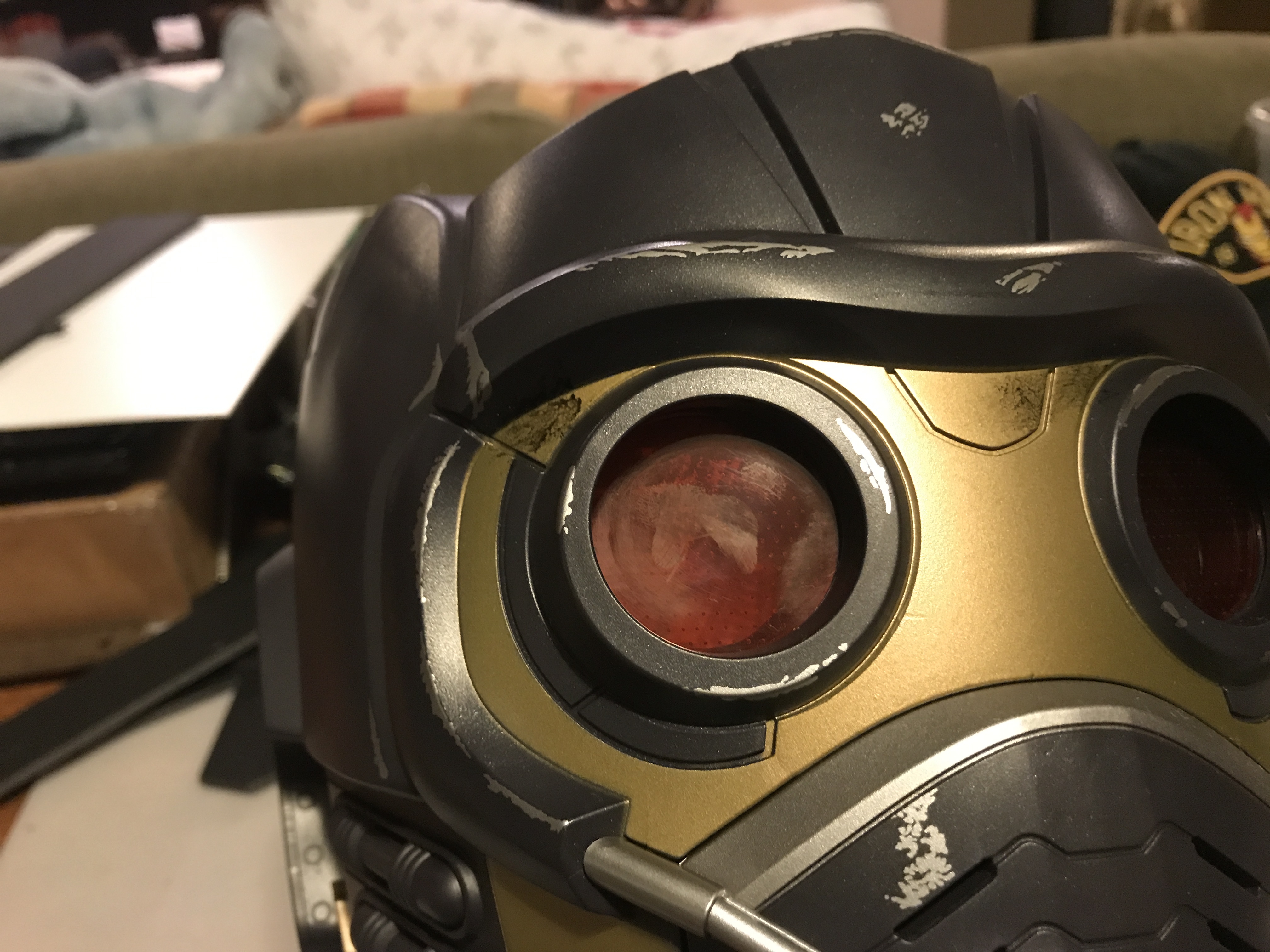

K, so here's my update on the NOVUS #2, I think it worked pretty well. I can actually see out of it, which was borderline impossible before, so any improvement is a good thing in my book.
I just used cotton swabs and put a little on the end and followed the instructions, applying in a circular motion until dry and buffing with a tissue, nothing special.
Here's a before and after with flash
The difference is very noticeable when the eyes are lit. I think this will suffice for me for Halloween.
