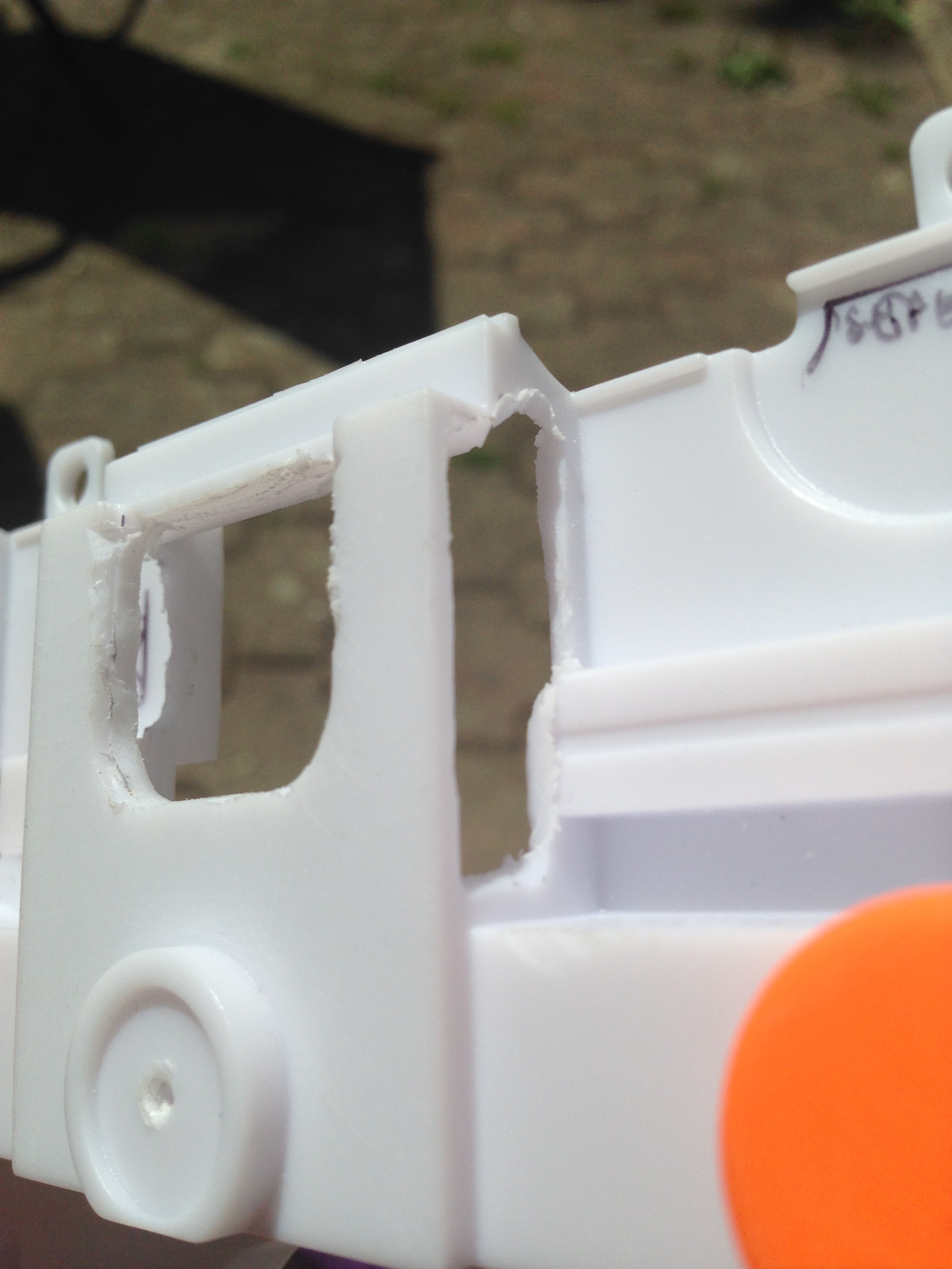

First I cut out the solid piece to make it look more like the real thing. Obviously clean-up will be needed.

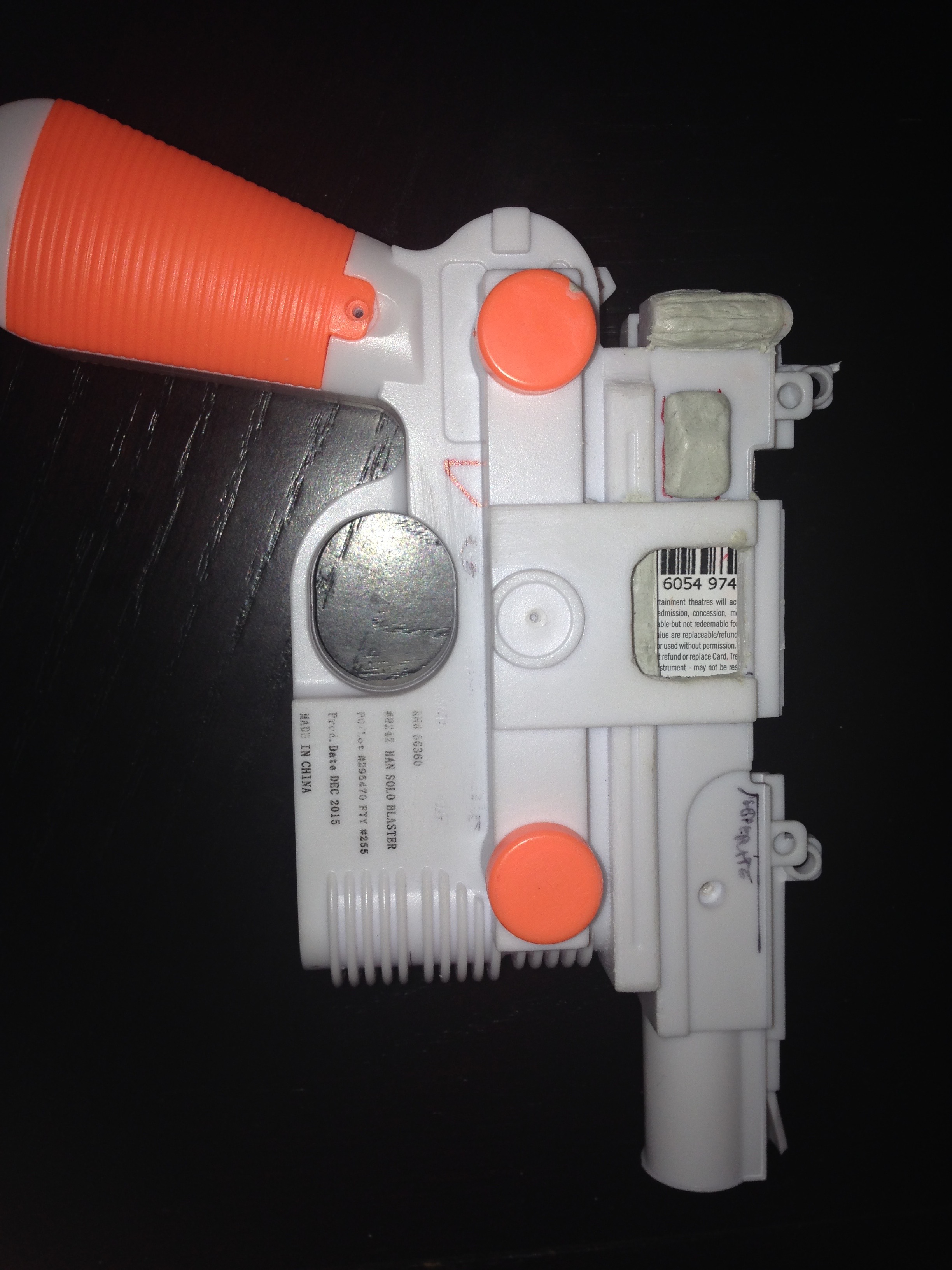

Next up I needed to fill in the long strip thing. As you can see I made good use out of an old gift card... Something I have a lot of...
I filled in what needed to be filled in with some apoxy.
I just have to wait for all the apoxy to dry... this is what I'm left with at the moment.

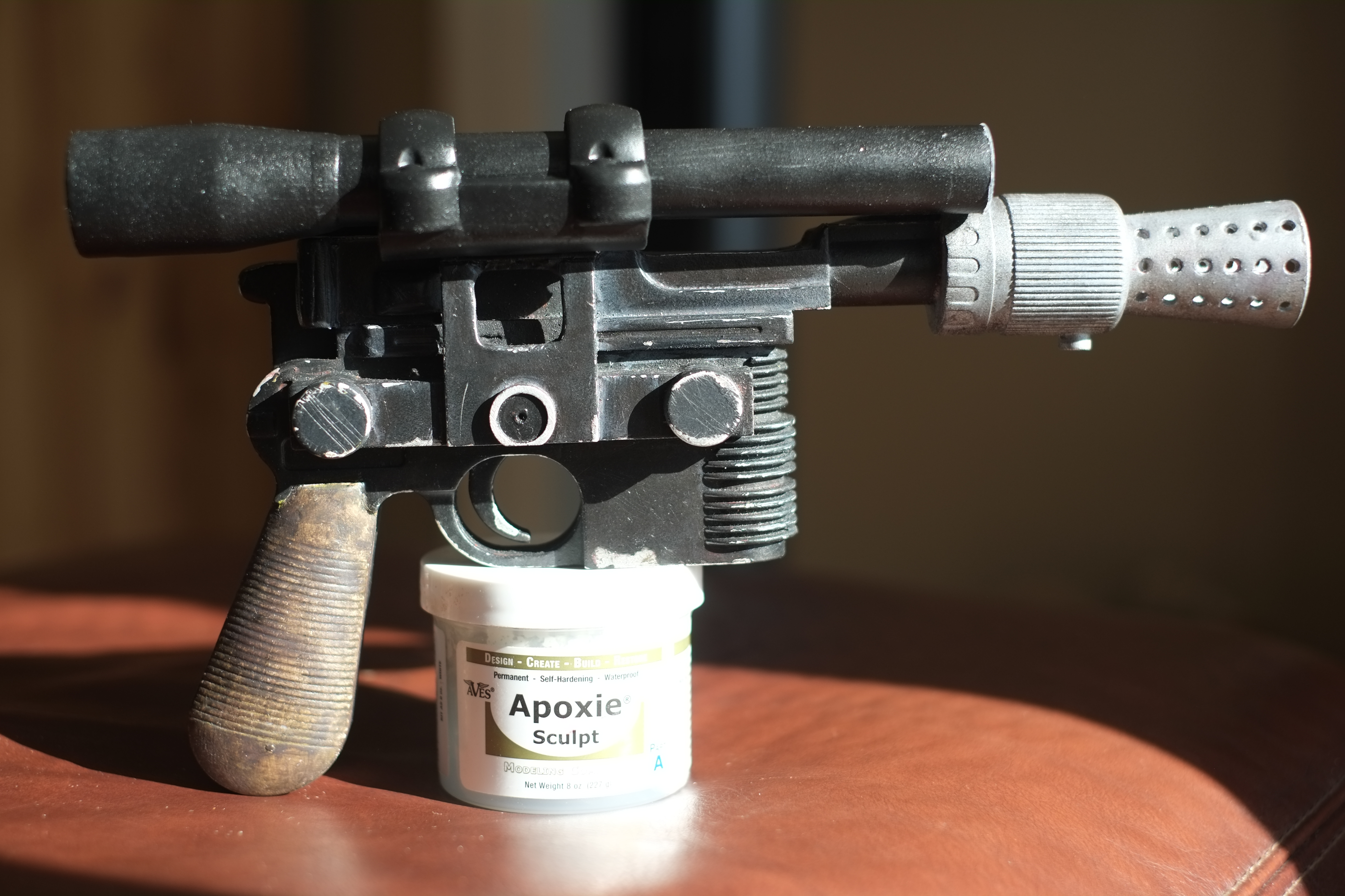

EDIT: I don't have a shot of the original blaster, but this is one hot of the finished piece.

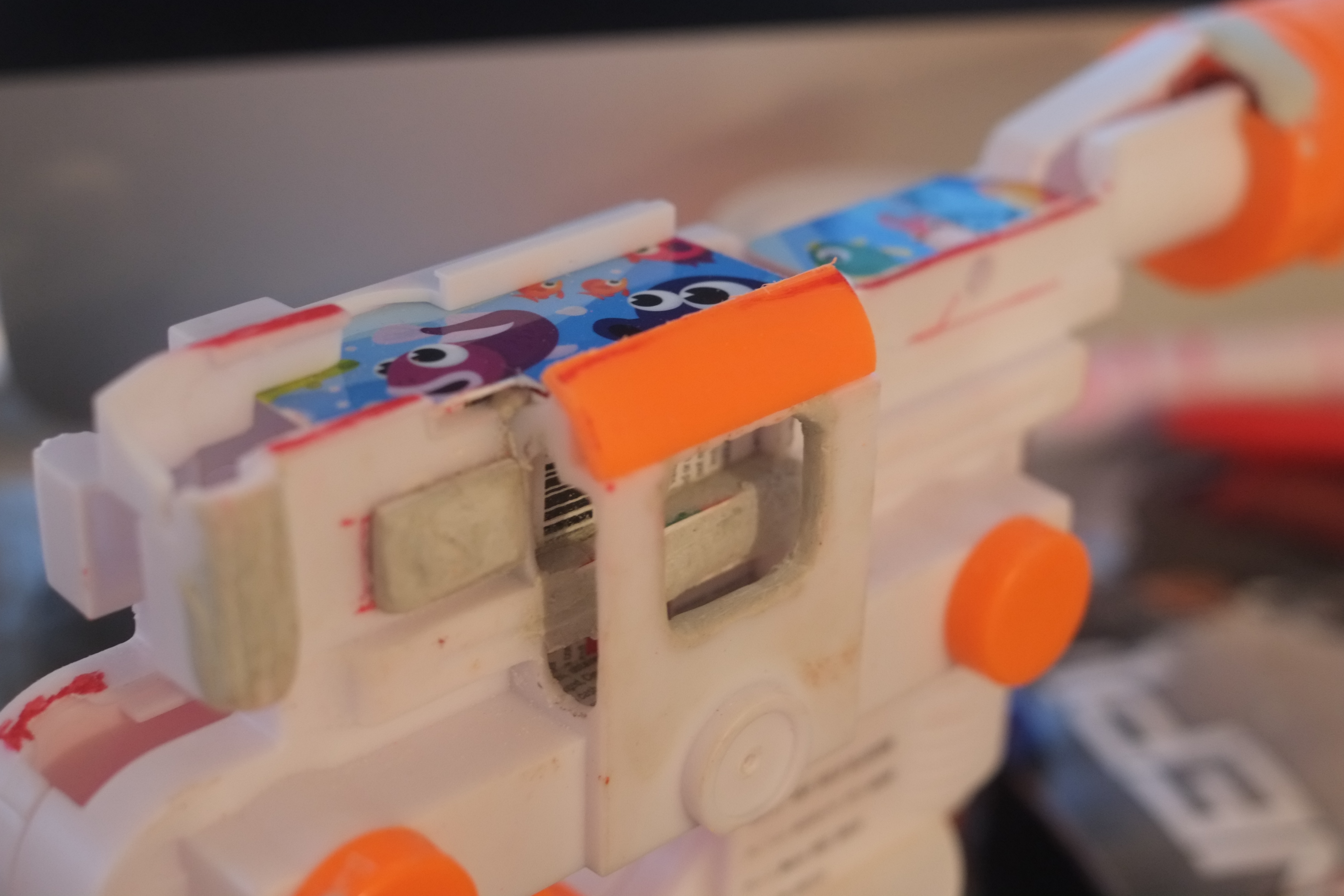

Next up I worked on the top. I filed down what need to be and put on the first top piece (cover-up) once again using a gift card.

--I marked the places I cut off with red.

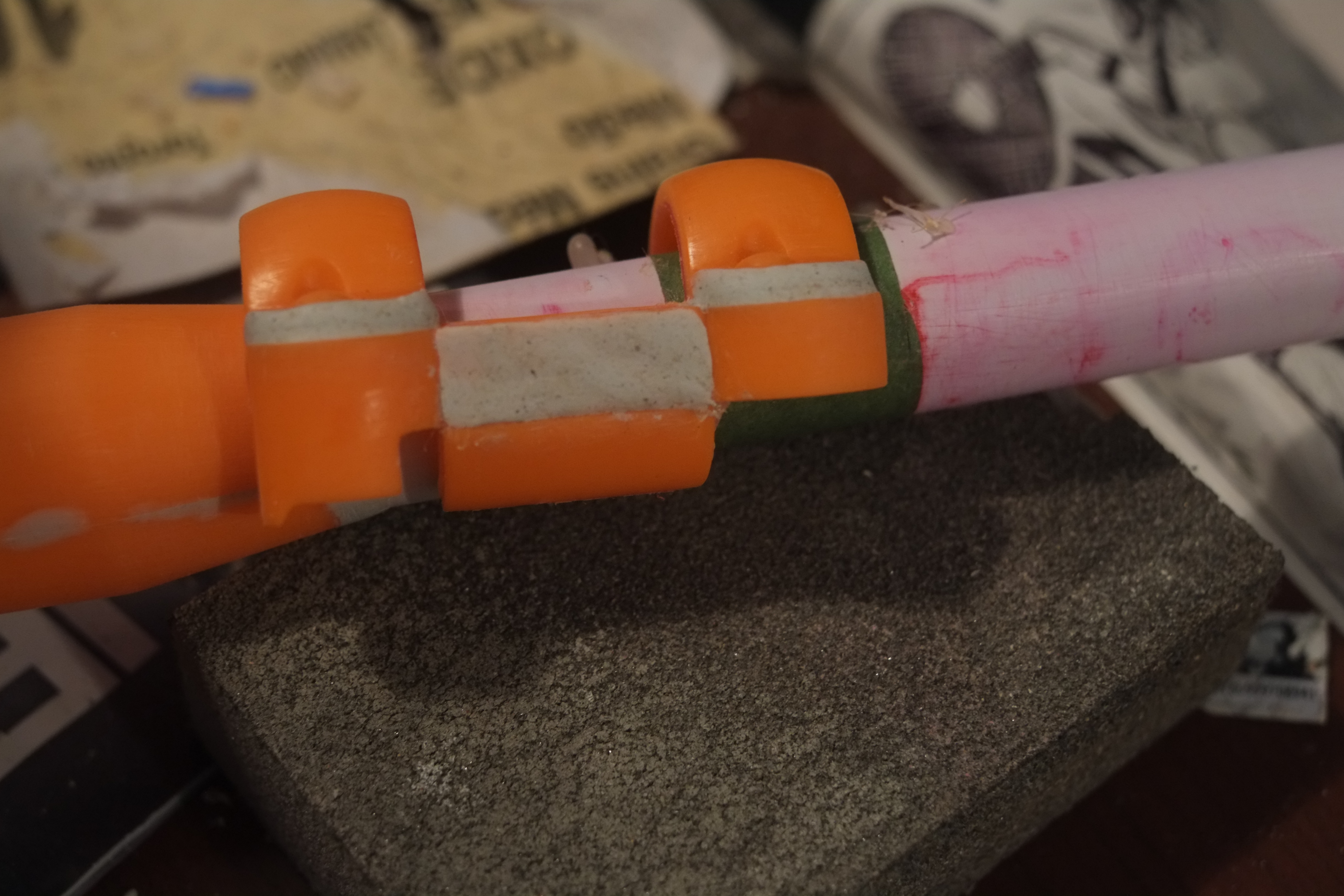

Not a whole lot was done today. I mostly just focused on the support for the scope. I dremmeled out the pieces from the original scope, I had to sand them quite a bit... The plastic this is made from doesn't really like being dremmeled, so there is a fair amount of clean-up needed. I also cut out a piece from the original scope barrel and used it to make the curved part (see first picture). More of the top gap was filled in with, you guess... gift card.

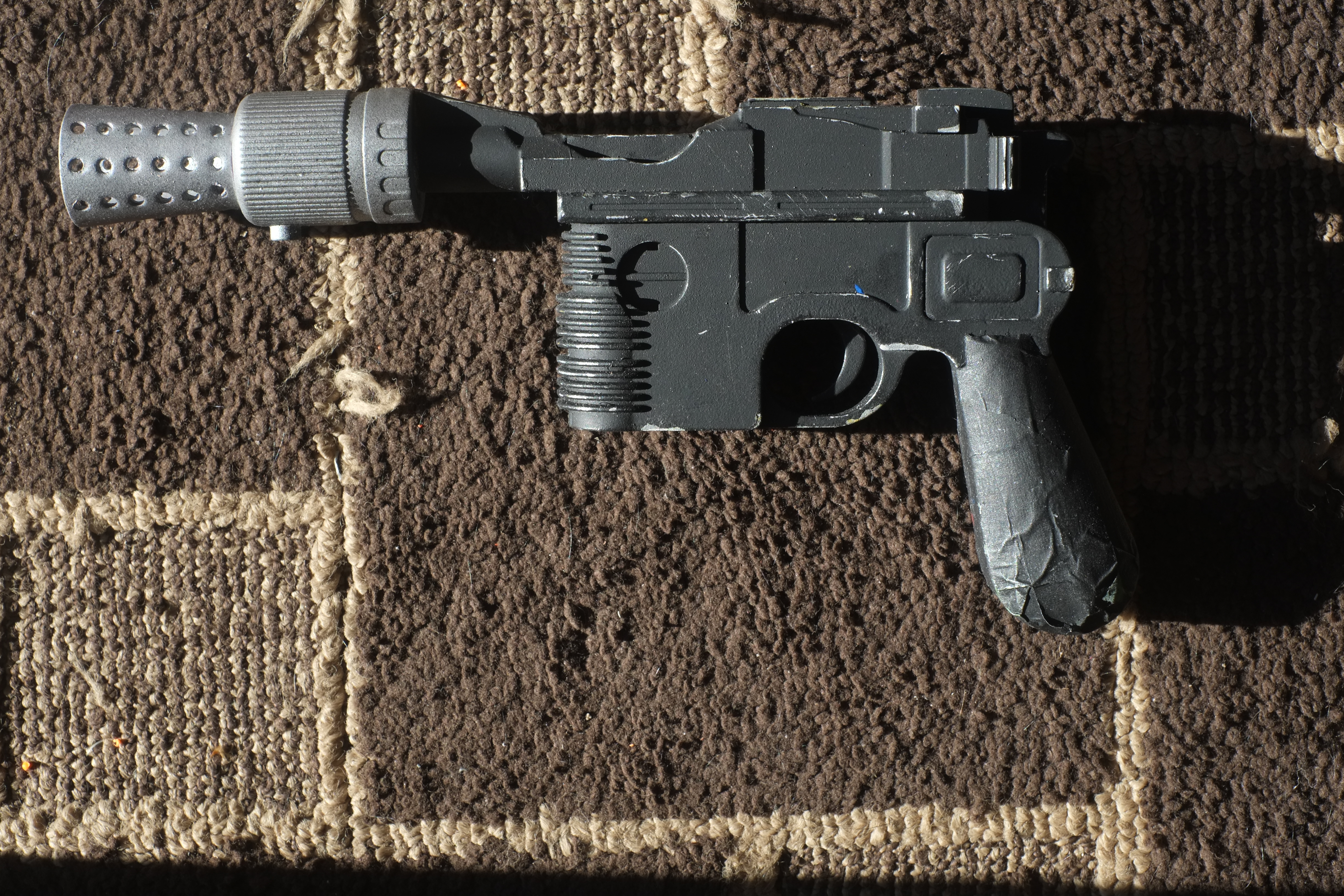

I've glued it together and filled in all the gaps/seams, using Apoxy and or super-glue. It's all been sanded down, and is currently outside with a first coat of primer.
Though I do still need to figure out how exactly I'm going to mount on the scope. I hot glued it temporarily where I want it to sit, but I still need to find a way to put the bracket/holder things on so that it looks right.
I screwed up the paint on the handle, so I sanded that off with everything else... So that will need to be redone.
After the second coat of primer I realized I forgot to fill in the gaps between the hole thing and the rounded part. I had accidentally pulled off the rounded part. :facepalm

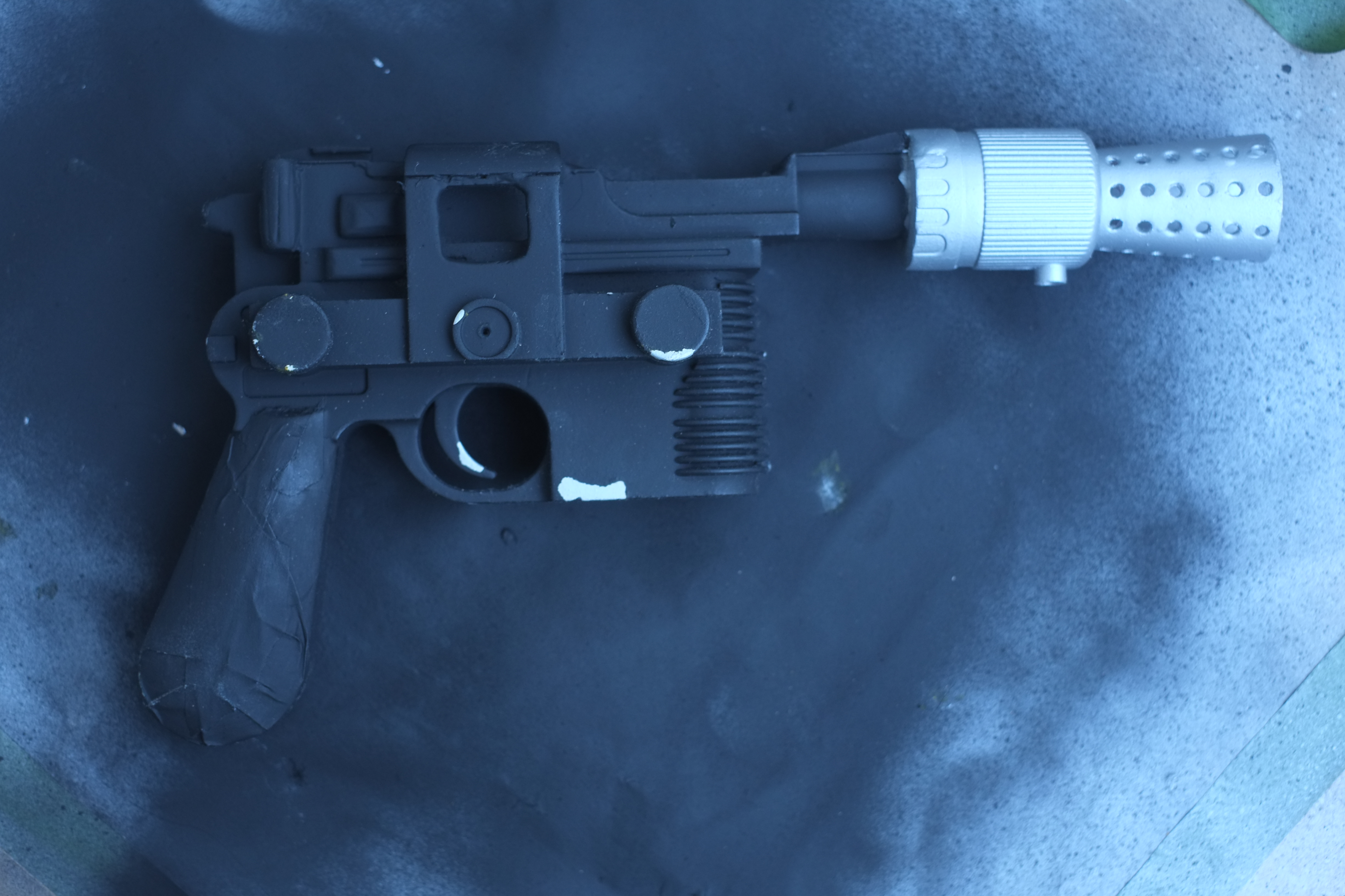

Ok... So my day way definitely more productive than it has been the last couple.
Firstly I finished the silver coat yesterday... and today I mustarded the paint chipped parts.
Next up was the the black coat with the muzzle taped off...
After that was finished I took the tape off and lightly sprayed over the silver with back, and then another light coat of silver. (I wish I had gotten a close-up, but I forgot.) You can kinda tell the difference in the two pictures below.

ALAS I am done!... Well kinda. It can pass as done, but I know I'm going to go back and redo somethings. Mainly the scope. When I was drying it was knocked over by the wind and the paint was still a little tacky so it got all sandy/gross. Overall I'm pretty happy with how it turned out, especially form my first (finished) prop project. As I'm writing this I realize that I forgot to add the top piece thing to the scope.
