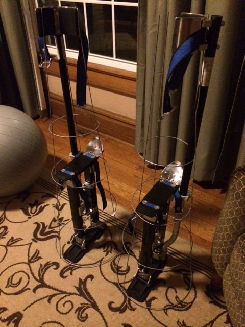

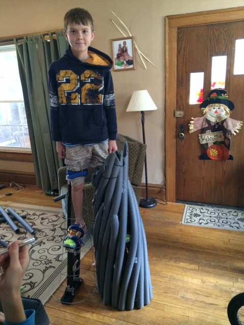

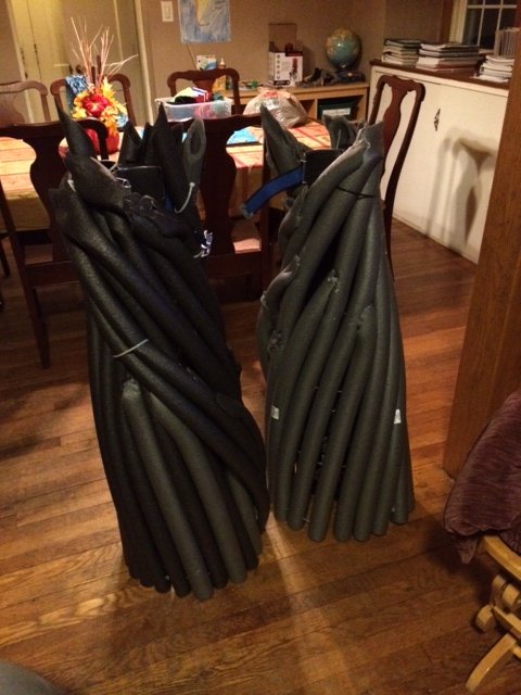

This was my approach. My son is less than 5' tall, and to get the 7+ feet effect we were after, I used drywall stilts and applied tomato cages to them to give them the shape I was after. He is now over 7' tall and walks very well in them. I hope this helps!
