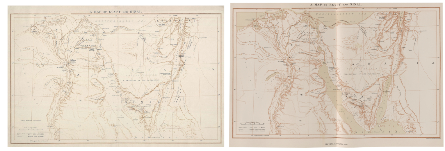

EGYPT AND SINAI MAP
Picturesque palestine, CW Wilson, 1881-1884
There have been several version made, one has yellow colored sea, the accurate type is the first type, on the left.
The full height is 32cm and black frame height is about 25,5cm
It seems to have been used at least for 2 different maps, including the long with hand writing:

When I measure my original map (distance from letter A to I on "arabia"), I find a width of 13cm on original map
But the diary pages are about 16cm in height, so it's not possible the diary maps to be directly cut frm original egypt and sinaï map, as the scale is about 125%
Here is what I made, based from a photo of my own map:
This is designed to be printed on A4 paper, for now width of 13cm, I have to check original prop map size, sadly it's very hard to get quick and accurate informations, those who know don't seem to share so much...
The file is 5180 pixel long, this size must fit the A4 full plate to get accurate scale for printing.

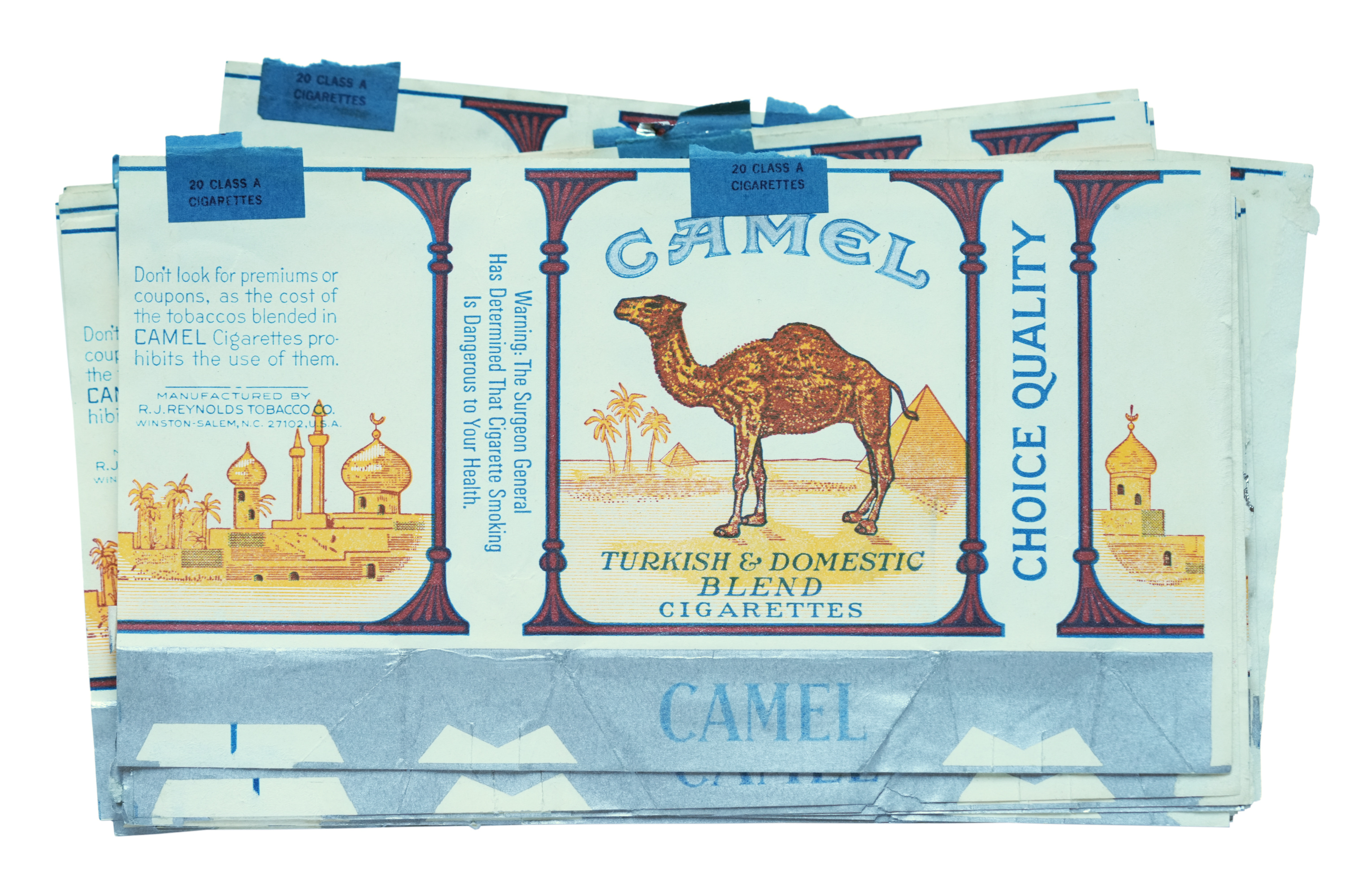

CAMEL PACK
Source : Lucasfilm archive, Andre771 "beginners grail diary" thread
From that picture, I thought the pack has been modified to hide some bar code, as I only found that capel typo on silver area on most recent pack version.
But, source : Holt ,"the true replica of the Grail diary Hero prop"
"There are no pictures of the original pack, the camel packs used in the original hero prop are custom made and not real packs"
So started to get doubts, however, I got new informations: picture of original real cigarette pack prop:
-it is a real cigarette pack
-it has a zip code number
-there are two paper on sides, to hide bar code, second one, designed to be identical on both sides, the letter "c" from "choice quality" is slightly visible on that original prop.
-the silver color has some fading on bottom left, meaning it's the exact prop used as reference for any replica made until now.
As I can't show that picture, I show you a similar real pack instead, it's the exact right version.
It may be a copy of real pack, but the printing quality is very different from other printed props, so my guess is it's actually a real pack, which is customized as I described.
This pack shows zip code and bar code, and correct camel writing on bottom, once you add inserts, you have the screen accurate result.

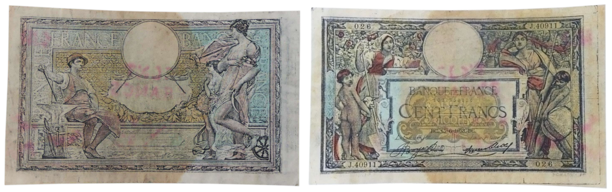

1933 100 FRANCS MERSON FRENCH NOTE
The note is a colored copy of original 1933 french note, Serial number J.40911 1933 BC 026
source : Propstore auction, original grail diary pictures

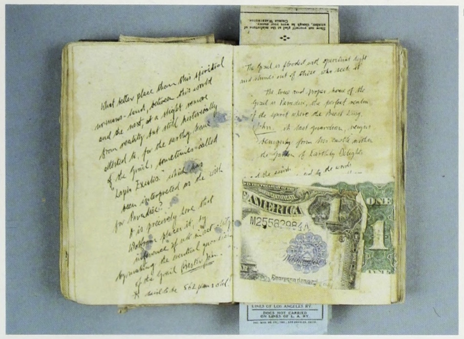

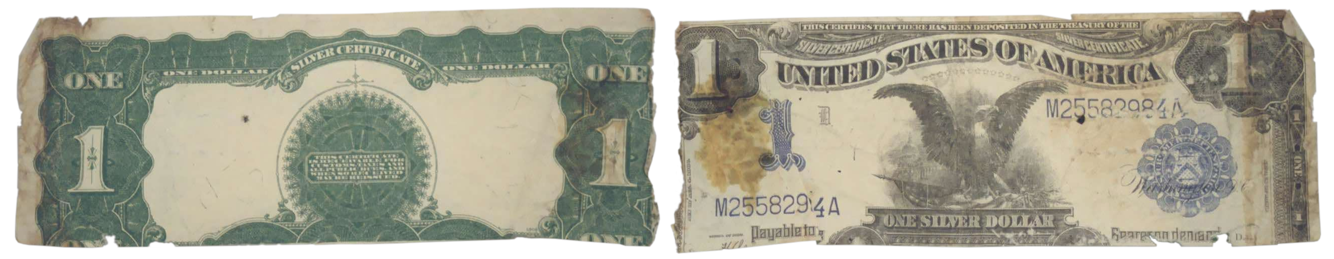

1899 US silver note, black Eagle dollar
Source : original diary pictures Lucasfilm book
Source : Propstore auction
You can see the note is bearing a number M25582984A.
The original note has trimmed bottom, as the material is expensive, I found a different way to display, without having to trim it.
Seen from this side, 1 is up, 2 is up on left and down on right, 3 and 4 are down.
This is how it looks once folded.

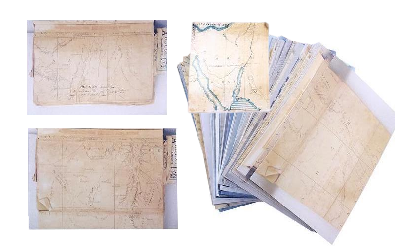

You can see on the picture 3 different maps
-two on left seem to be the l"big dead sea map" with some handwriting on bottom
That map is very long, about 10-11" long, as it's a full height from original "Egypt and Sinaï" map, even the bottom seems to be cut.
-the map with blue watercolor seems to be half-scaled
I made scaling attempts on theGimp and find about 50% scale, but still coming from "Egypt and Sinaï" 1881 map
-a bunch of other map photographies, probably from the 2 other maps, supposed to be used in the prop, what is strange is all, less or more, show the same area.

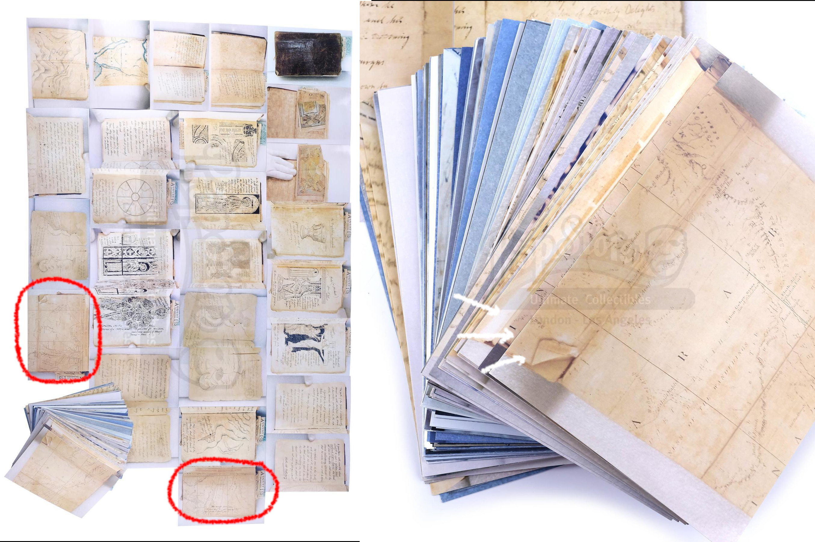

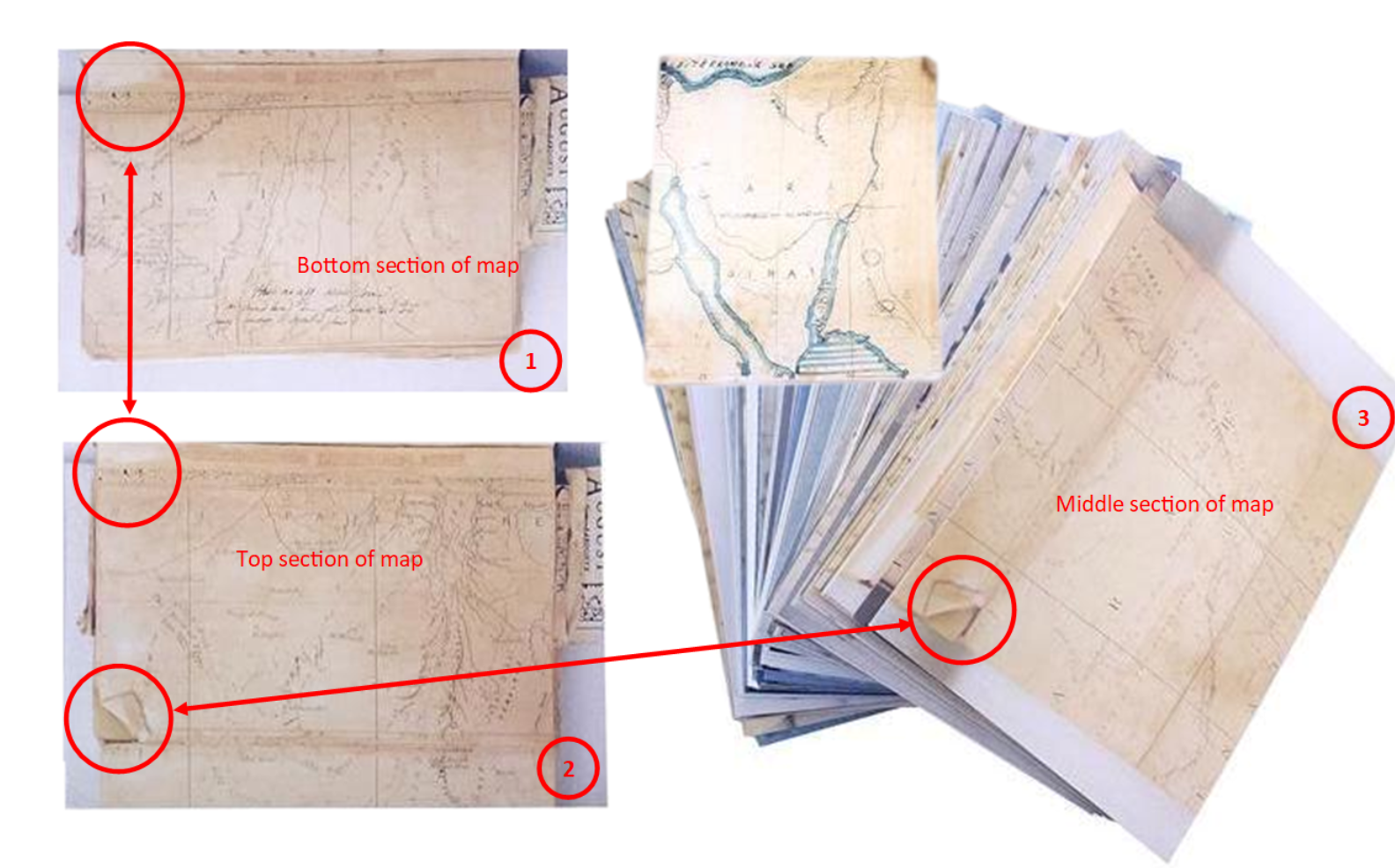

The 3 pictures are one and same map. Picture 1 is the map folded up in position in the diary. Picture 2 shows the top section when the map is opened up and picture 3 is the middle section.

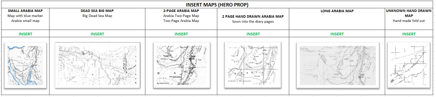

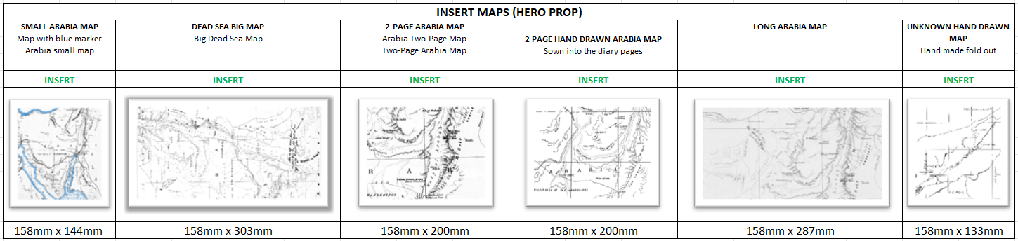

As a guide I created the below to help me sort out all the different maps in the diary, maybe it will help you as well.

Do you know the size of those maps?
Is there any accurate document showing exact size?
This is to know if any of them would have directly been cut from original map from the bok, or if all are copies, as scale should be different.
thanks a lot,
So I'm not aware of exact sizes for these maps however with a bit of detective work you can work the sizes out. We know that a diary page is 158mm high and so using this as our base size we can then scale the maps to suit. Looking at photos like the ones above we can see where the edge of the maps supposed to be and that gives us our reference to scale correctly. I have added the sizes that I have calculated to the below.
I did all my map scaling and layouts in Microsoft Publisher. This allows you to crop in and then scale the picture to the right size.
