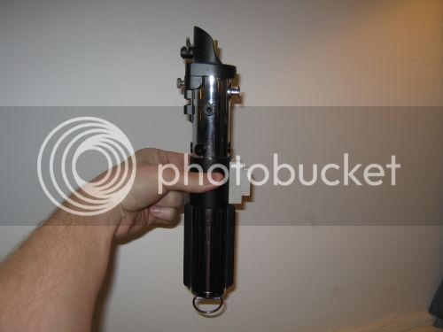

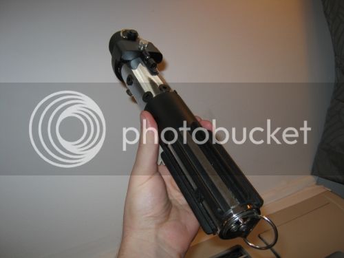

Hello therpf members, this is my first post onto this amazing website, but i have been reading the posts here for years. I have finally started on one of my dream projects and would like to ask a few questions and hopefully get some help. I recently purchased a graflex 3 cell flash and want to get into jedi worthy shape. It shows some age, but i like this since it was made a long time ago in a galaxy far, far away. However, it needs some attention to make it nicer. It came with the blast tech Luke ANH kit assembled on it. I would like to put a more accurate bubble strip on it, and look into getting some plastic grips (i am okay with the D-ring). Any ways here are my questions:
1. the "bunny ears" section at the top swings left and right, it is pretty loose. Is there any way to tighten this or stabilize it?
2. the attachment of the top half to the clamp, as well as the attachment of the bottom half to the clamp is fairly loose. It wobbles when held in the hand. is there anyway to tighten this up or fix it with modification?
3. is there any way to find the tiny screw that would have been on the graflex clamp (that held the clamp on to the top half)? I know people usually take this off in their conversions, but i feel it may help with some of the wobbly-ness. Perhaps someone would have one laying around they don't want/need any more?
Thanks again for any help and advice :). I am looking forward to working on this project and learning more about the hobby.
1.) I've posted on here about this a few times. Yep, this is how Graflex's are. Some people put a drop of epoxy or superglue on the rivet to hold it in place. I personally found/cut two tiny bits of something soft (I used a pencil eraser) and wrapped them in electrical tape. These tiny things I then stuffed into the back corners of the "emitter" where the bunny ears turn straight...anchoring the bunny ears in place. I can always take them out if I want to :)
2/3.) Mine is a little wobbly too. The mechanism is made up of the cut-out on the halves...and the tabs inside the graflex clamp. There may be something you can do to the tabs to make them more snug when clipped together. Maybe make them bigger or longer? I have the little screw in mine and it helps for the top half but not the back. Also make sure you attach your new grips while the back half is pushed forward (half off). The back needs room to move forwards and turn to come off. I put my grips on too high and can't take my back half off..until I upgrade my grips haha.

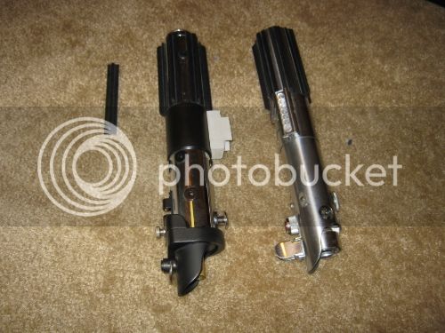

theJUDGE, that looks pretty good! I bought a 3-cell Graflex off ebay a few months ago and I went about trying to turn it into a Luke ESB saber. I bought the grips and screws from the custom saber shop, but i found an original red button from another graflex on ebay and I already had a circuit board card that I put in the clamp. I went online and found metalized mylar tape to put around the middle band. I also got access to a drill press and drilled holes in the bottom of the hilt to put the screws in.
the only thing I have to track down now is a clamp from an original Kobold flash gun to put on the bottom for the D-ring. I wanted to use as many original pieces as i could.
