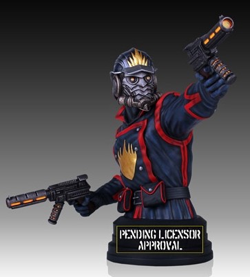

I just want to start out and say I am really impressed with all the Guardians builds off the movie especially Star-Lord. As much as I love the movie look I am more keen on a Annihilation Helmet build as of now. I am to say it the easiest way a novice at replica and prop building. I can't find consistent pictures of any one variant of the helmet that I like except for a bust that's coming out later this year. I'll post some pictures and see if anyone could give some pointers on where to begin.
Gentle-Giant-Ltd.-Guardians-of-the-Galaxy-Starlord-Mini-Bust.jpgStar-Lord-Mini-Bust-006.jpgStar-Lord-Mini-Bust-004.jpgStar-Lord-Mini-Bust-002.jpgStar-Lord-Mini-Bust-001.jpgStarlord-Guardians-of-the-Galaxy-Gentle-Giant-Mini-Bust-Marvel-e1392435275222.jpgMarvel-Gentle-Giant-Mini-Bust-Star-Lord-Guardians-of-the-Galaxy.jpgGuardians-of-the-Galaxy-Star-Lord-Mini-Bust-Side-Q4-2014.jpgGuardians-Of-The-Galaxy-Star-Lord-1.jpgStar-Lord-Mini-Bust-Gentle-Giant-Ltd-GOTG-with-Blasters.jpg
At my last local con I saw a French Firefighting helmet called the Gallet. Although pricy, It looks like a great base for the helmet. Using any of the helmets for the movie and modifying it to fit under the Gallet, may work a treat.
The movie costume definitely took a while to grow on me because it was so different from the Abnett and Lanning comics. I'm with Jackal, I'd start by finding some sort of pre-existing helmet. I know I can almost always go into a thrift store and find a bike or batting helmet for $2-5, and they make great starting points.Even though they are typically kids helmets, they work for me if I pop put the foam lining, and I have a pretty big head. :p
From there I'd gut off any excess and just start adding on to it. I usually start by covering the holes that may be in the dome on the inside and filling them with bondo. Then I pattern out and add on more pieces to achieve whatever look I'm going for. My go to material is usually cardboard which then gets coated in fiberglass and bondo, but I imagine you could get good results with thin sintra, styrene or foam. For the face, if you don't want to make it fully from scratch, you could always print out the pepakura patterns for the movie helmet and modify them to the shape that you want.

Love the Annihilation Star-Lord! I would personally try to find some sort of world war 2/1 replica helmet and sculpt/build the fins and bill to it. I'm with bh1138 for this build. I'm excited to see how this turns out
Thanks everyone for the ideas, I'll go out this weekend to the local shops and flee markets and see what I can find, I'll try to update as often as possible but this isn't my main priority yet. As of right now I feel like I'm leaning towards a mostly pep build, aside from the helmet (but who knows). Thanks KaptainJosh for the file, I'll try there first and see how it goes. ww1 french helmet 001.JPG I like this helmet as a base except the back doesn't extend as far as I'd like, but that could be altered. Oh well there are ton of possibilities from what I can see, so Ill get to work. Thanks Again everyone.
