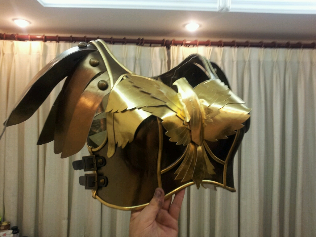

I made one of those armors some time ago, and I could offer you girls some ideas... the first of them would be indeed to get a hard material for the breastplate/backplate, and yes, I would suggest them both one piece, if at all possible, or with very sturdy shoulder straps. Allow me to show you three pictures that may help you....
As you can see, I placed two buckles on each side of the breastplate, but only one side was operational, so she could get in and out. Before making the actual armor, I found a stretchy golden fabric and made a skintight long shirt out of it, which doubles as the belly armor, which Alex Ross drew, but let´s face it, it is impossible for anyone to move with such an armor, so I had a choice - fidelity to the look or to the armor aspect, and looks won. If you guys need any help, respond, I will subscribe to this thread.
