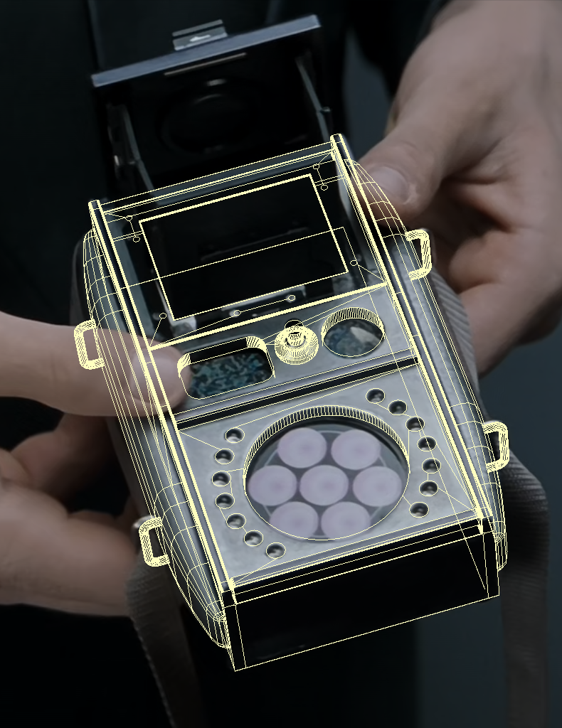

I started with the blueprints found on the Questarian website, but quickly realized that they've got a lot of inaccuracies. They're good for what they are, blueprints drawn by hand off of DVD quality images, but there's better reference available now. I started with the blurry, low-res front-facing photo found on the Questarian, and lined it up with a small fragment of a high-res pic that @redshirt posted years ago:
I used that as the baseline for size and placement of the lights, openings, etc. Once I had a real waist level finder in hand, I used that plus the 5 mm LEDs on the face and 1/2" strap to scale the mapper to 38mm high by 76mm wide by 145mm long. The result is thus:
I made changes as needed to match the screencaps.

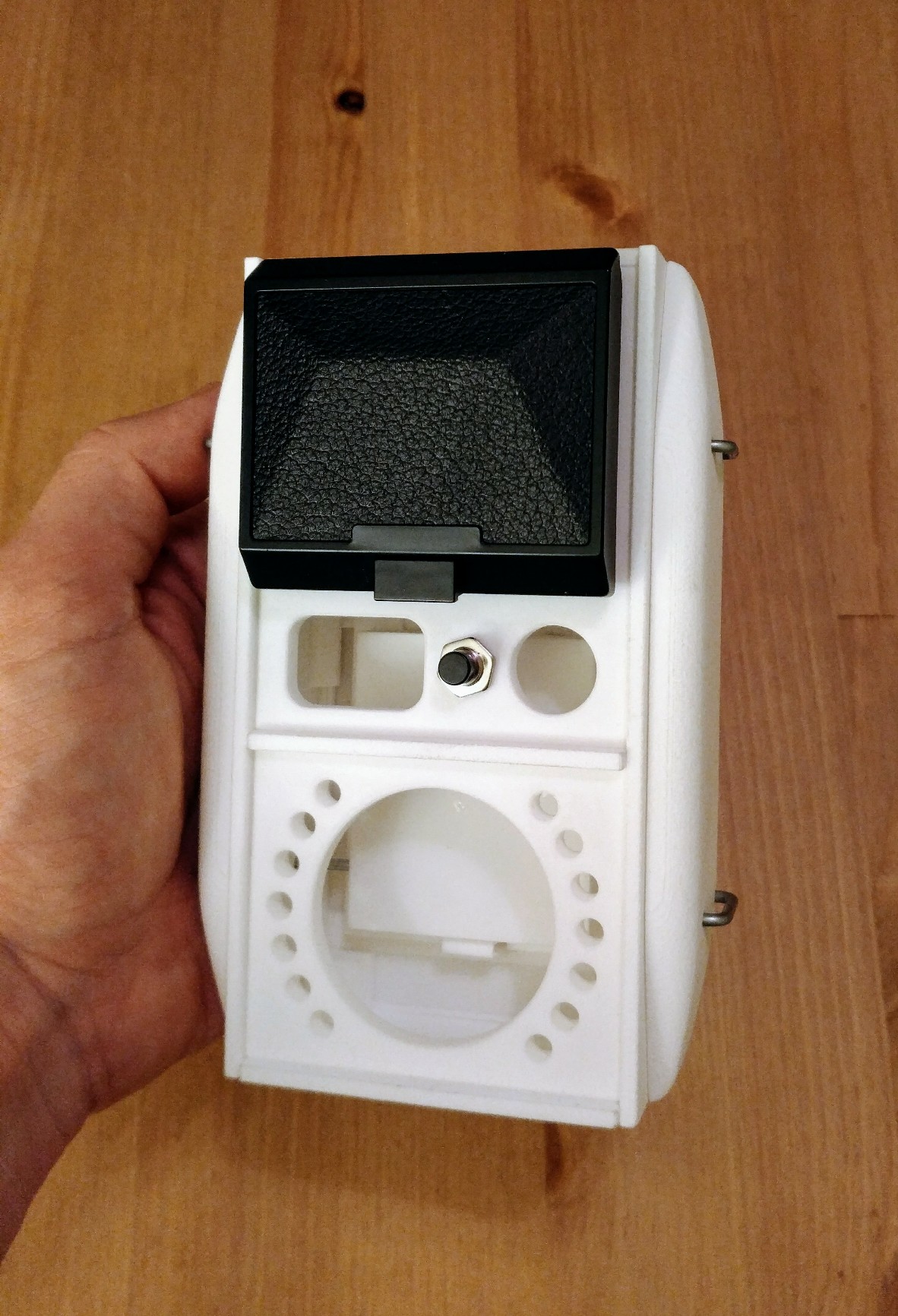

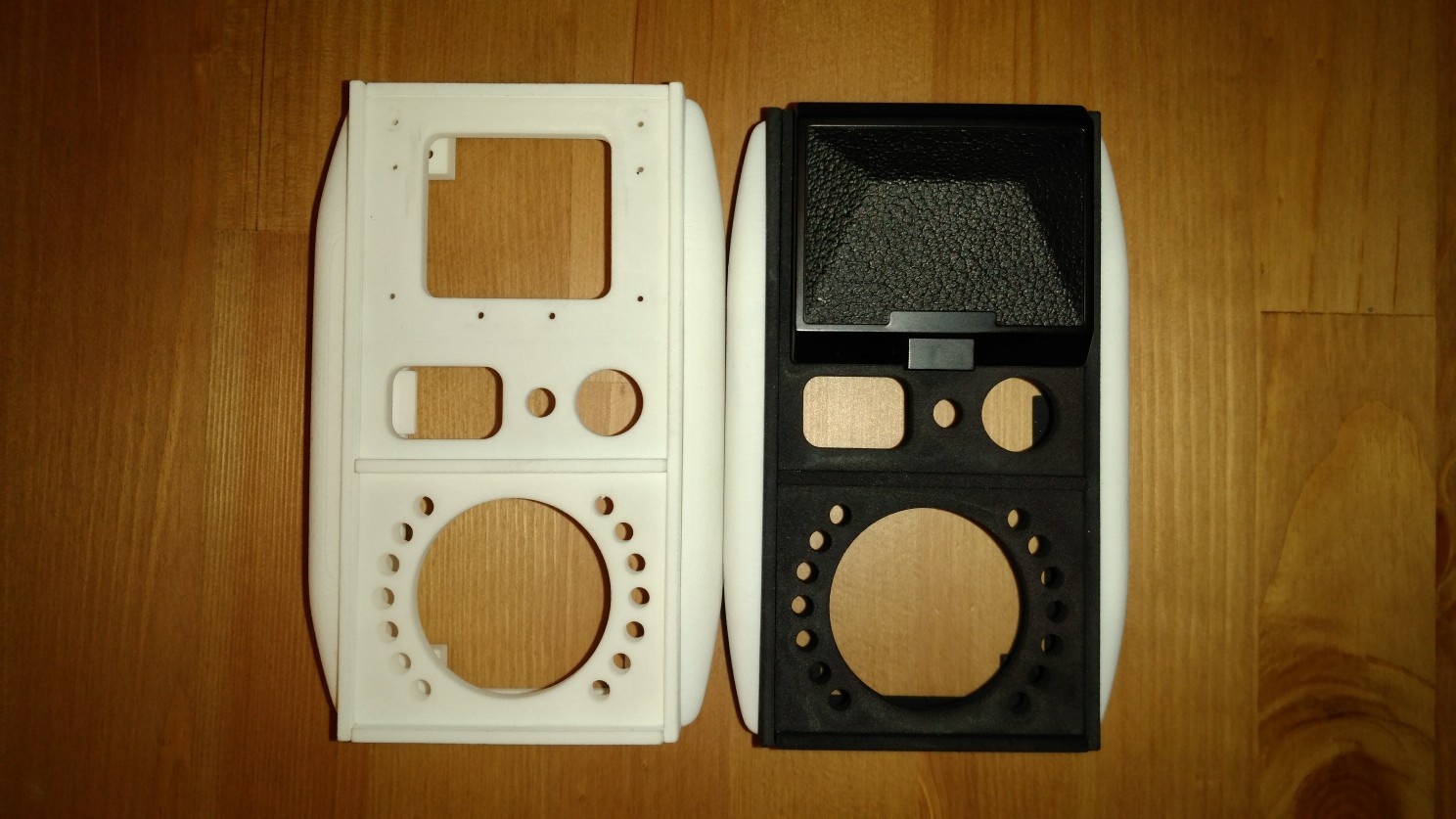

I have an initial print in-hand, with a second revised (and hopefully final) print on the way.

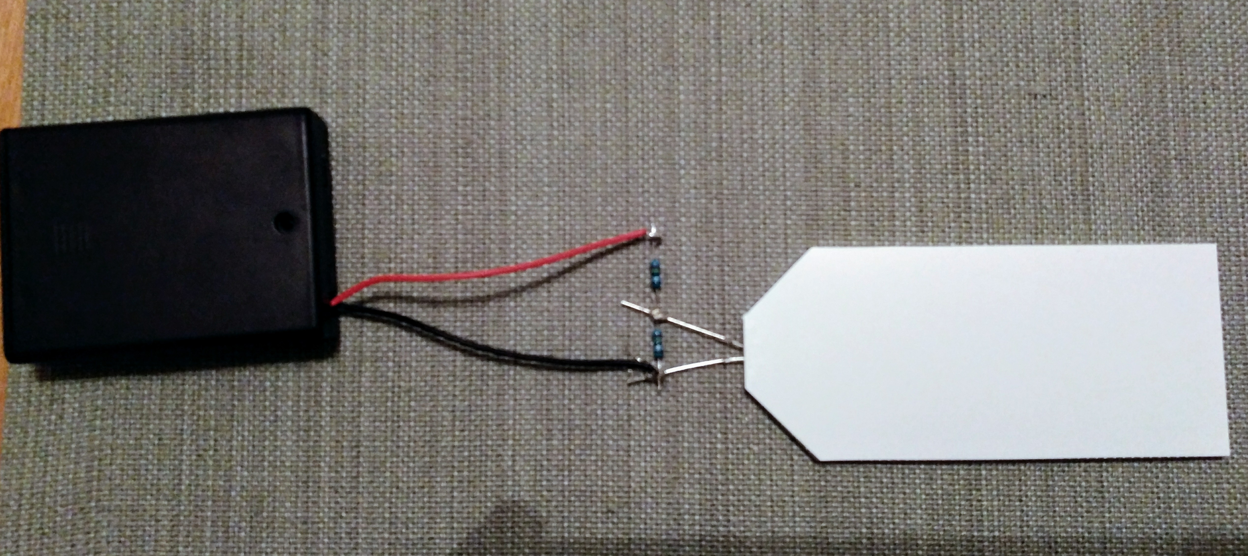

Electronics are still in the planning stages, but the current plan is to have:
- A backlit graphic behind the hood that will activate when the hood is opened
- Sequencing LEDs and a sound chip with sampled sound FX from the movie that will activate when the central button is pressed.
- A faux-touch surface behind one of the openings on either side of the switch that will change the LED cycle when pressed.
