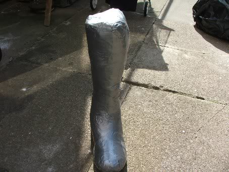

5. A duct tape dummy of your leg (this is optional but I found it very
helpful indeed)
6. Lots of reference pictures (got mine out of the AVP creature book)
7. Patience (lots required)
Okay so first off and also the hardest you need to make the
templates/patterns for your armour.
For this I used the duct tape dummy of my leg and the plain paper
I anchored the paper to one half the leg and drew the shape of the armour I
had in mind, I then cut it out and placed it back on the leg to make sure it looked correct.

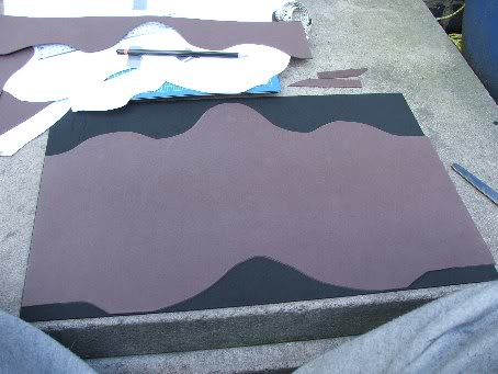

I use 2mm funfoam mainly because it's all I can get, But in this case it's a must for me, as I approached the construction in layers. what you can see above is the foundation layer, the innermost part of the armour, and from the reference pics It had an oval cut out which would have been difficult to re-create with thicker foam. What I did was to draw the templates onto the foam.
Like so, then I cut out the oval from the upper piece and glued the two 2mm template shapes together with hot glue.

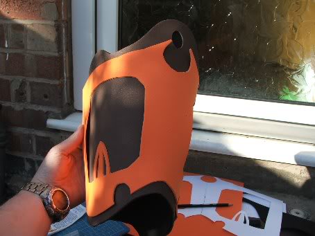

Next I drew out the templates for the next layer which is purely decorative, it is also quite tricky to do too, as it contains some shapes that need to be cut out with a very sharp blade.
As you can see the two rounded triangular shapes are what cover your ankles, and these have some rounded slits and also two small circular shapes that will point towards the foot.
Next carefully cut the shape out and lay it atop the lower layer to make sure it fits okay
Once you've done that you can glue it in place. Now for the dangerous bit, heating and shaping it, you can do this over a gas cooker burner. Just be careful not to overheat the foam or burn you fingers, and I can take no responsibility for you singing your digits. Just hold it over the flame not in it and mold away. Once you've got the shape you need feel free to use any old material to back the armour and coat that liberally with PVA glue, leave it over night in the shape you molded and the material and PVA will have stiffened to hold the shape well.
