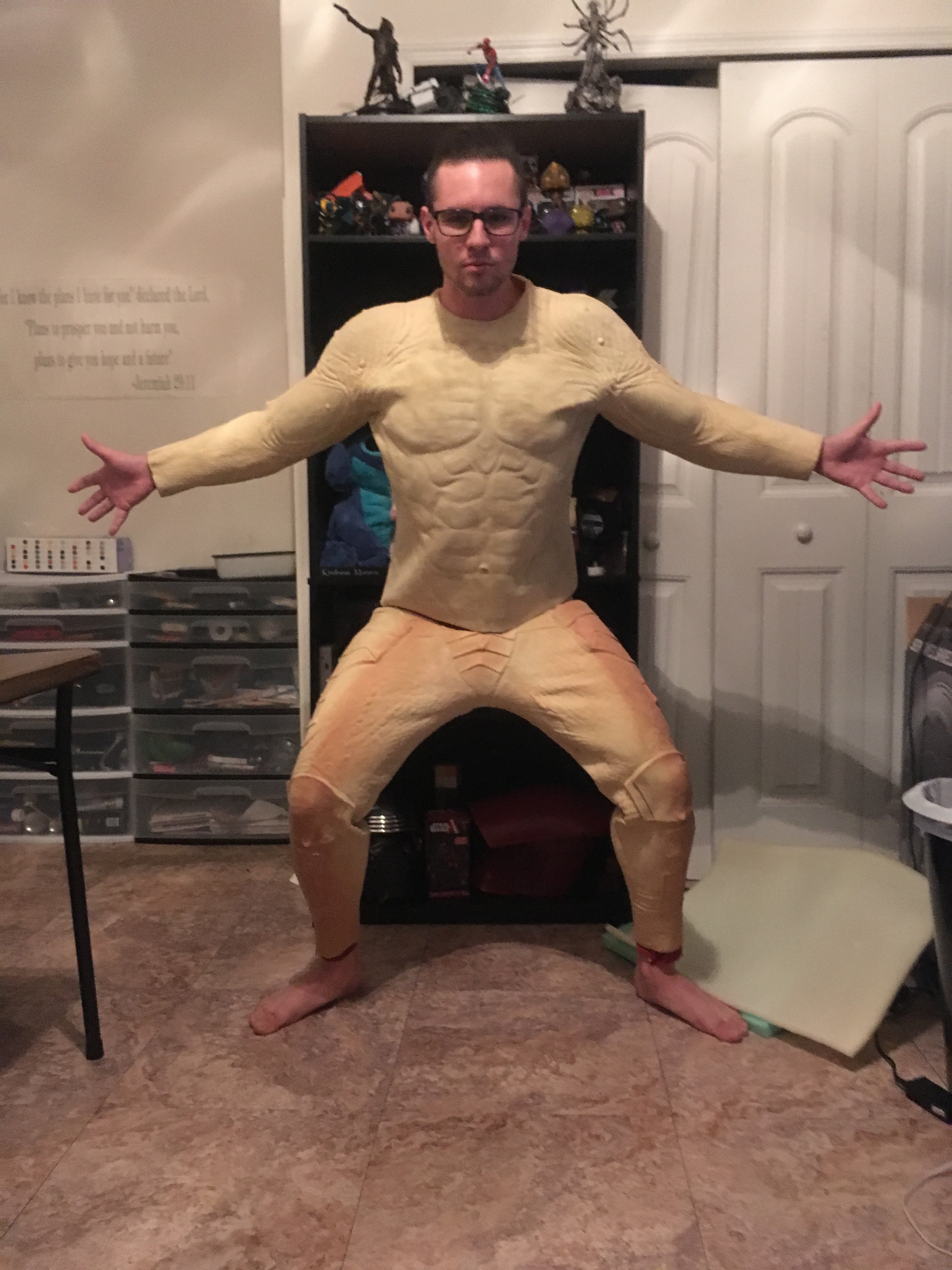

Update
So i have a padded suit inside the latex suit and it makes it so much easir to get in and out of , NO MORE POWDER !!!!!.
The suit itself turned out very well in my opinion im happy with the armor less torso and now i have the sipper drying on the back with contact cement and surprisingly Pen clasps work very well for holding it together ( my fiances idea ) .
Next up will be the head and airbrushing then armor.
