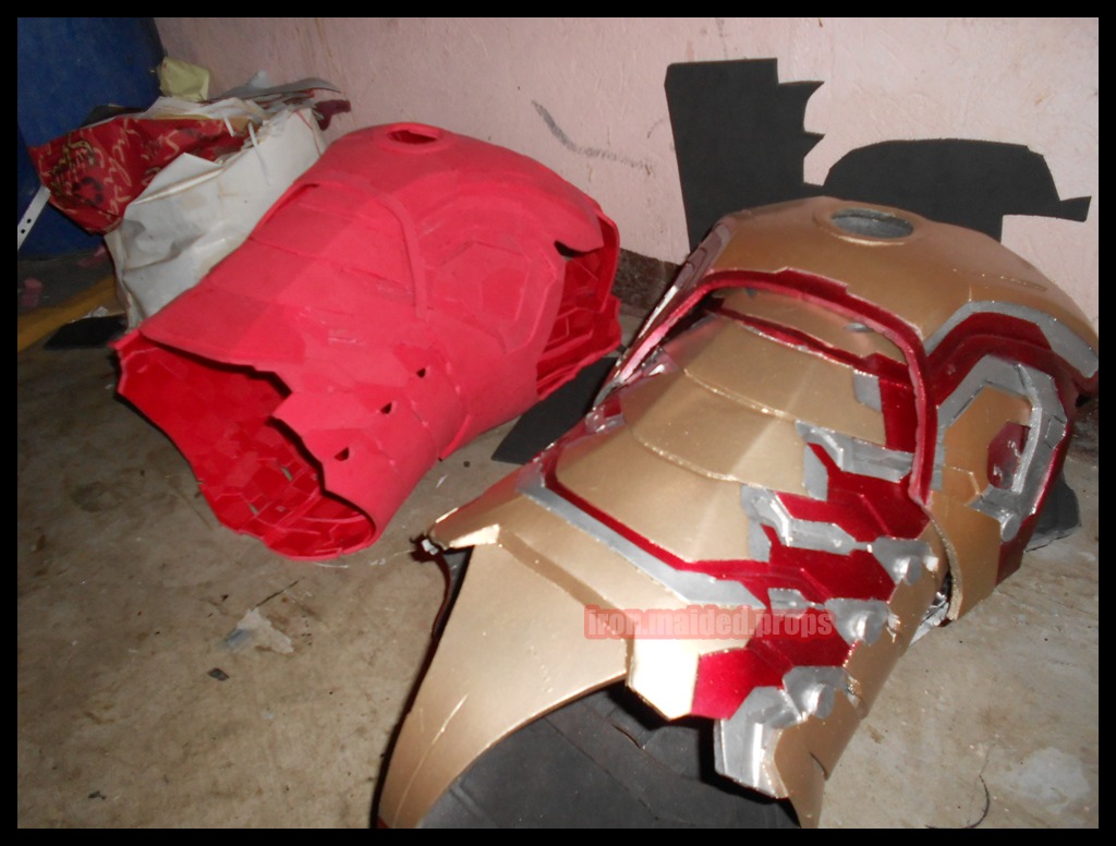

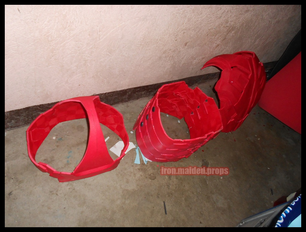

i started building helagak's chest and back files. . .scale to fit a 5'7" guy
next is the ab piece, using jackieisrockin's ab file. .scale to fit 5'7" guy and is exactly the same with helagak's ab file
the reason why i didn't use helagak's ab file, my pc crashes whenever i try to reduce the pages on the whole suit pdo file. .lol
days later. . .after finishing my gurren lagann costume, i started to seal each parts of the suit, no pictures of the other parts being built because i was toooo lazy that time to take pictures and i'm so freakin' tired :cry i'm using acrylic emulsion here to seal the foam, i use 4-5 layers of acrylic emulsion to give the foam a nice shiny coating for me to paint

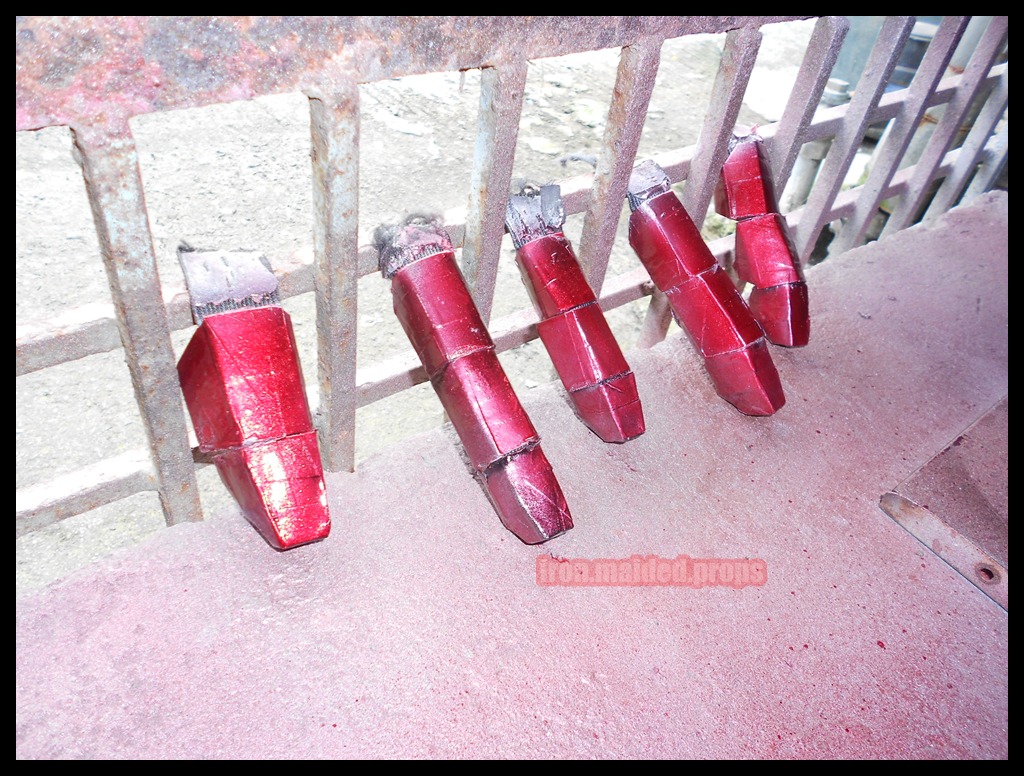

fingers, made of paper mache-d robo's mark 4-6 finger pep file

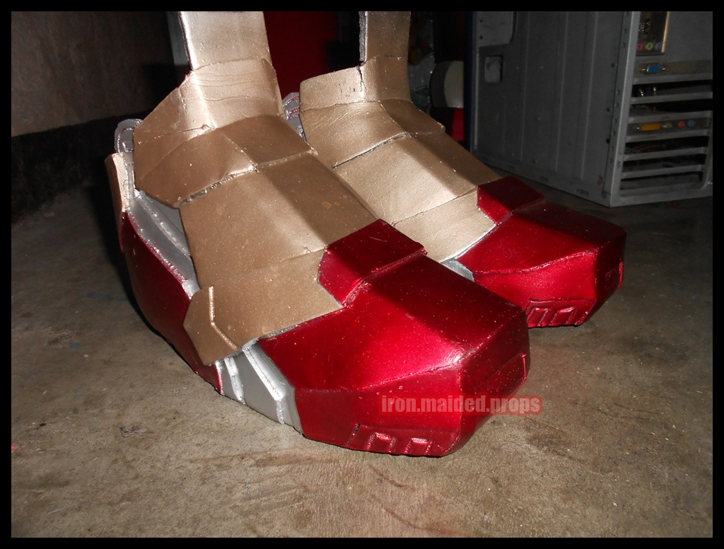

yeah jackieisrockin's boots, the extension flaps on the top will be inserted inside the shin to preserve it's proportion

~usually i built my boots with soles, something like this:
as for the "tip-toe problem". . .i would suggest making it separated since you are scared on any fold damage on the boots. .for me the boot articulation is critical on the mark 42 boots unlike the mark 3 to mark 7 boots which have a "screw section" which you could just use chicago screws to make the boot articulation. .hope it helps. . .i'm no genius on those articulations though but this is just my idea :angel hopefully i could make those boot articulation in the future too. . .good luck on your build ;)
