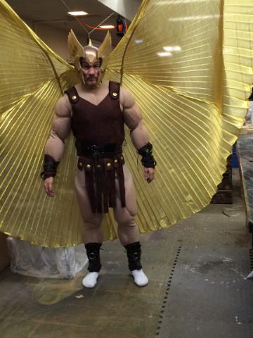

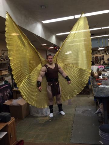

George-- I have been considering what to use as well for the detail coat-- Since I got not only the go ahead from Brandon, but a very strong "proceed as we love the idea ---just give us pics and videos". I will be starting on this after we use the suit as is in our Christmas production- (Need a buff Gabriel Guardian Angel) .
So we will see how this goes for sure!
Here is the first use for the suit-- Wont be me in it for our church production, but we needed a buff angel.  probably losing the Thor helmet, Adding more straps, belts and buckles to the costume.  Looks pretty sweet when you move too. the wings have great flow and movement.
