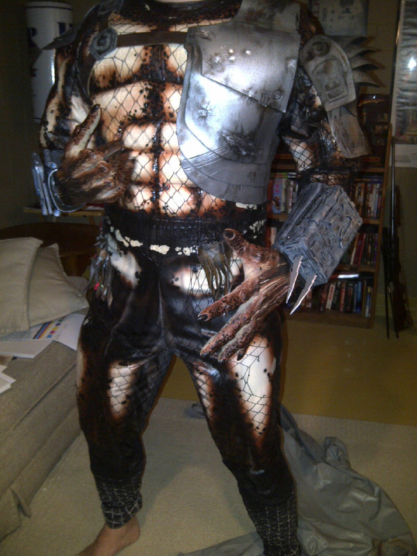

I tried on my completed scratch build skin today and couldn't squeeze into it. I had to rip off the thigh armor, cod piece and loin cloth that I had glued on as they had cinched the waist area to tight to slip into. The thigh armor was destroyed....ripped in half but I can redo it . It was craft foam. I was able to salvage the cod piece at least. For a moment I was ready to chuck the whole costume out of frustration and call it a day. It's a scary thing seeing months of hard work being twisted like a pretzel in a matter of seconds.
I plan on attaching the cod piece & thigh armor to hang off the belt since the belt will be put on after the suit is worn. I barley squeezed into the suit at all, though I managed with the help of my snickering wife. Note: I didn't use a duct tape dummy, I used an inflatable full body dummy inside the muscle suit while working on the skin. Proly should've sucked it up and went the duct tape route. Here's a pic of me in the skin. I held off testing the rest of the armor, feet, etc at this point.
Well at least it fits which is a positive.. :D .  Another positive is that being skin tight it will look more realistic and move with your body and not hang off  you in big wrinkly flaps. Personally I'm against gluing any Armour on to the suit itself and would  rather create something that is detachable to both repair and change for different looks.  I have to get help to get in and out of my suit as well.

Good point, I'm happy I got into the skin and like that its not bulky. How do you attatch your armor, via Velcro? I considered this but was worried that gluing Velcro pieces would become problimatic and eventually peel off of the armor or skin? I did use magnets on the back for the medical kit.

I plan on leaving the suit as is once its done. Magnets seem right to me also, perhaps ill use them for the thigh pieces. I love the weathered look too with straps, leather . It creates a real aged look on the predator. Thanks again.
