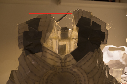

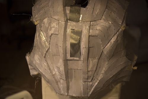

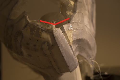

So I went with epoxy and fiberglass.
I failed to neglect the importance of bracing. I did some but clearly not enough because the shape isn't perfect. Furthermore some of the smaller flaps buckled under the stress of the weight from the fiberglass.
Now my big concern is that it's all wasted.Are these details fixable?
I was considering buying a heatgun, but seeing as the Epoxy needs heat to harden, I'm having a hard time understanding how heat, again, can make it soft and manageable.
Another worry I have is that my bodyfiller won't stick to my very solid but slippery surface of Epoxy.
- any insights to these issues will be much appreciated:)

I did 3 layers of epoxy on the outside, let it set for a few days, then moved on the epoxy + fiberglass mat on the inside. and I used paper stock 200g/m2.
I dunno it just seems like some of the hotglue got undone in the process + my bracing wasn't perfect. But I guess it's a matter of definition of bad pep:) I think it looks alright, It just have some dents here and there and a very noticeable non-alignment on the shoulders and ribs area, as my pictures can tell.
Are there any limits to what the heat gun can do? like... is there a point to where a heatgun can't fix it? like if the pep is too out of ideal shape, or if I used 3 layers of fiberglass for instance..
Atleast now I'm not worried about the bodyfiller part:)

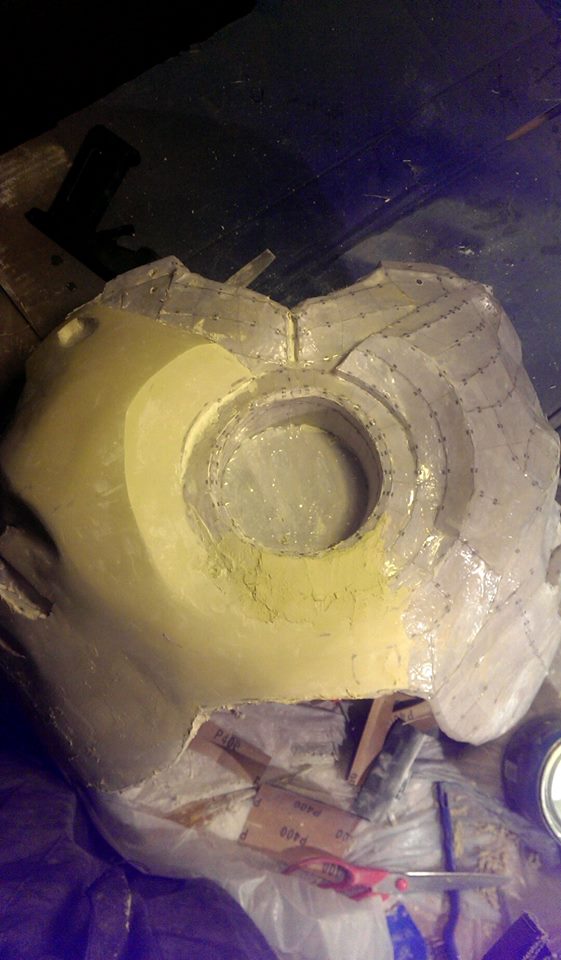

*update*
So I've gone against some peoples advice here, and tried to shape things back again with a heatgun - It worked and I now have my pieces all fitting, all lining up to one another beautifully:)
However I've begun the whole sanding phase, and I'm curious to know when it's enough? I've started using some fiberglass bondo(for the sake of strenght) but I've soon come to realise that it also seems it leaves some ugly strands and pits in the outcome, that is just a pain.(see image)
(look at those craters... 1milimeter deep, but nasty as hell)
Basically I have some voids, I have some ugly looking craters and I have some endings that is not good enough yet.
- I have a feeling throwing a more refined bondo layer ontop will do the job, but I would love to hear what you guys think?
The question of "when is it enough" is one of the best and worst questions about this hobby... it's all subjective. It's done when you're happy with it, and not a moment before. The structural bondo with embedded fiberglass is great for added strength on the inside (fiberglass cloth/mat is hard to get into some areas), but in my experience it's best to stick with regular bondo on the outside.
Take as much time as you want with each piece, and only move on once you're satisfied. Add little bits of bondo at a time, doing your best to keep it consistent with the overall shape of the pep piece underneath. Use high grit sandpaper or a rasp on the early layers, moving onto finer and finer as the shape becomes more refined. Remember the bondo's only there to enhance/smooth the shape, not to form it; that's what the pep does. Use it as sparingly as possible and you'll generally have better results.
One more thing... don't be afraid to sand through the outer paper layer in some spots to round off points in the pep model. This is very common and helps save a lot of bondo and weight in the long run.

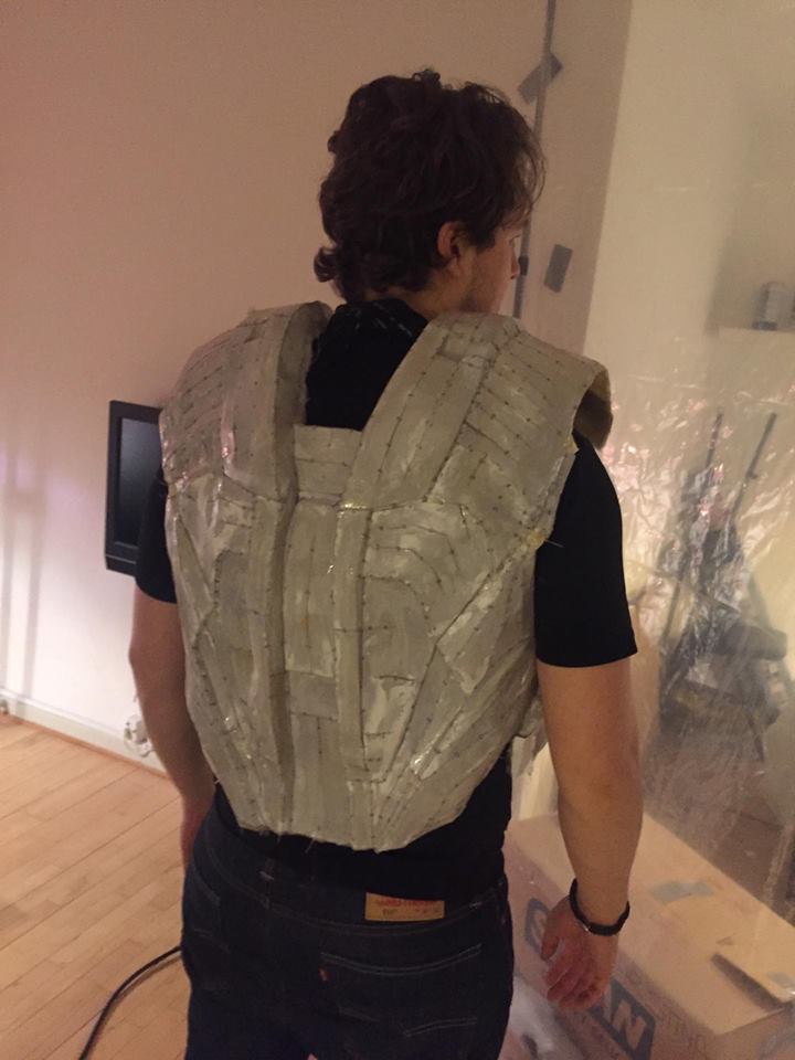

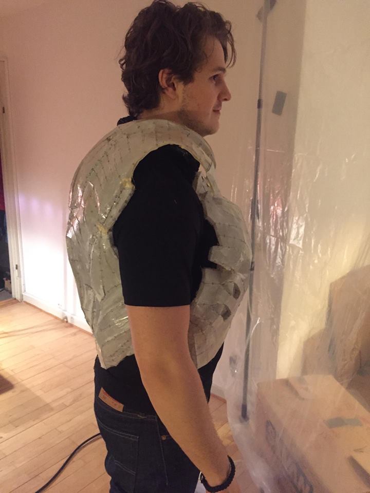

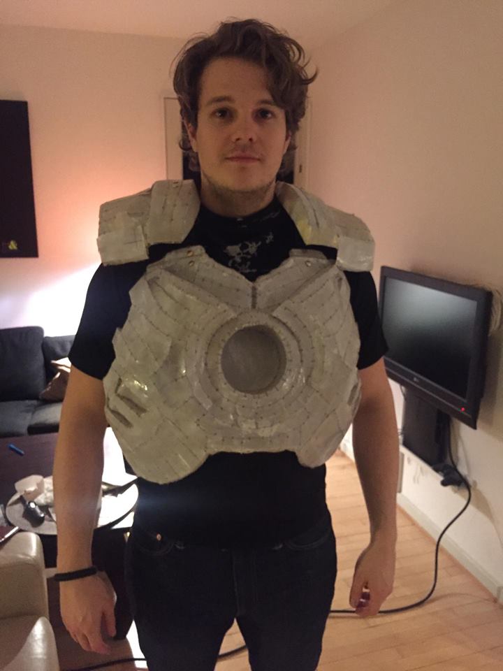

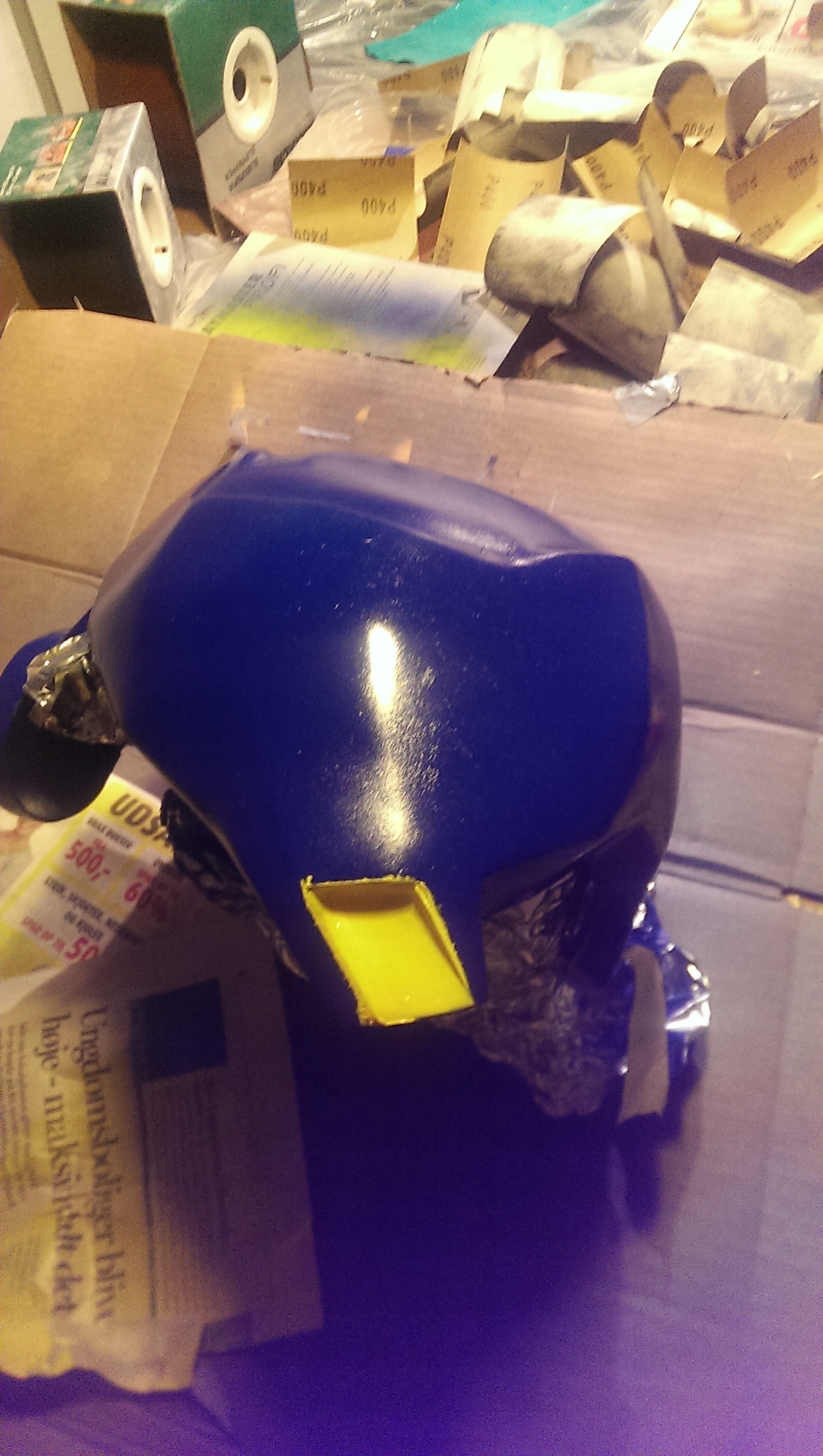

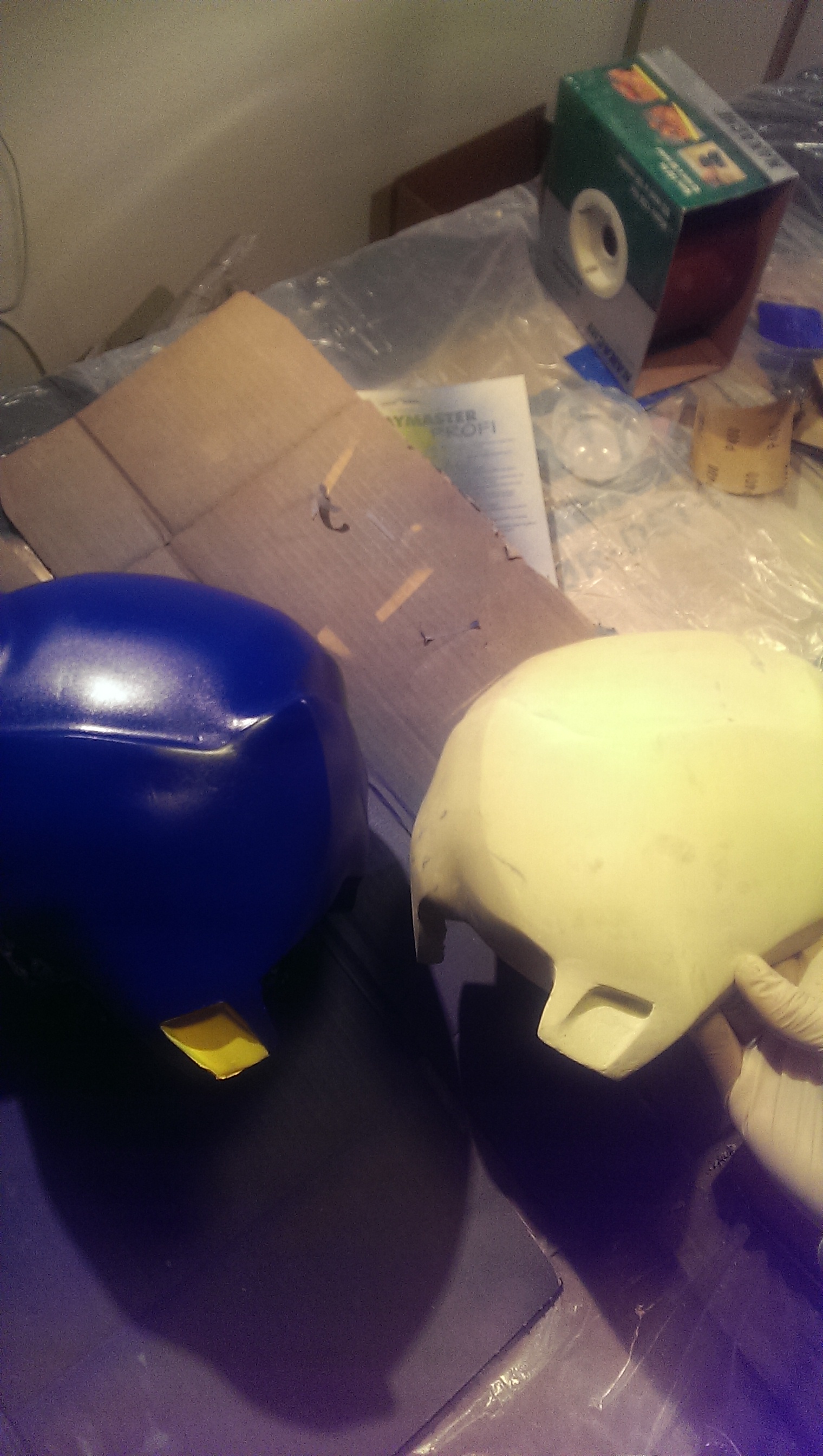

*update*
So things are progressing and I'm getting some real nice stuff I can show you guys:)
Shoulders:
Chest & back:
12527722_10153729818658110_1077766809_n.jpg12516421_10153729818588110_1740726112_n.jpg12498734_10153729818648110_1737227809_n.jpg12596175_10153776151272550_553333696_n.jpg

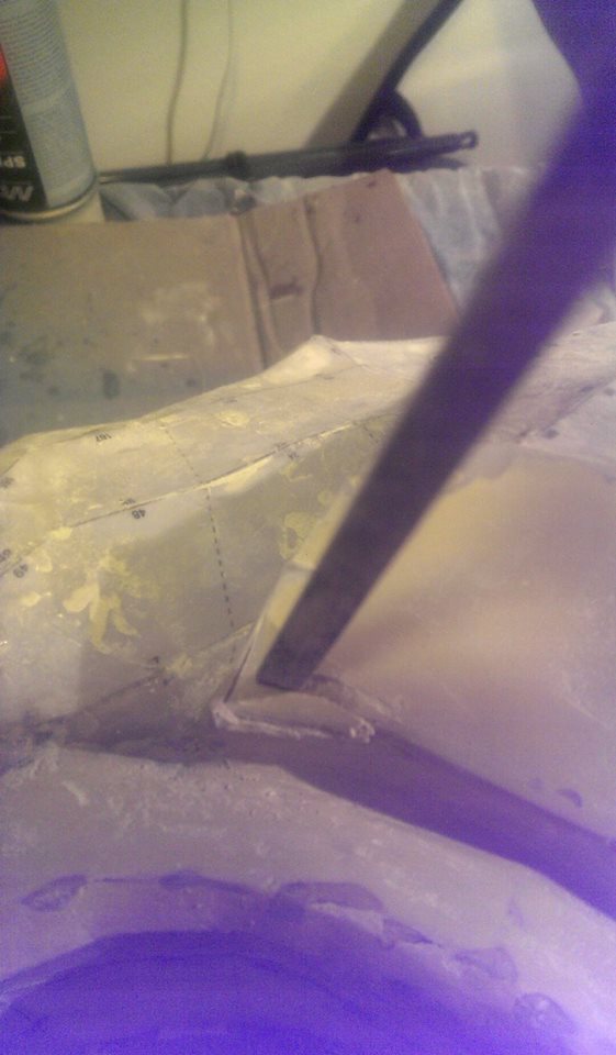

So it's progressing. Got both arms resined and will soon start to mount them - however I still need to find a good way of doing that, while still keeping some level of movability.
But I've run into a problem, I accidently pushed through a corner on the chest with the sandblaster, and now I'm not quite sure what to do, as it hasn't punctured through the fiberglass underneath it.
The issue:
1cm2 breach
Any input on solving that in a good way will be much appreciated - personally i'm thinking of just giving it a blast of Epoxy, but I could think of a few things that could go wrong with that.
