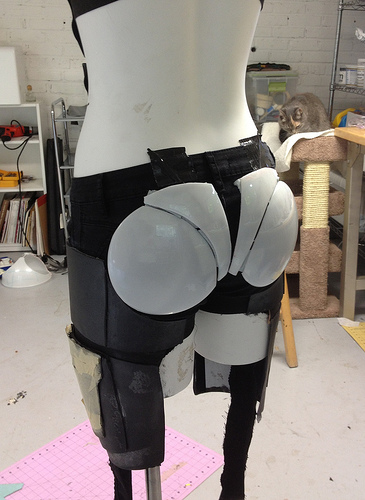

I decided to start working on the ass plates. Since I realized I'm out of the thick leather that would have served this area, and buying a 60$+ hide isn't something I can do right now, I'm gonna see how vac-formed ABS works. Hopefully there won't be panty shrapnel with the right thickness, ABS is pretty tough.
Then, while at the hardware store picking up stuff for the N7 rifle electronics, I noticed this magnificently proportioned trash can lid.
The two little flaps, as it turns out, fit nicely over my behind. I tried it on in the store. There is security footage of me doing this:
SOLD. 10$ got me a new trash bin and a nicely curved template for the ass plates. Templates, because this trash can is made out of polypropylene and I really don't feel like buying special industrial glue to get it to stick to the seat of my pants. It would probably melt the fabric or something stupid as well. These butt-slices will be sent off to Volpin Props who kindly offered to be my "vac-former b___h."
For the record, my mannequin does not have a gluteus worth writing songs about, so it looks a little crowded back there on her.
