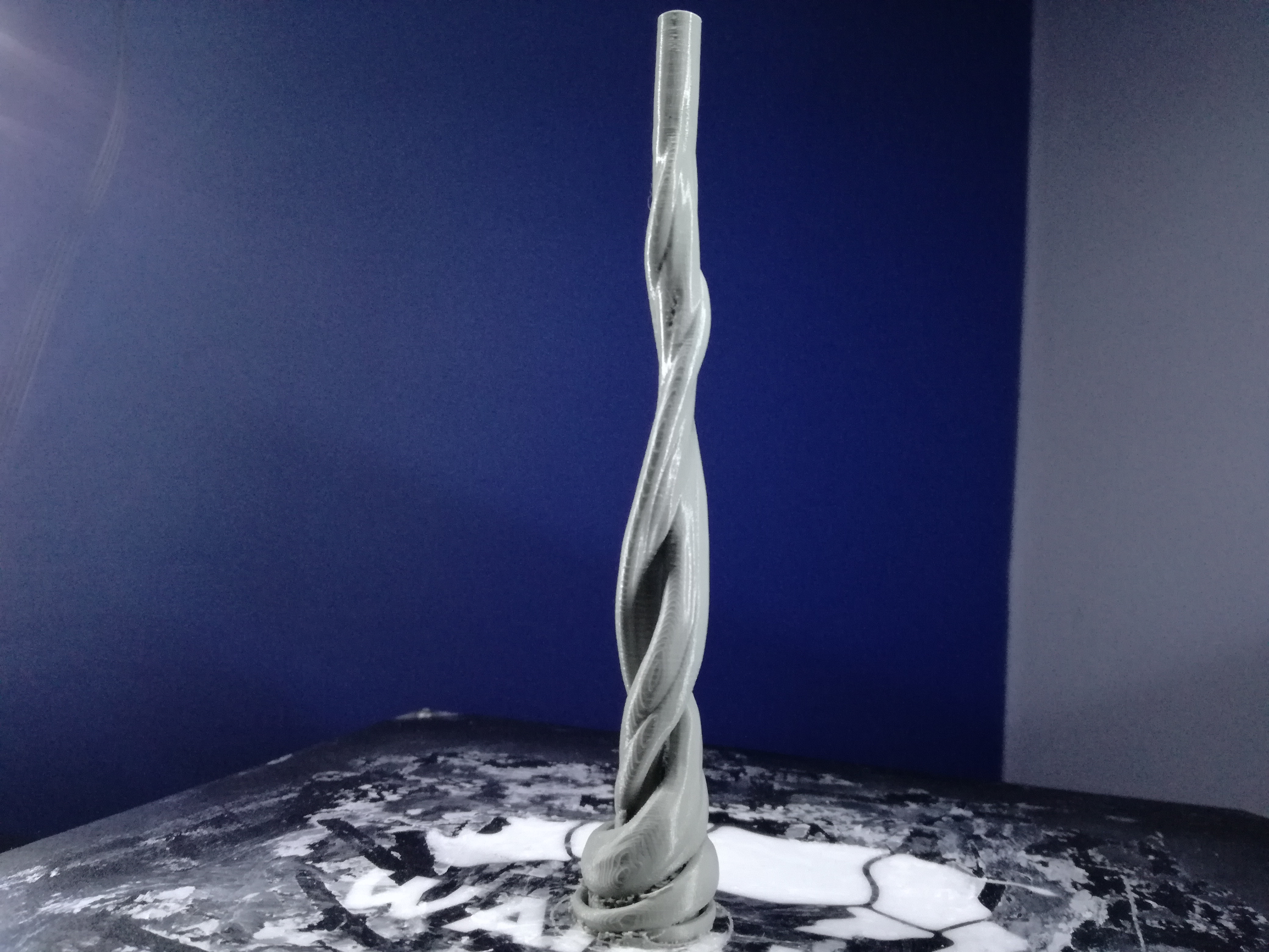

I printed a the main spiral part of the wand out today. Printed really well! 0.06 layer height and 15mm/s speed. Took ~10 hours to print this part! Super happy with how it came out!

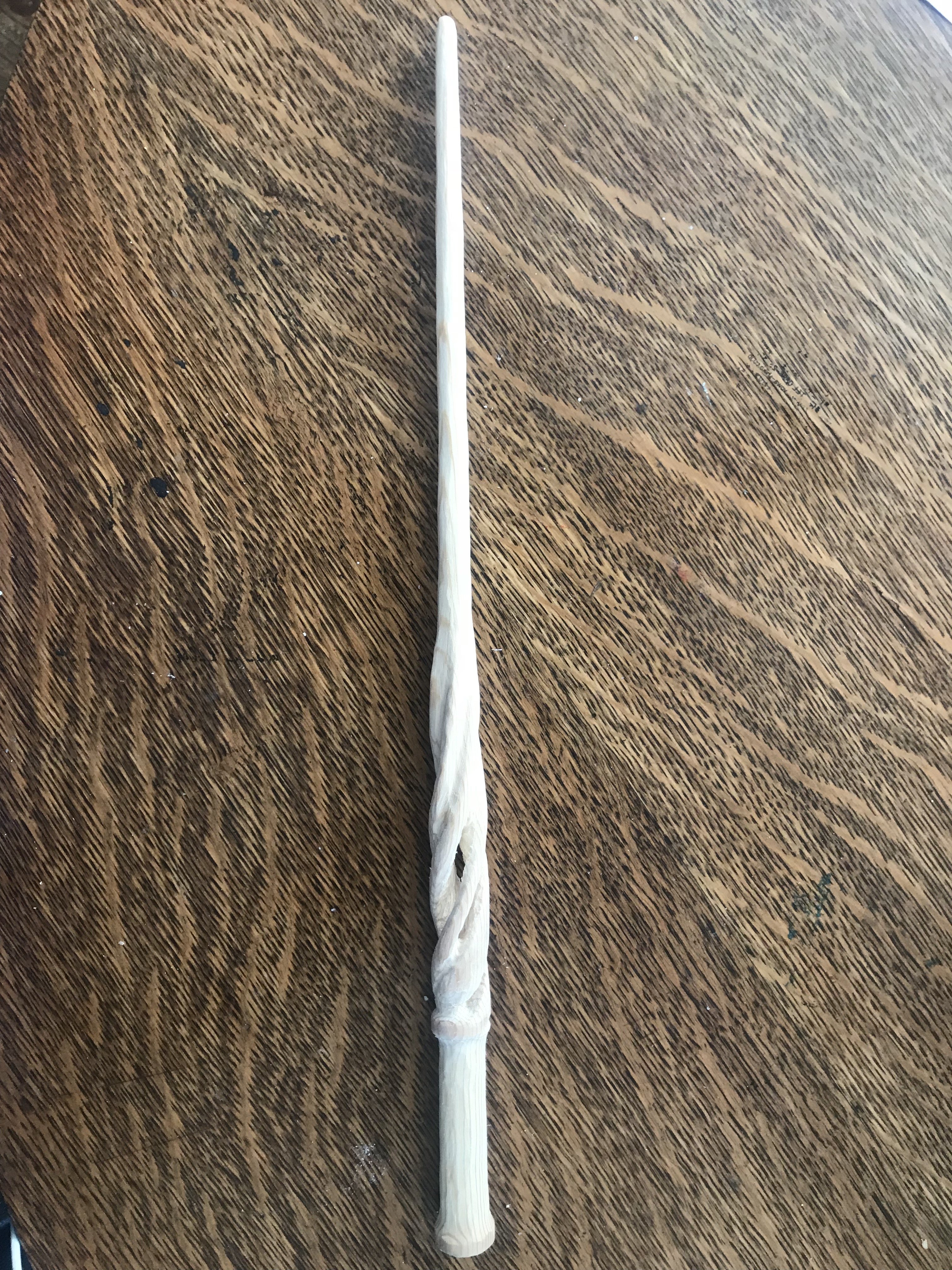

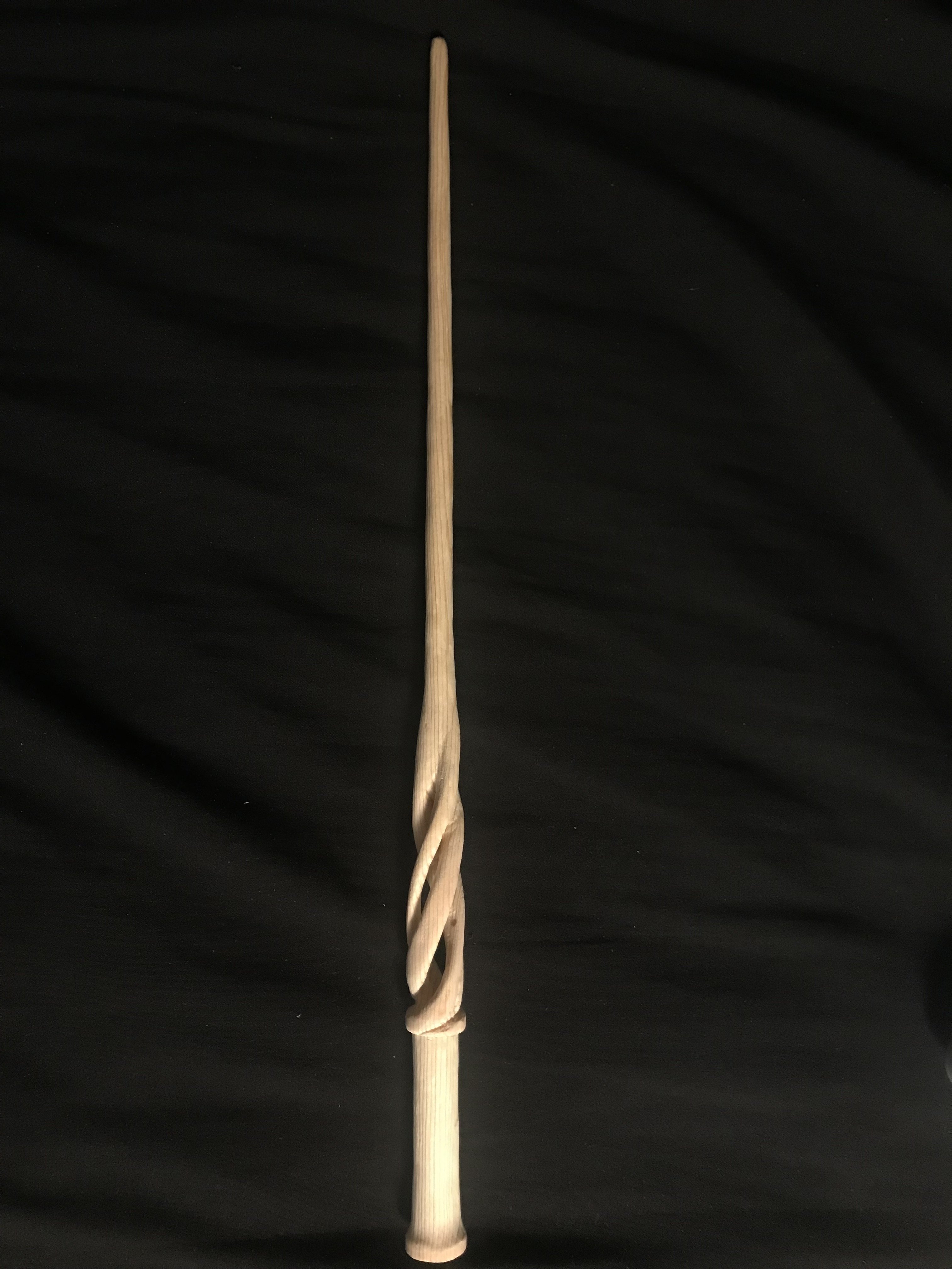

I carved out the rough shape for the wand, now to finish it up! All done with a pocket knife and dremel tool
Woah! Awesome!

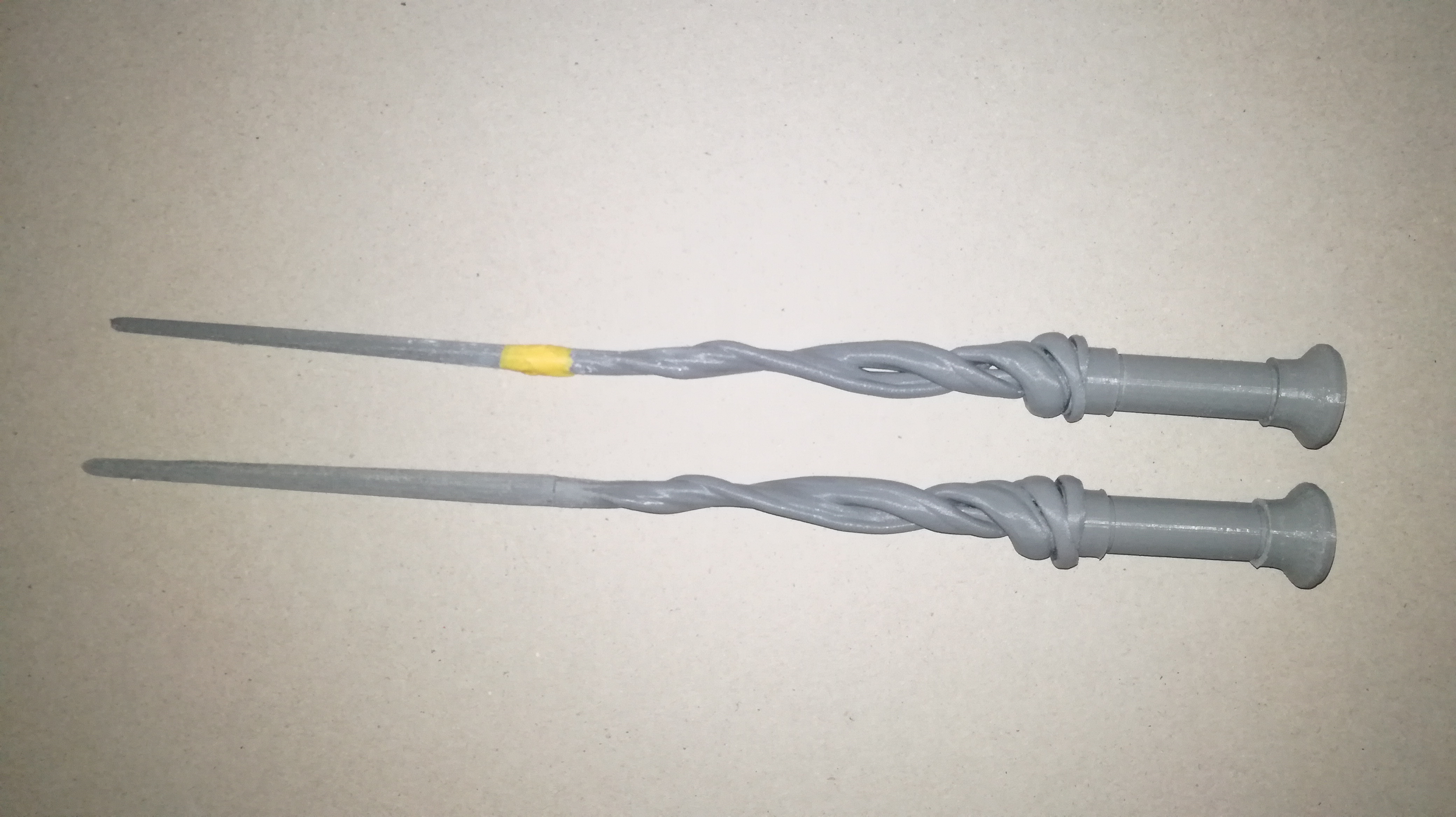

I've printed the initial, I guess, prototype of Dumbledores Wand. I've already made some changes to the model, made a few things a little thicker, increased some tolerances etc...

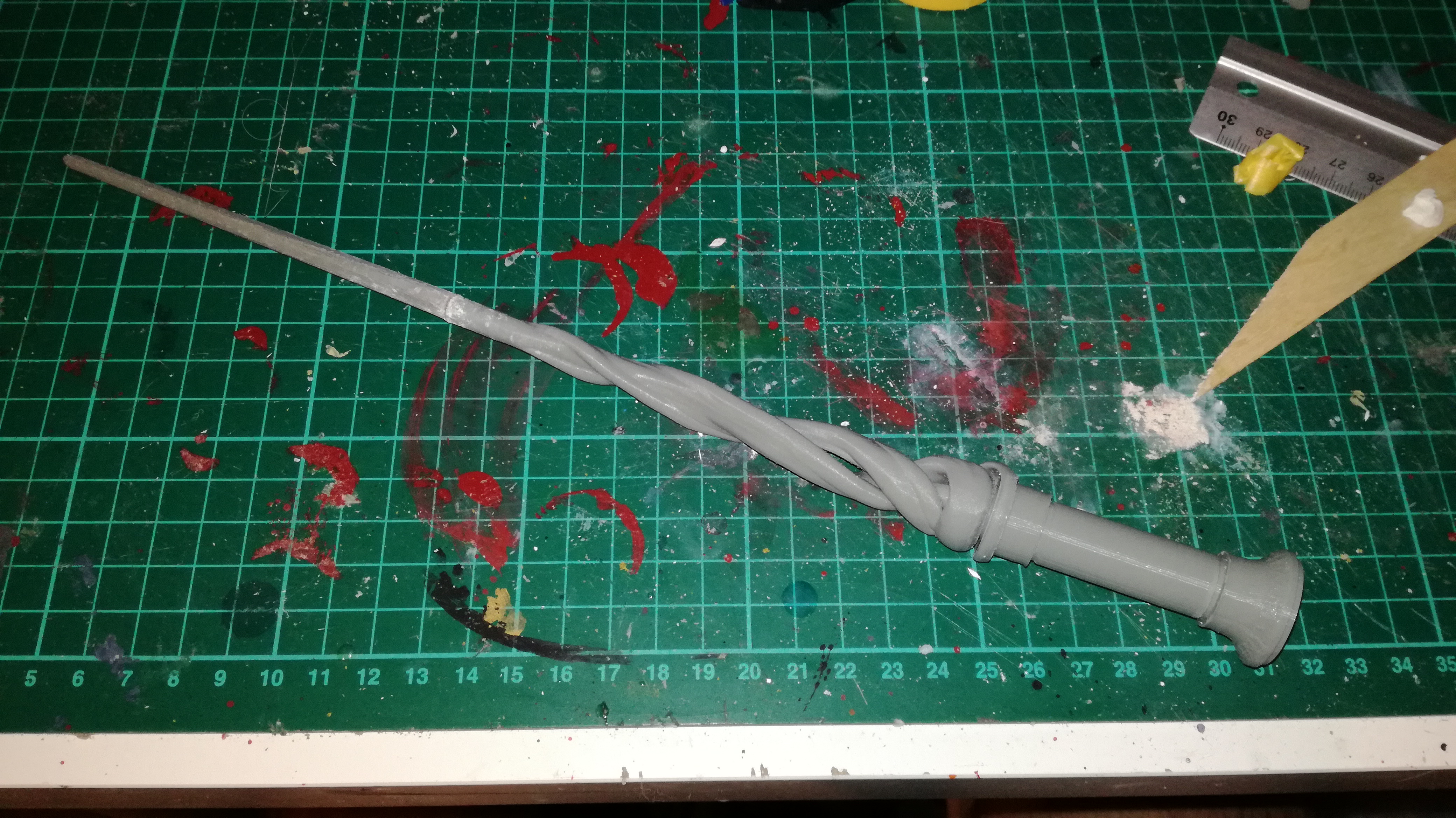

V2 of the Dumbledore Wand printed. Handle is separate from the wand still. Will be fixed at the end. I'll probably get the handle sanded smooth, and then cast it in resin. Wand will remain 3D printed. Not sure how I'd go about casting the wand anyway. You can see compared to V1 a few changes made. I've made the bottom of the main wand a little thicker, and also thickened up the top part of the wand a little.
Next step is to sand the wand smooth, which should be a pretty simple job honestly. I'll probably go in with a dremel and blend the join a little better too.

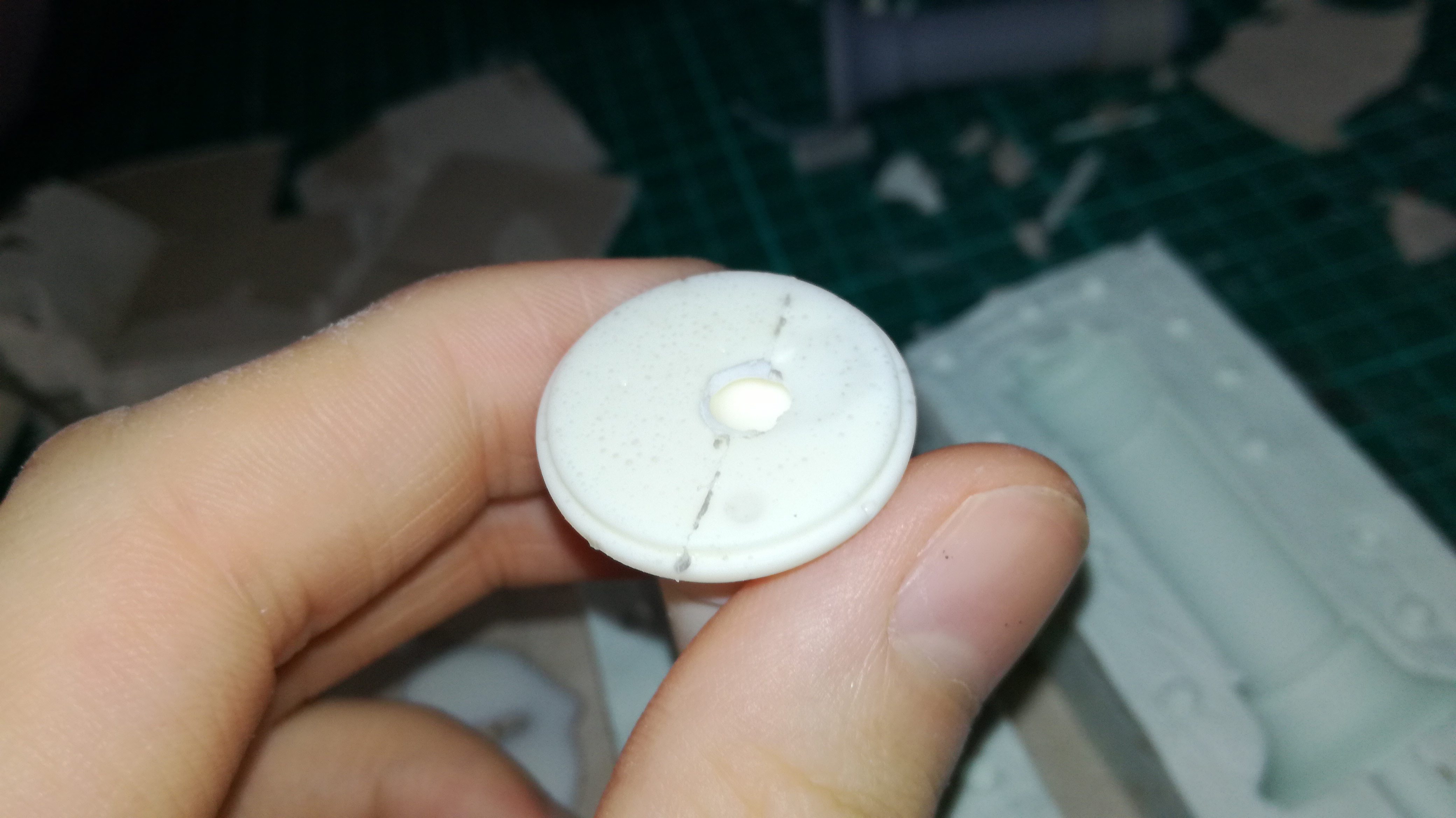

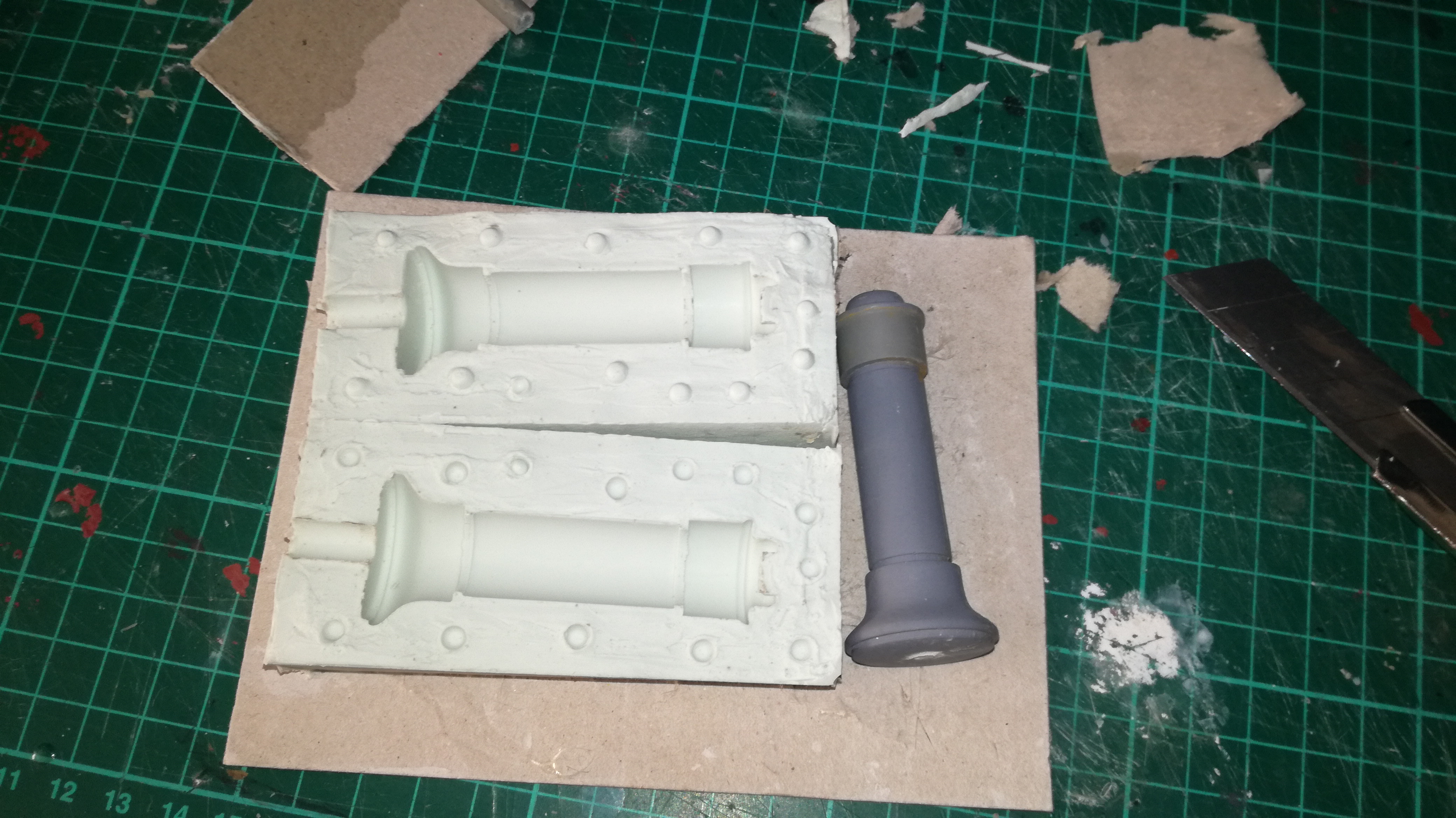

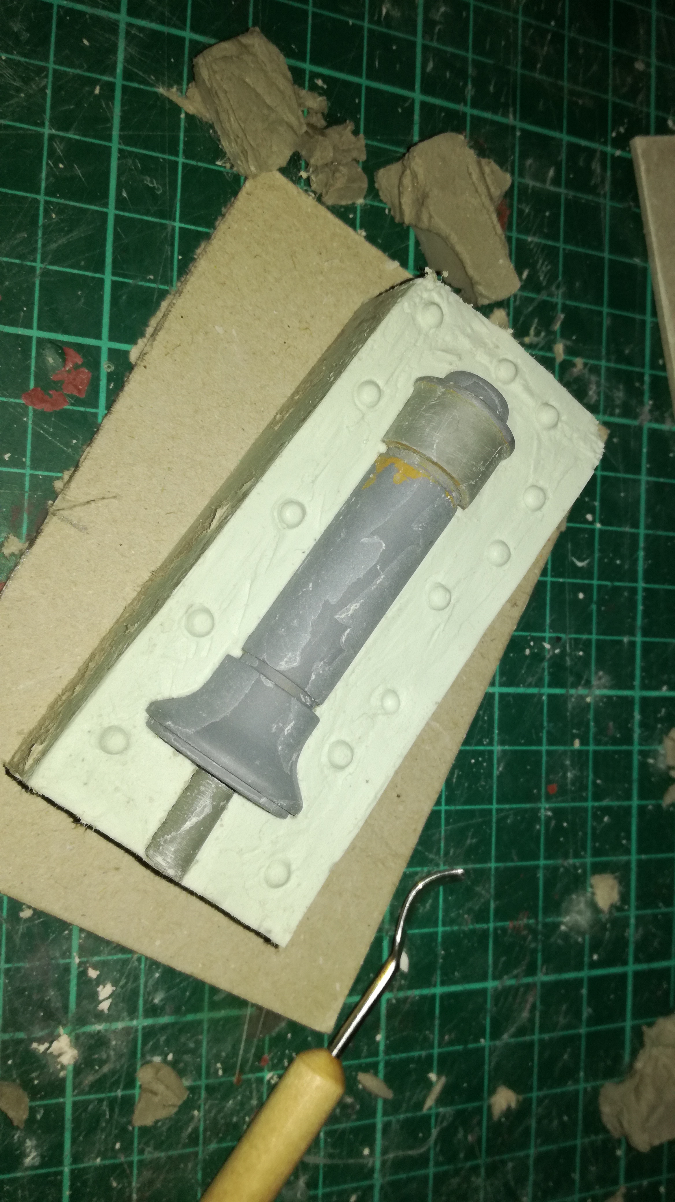

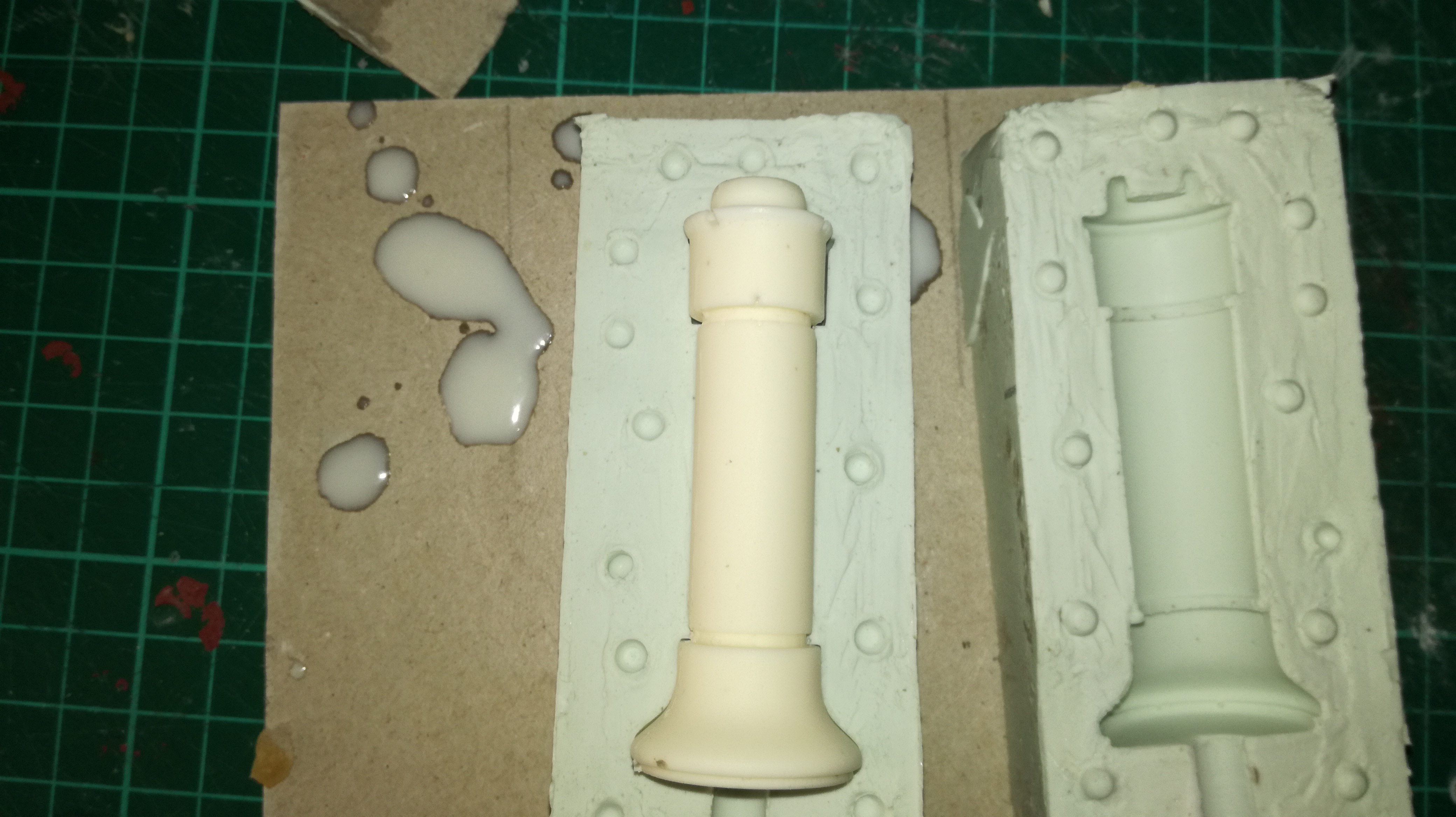

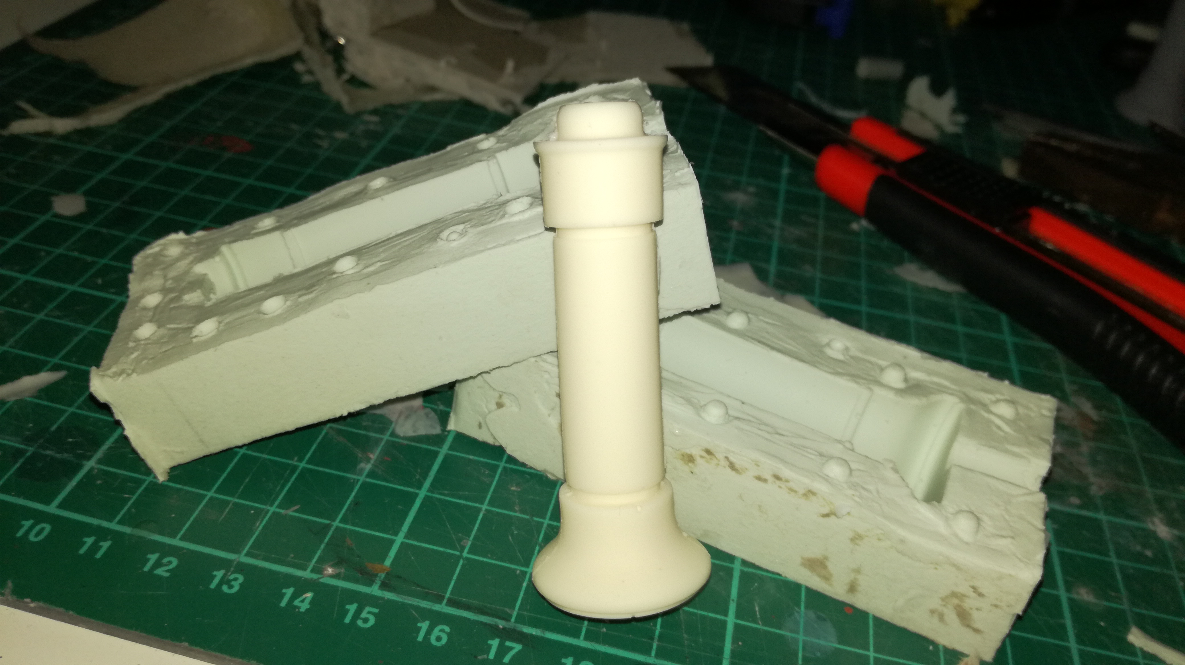

Wand handle mould was a success! First pull had a few issues, but I got a near perfect result from the second! Gonna spend the day making a few of these. They cure in 30-60mins so, should be able to churn a few out.
2018-10-09 09.42.47.jpg2018-10-09 10.37.49.jpg2018-10-09 10.37.57.jpg2018-10-09 12.51.29.jpg

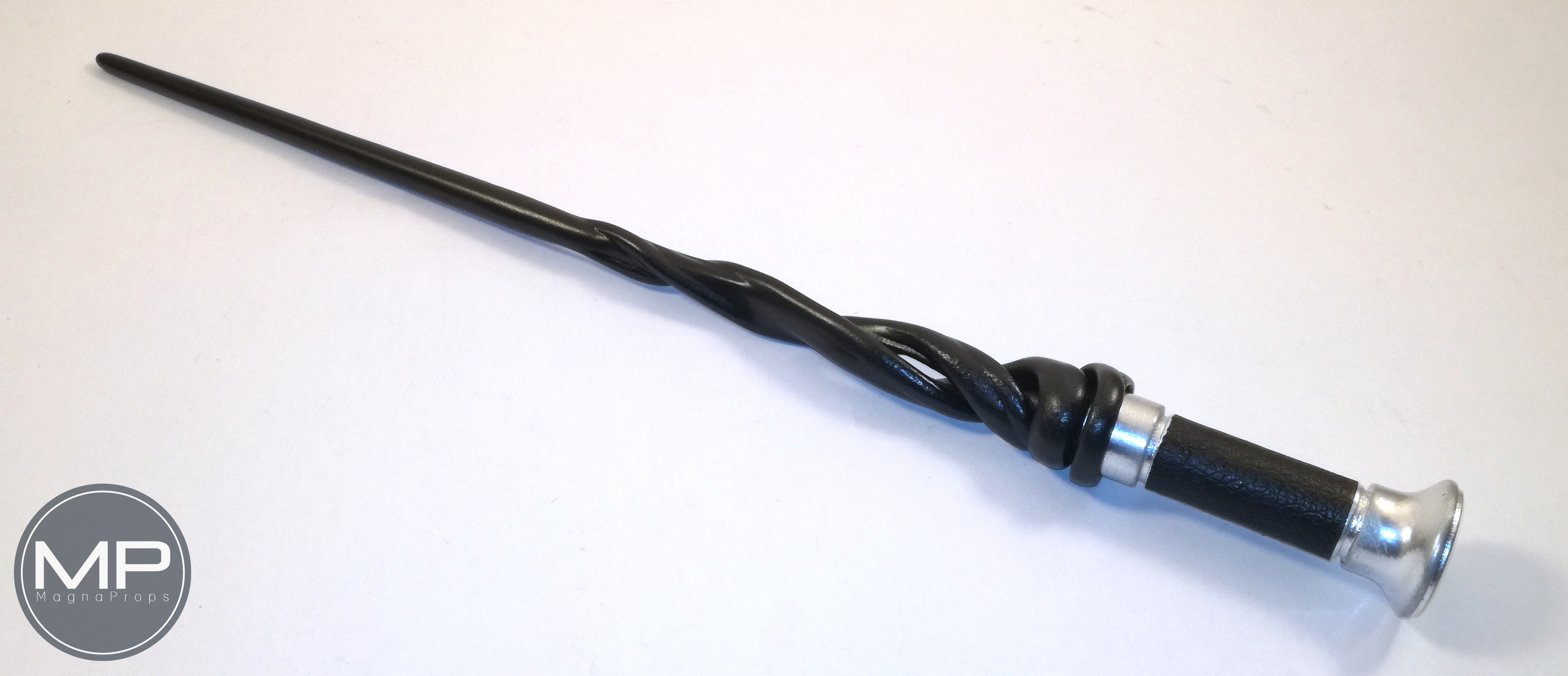

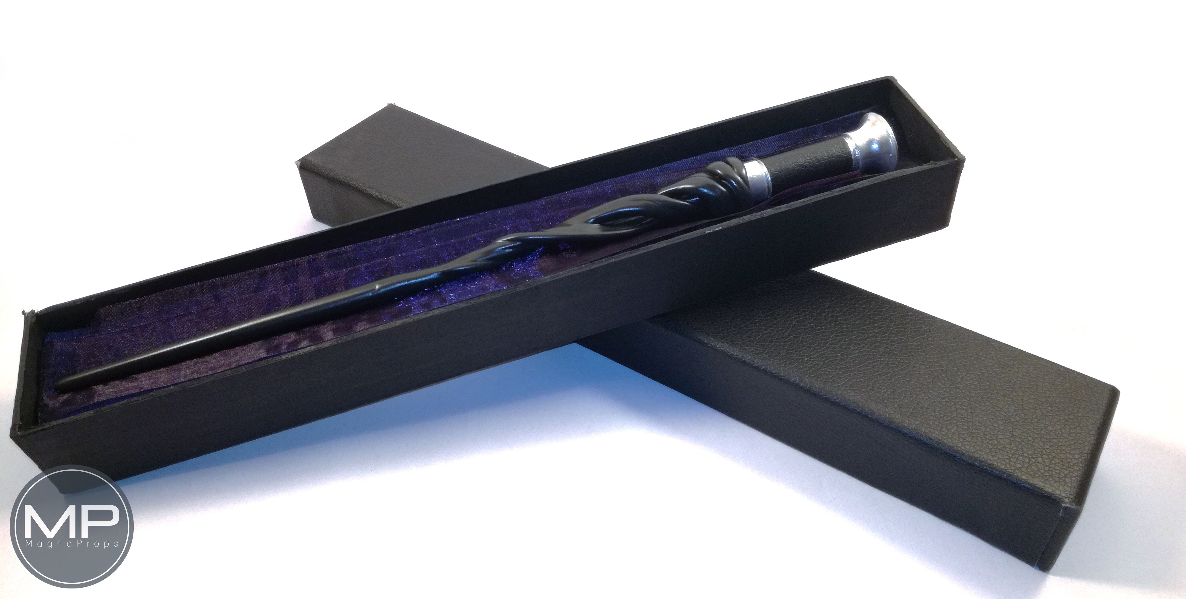

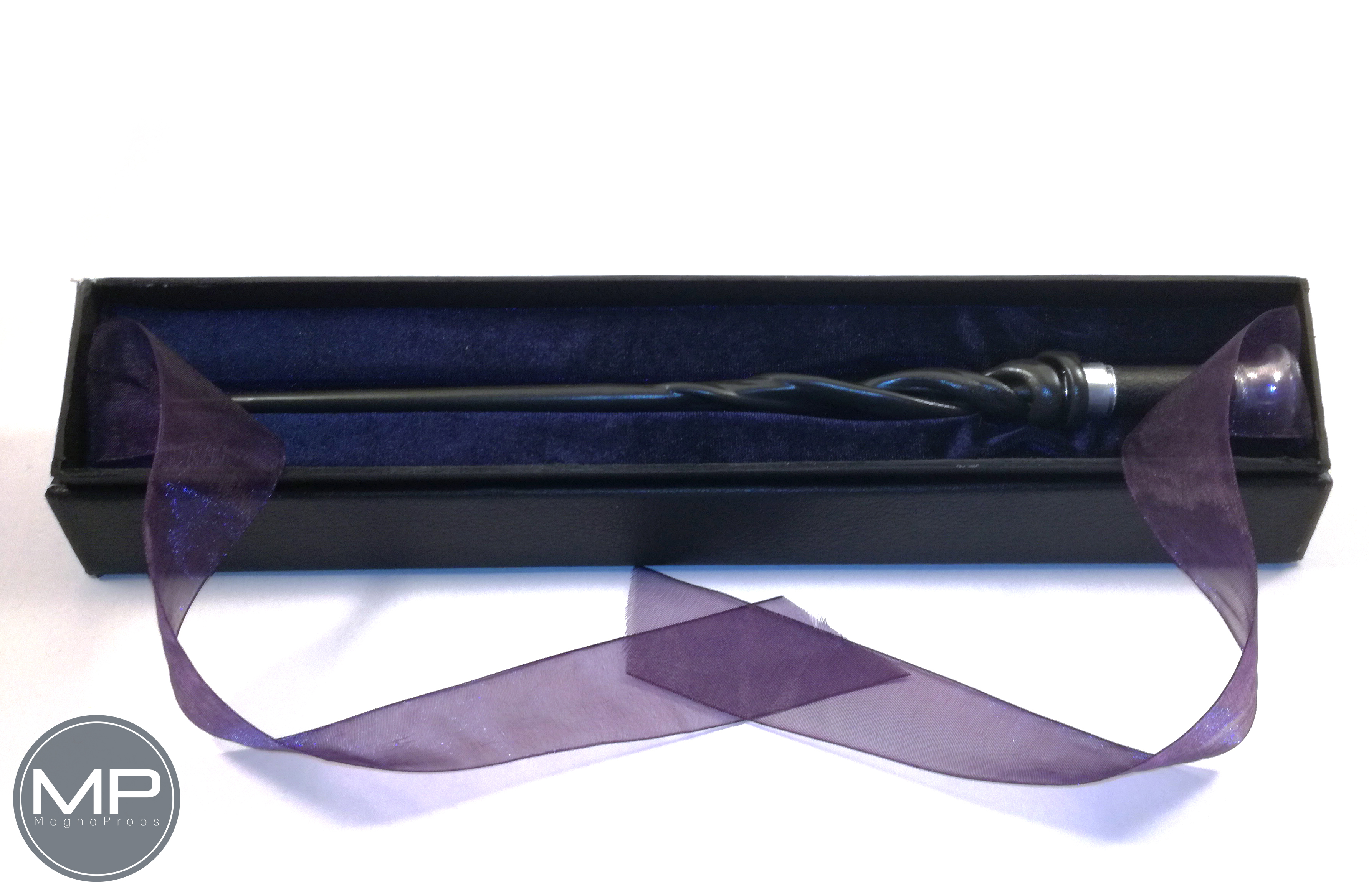

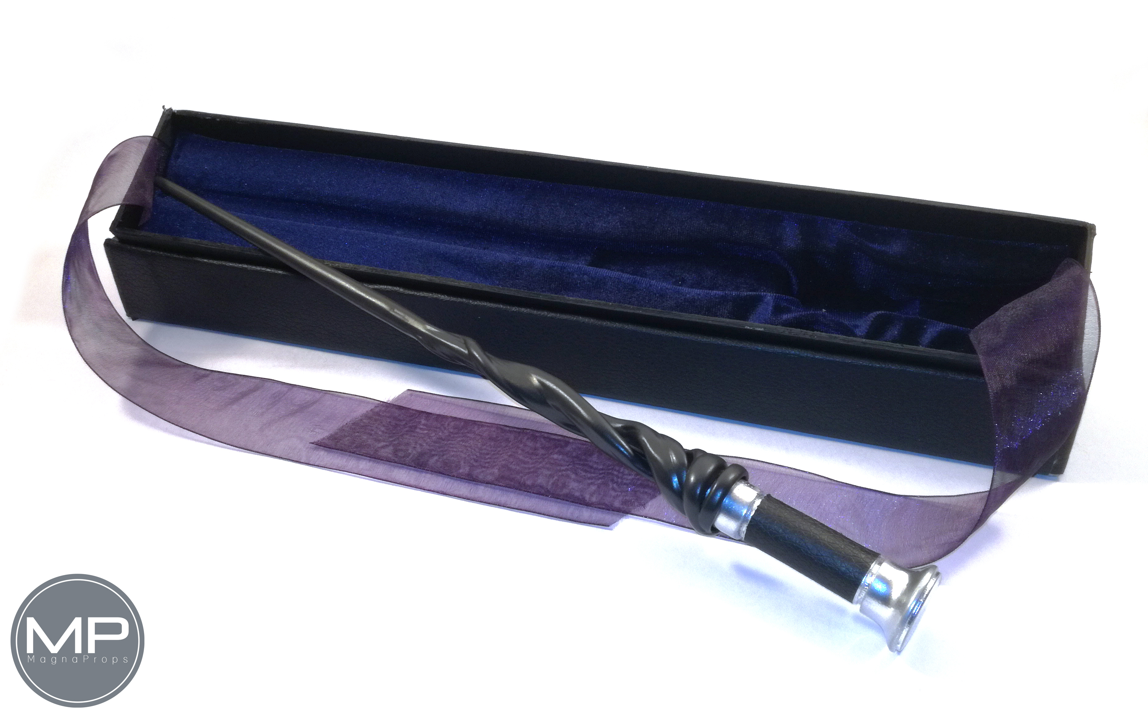

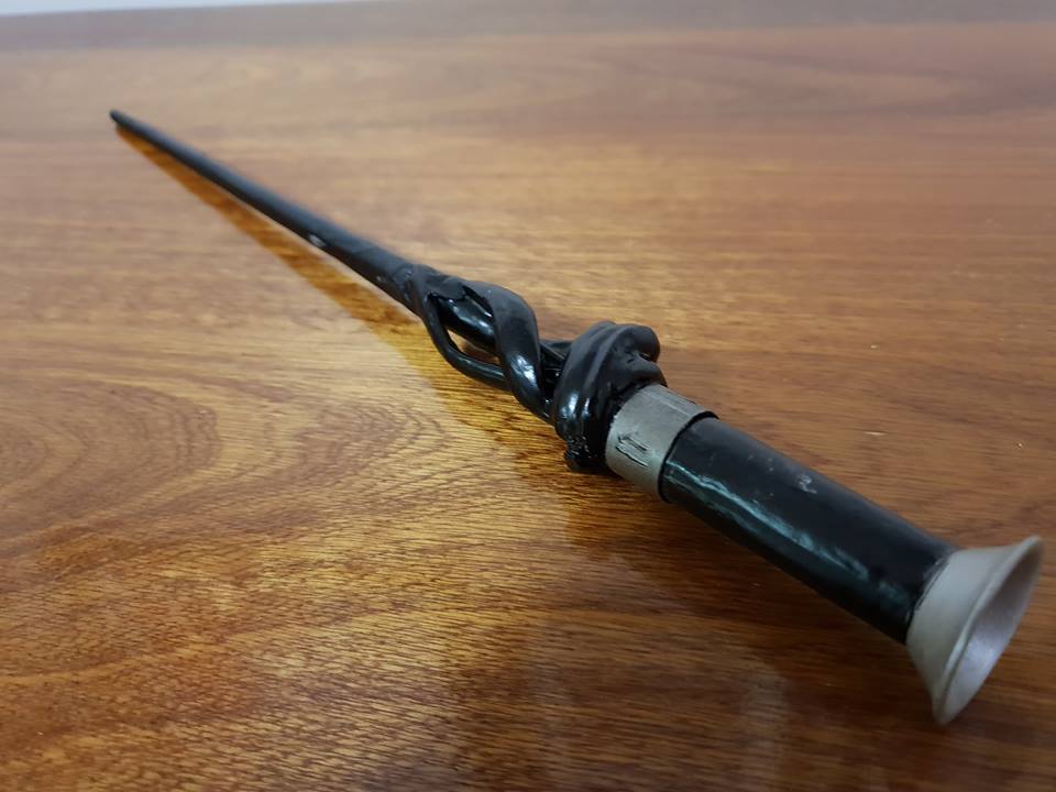

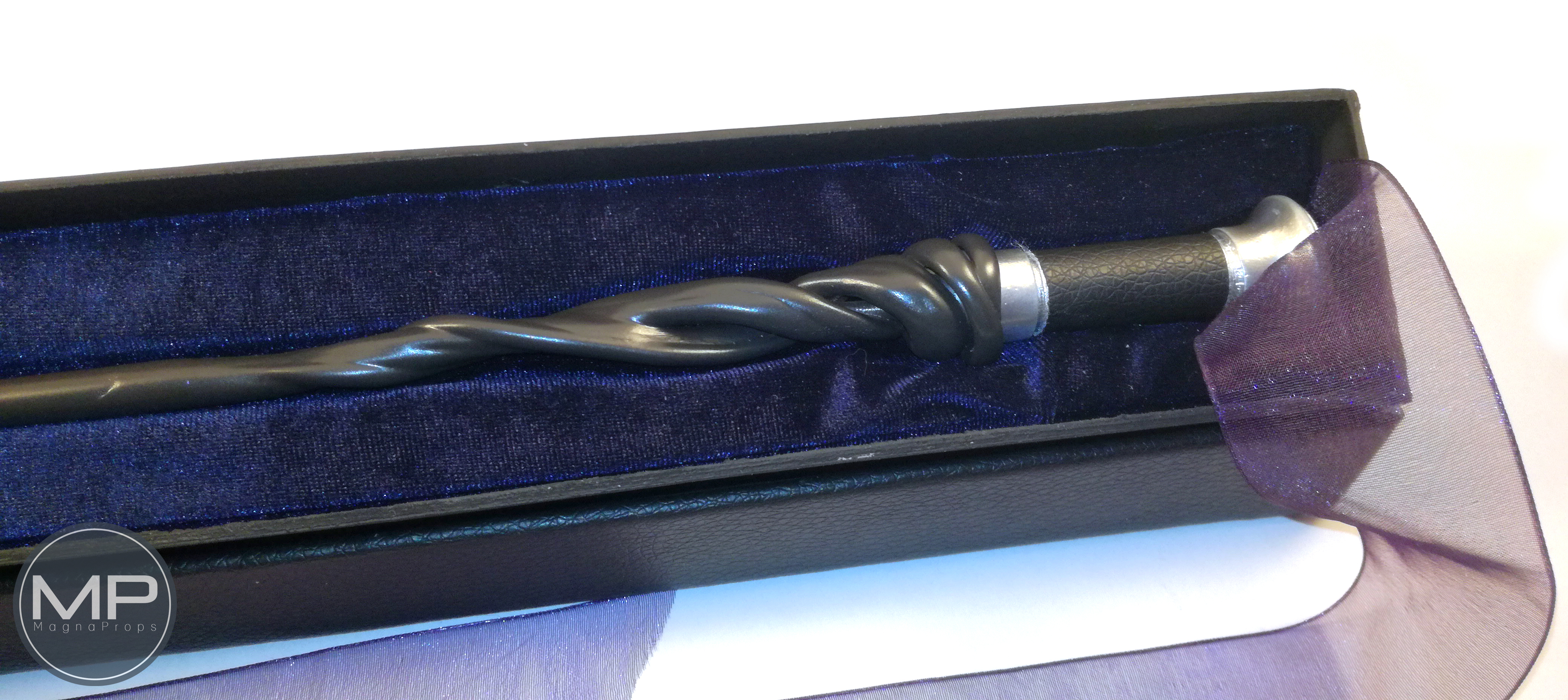

I just finished my attempt at the new design. Unfortunately I didn't notice the Noble collection had released theirs before I completed it. The end cap will have to be revisited one day.
