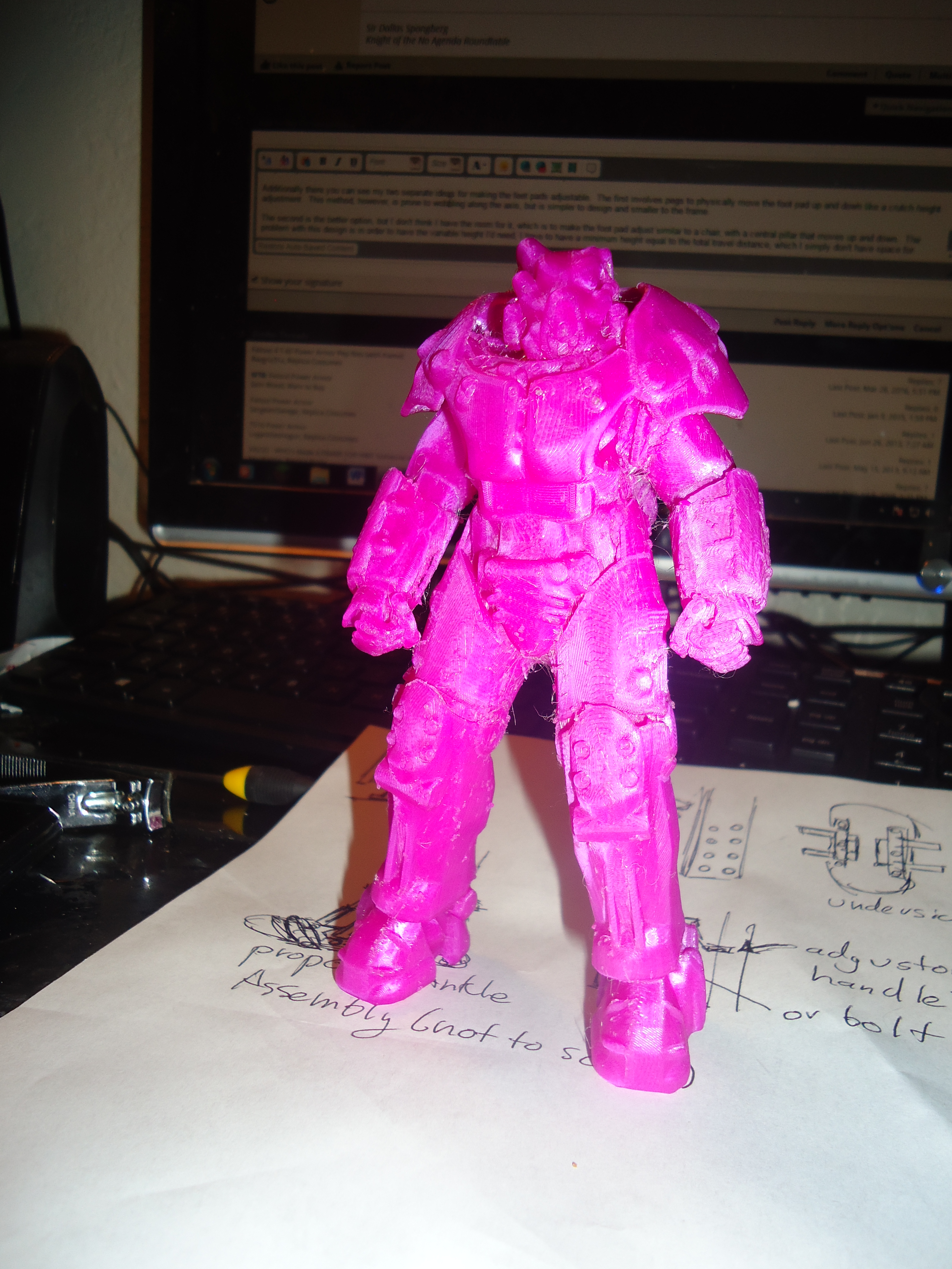

In addition, I have acquired a...serviceable obj file, that I have printed for reference and will be segmenting to use for pep until I can find better models.
