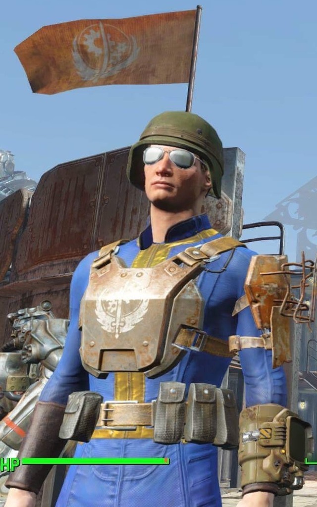

This is what I hoped to be able to recreate.

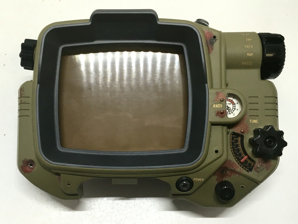

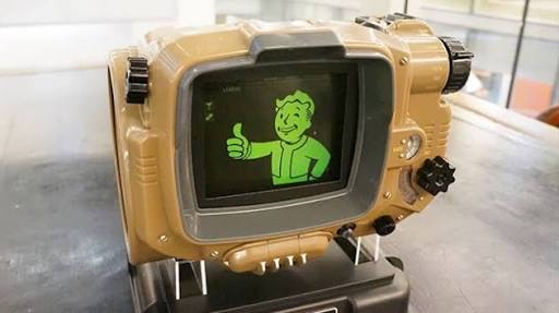

The first component was the Pip Boy. I picked up a Pip Boy Edition, but wasn’t happy with the base colour or the lack of weathering compared to the game. It started life looking like this:

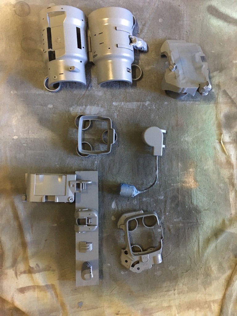

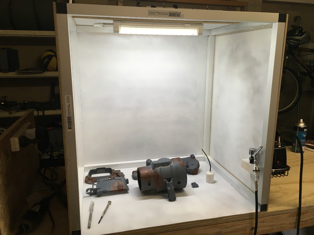

First I stripped it back to it’s components, lightly sanded and primed all the parts.

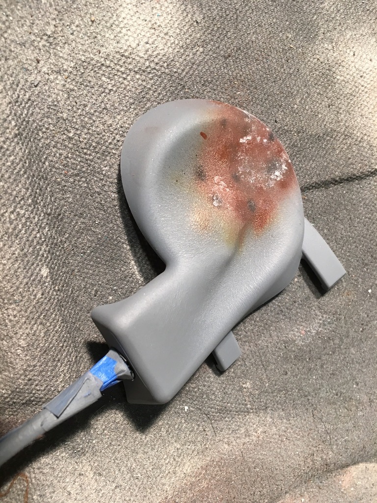

Next, after comparing the screenshots of the in-game Pip Boy, I applied a mottled mix of rusty colours to select areas.

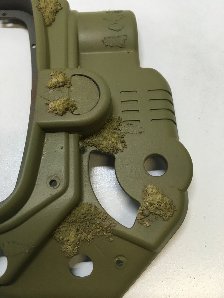

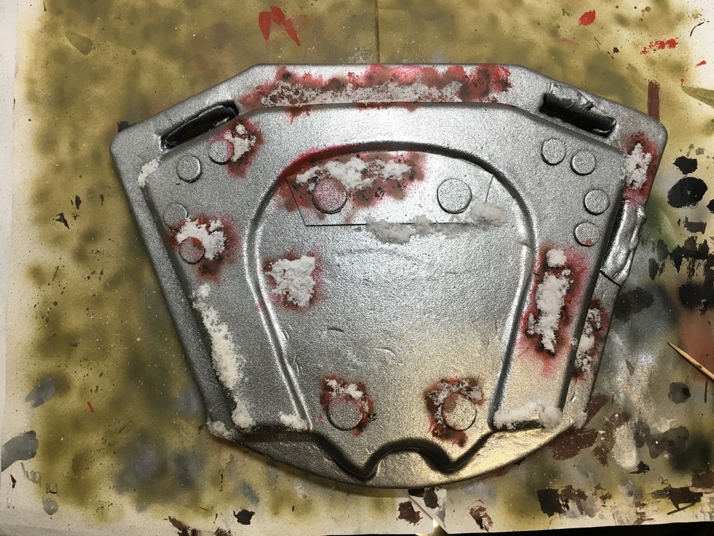

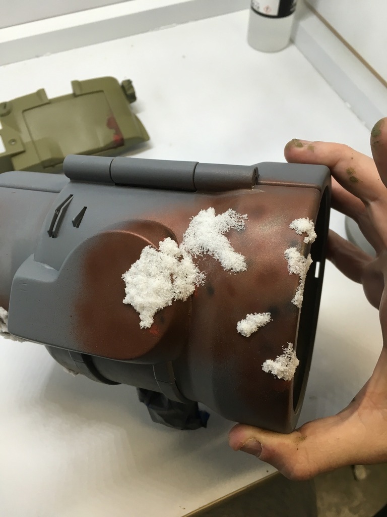

The intent next was to use salt to mask off the rusted areas so when I applied the green colour the salt would chip away to reveal the rust underneath. Unfortunately in my haste to dry the paint and get the next step done, I discovered that the plastic used to make the item has a very low melting point. I left this part in front of a halogen light for ten minutes and returned to find it looking like this

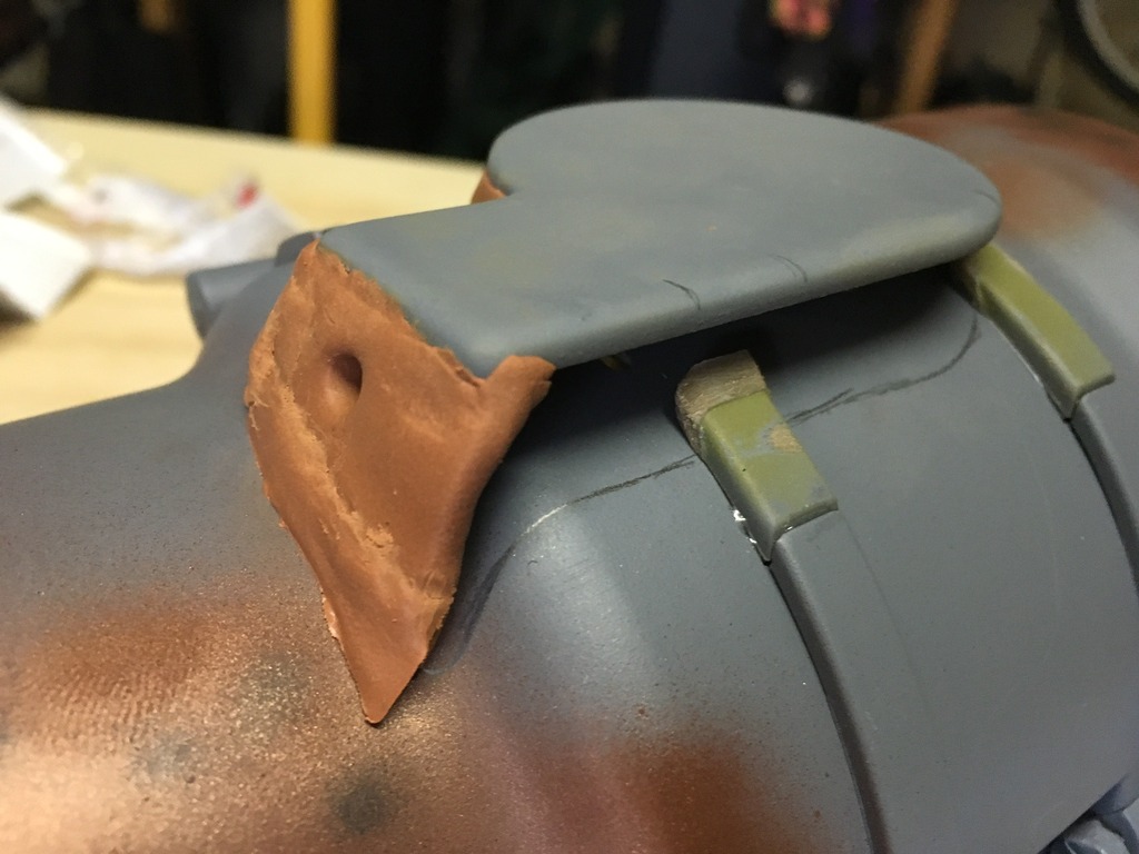

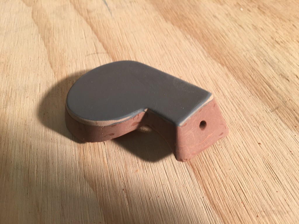

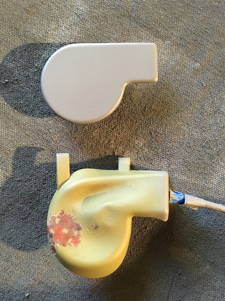

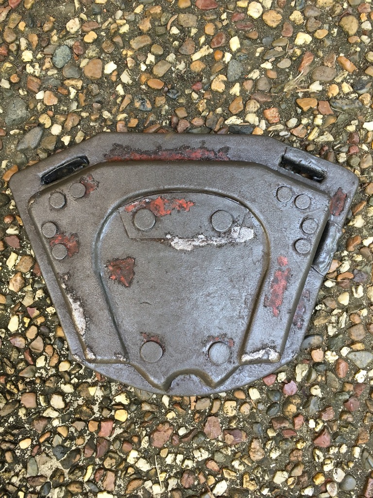

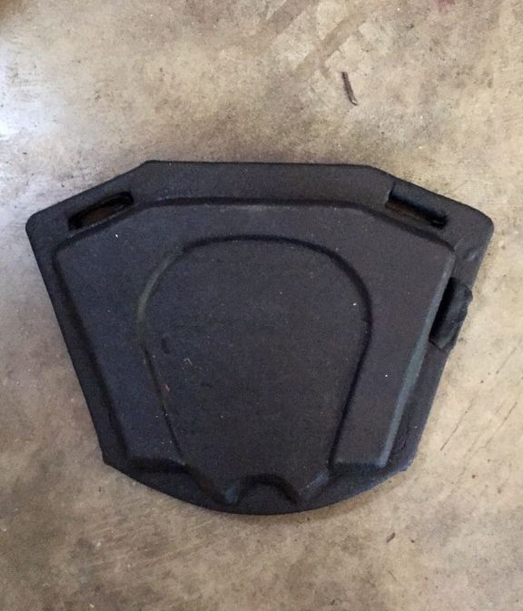

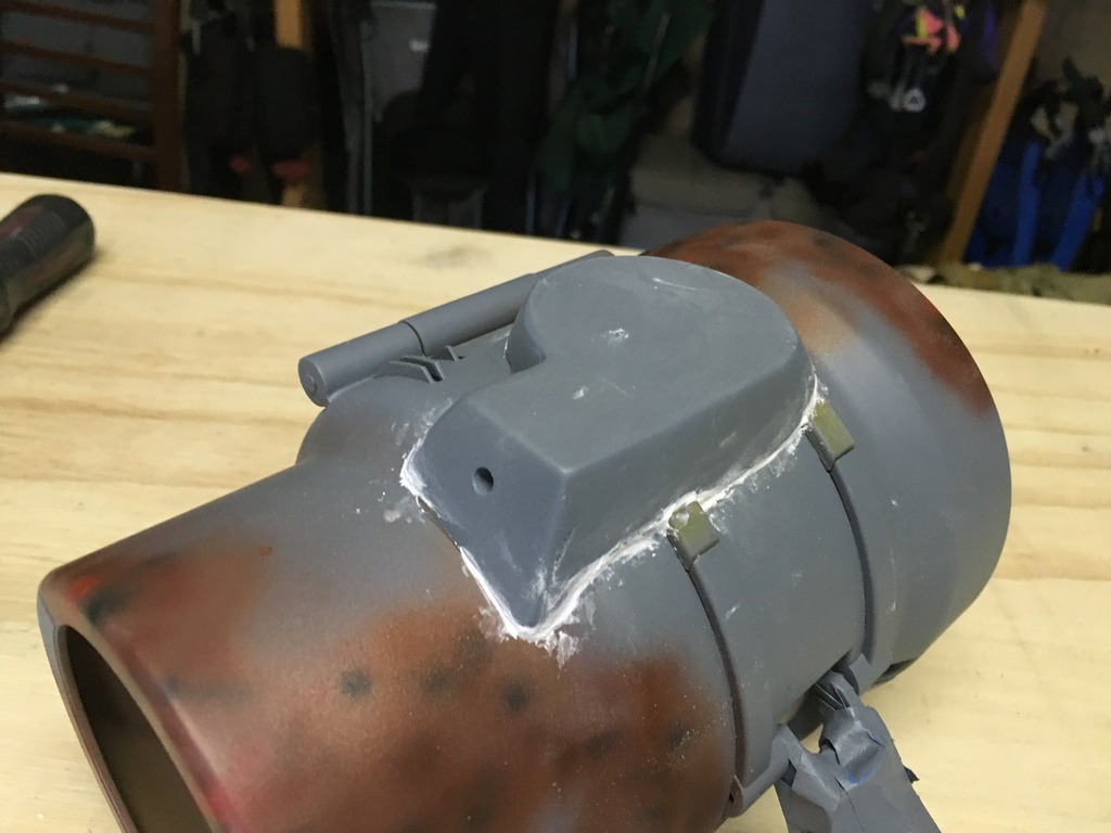

So now I had a new side project…recreate the destroyed component. I used a piece of MDF as the top plate and filled in underneath it with Fimo. Overall it worked out quite well, plus I got taught the valuable lesson of not trying to rush things
(you can see in this first picture how the salt chipping method leaves the rust appearance)

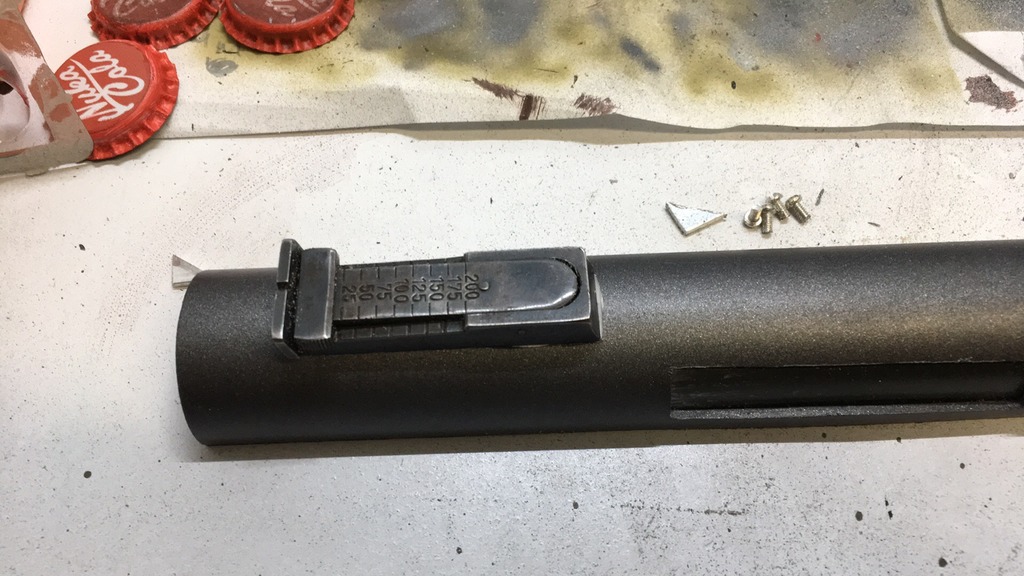

So with that crisis averted, I went back to the main task. Next thing I wanted was to replace all the plastic moulded screws with real ones. After much searching I found the perfect screw and began cutting off the originals and inserting the new ones.
(metal screw on the left and original moulded screw on the right)

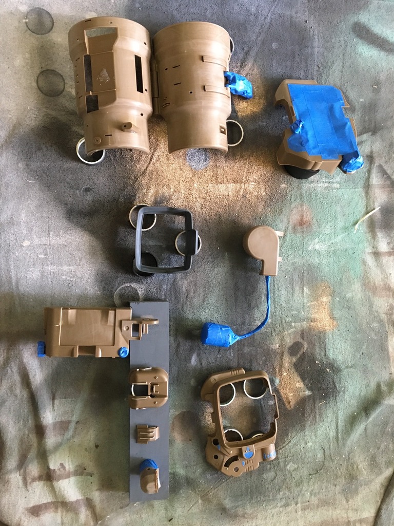

With that done it was time to give the Pip Boy its new colours
Then started applying the grime and weathering

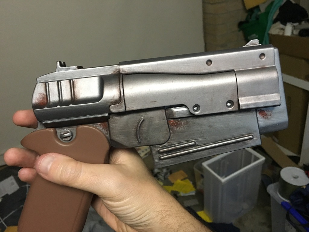

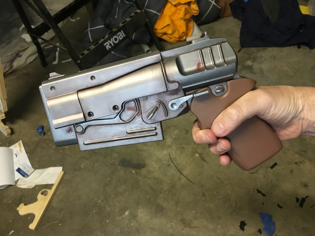

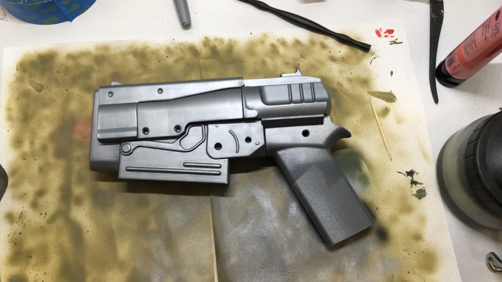

Next I bought a 3D print of the 10mm pistol from Traywick Designs on Etsy. The pieces were really clean and fitted together beautifully.
After some sanding and filling, it was an easy job to assemble and weather. The only addition to the kit was that I added in some real screws (again) to add to the detailing.

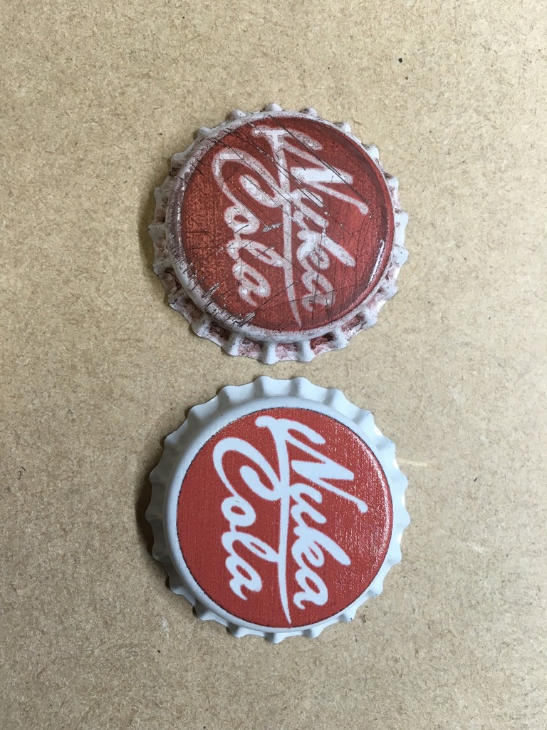

I also picked up some bottle caps which I had custom printed to match the Nuka-Cola caps from the game. These came in looking really good, but of course, needed to be weathered.

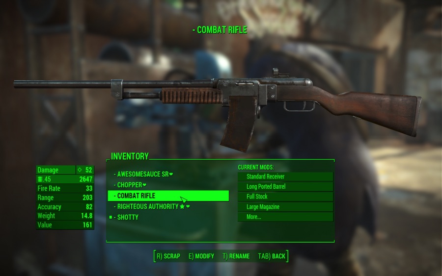

I decided to have a go at building my first scratch built weapon. The combat rifle (below) was what I wanted.
But I loved the barrel magazine on the shotgun

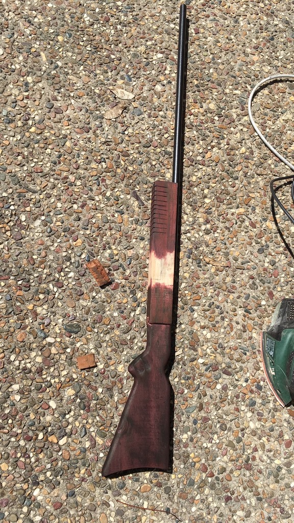

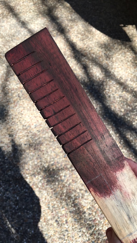

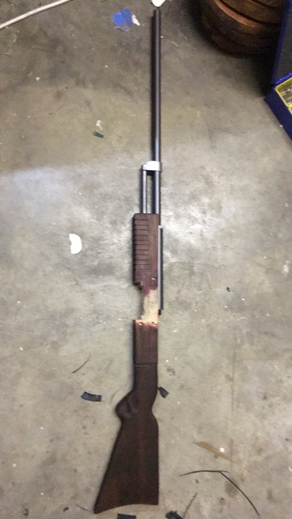

I started with just an off cut of treated pine that I had lying around in the garage and used my Dremel to etch in the grip onto what would become the front of the rifle. I used a mahogany stain to darken up the timber as well.

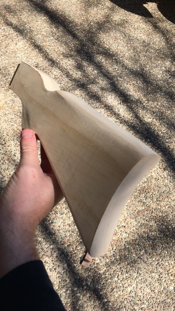

Then using a pine plank (again, off cuts) I shaped up the butt stock
Stained and cut a curtain rod to length for the barrel for the first test fitting.

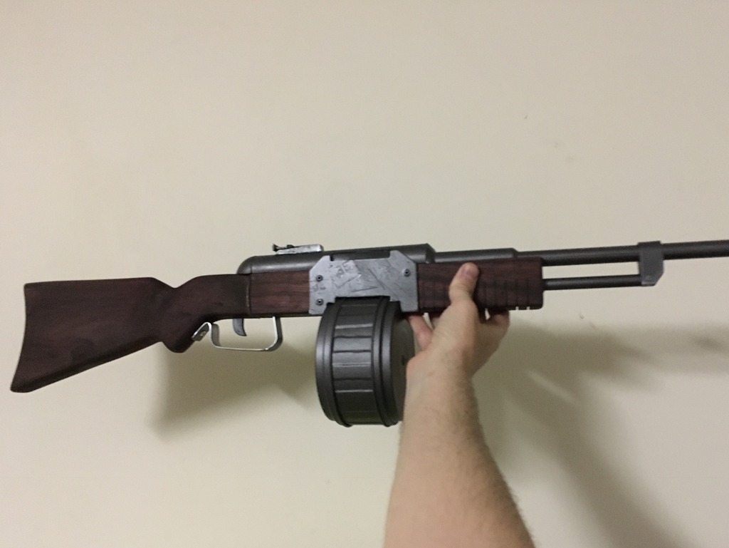

Next I made the barrel magazine from an off cut of PVC pipe, worbla (my first ever use), and the lids off two mosquito coil tins!
I then cut down some aluminium tubing and flat stock to create the gas system

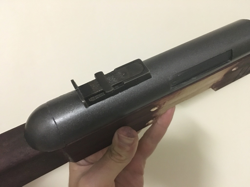

Lastly I created the receiver using a couple of different thicknesses of PVC pipe and filled with Knead-It to close off the gaps, and cut down an ping pong ball to make the rounded rear portion. To top it off I added a real rifle sight to the top.
Finally I used some thin MDF to make the metal plates for around the cocking handle and ejection port, attached the magazine and trigger and it was done. Simple!!

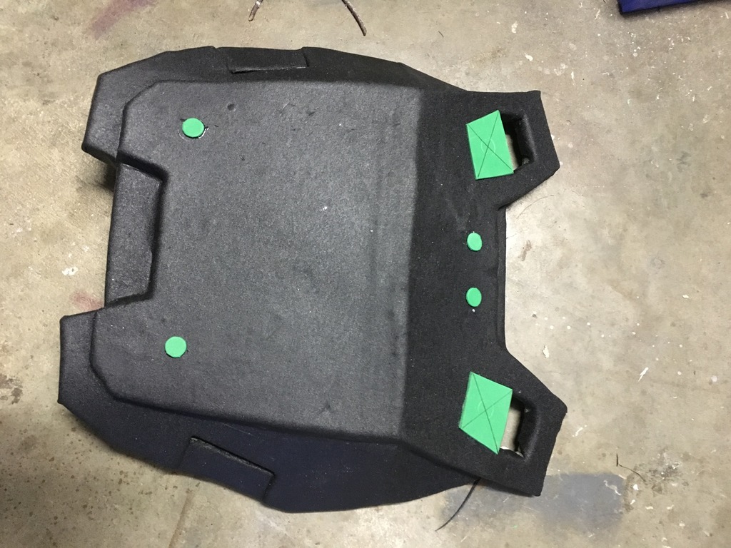

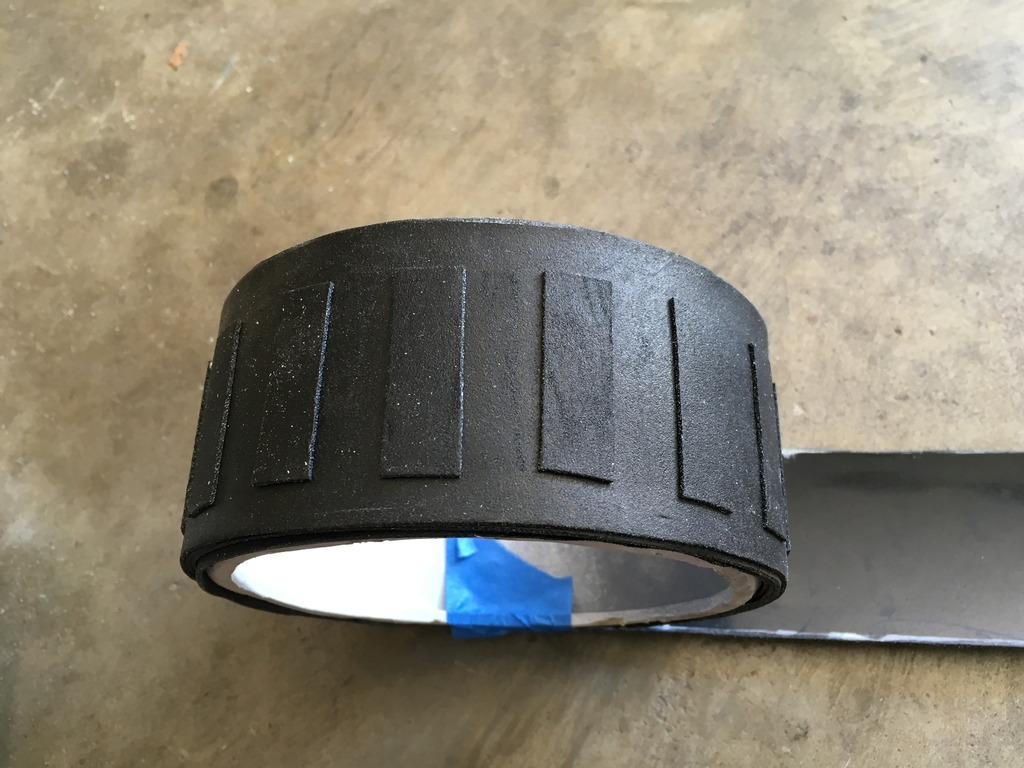

Lastly the body armour. This was my first attempt at crafting from foam and Worbla (aside from the Worbla I used on the magazine).

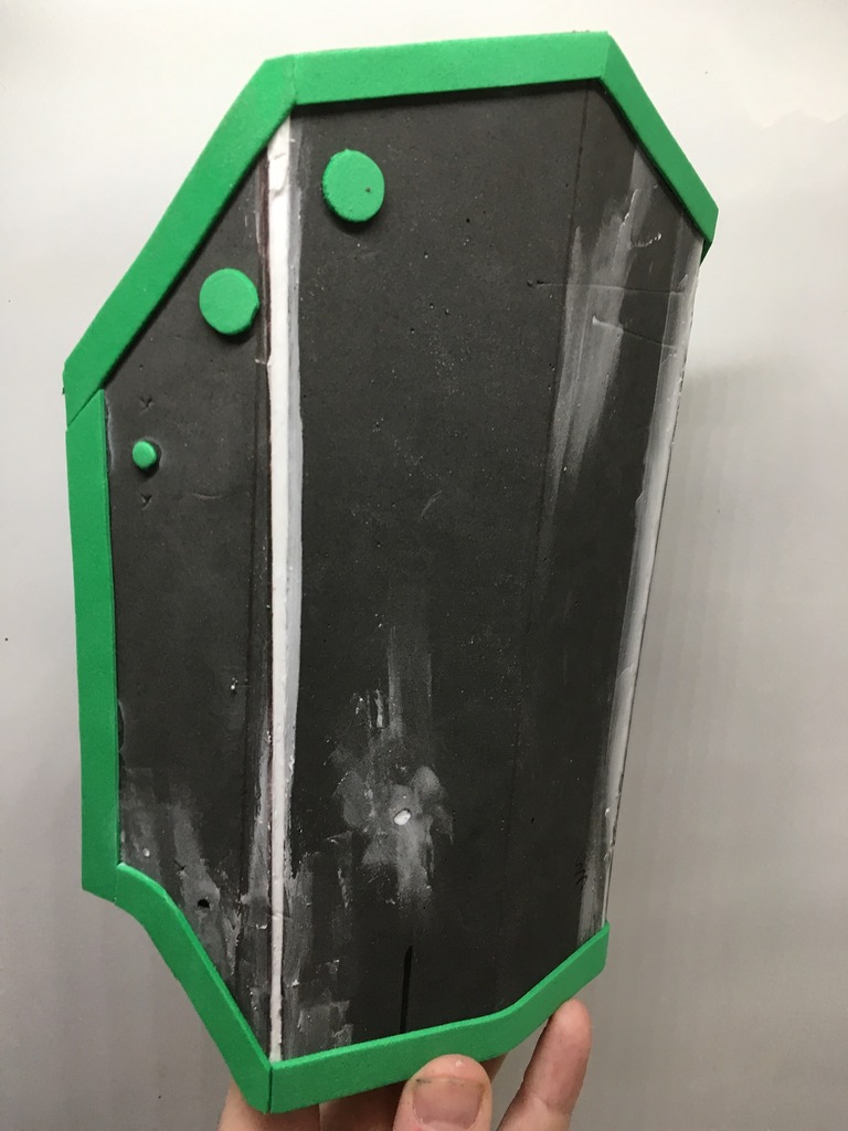

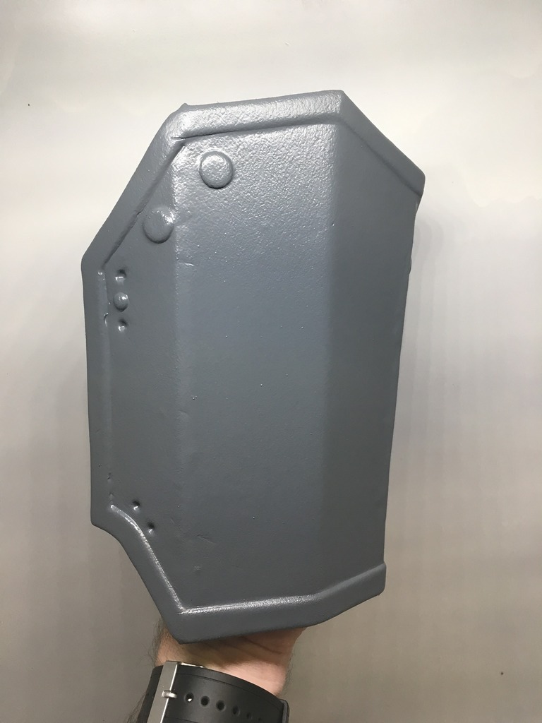

From the above I made a pattern and cut out the pieces from two thicknesses of foam and assembled
Then covered in Worbla

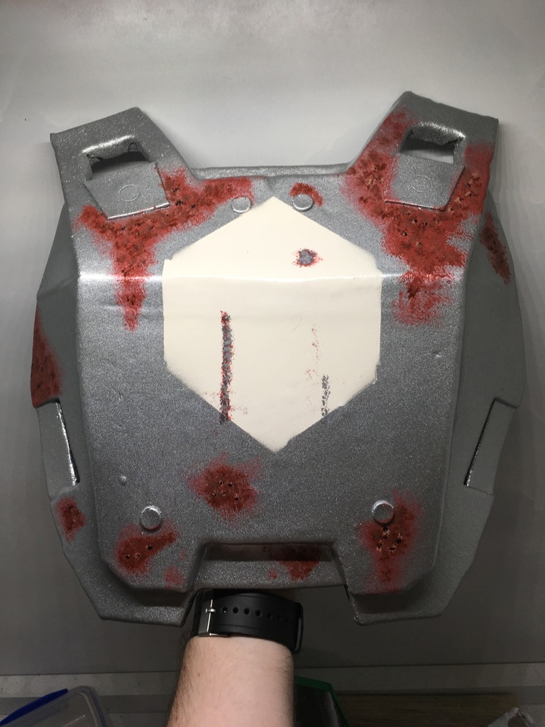

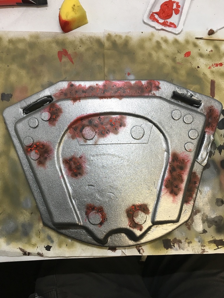

Attached the detail and began painting. I used a silver as the base coat and then the same salt method as I had used on the Pip Boy to create some chips and rust.

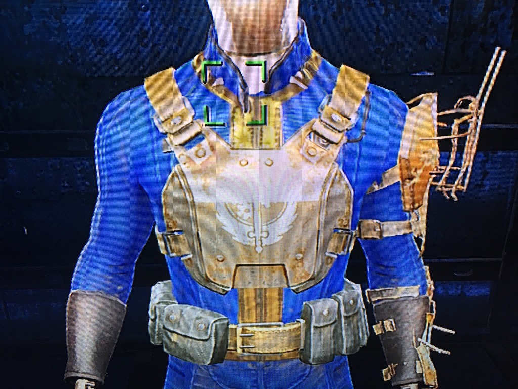

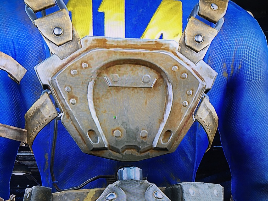

The process for the front was broadly the same except I wanted to put the BOS symbol on the front like the ref pic
Assembled the foam and covered in Worbla again (I forgot to take pics through that part)
When painting this time I applied the white patch with I would mask off to put on the BOS logo. Some of the weathering was done before and some after to get the logo to look suitably worn
To stencil the logo, I used a decal of the logo which i dusted the adhesive side with talcum powder to reduce its stickiness, then applied, top coated and removed the decal while the paint was still wet. I learned from a couple of testes that if I waited for the paint to dry too much it would lift when the decal was removed. I was really nervous starting the process, but very happy with the final result

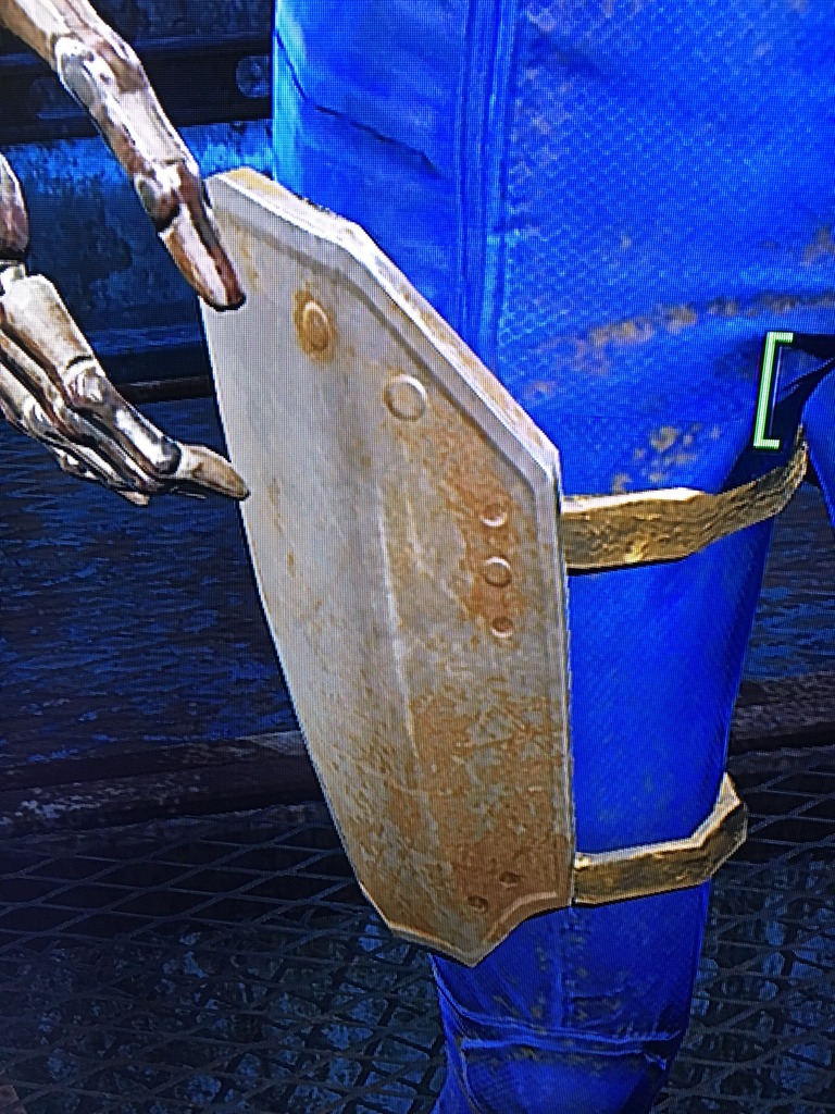

Next piece of armour was the leg.
Again I formed it from foam
Before covering with Worbla and painting

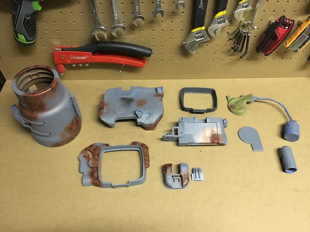

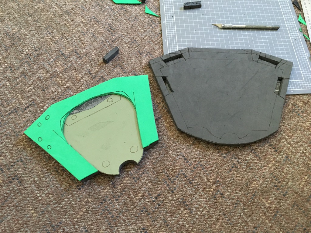

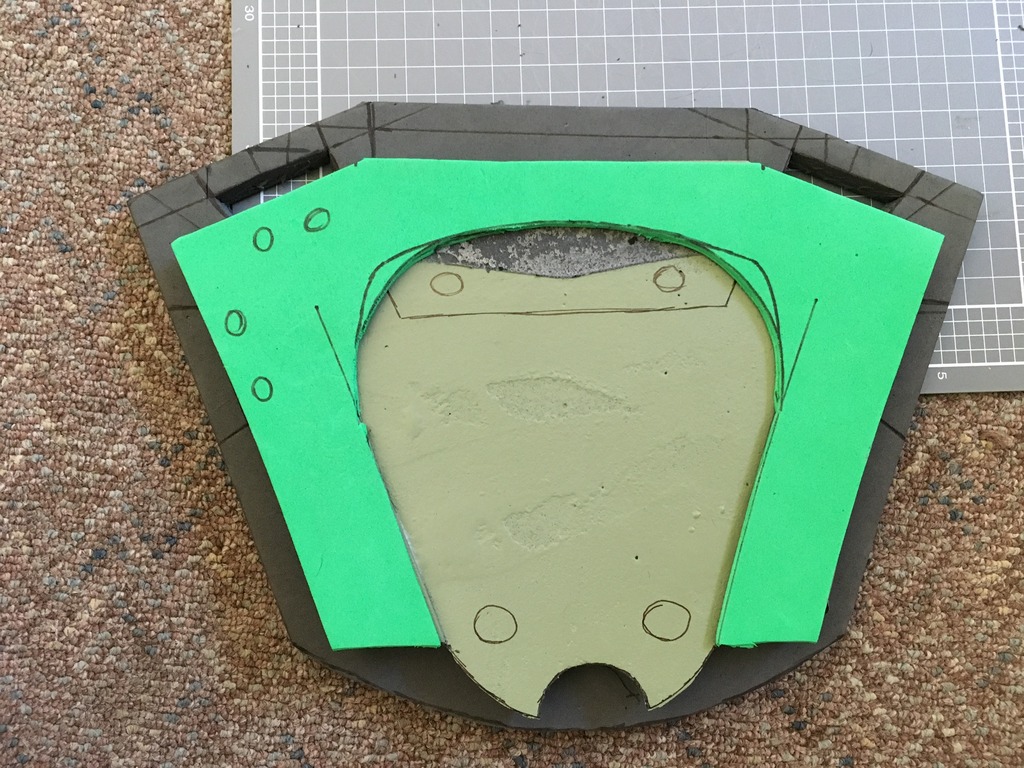

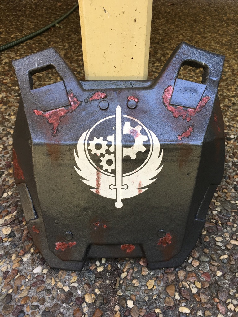

And with the salt chipped away to reveal the rust

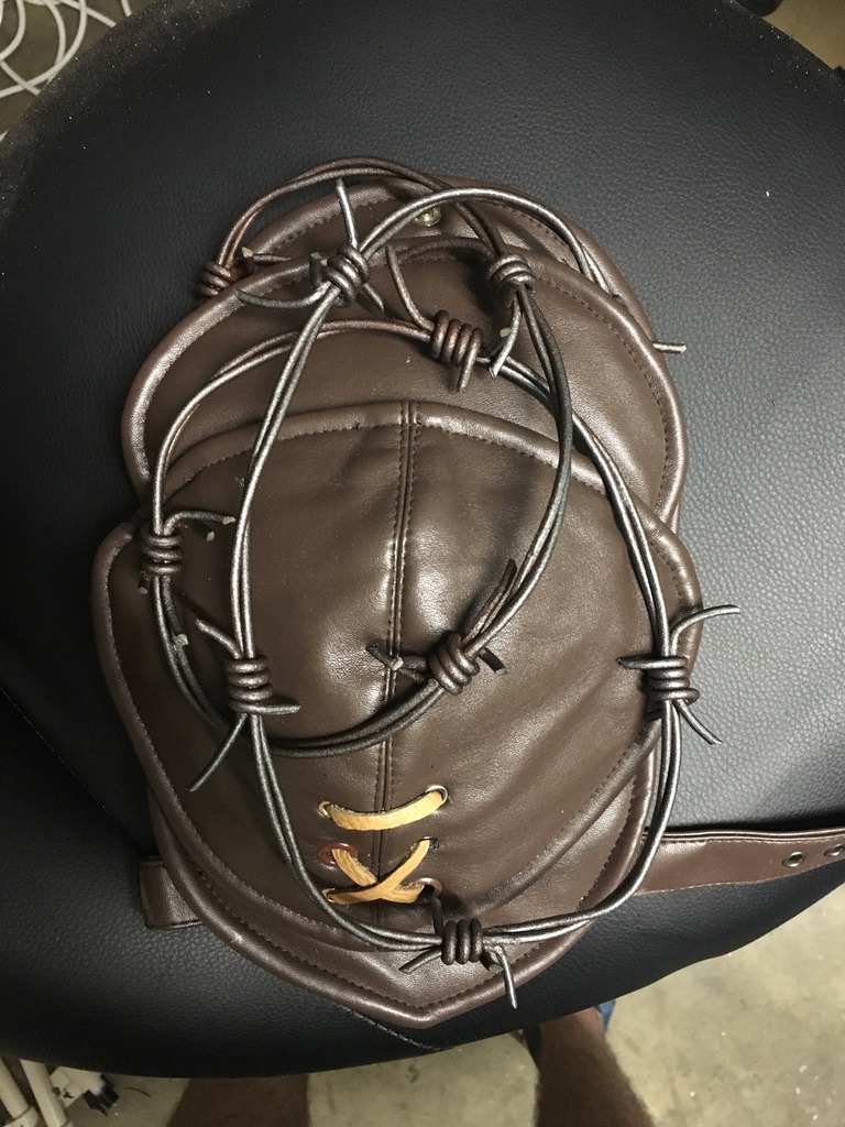

The final armour piece was the shoulder. For this I used a shoulder bell that came with the vault suit. I added some leather stitching and made barbed wire out of leather cord. Lightly sprayed it with a mix of rust and metallic paints and glued it wrapped over the shoulder bell
