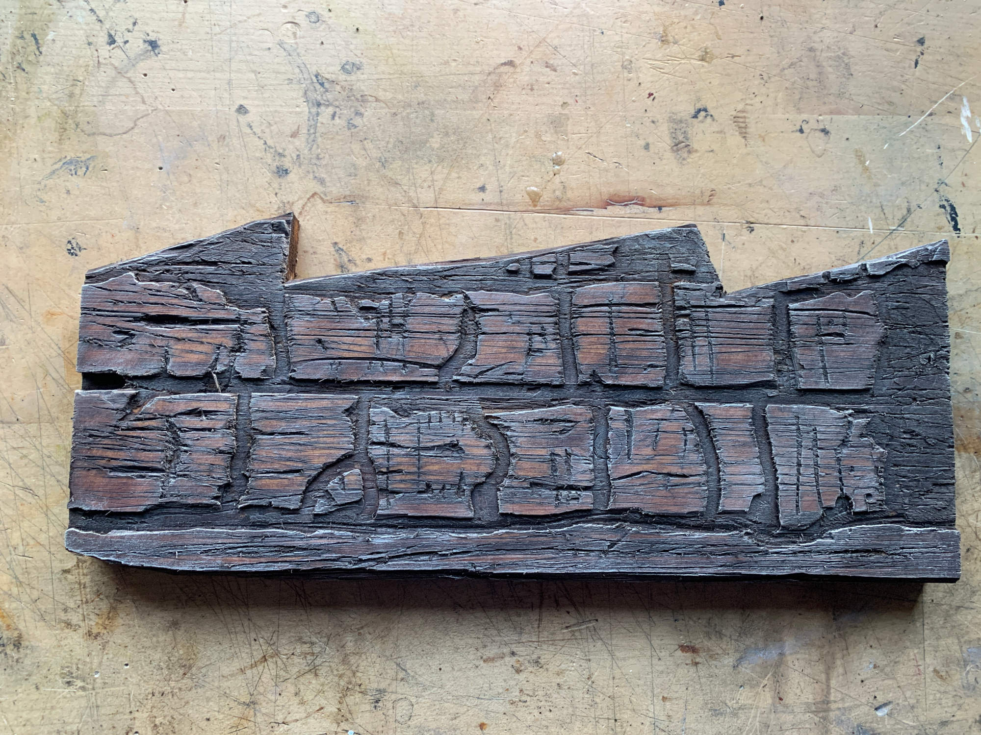

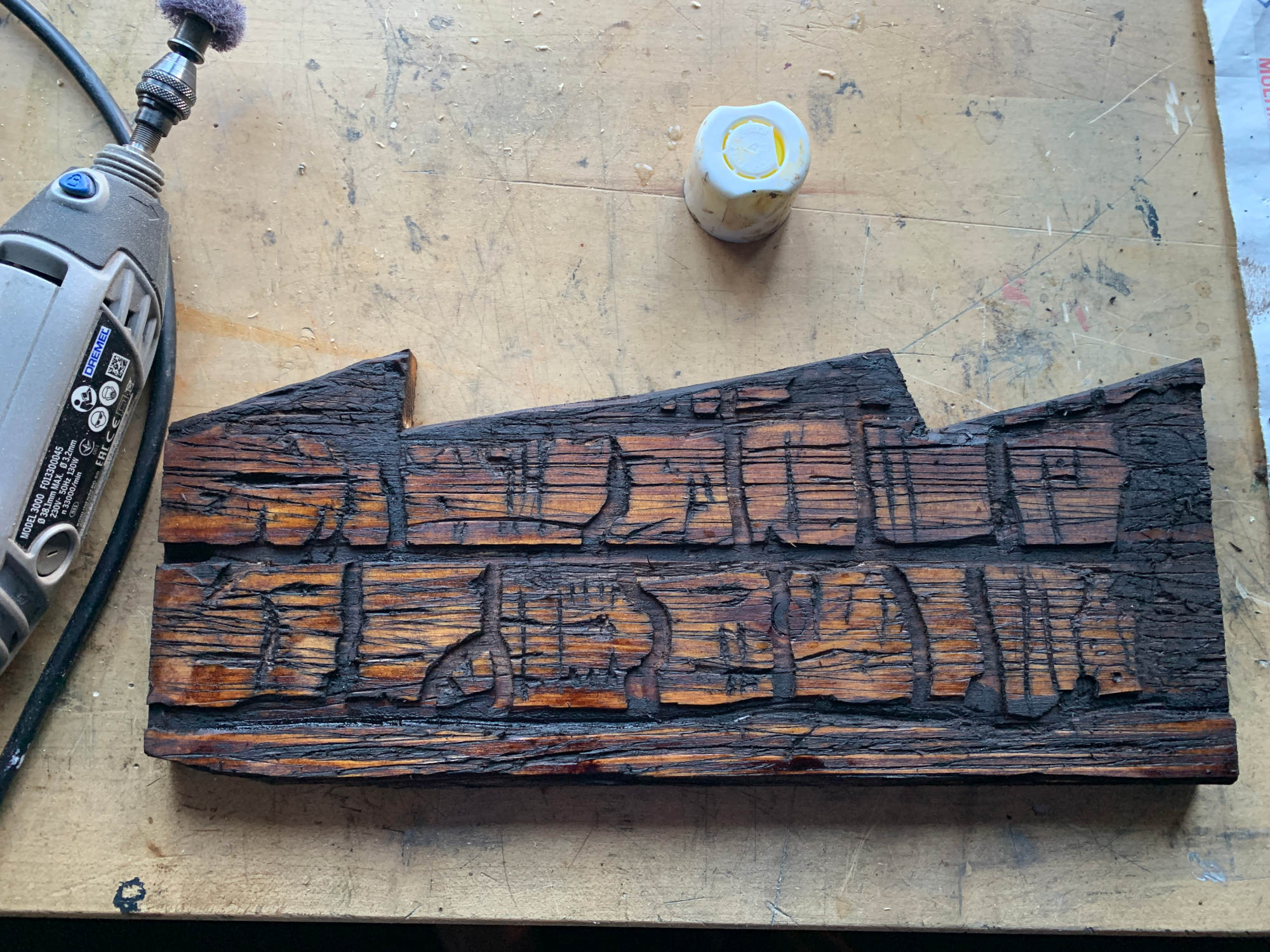

A while back I made myself an Olmec plank out of wood.
So I blew up a prop foto, transfered it roughly to a piece of wood with charcoalpaper and then dremeled it in with various heads. Afterwards I stained the woodpiece and did some weathering with acrylic and oil colours and some chizels.

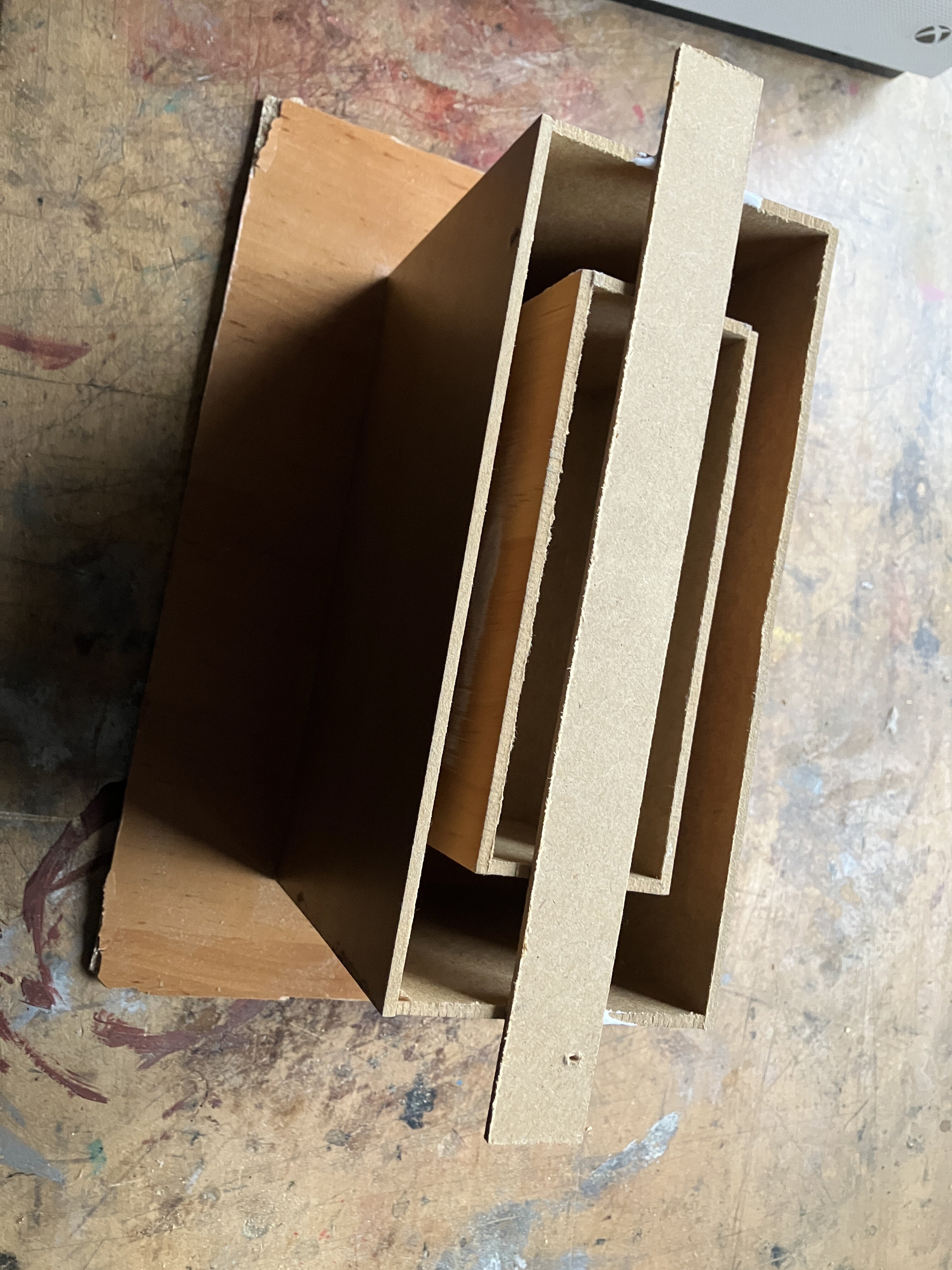

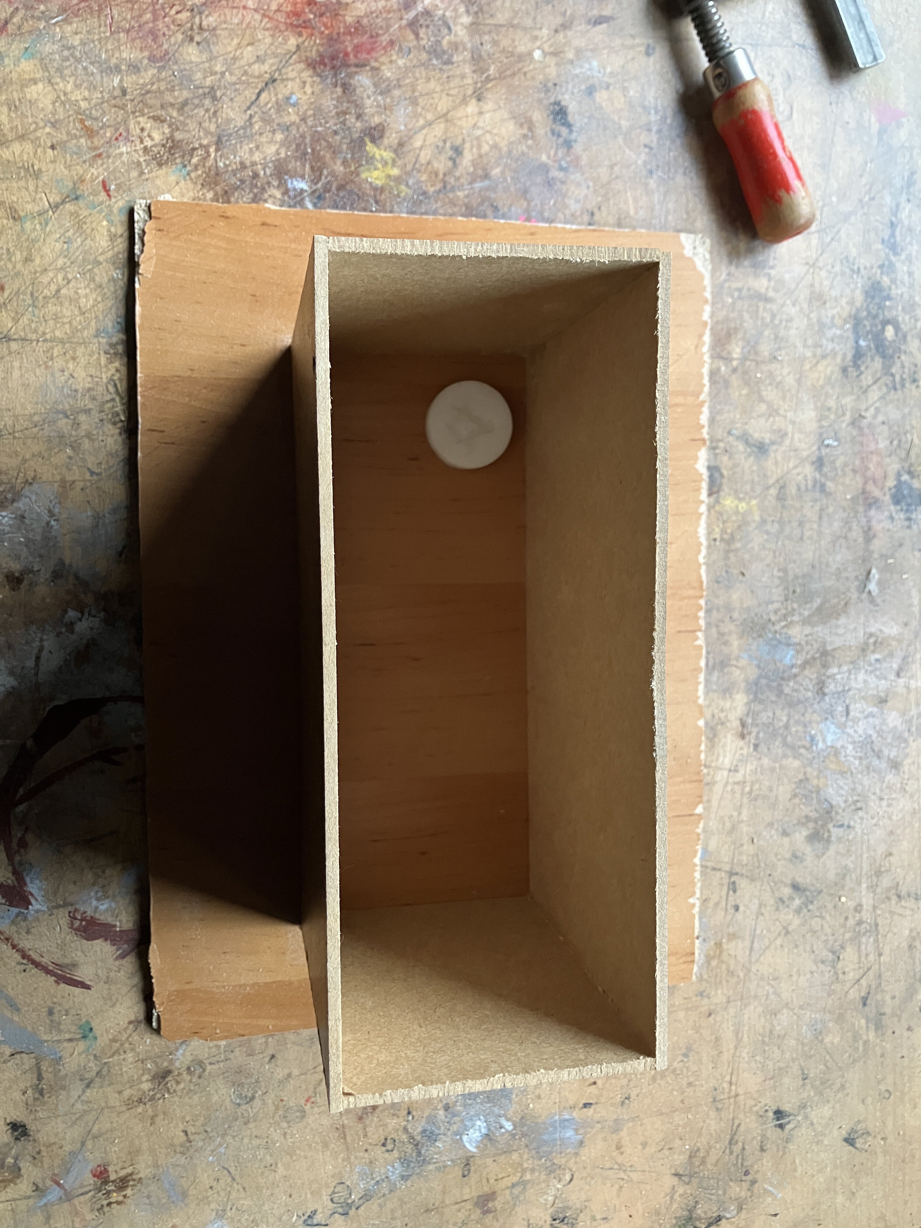

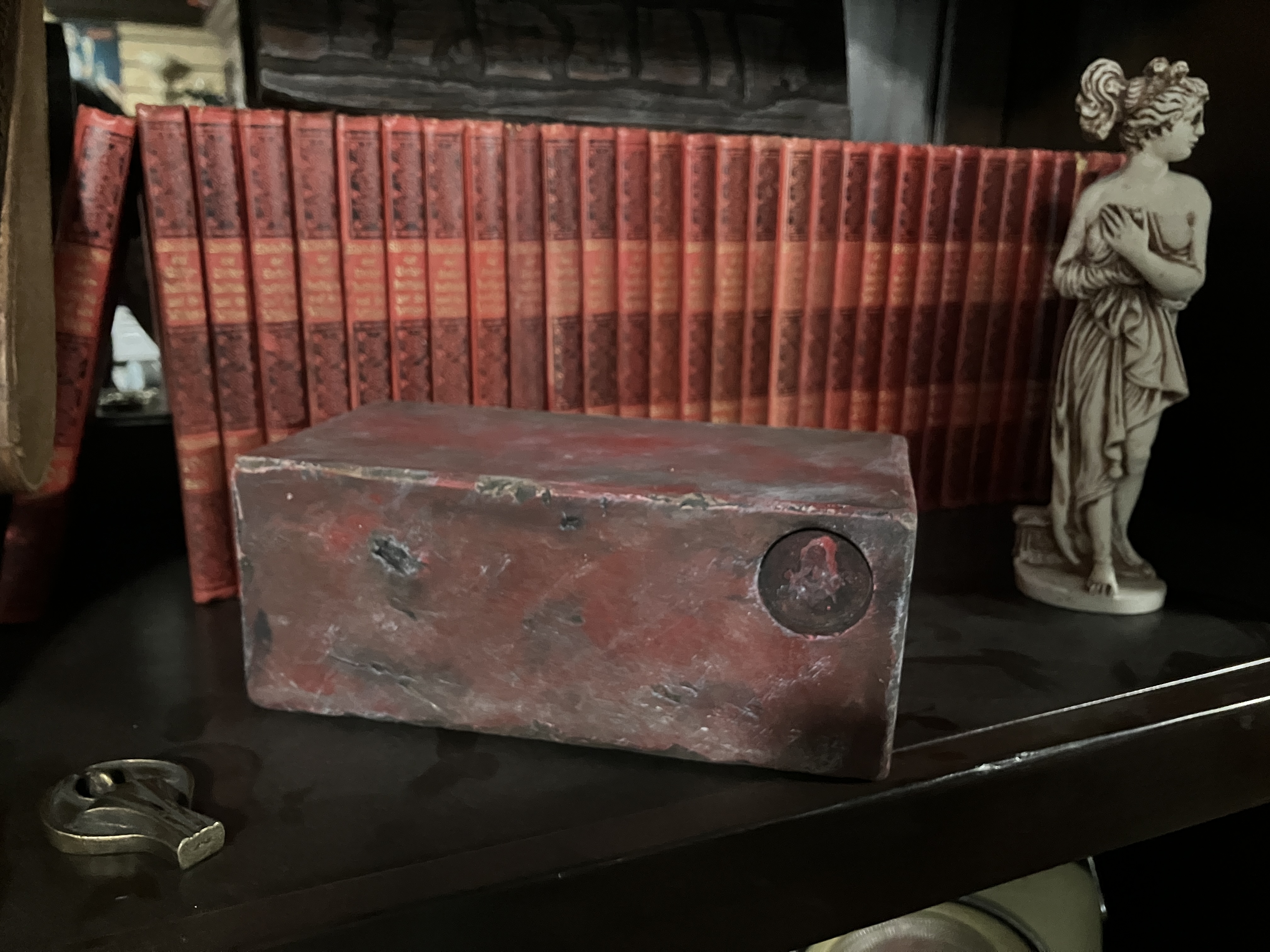

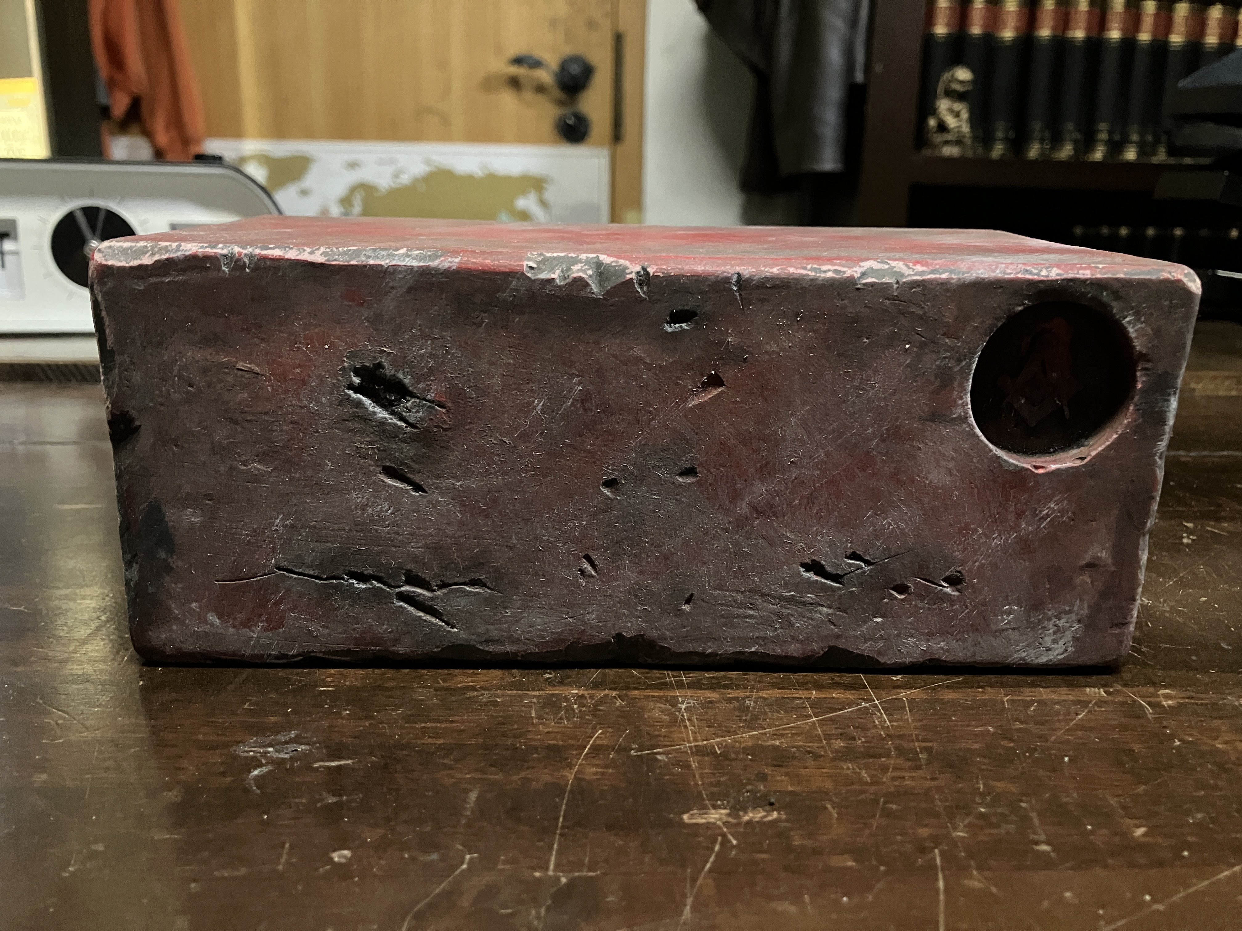

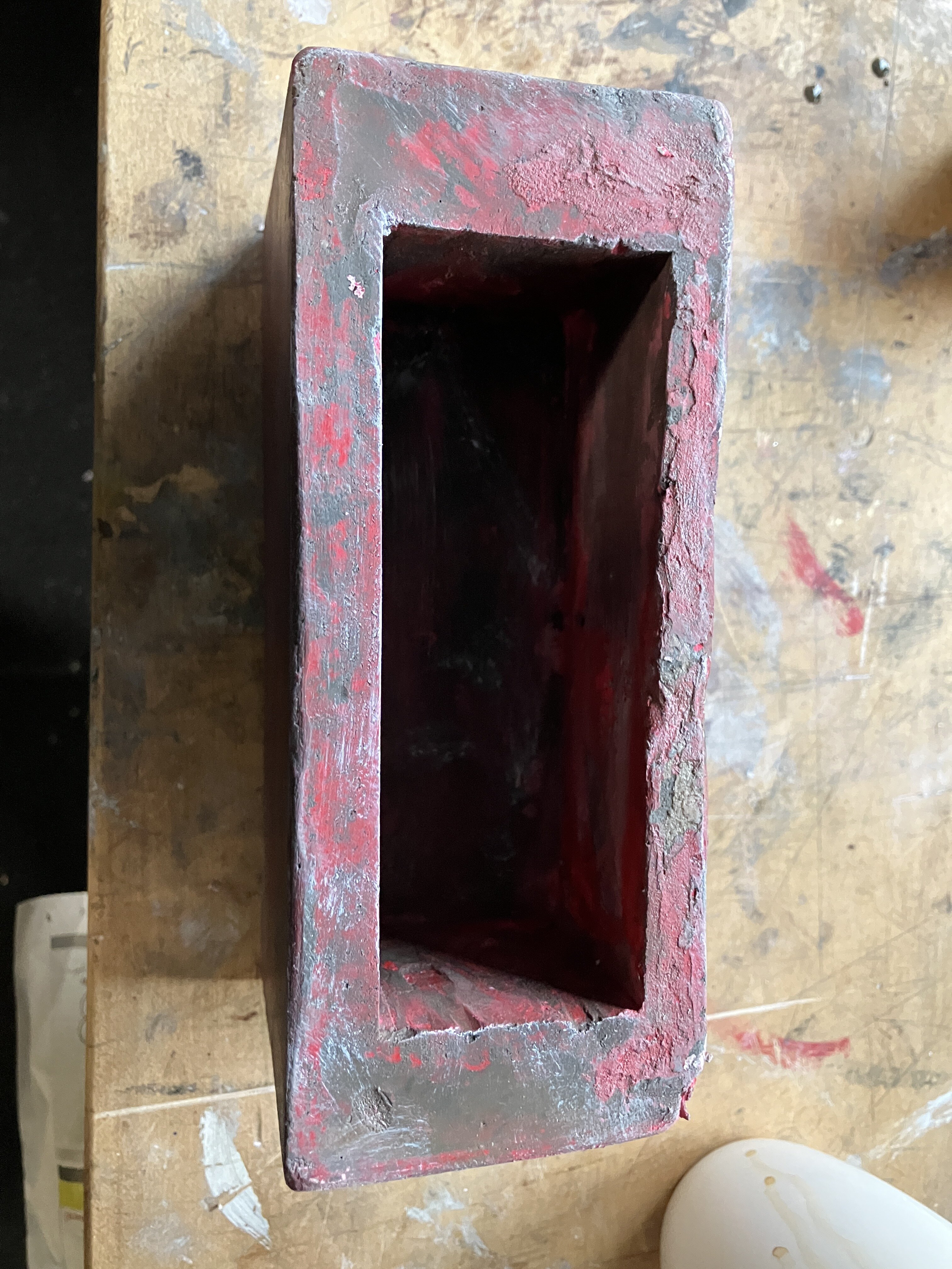

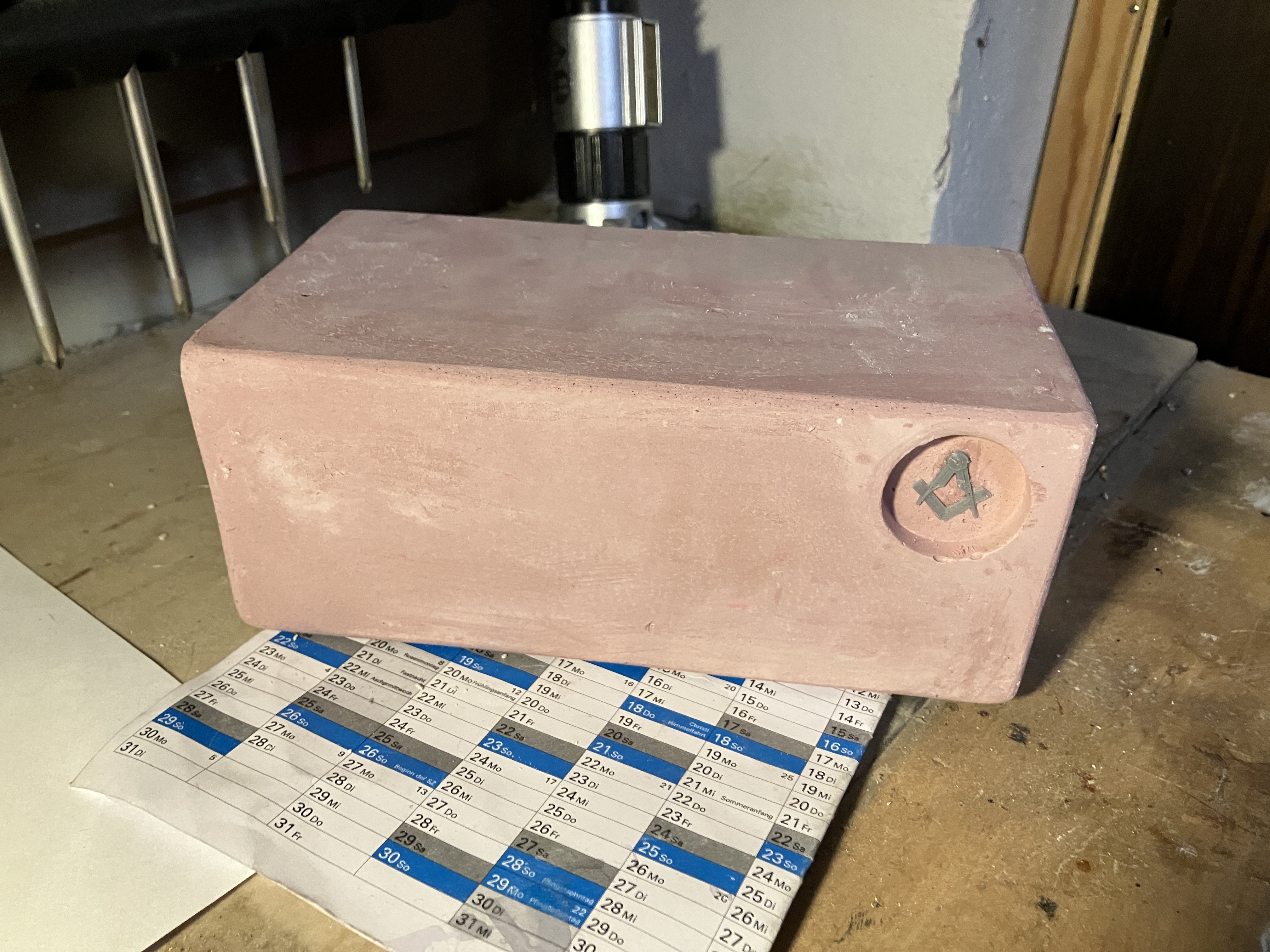

Next up is the Masonic Brick. I made a wooden frame for the brick shape. Then I made a silicone mold from a 3D printed masonic sign to have it inverted and glued it into the frame. After casting the stone with red colored plaster I sanded the edges and painted it with spraypaint and acrylic washes. Finished with white acrylic highlights. The damages are done randomly with a scraper, screwdrivers and a hammer.
