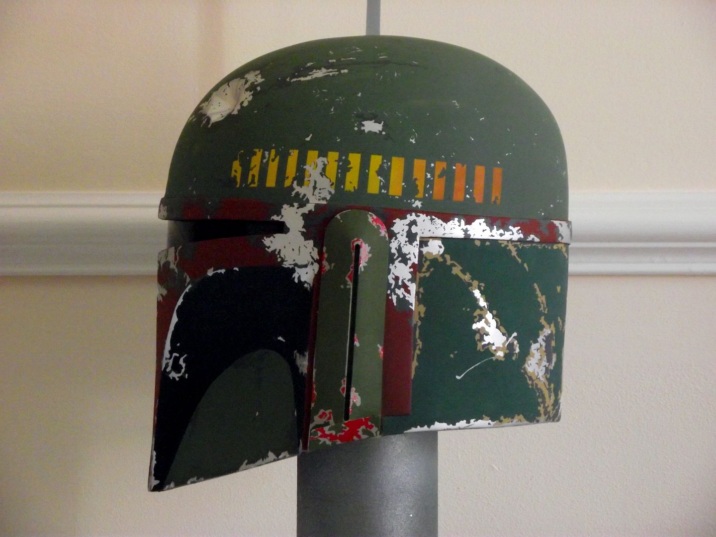

This is hopefully going to be an Empire Strikes back hero Boba Fett lid, Layered and topically done with a modified Terminal fettler paintlist which are all Humbrol Colors. Using Rafs Stencils of course, all can be found on TDH if folks are interested in putting together their own helmet.
The Base is a fantastic Terminal fettler helmet, already painted silver and assembled by the man himself (cheers )
So I started to paint both the ears first, and naturally didnt take any photos of the process. So I jump straight in with the back panels. Usually I do a full layered paint job, going from silver, to the grey, beige then the final green. But on the last helmet I did I left out the grey layer, doing this I found really helps me keep the beige an accurate size. So after the silver was masked off, the beige was applied and itself to, masked off. For the beige I used 94 and 103 mixed 1:2. I like this section to be quite dark.
The green was then applied, this is straight up from TF's paint list, which is 76+96, although I put a little more blue in than usual. Once the green is tacky I then removed the masking fluid with a needle to give me the near complete panels.
Its then a case of going in with a fine brush and hand painting all the grey 79 sections in. I find that its best to mix the paint quite heavily with some thinner, this gives you a good working time and reduces brush strokes.
Finishing it up then by appling the white areas inside the silver, you can only see these under certain light/angles but it really completes that busy right panel look I find.
All the panels need now are the physical scratches and the misting of black plus a wire wool. Next up will be the dome and front cheeks.
Hope you guys like what you see, will post more as I get it done.
