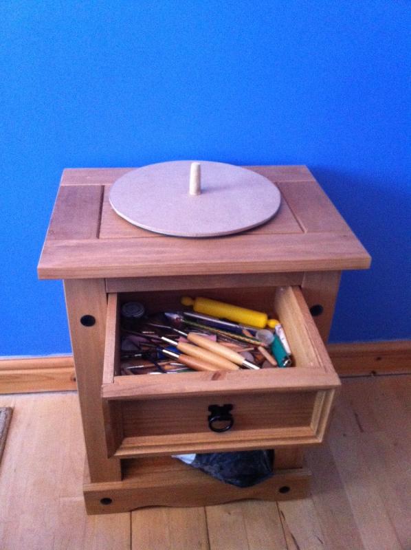

Sculpting table arrived, just waiting for the lazy susan, then i can start in earnest......................again AFTER i have reclaimed the clay from my leg sculpt.

Table assembled = Tick
Lazy susan installed = Tick
Tools in drawer = Tick
spare Clay underneath = Tick
just need the clay from the p1 leg sculpt now
I am envious of your assortment of ribbon tools, since I broke one of the two I have :(
Now start slapping some clay on that puppy!
WOOOP! Its all coming together now bud, now get the mannequin head on the pike and start some clay slinging!
ps nice cabinet
